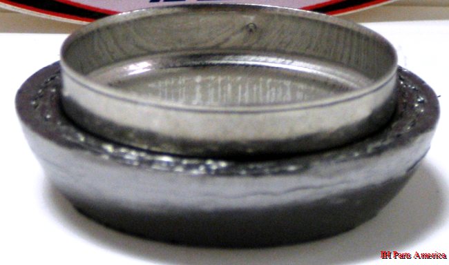

anyone have a part number for the exhaust adapter/part that mounts to the flange coming from that crossover pipe? I think I am looking for some sort of ball with flange.
Think I got it figured out, but willing to see if there is a better way. Starting at the V8 SBC, we have the pipe shown below, that is upside down. The output side, on the far right is my issue. What is the connector I need to connect it to rest of exhaust. Talked to @tornadoalleycruiser and the plan is to weld the 2" output to a 2 1/2 vibrant stainless flex pipe (lined) part 60806, then to a vibrant V clamp, part 1490, then to a 2 1/2 to 3 adapter to the rest of the tailpipe that came with the rig.
if the bottom of the exhaust manifold is flat
this one
if not (it would have a ball or angled shaped) - this one
as those are center dump, it's probably the bottom one (two bolt).
