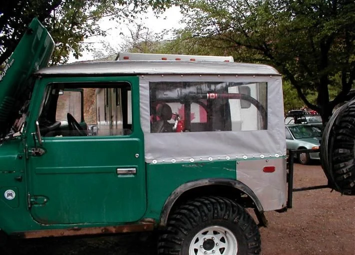

Does anyone have any detail on how the fiberglass cap attaches other than at the top of the windshield? Pics??
Thanks
I sent Steve an email asking for his input to this thread. Hopefully he will respond and show us how he installed his top.
The rig in post #20 is Steve Tetu's. He is the president of the Coastal Cruisers club up here in Vancouver, BC Canada. He is also the owner of EBI Cruiser Parts. He can be contacted at sales@extremebends.com.
How would the back attach to the top? Would "B" and "C" pillars need to be made or would the back "C" pillar be enough to attach the top (with the windsheild and the rear pillar)?

Several years ago, Toyota Trails did an entire issue of Readers Rides. One of the 40s was set up with the fiberglass cap and snap-on vinyl sides. It was red.
You might try a rusted out pair of hard sides as a start for framwork. Cut out all of the unwanted metal, weld in some bracing, paint, done.
I thought about using an older set of side panels also. It would make it easy to get the proportions right.
wow, I need to wash my Cruiser a bit.
The hardtop shell is resting on one of our family cage kits. When I installed the cage, I left half an inch of clearance between the rear hoop and the shell.
When I put the shell on it, I used pieces of (about 3/8's thick) rubber cut into strips to sit on the cage. I notched the rubber strips so I could run 2" exhaust clamps around the hoop, then drilled a flawless hardtop shell for the clamps.
I used stainless fender washers and nylocks to hold it all together
I drilled out the factory rivets on the front track and used larger stainless hardware as well
I do want to attach metal plates in the rear to support the fiberglass but I just never got around to it. I'm not sure which adhesive to use
I've run it for a few summers, no problems, no movement
I did put straps by the B pillars a few times for hwy. trips when I first installed it. The straps were not needed as I found out. It's solid, it's brushed against a few trees and has survived a lot of wheeling trips
You do get really wet at about 40 mph and above if it's raining though.
