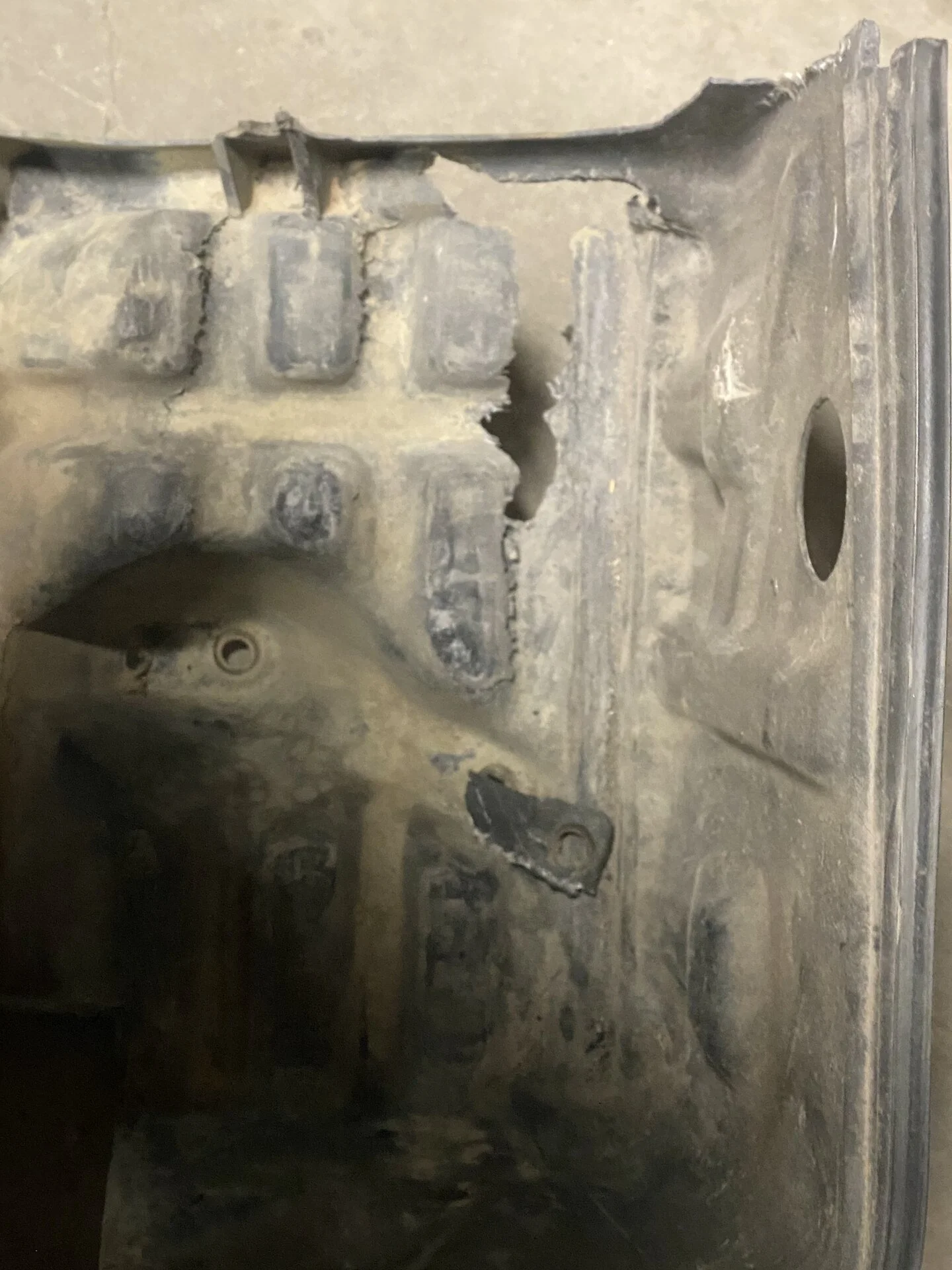

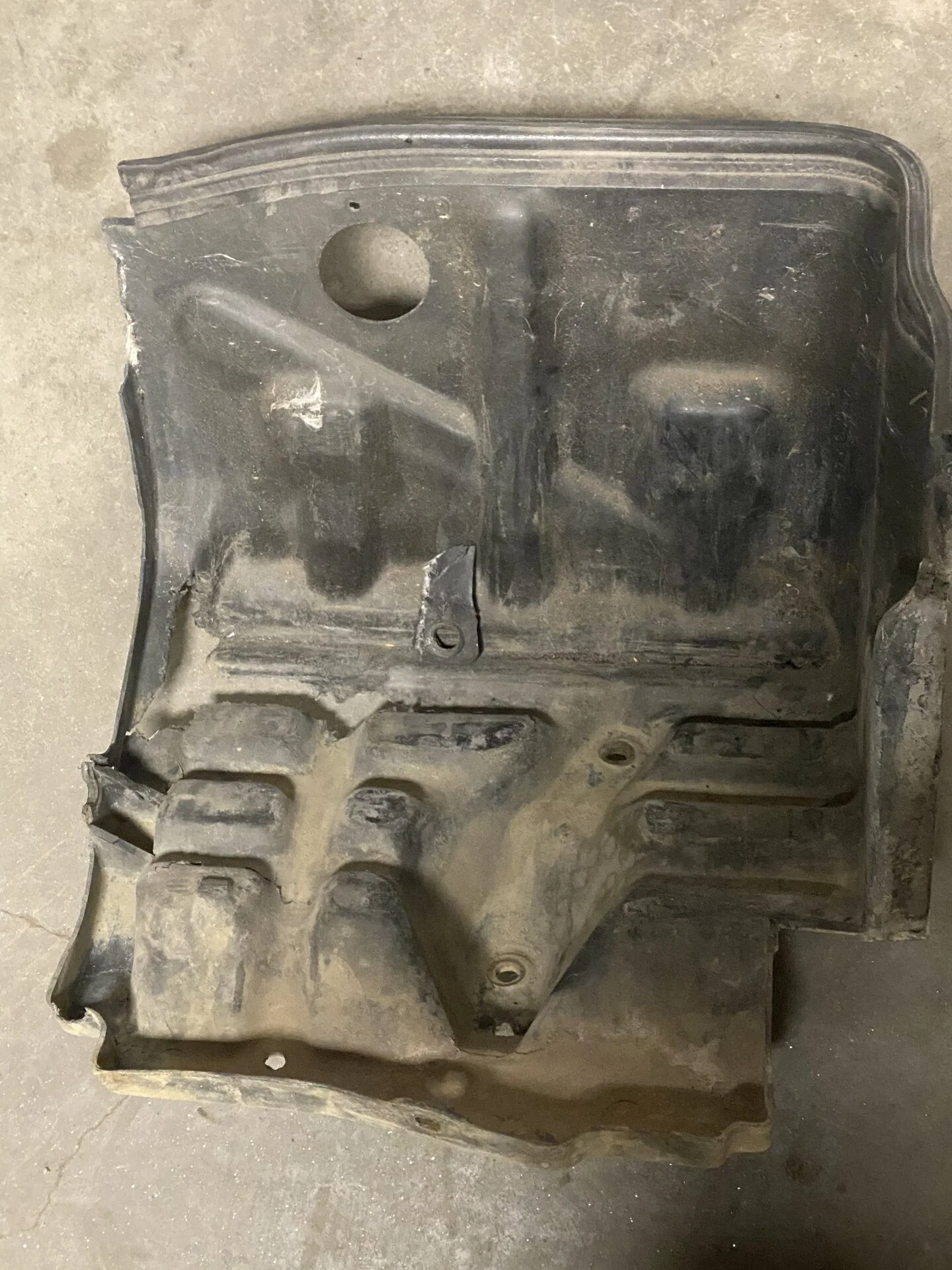

This is the plan. I had to order a new battery tray. The one in it had cracked and broken in several places, so after it shows up and I can secure the battery properly I will give it a good test.
I have not been able to figure out what the issue is and I am ok with it, mostly. I am going use this as my excuse to move forward with the engine swap and refresh of the cruiser. The only reason I may spend more time troubleshooting the issues is to eliminate any issues with the body harness ahead of the swap. If anyone has a good 3FE ecu they would lone me I would pay shipping both ways. I would like to rule out the ecu as the issue.
This battery box should have been replaced a long time ago. I am sure its broken and weakened state is what created enough play to allow the battery bar to come unscrewed and move around until it connected the positive terminal to the hood. It also doesn’t help that I had the wrong battery configuration for this set up. The battery terminals should have been facing the rear of the box away from the hold down bar. I learned something and figured I would pass it on.

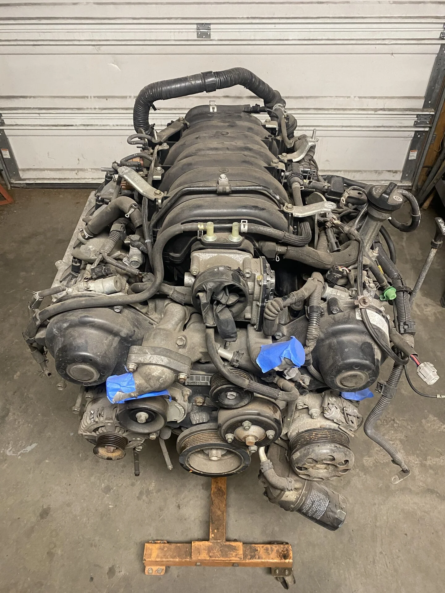

I bought this 2uz VVTI a while ago with the plan to swap it into this 80. It has 106k miles on it and the sticker on the engine cover says the timing belt was done at 84k miles. The engine has been stored inside and not run for 3 plus years. Anyone think I should swap the timing belt out again?
I have been doing some research on the VVTI version and I am leaning toward deleting the SAI system to reduce maintenance needs, clean up the excess on the engine and use the non VVTI manifold’s
Is there anything else specific to the VVTI I should address before installing it?

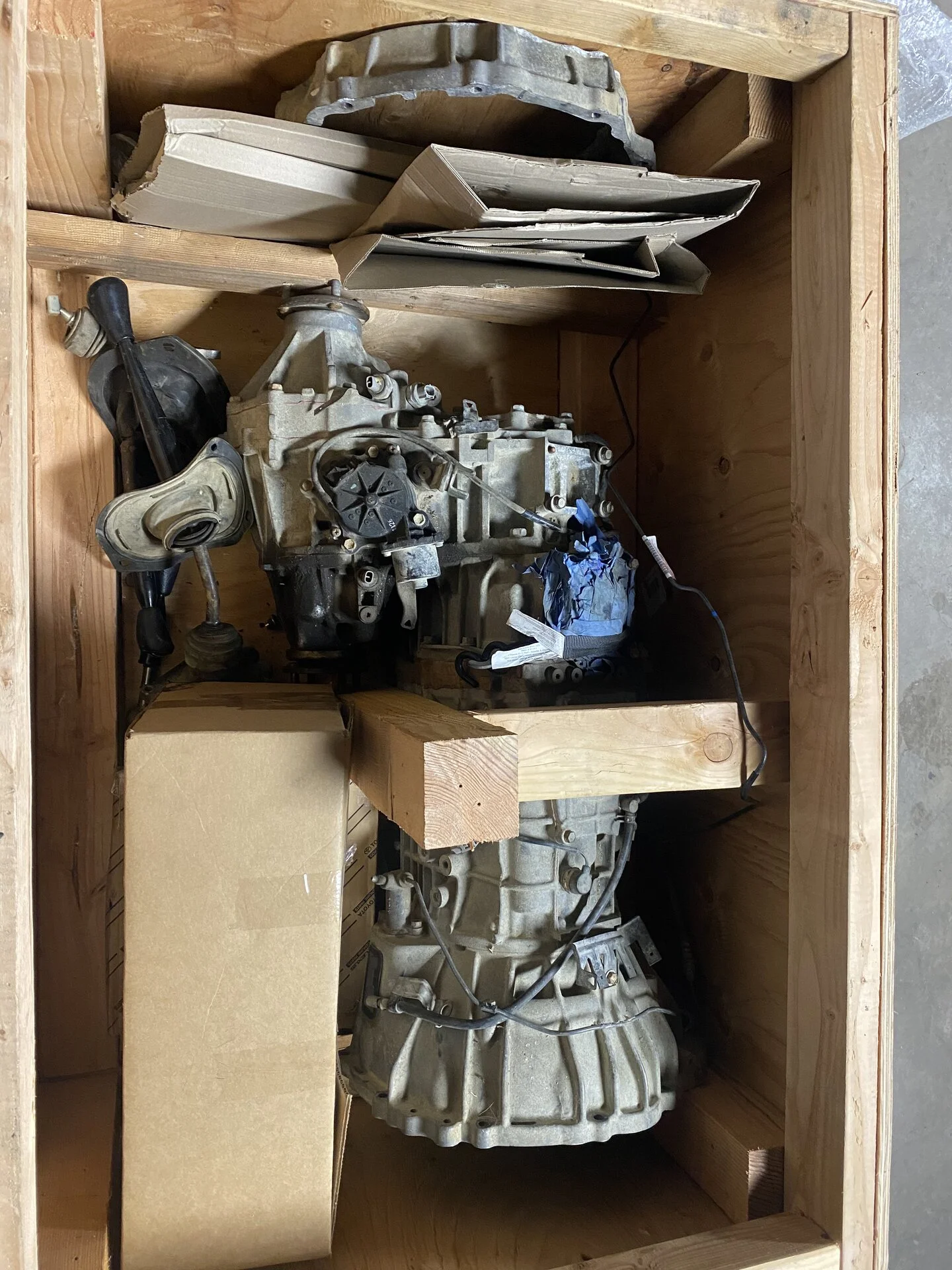

I peaked in the box box today and it is real, I bought back the h151f 2uz set up I passed on to the prior owner of this 80. Turns out he saw my post about preparing the 80 for the 2uz swap and offered it up. After a little thought it was a done deal.
It came with a bunch of small parts to help complete the install but I still have pieces to order. It will sit in the box until I have more pieces of it. I need to get the 45 bed done and on to make space for the 80 before my Land Cruiser ADHD kicks in.

Wow, is this a brand new h151?
that packing job is no joke.

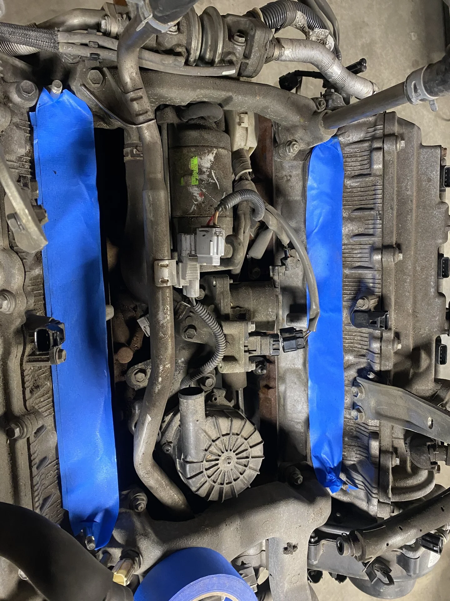

I pulled the harness from the engine to send out to get reworked. I knew part of the SAI system was in the craddle but had not been into a VVTI before. It seems Toyota didn’t think pulling the starter was enough work as it was, they wanted to pack more crap around it. I am still leaning towards deleting all the SAI, I just need to do more research.

Pulled the Intake, to remove all the SAI components. With everything out of the way I decided to pain the block. I used this POR15 engine enamel after using their degreaser and metal prep. It is has been really cold at my place but I did let that deter me. Initially the enamel was as thick as honey, I had to set it in front of a heater to warm it up so I could brush it on. I went through several cycles of warm it up, brush it on , rewarm it, brush it on etc…. Optimum temperature is 70 degrees, I hope I didn’t waste my time.

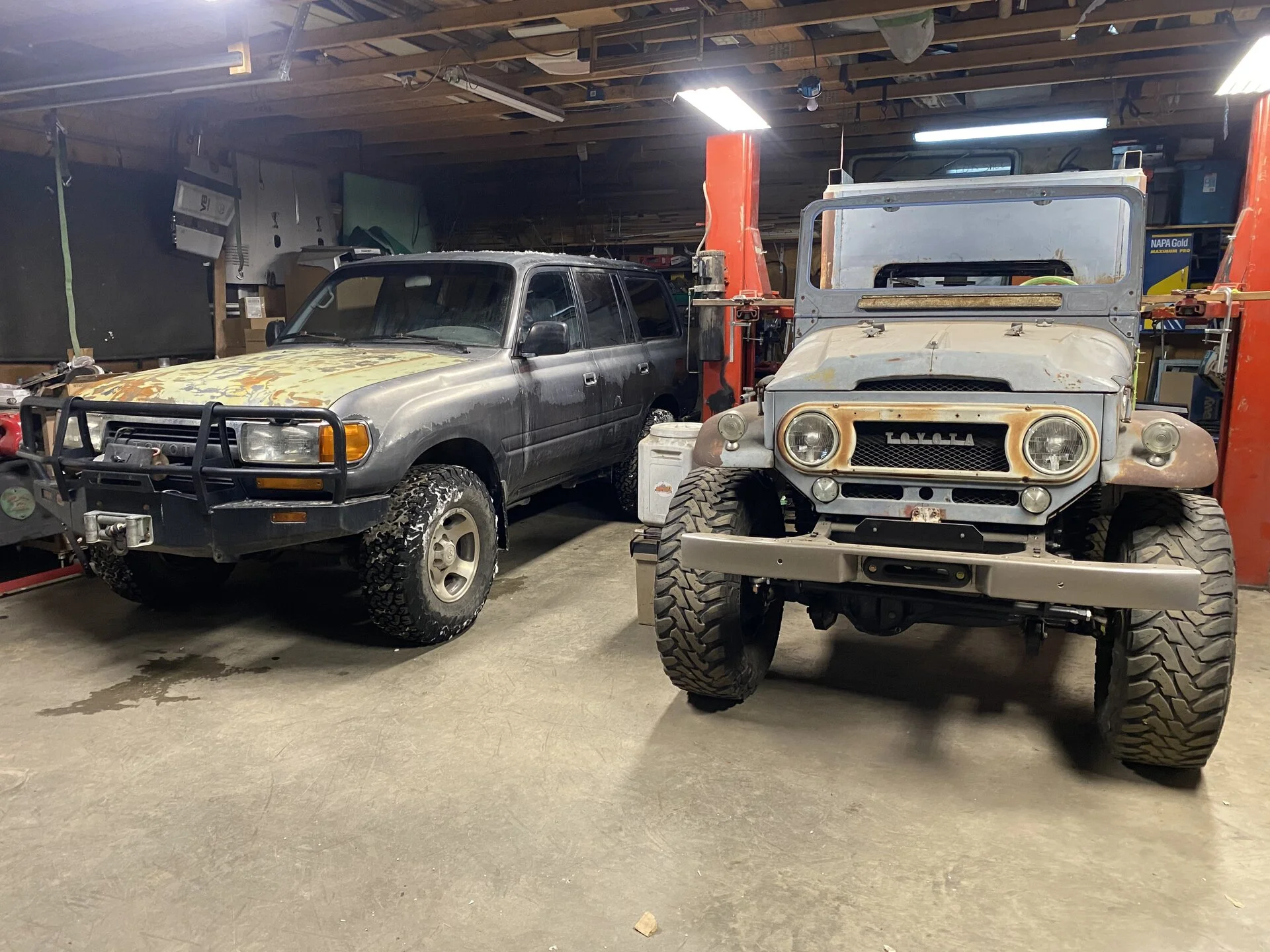

I spent some time this past weekend rearranging the garage, so I could get the 80 in. The 45 project had really spread out but it is far enough along to share the space, so it has company which will be distracting at times. I am hoping the swap goes quickly after I start.
Interestingly I have driven the 80 three times after letting it sit and have not been able to repeat the check engine light or electrical issue when under load with lights turned on. Weird, doesn’t matter at this point. I plan start to the swap shortly.
Pretty rare as I thought only LX450 full-spec 80's were sold in the US. It's got some of the features of our Oz pov/dx/base model 80's with the no-sunroof, fixed cargo side glass, no flares, but it still has a tailgate not barn doors.
Looks pretty nice and hopefully is mostly rust-free.
