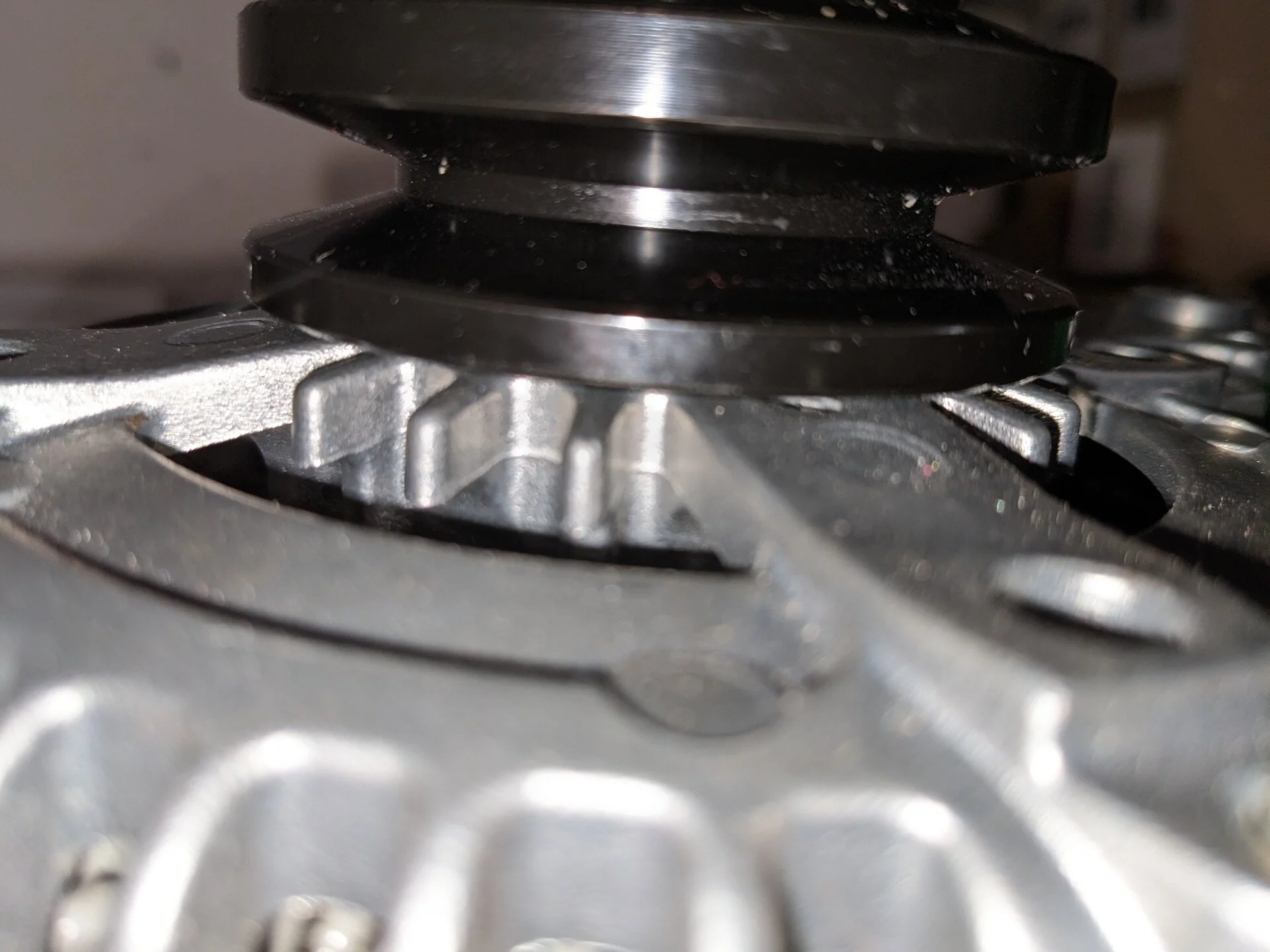

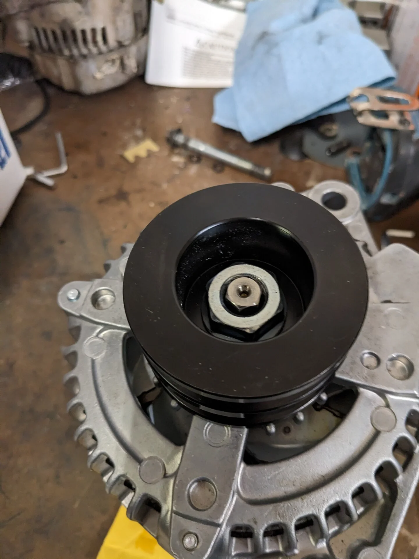

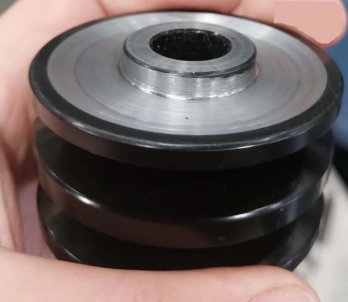

Correct Landtank, I did find a smaller pulley meaning smaller overall outside diameter and smaller outside diameter in the bottom of the v-belt grooves. Everything is right about it except the back side. It needs to be milled out a bit to clear the alternator housing. SHouldn't be a big deal to resolve.

Those are nice classic mills. Better than the china ones. Here is my pulley milled out - clears nicely.
