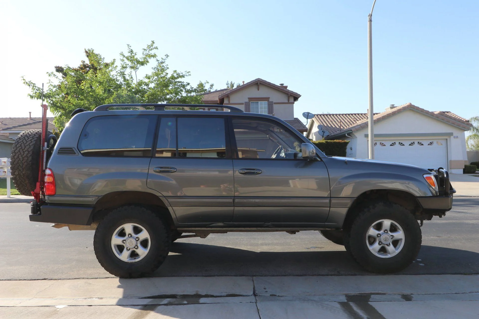

my previous 100 series from a couple years back. note the arb front bumper and slee rear bumper..., then note the rocker panel dents without sliders. i definately learned from my mistakes.
