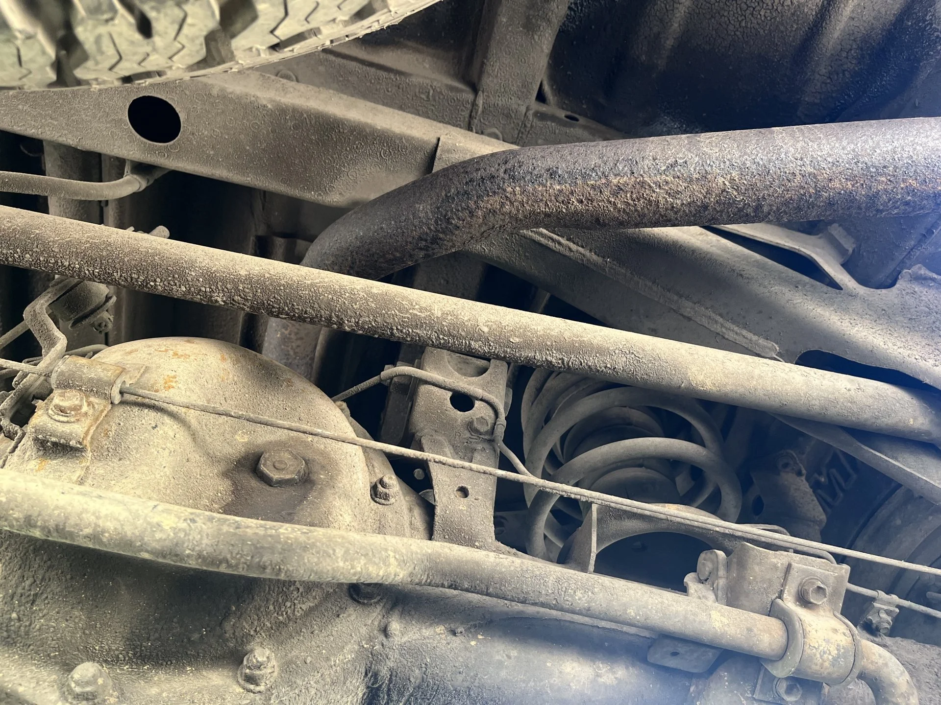

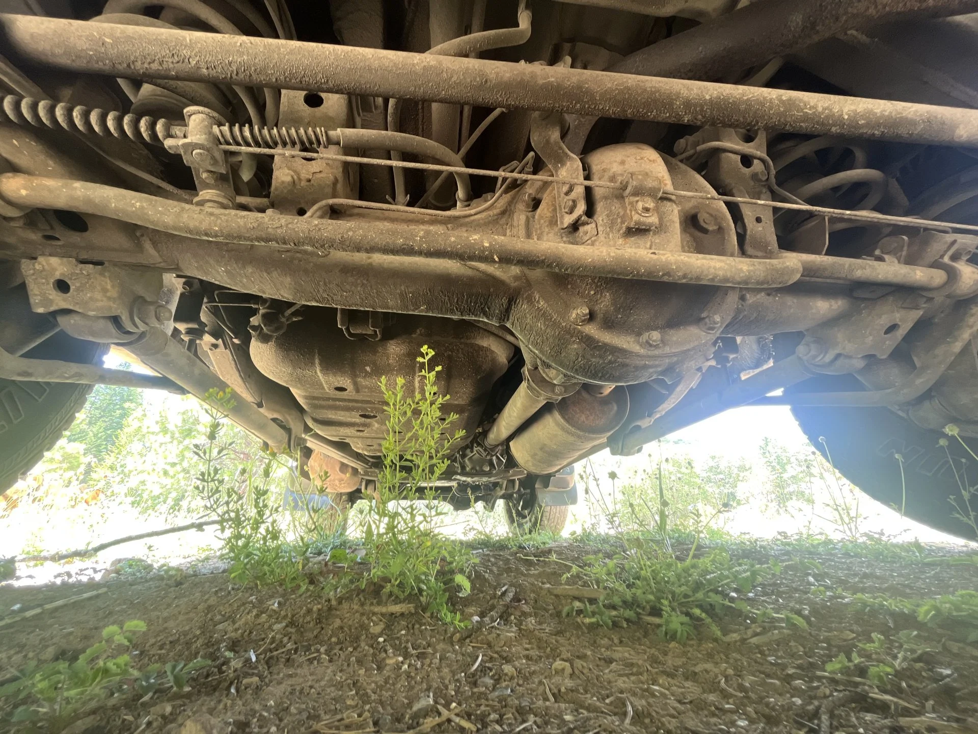

Will it clean up well? Looks good as far as rust? Appears to just be road grime to me
Yeah that's just grime and a touch of surface rust. It's going to take a lot of scrubbing, but it'll clean up nicely.
Look at the heads of the fasteners. That seems to signal the tipping point between "some surface rust on the gravel-blasted bits" and "run away, serious rust!"
Looks rust-free and filthy to me.
Looks good.
Personally I wouldn't try to pressure wash it, you'll just remove any previously applied rustproofing, and the rust will start, guaranteed.
Just drive it during a rainstorm, that will wash off any dust.

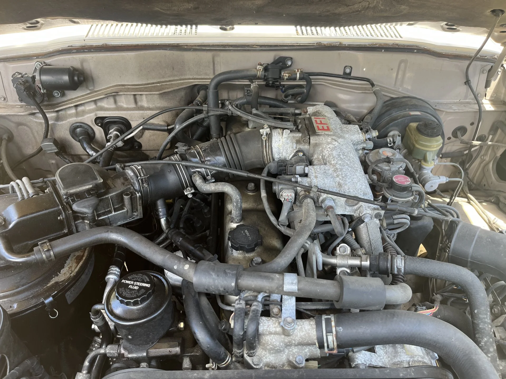

I wish the engine bay were a little cleaner and the window/dash both are cracked. No roof rack from factory which is cool.

The large air intake tube going from the air filter housing to the throttle body has a quickie repair, needs to be replaced.

Engine bay actually doesn't look all that bad, just some light oxidation on the aluminum intake manifold.
