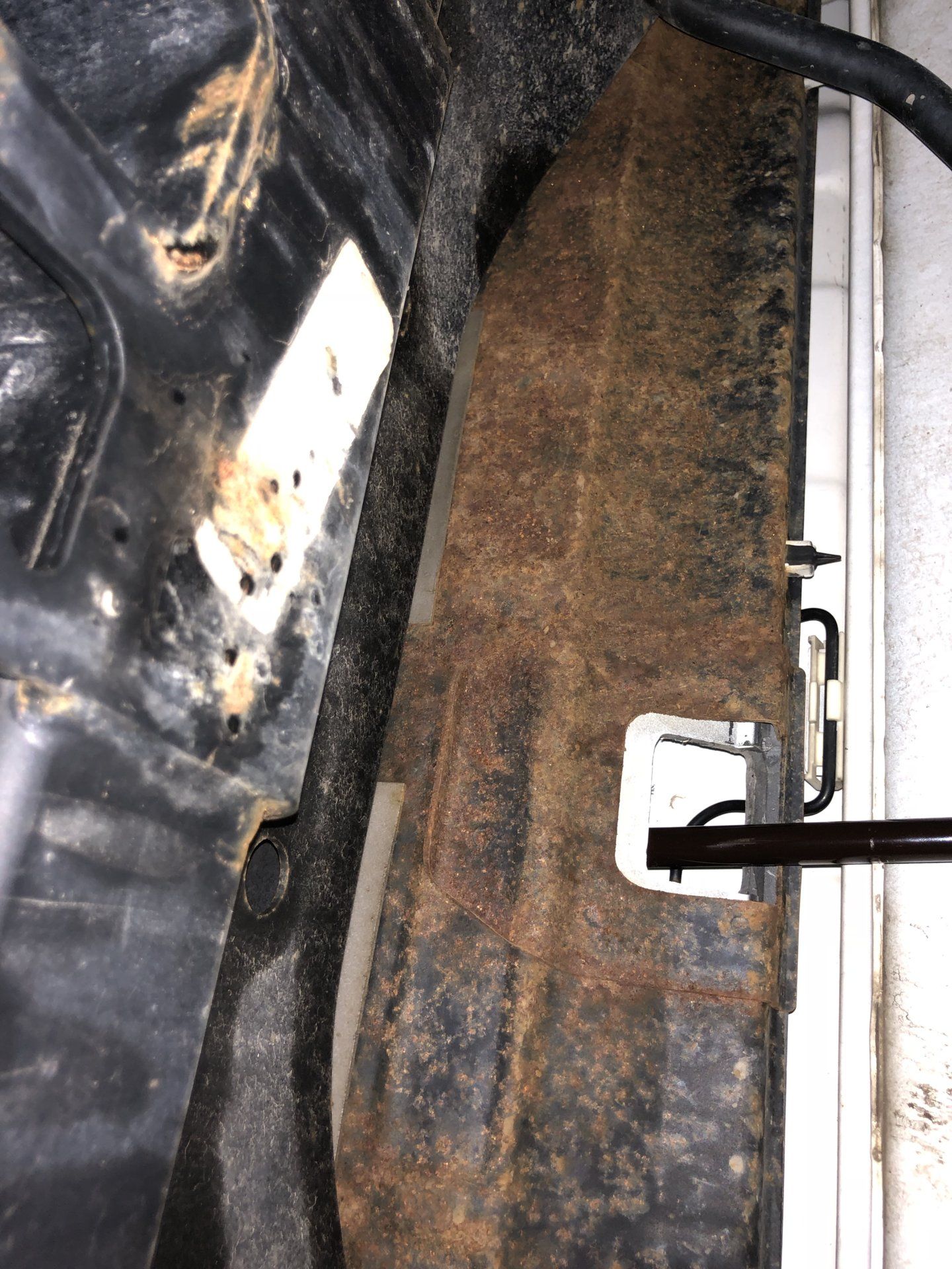

Curious to get some opinions from everyone here. Recently picked up a 2000 LC for a good deal for 4500 with 202k. even though it needs a couple things (timing belt/WP job, exhaust manifold gasket, hood latch, and rear brake shim clanking). What gives me concern is the amount of rust underneath. I would like to see what you all think and how much of it I can do something about without dropping serious cash.

I can't offer much for help other than that looks scary. I live in the northeast and personally, I would have passed on that. Not that it's a bad deal, just that I plan to keep mine for a very long time and that amount of rust would make it much harder to do.

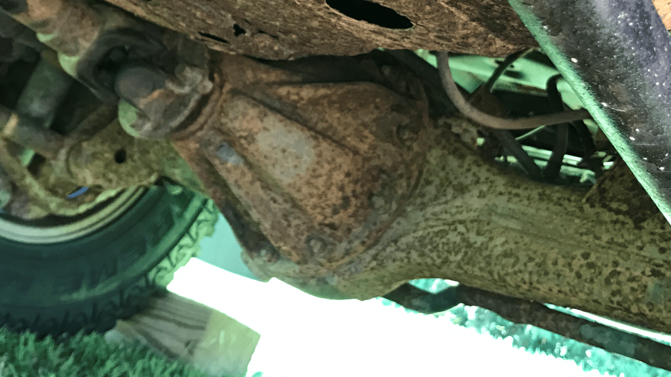

Just purchased a 1999 a few months ago. 204K miles, New Hampshire. Underneath is full of rust. Holes everywhere, and the gas skid plate is half gone due to rust. Its now relegated to parts duty for my next 100

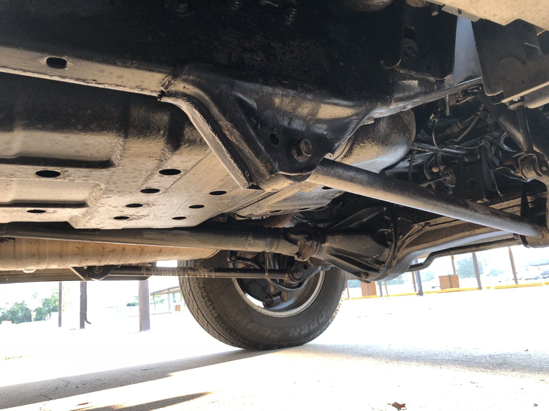

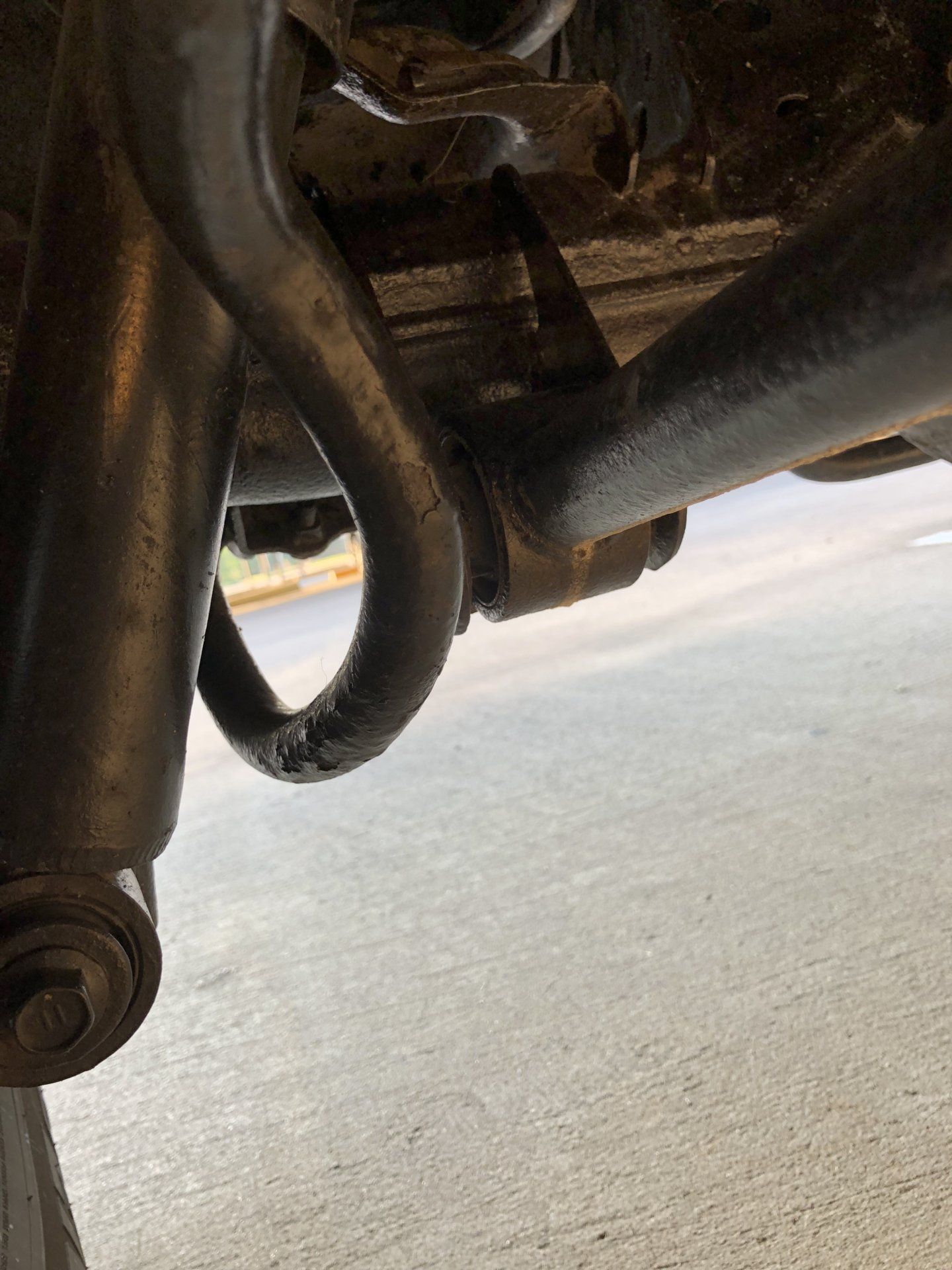

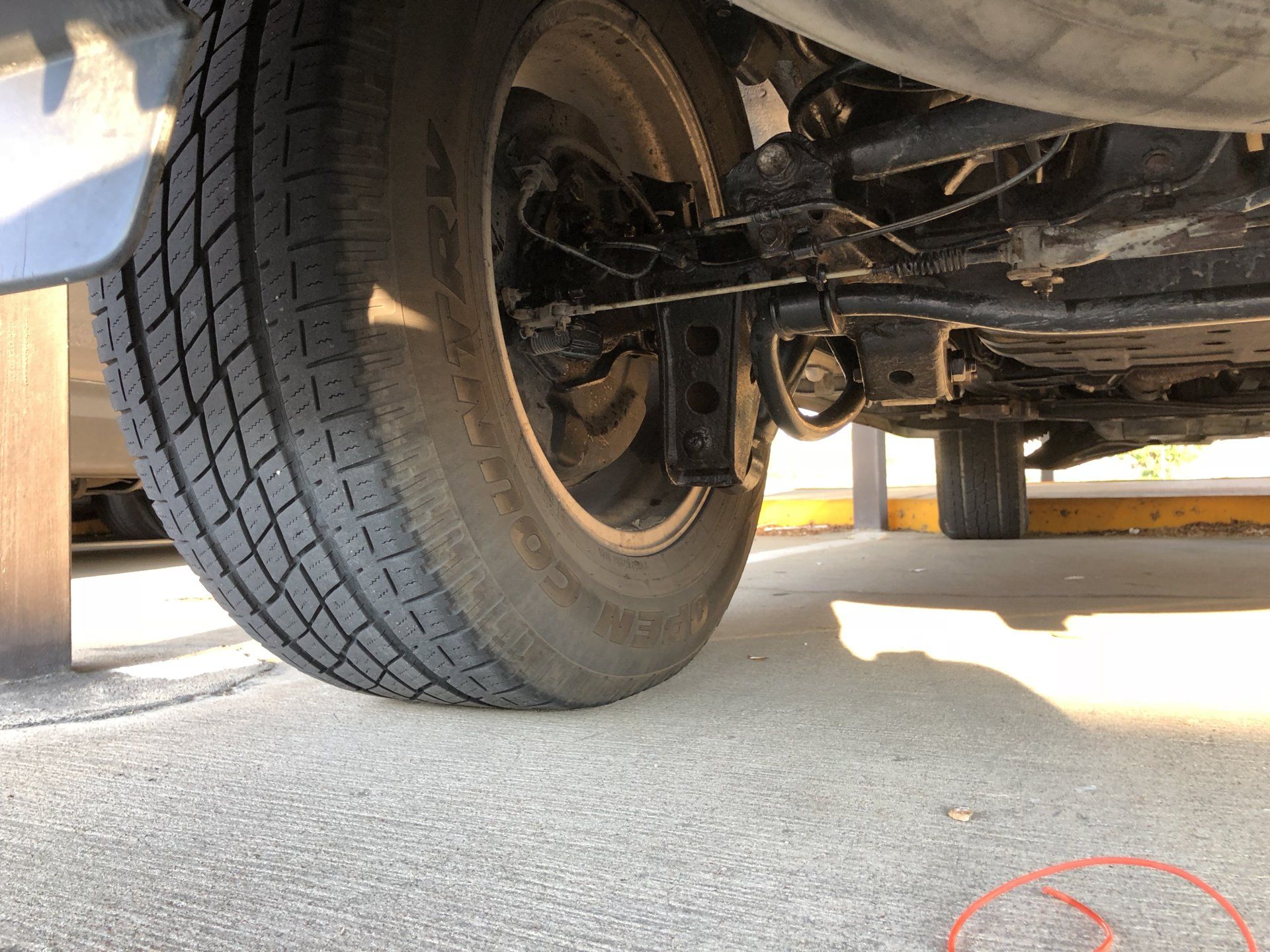

Looks pretty clean, however, when I received it it was a pretty substantial level of rust.
I used Corraseal and that’s it.
I’ll hit it with POR soon.
Before:
After:
Did you brush any of that down or off before applying the seal? Have you had any issues with it?
Gas tank cover and stabilizer bar had flaking rust. As you can see, it didn't take that well. Corraseal is great for superficial rust only. I'll go back with a brush tool on the drill and re-touch it. Then the POR-15.

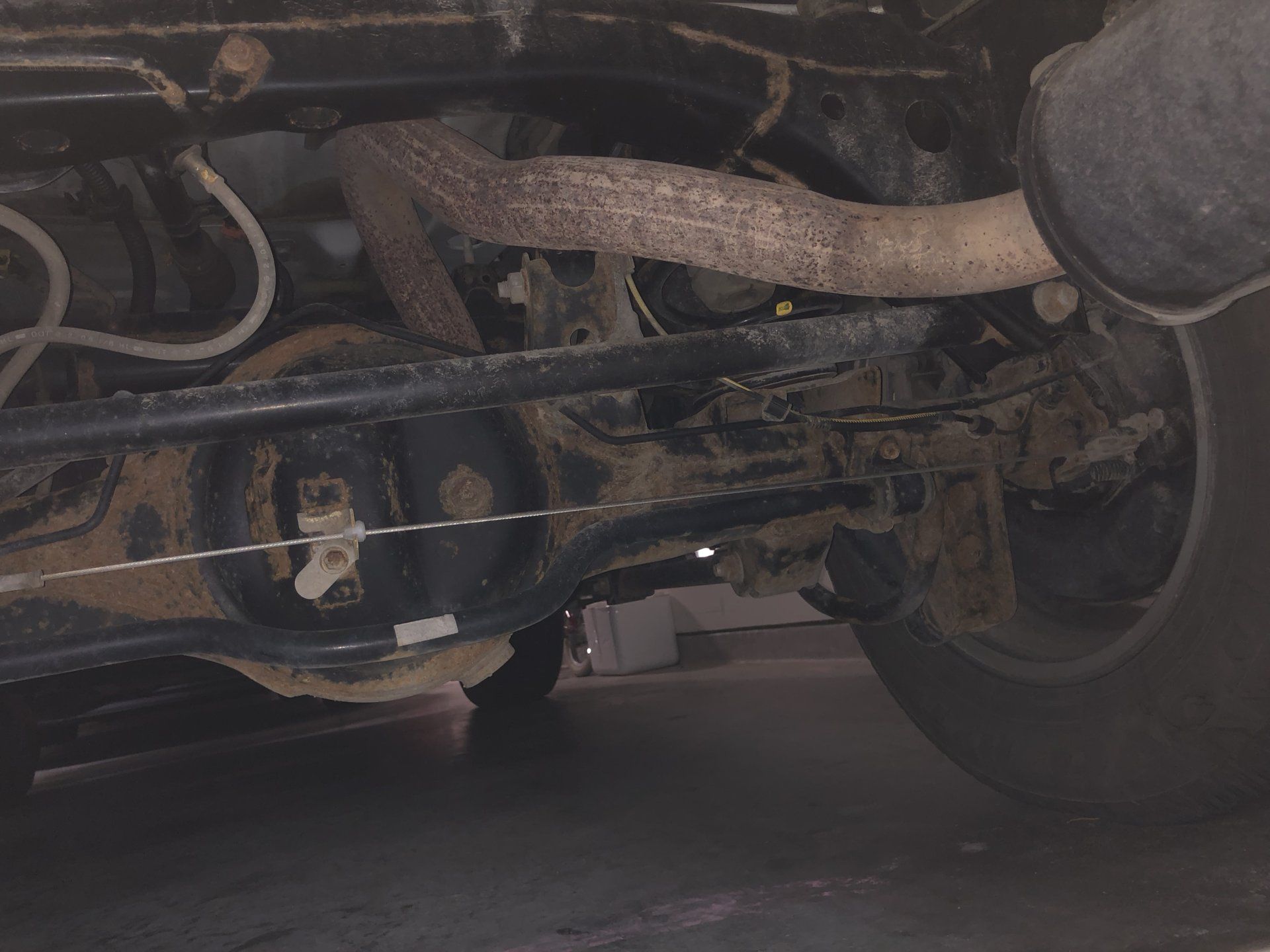

I guess I will need to do some wire-brush rust cleaning and to avoid further rust do undercoating maybe?
First, I heartily agree with the previous two guys... low miles, and in very good shape rust-wise. $14k is an excellent price. I wouldn't undercoat it; rust has already started (although very little), and all you'll do by undercoating now is seal it in where you can't see it; it'll still keep developing under there. If you'd like to really stop it and protect it, POR15 is the way to go. Just don't paint your boltheads to the frame.. ;)
