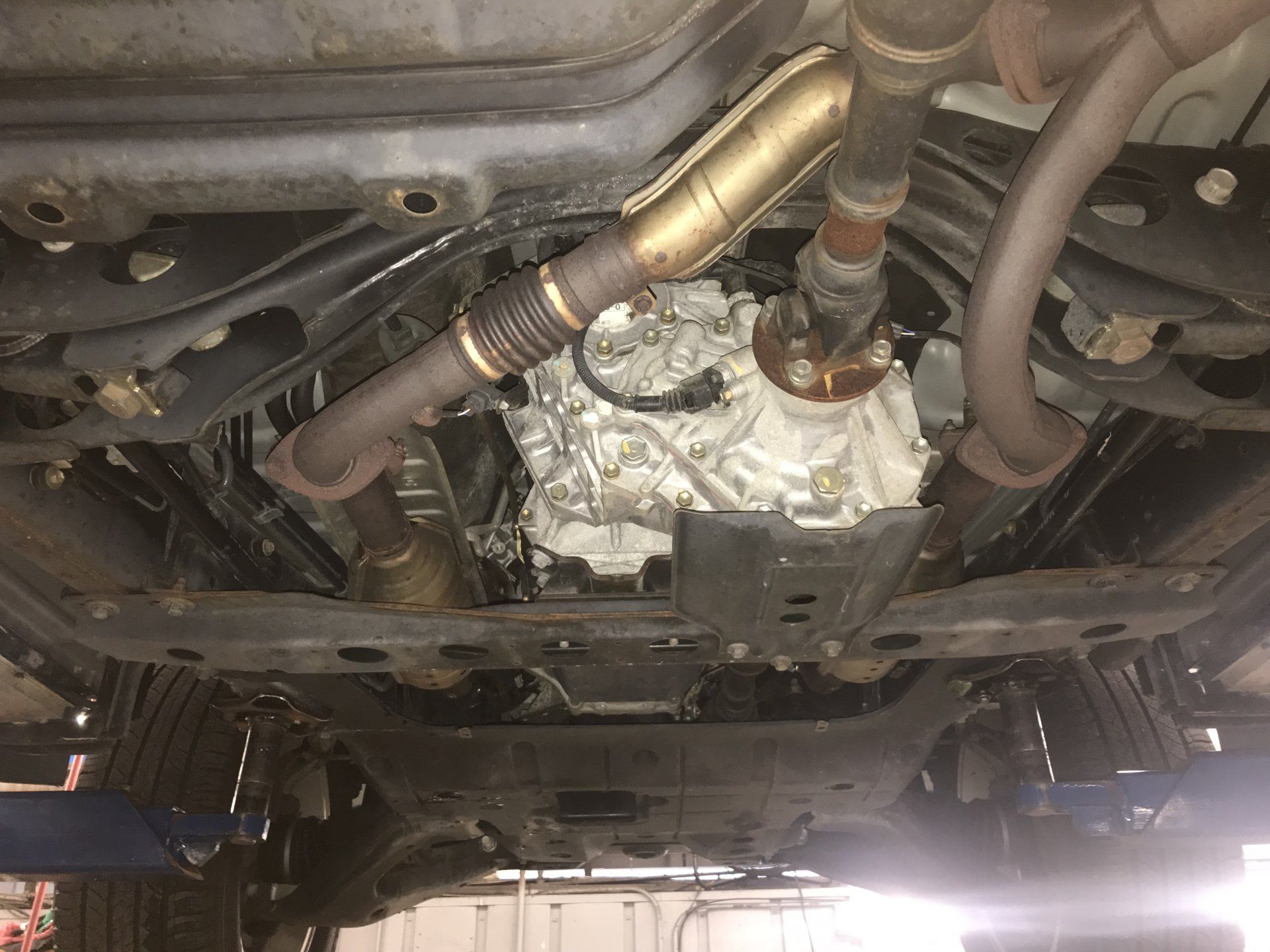

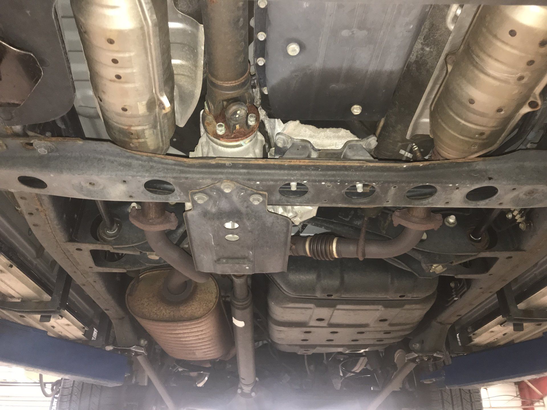

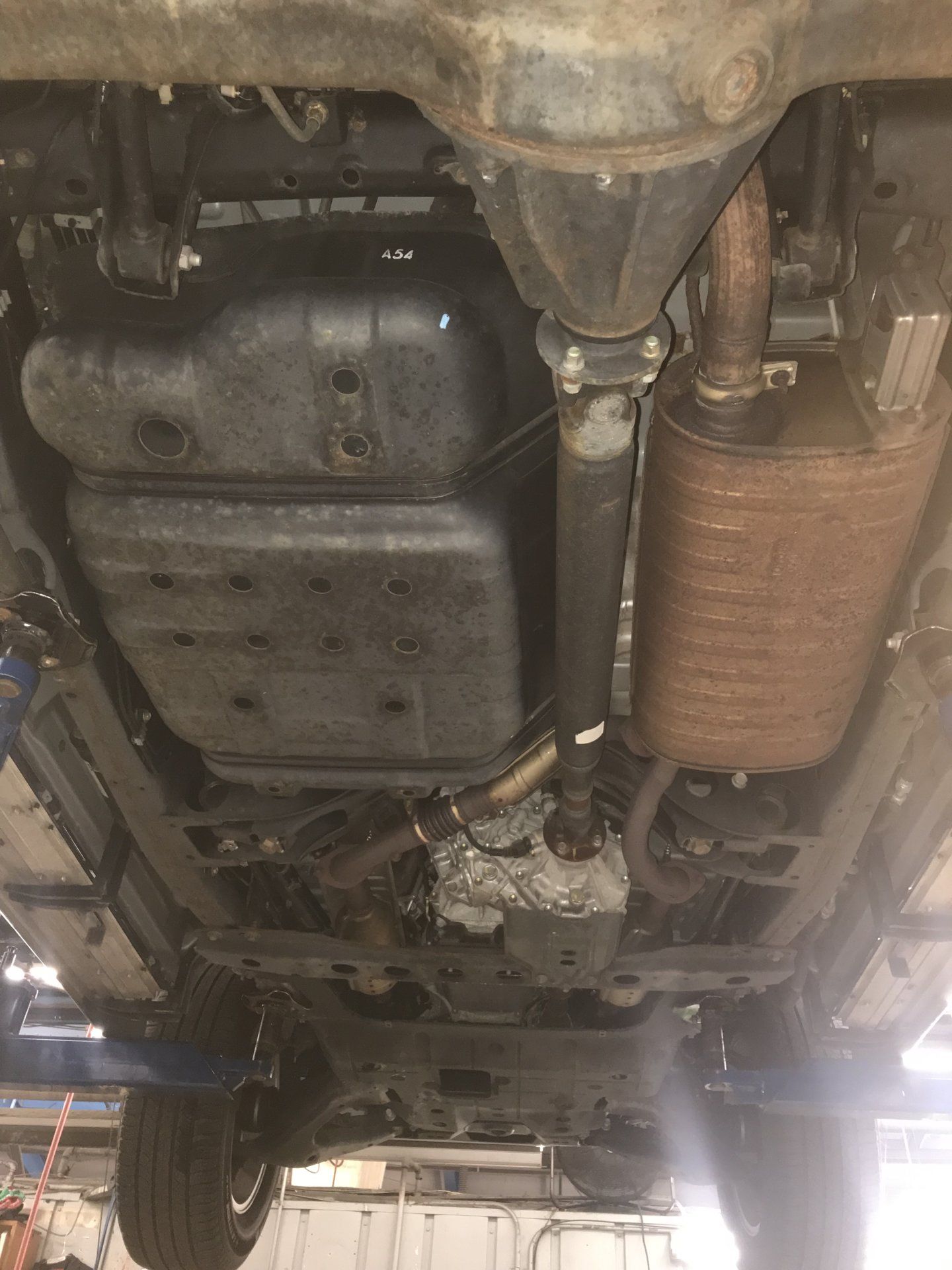

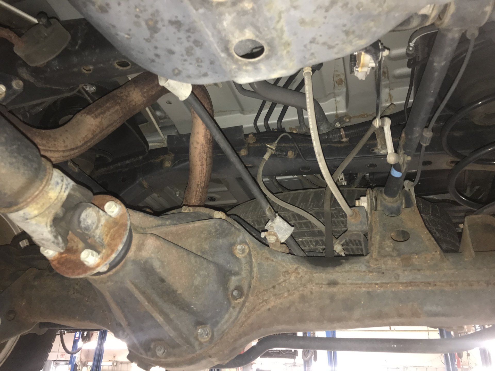

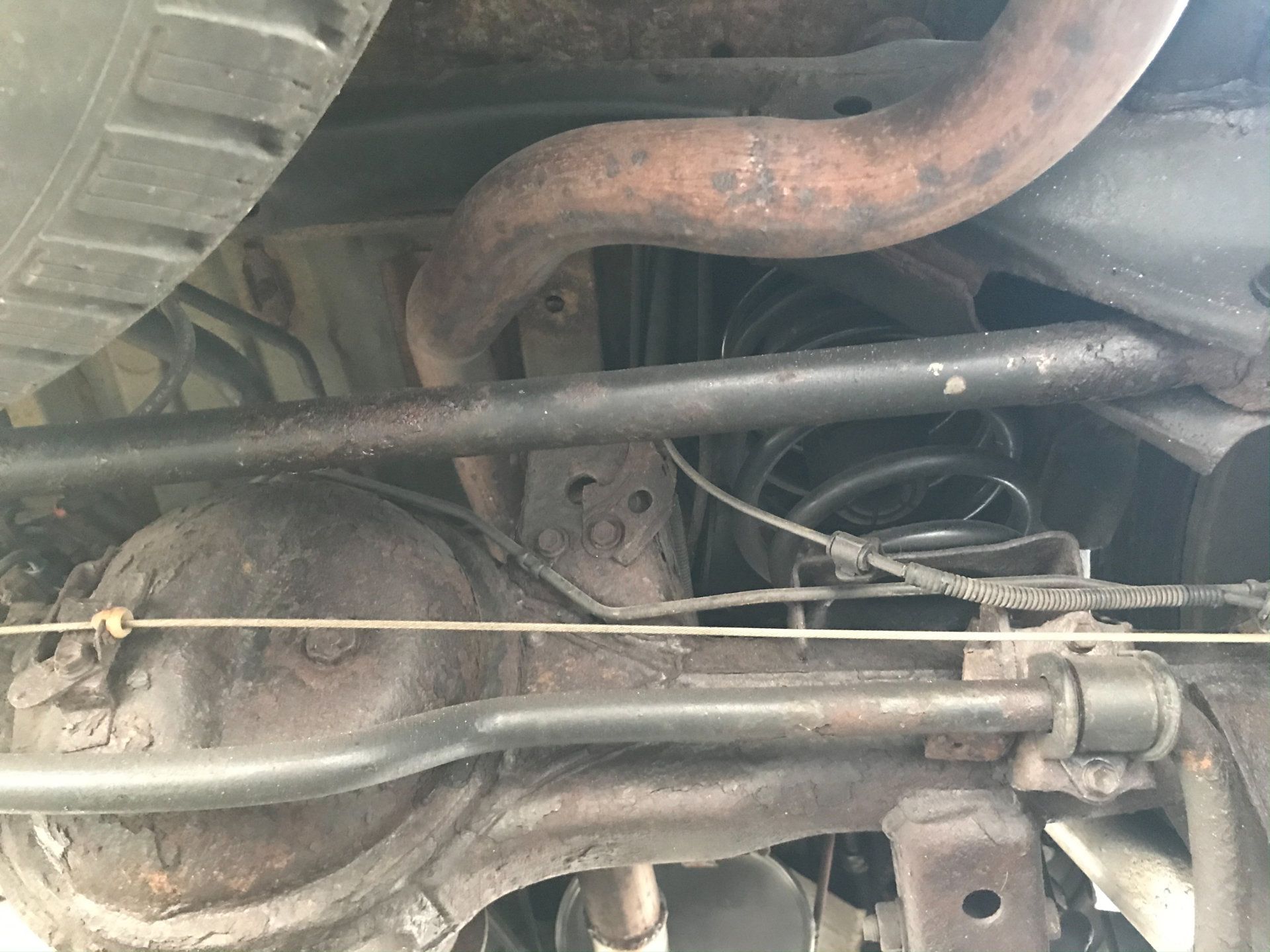

Hello! Hoping to get some opinions on the rust on this LX470. I am trying to find a reason to explain the low price of this vehicle. Low miles, amazing maintenance history, and very low price. The carfax shows three "very minor" damage incidents. No air bag deployments. Could that impact the selling price significantly?
I have just started my journey towards buying a LC and am taking my sweet time. This is the first I have looked at in person. I am looking at this vehicle as a test of my abilities to find "the one". I don't anticipate buying this vehicle. I am thinking the rust, plus three "minor" accidents explains the price.
Also looks like the airbags have already been deleted? If you happen to see any other issues, let me know!
Thanks for any insight!
