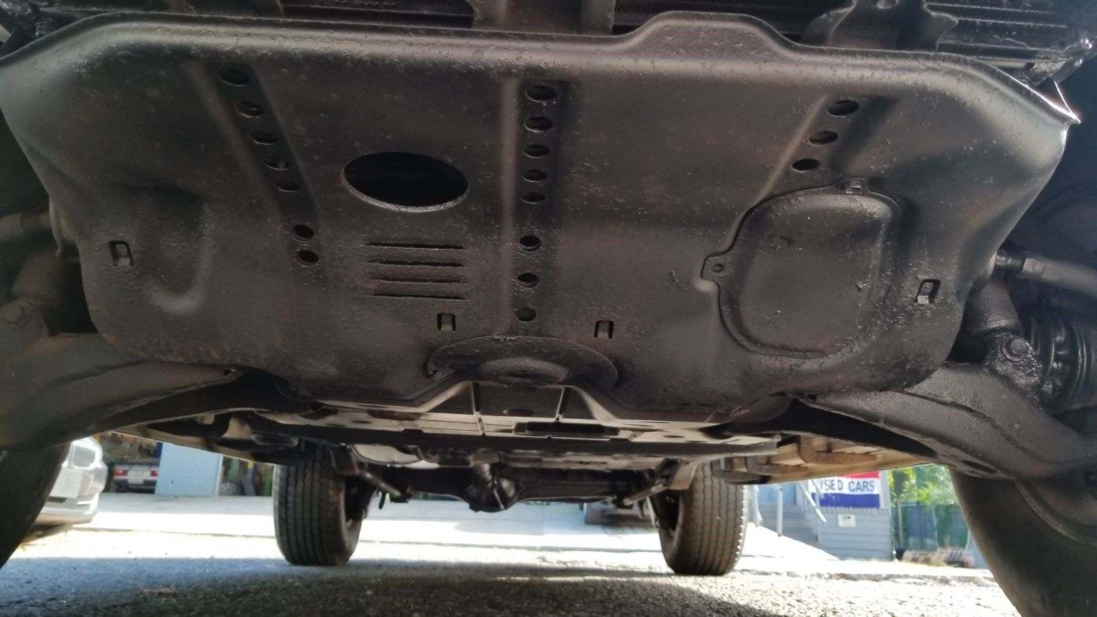

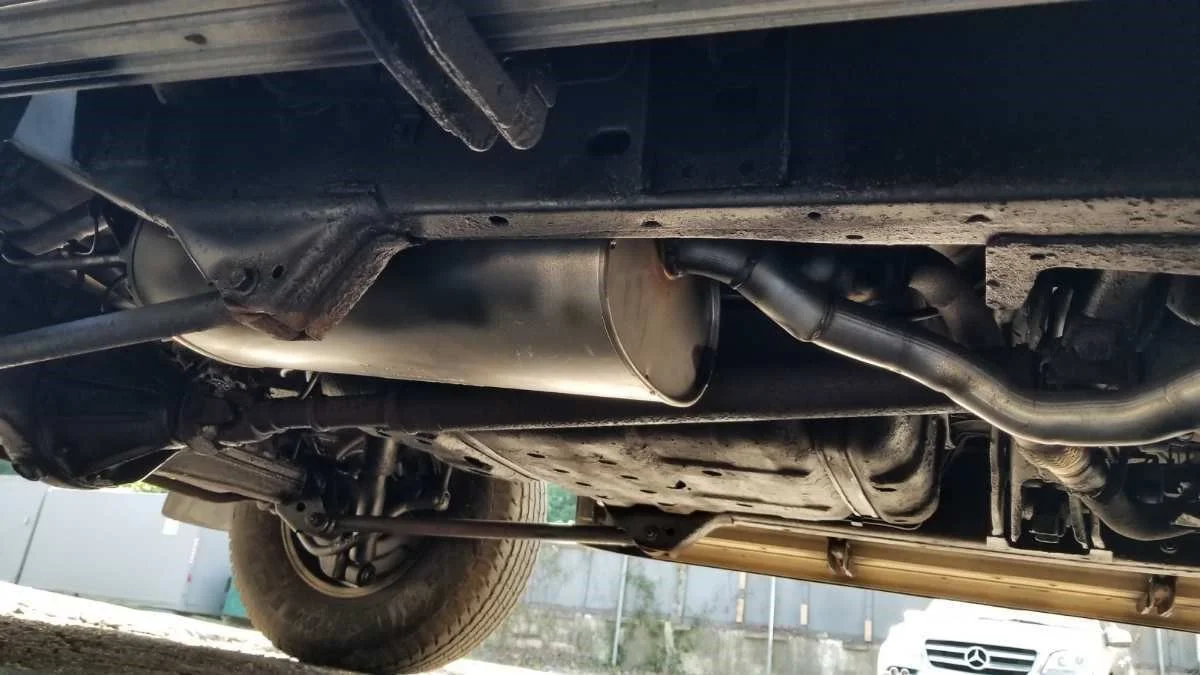

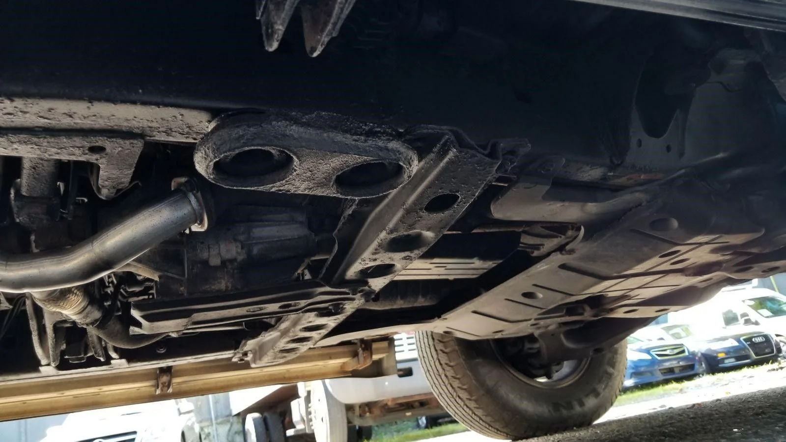

Would appreciate some input on this undercarriage. Currently shopping for a daily driver for my significant other. Looking at an early model LX that has very low miles, great asking price, and is my favorite color (green, which is quite rare). Despite living in NJ, I have bought all my cars from the South and the West, and preserve them with Fluid Film. Ih8rust and a biyearly application works surprisingly well.
This Cruiser seems to have a POR15 or similar coating applied liberally as well as a replaced exhaust. I don't have any experience working on trucks with this coating and scared of what I could uncover down the road (frame rusted through?). It seems like it had a ton of corrosion and was corrected, but the price, mileage and color are tempting...
What're your thoughts? Should I hold out for another rig?
