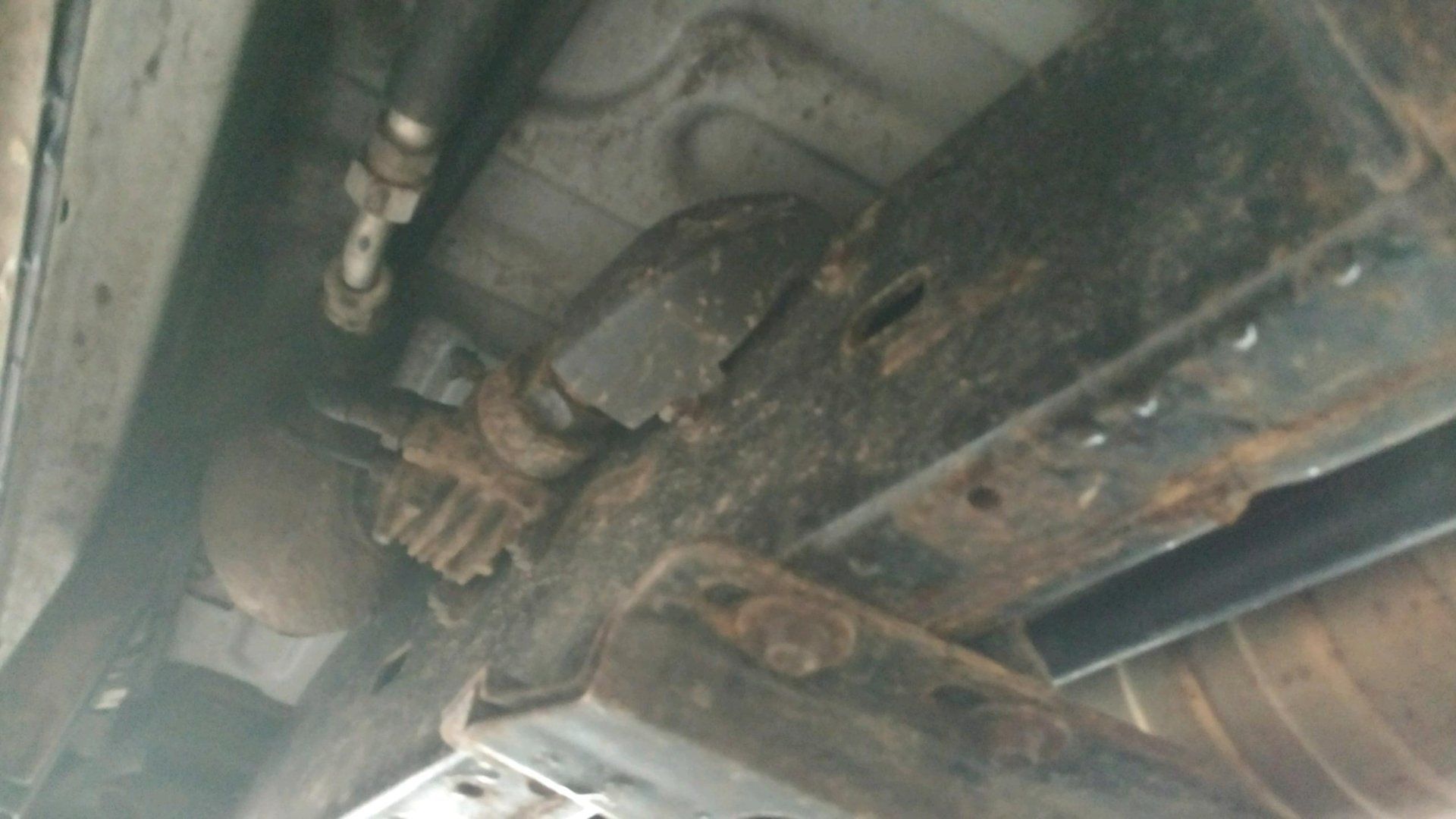

This looks amazing! So, I'm looking to purchase a 2005-2007 Lexus LX470. Currently, I'm looking at a 2005 with 95k miles - here are some photos of the undercarriage, how does it look to you guys? Should I walk away or it's not that bad?
My 05 LC with 158k looked like this when I bought it last April. It's not bad but I've snapped some bolts and I'm going to have to replace the fuel tank skid and front skid sooner than later. If I were to do it all over I'd consider flying out to get one with the least rust and drive it back.

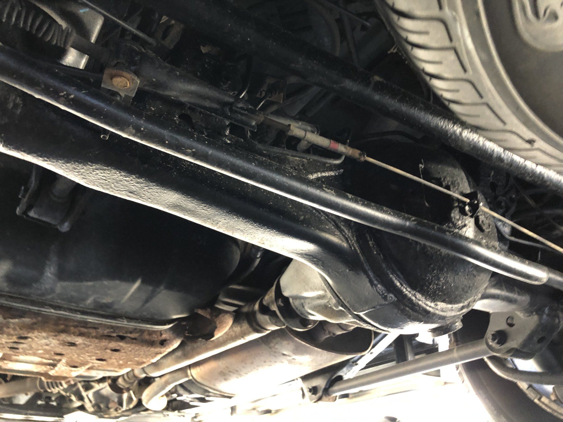

The only major rust I had on my 2003 LC (which lived in Vermont and Illinois before I bought it) was the Fuel Tank Skid Plate and the front skid. I found a wrecked LC on eBay and bought the Fuel Tank Skid Plate for $100 (see photos in my media library, was in great condition!). I cleaned it up and repainted it.
I haven’t started looking for the front skid yet, although that was in much better shape than my fuel tank skid.
Also, although my fuel tank skid looked terrible on the bottom (and the back 1/8 was completely gone), the top side was actually rust free. I might have been able to salvage it. I didn’t like the fact part of it was missing, though.
I’ve also scraped any surface rust and coated most of the bottom with some 3M rubberized undercoating.
3M 03584 Professional Grade Rubberized Undercoating - 16 oz. https://www.amazon.com/dp/B002H9CMCQ/ref=cm_sw_r_cp_api_i_FHE7AbKEY6SB1
In this pic you can see the coating, plus the original rusty fuel tank skid cover.
Hopefully this will help me extend the life of my truck, living in the Northeast.
