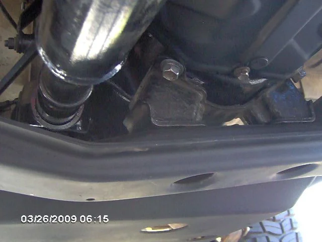

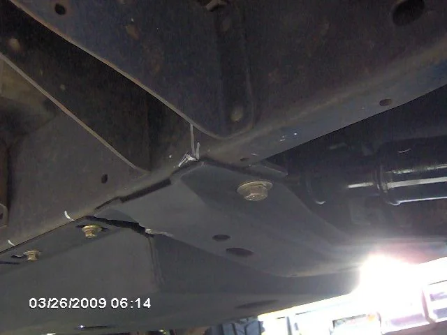

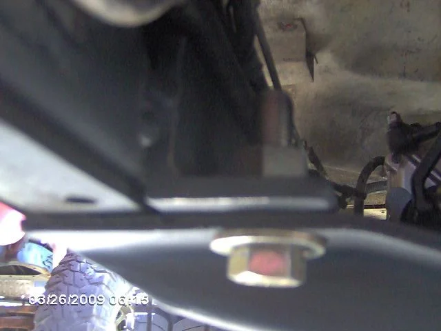

however, i finished a very similar conversion here at the shop a couple of months ago. i'm afraid i do not have any pics of the installed combo without the skid plate installed. here are a couple of pics of the completed job. this 40 has a body lift so it only required minimal tunnel mods.
georg @ valley hybrids
Is that a custom cross-member for the back of the H55F? Any additional pictures of that?
the x-member in the pics is a modified fj60 x-member; the later style. we shortened it and made new frame brackets out of angle iron. worked out really well. not as sano as some of the custom units we've done but we were on a budget and had the original x-member on hand.
