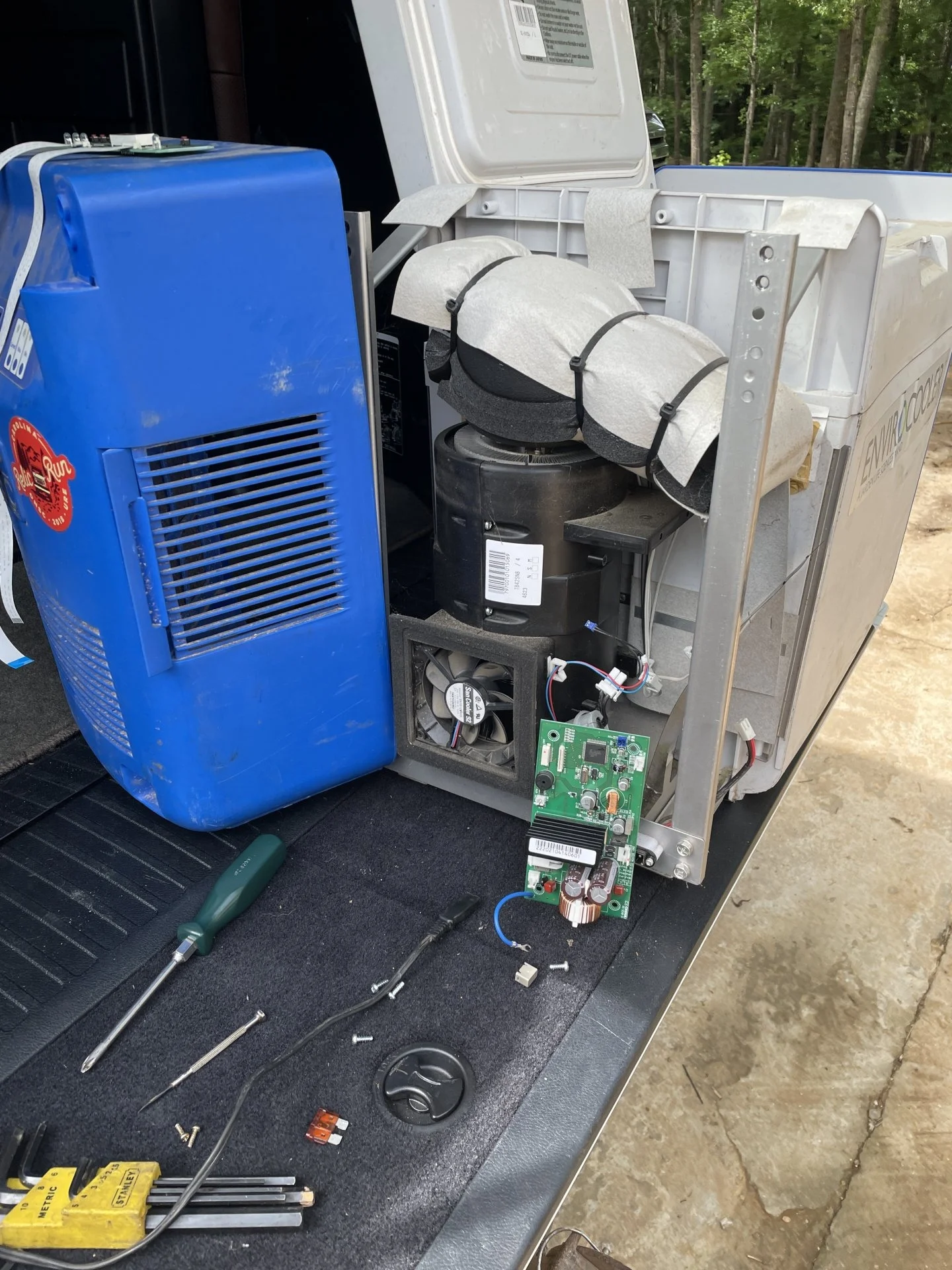

Well one of the Envirocoolers finally crapped out, glad I have a back up.

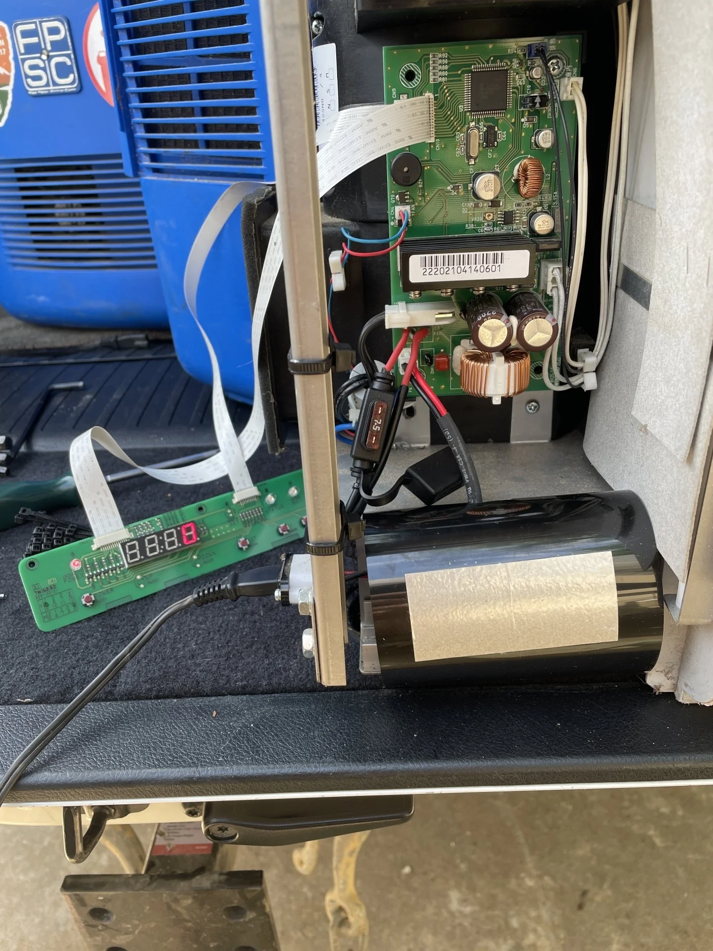

I was a little bummed at first, but then I remembered some guys had some issues with these when we first bought them. Found the problem…solved. #EnviroCoolerFuseMod
Wish I had bought two but mine is still going strong.

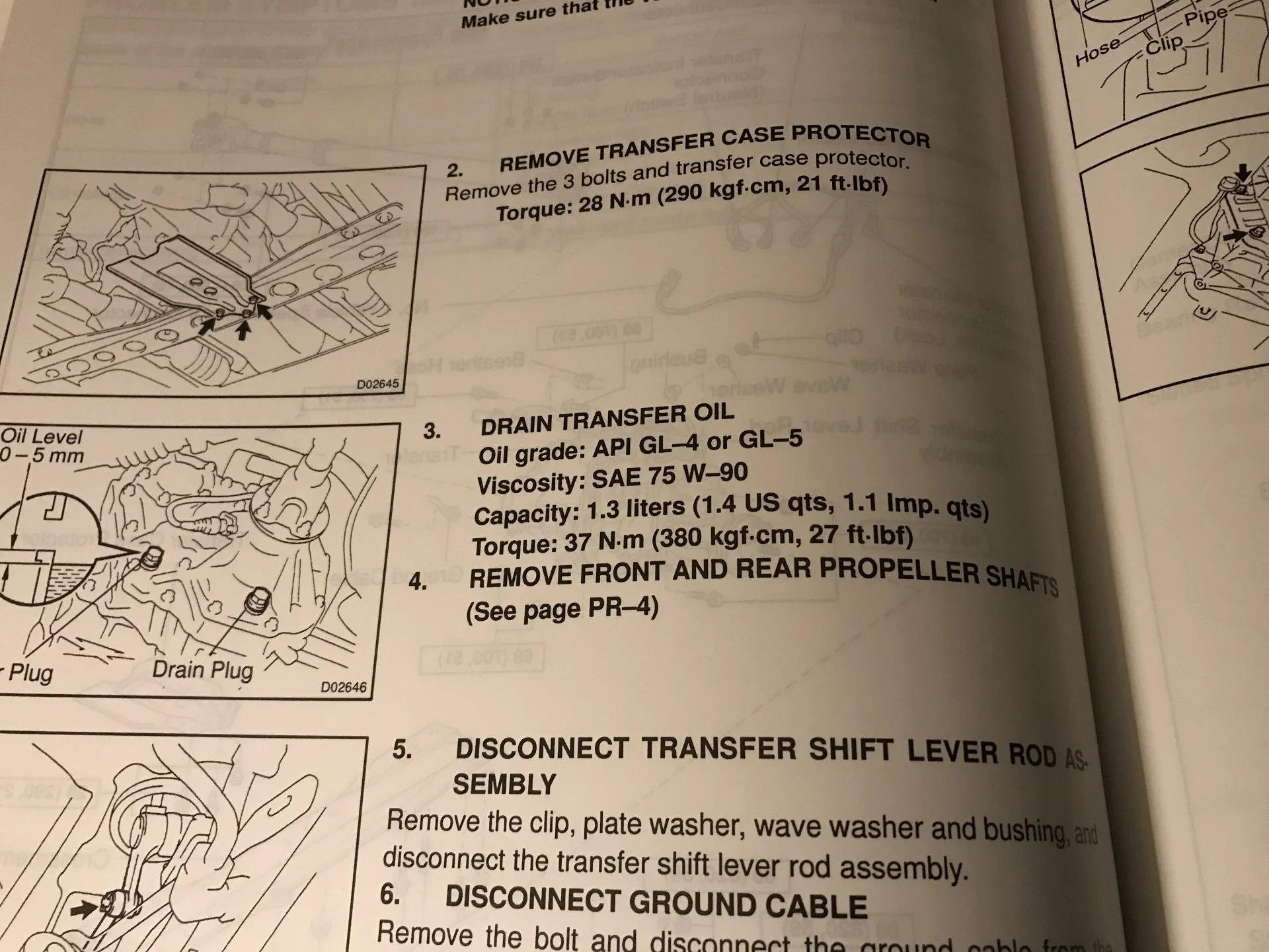

Forgive me if this is already posted somewhere but how much fluid typically goes into the front/rear differentials and transfer case? I can’t seem to find a figure anywhere online. Thanks y’all!
From the FSM for a 2000 TLC. Hope this helps. Typically, I don’t measure. I just fill until I can feel it similar to the diagram shown.
Here’s the transfer case
