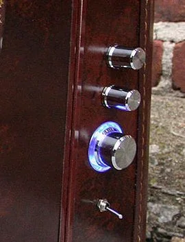

This was the inspiration. $$$$ :eek:
http://www.curiousprovisions.com/

So it looks like the expensive ones on that guy's site use the exact same $22 amp. The knobs are in the same config (even the blue led ring around the volume), but he moved the power switch and changed it to a metallic toggle switch.
