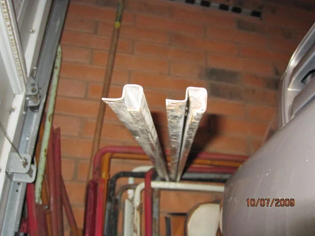

First picture is of a 62 soft top channel. Welded on channel. Sorry best picture I could get. It is stored away with the tub.
Second channels are the standard channel I'm use to seeing
attachment.php
Third is the channel that came with the 67 bows. This a bolt on channel but shaped like the weld on type:hhmm:
all three are OEM as far as I know.
Anybody else seen one like the one in picture three? Ocdbeetle 65 soft top's channel is like the second picture I posted:meh:

here is a pic of mine...oem windshield channel...it does have a bend on top...but 'box' area also goes down infront of the windshield frame.
I had noticed that Ehsans channel goes with the 'box' area ontop of the windshield frame
So what are these dimensions? I'd like to have some bent up this week.
I'm assuming they are 16ga roughly? Any drawbacks in the design?
i would say yes about 16ga.
the major drawback is the ends...if they sloped down the ends i think would be better.
the sharp ends over time wear into and thru the top...the ends of my canvas are double layered and are starting to poke thru after 5 years of DD new england weather.
my old kaylines lasted about 2 years and in 3-4 would be fully ripped in the corners.

It looks to me from your picture that you want the channel to curve to the front?!? Is that right?
the corners to curve down...but i may just try a piece of door edging...that was a good idea
We can make the channel any way that works best. If a curve down at the ends is desired, let's do it!!
