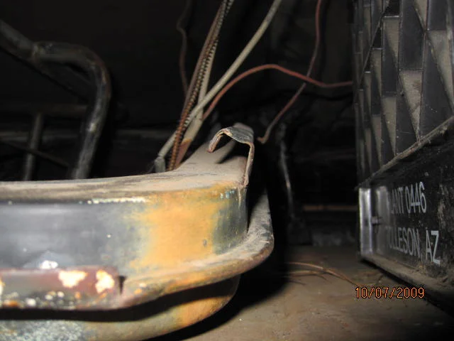

First picture is of a 62 soft top channel. Welded on channel. Sorry best picture I could get. It is stored away with the tub.
Second channels are the standard channel I'm use to seeing
Third is the channel that came with the 67 bows. This a bolt on channel but shaped like the weld on type:hhmm:
all three are OEM as far as I know.
Anybody else seen one like the one in picture three? Ocdbeetle 65 soft top's channel is like the second picture I posted:meh:
