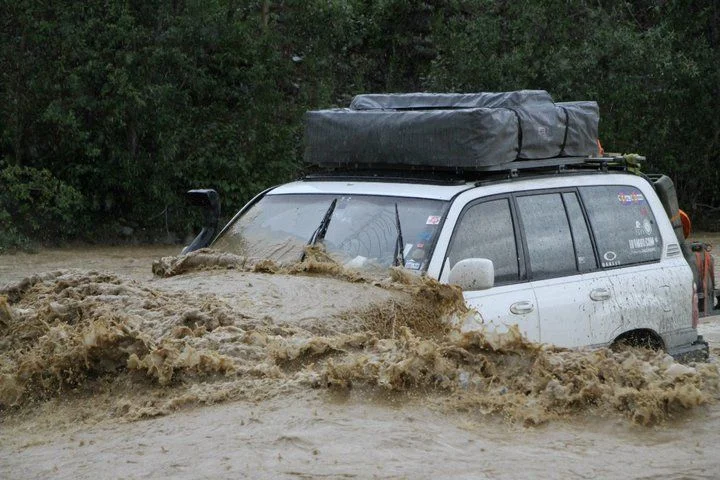

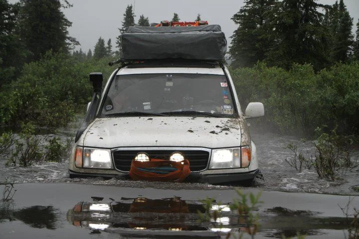

Final made it back to Houston, what a three week adventure. I was rough on the rig but it got me home, KM2 went flat with a side wall puncture, a drive shaft issues, starter finally died, but in my drive way. HID headlights went out, here are some of the pictures, more to follow.
reason to avoid HID .. about the starter could be considered as " normal " wear and failure after that amount of water .. a bit complicated with automatic tranny .. but glad you made home !
keep the pics comming !
Awesome. Worth an alternator and a starter for sure!
How did the rear axle seals hold up to all that water?
