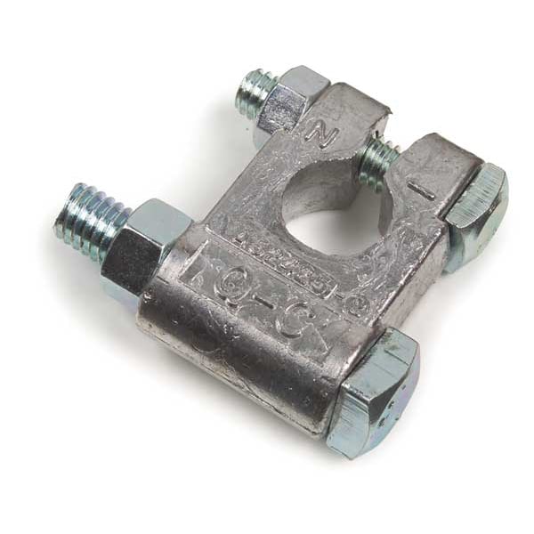

While I was in there, I installed new battery terminals.
Where'd you get the terminals? Those I like.
As with Amazon the 4 post terminals are no longer listed.
I actually bought 3 sets of terminals. This was the only pair that worked well with the 24F battery posts. The others were too long to fit between the battery posts and the battery tray.
I plan on installing the same terminals on my house battery if I can find them again.
