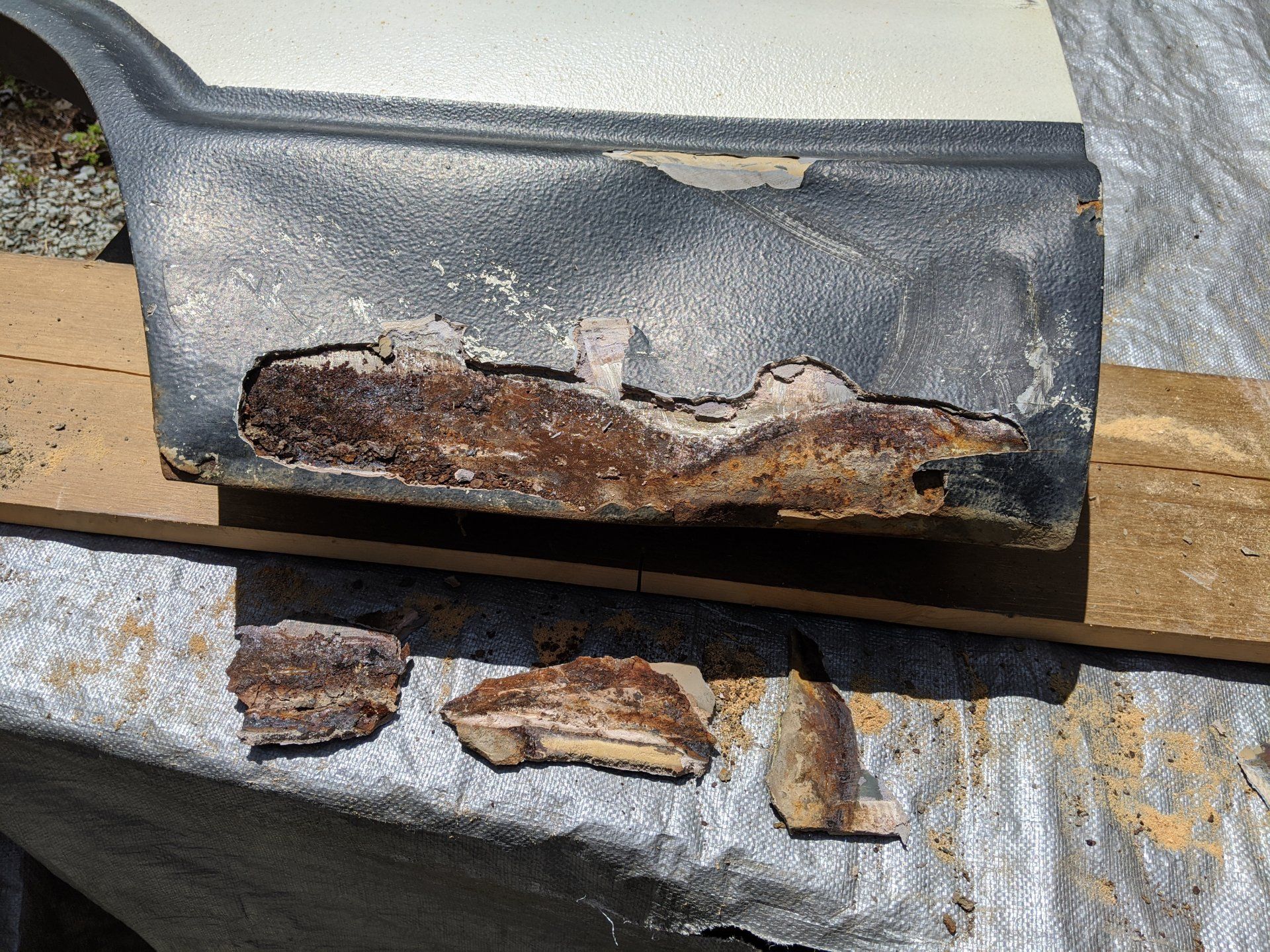

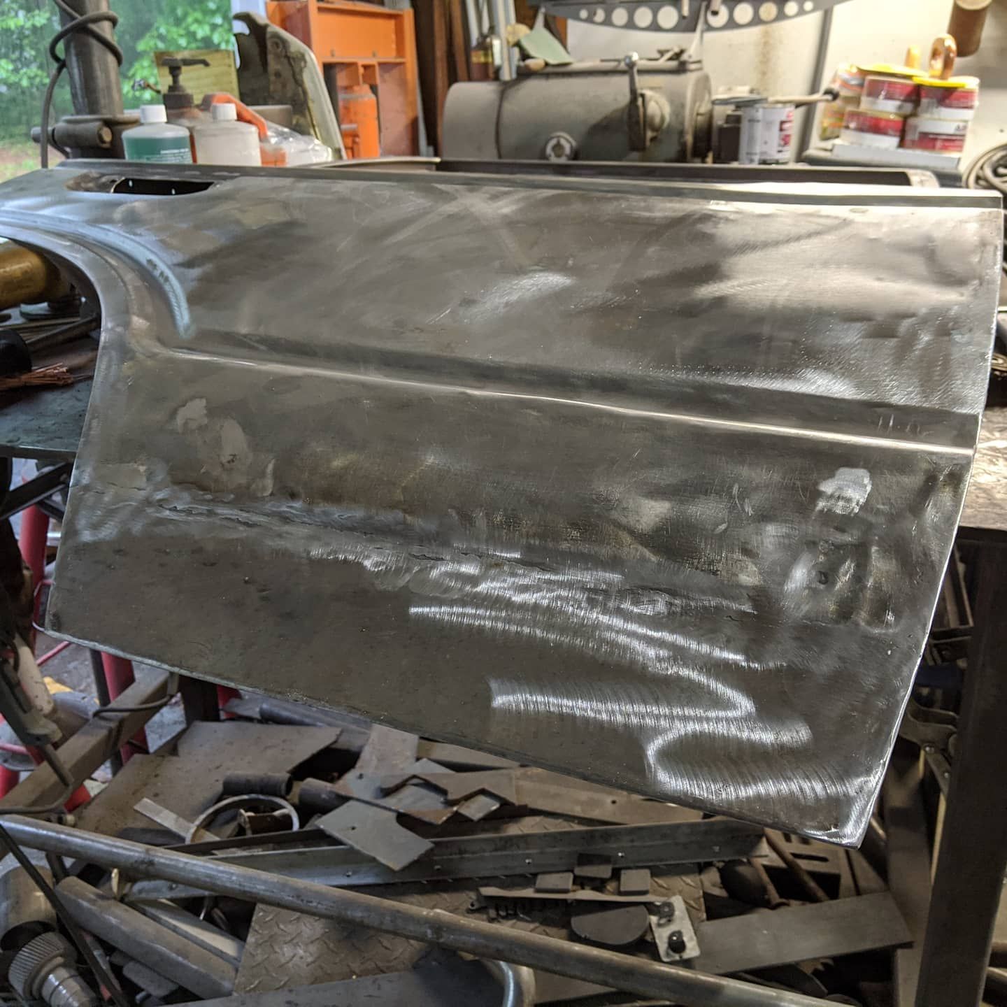

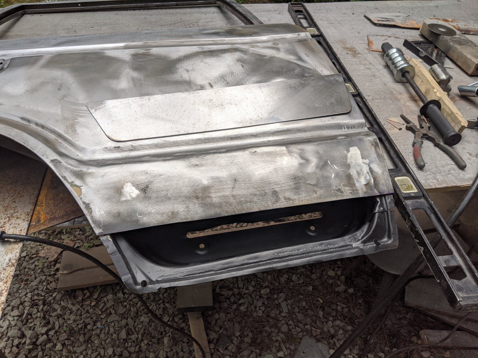

Continuing with the rust repair. Ps rear door. Love rot hidden by bondo!
Much better now.

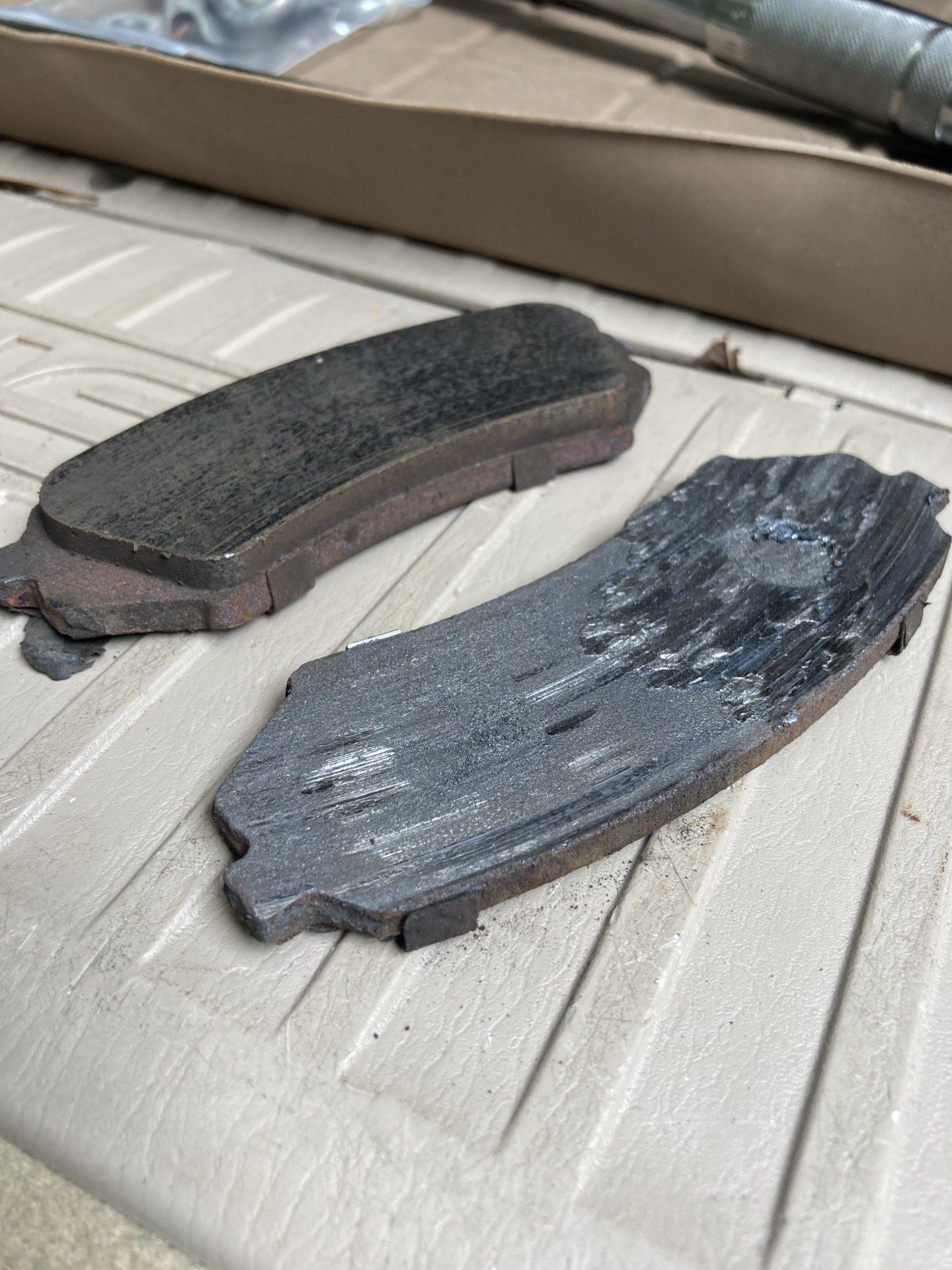

Question for the masses: Because of the above problem, should I be concerned about bearings/grease on that corner? The only things I know is that there was no grinding noise when Sarah left last week but it started at some point on her 400 round trip, the pad is gone, and the inside face of the rotor feels like corduroy. Pic below is outer & inner pads from that corner.

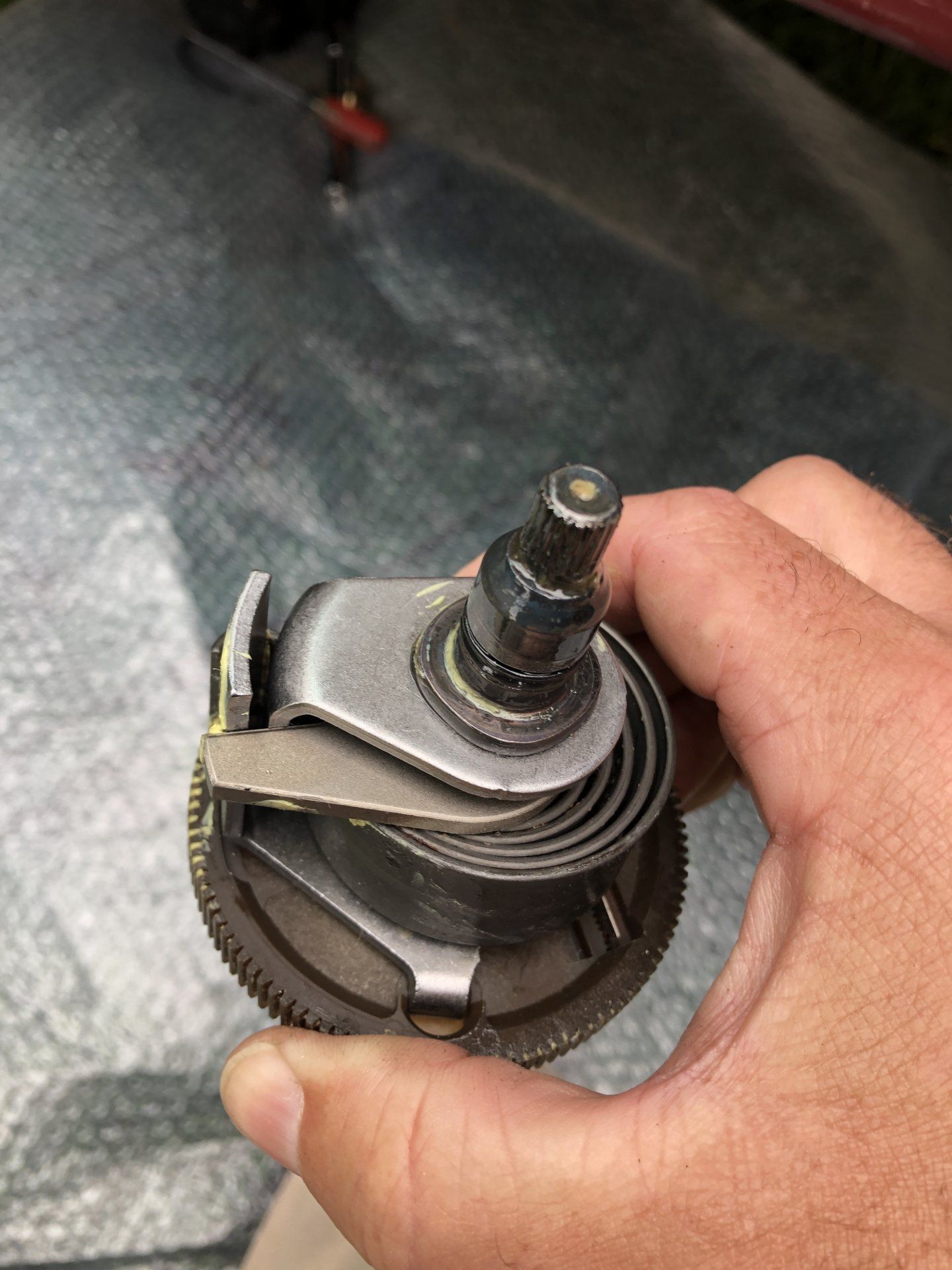

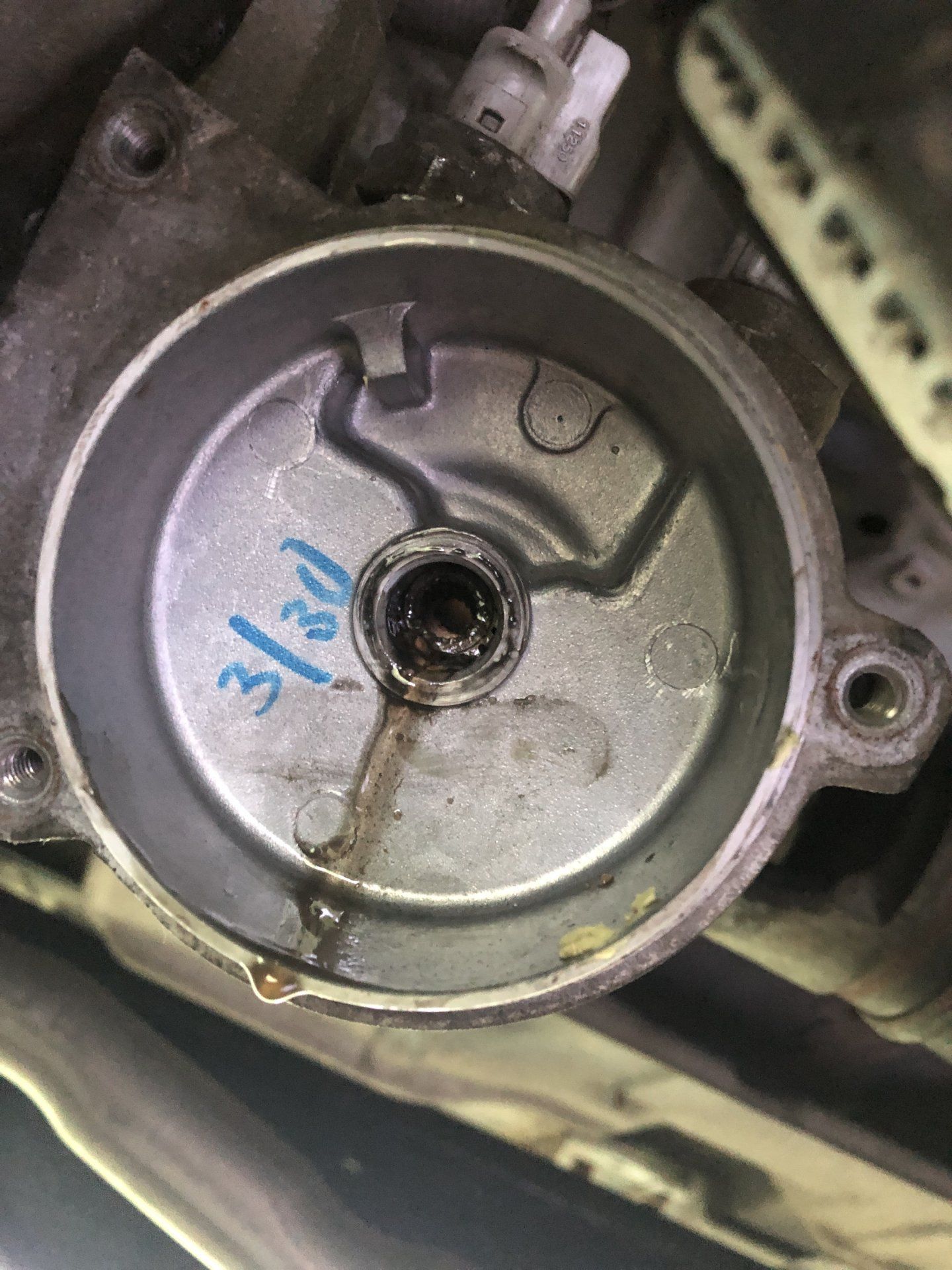

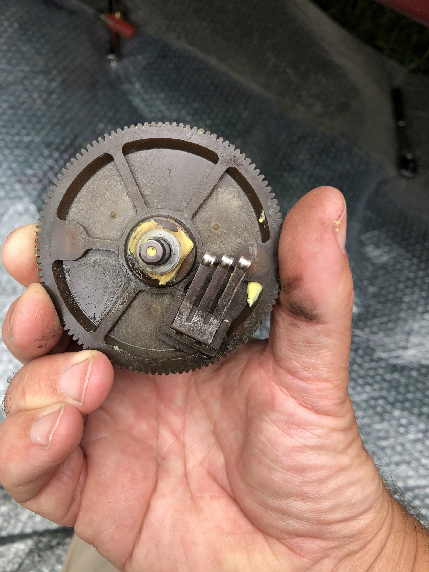

Working on my 2001 Tundra Access Cab. Blinking 4wd light on dash when I press the 4wd button. Thought I would just clean up the contacts on the actuator on the transfer case housing assembly. The large plastic gear plopped out when I took the black plastic housing of. Any ideas on how to properly align the large Plastic gear inside the transfer case assembly?
Definitely time to check bearings.
Just a guess, but it looks like it only goes in one way. The spring retainer fits into the recess in the housing.
Final color going to be stock or painting the whole truck something else?? Looks PHENOMENAL!!
Thanks! Primer is showing me where I need more hammer and dolly work, but she'll get there.
Color will be stock 033 white.
I would not be too concerned about bearings.
If those are OEM pads I recall there is no wear tab for the rear. As for the wear it sounds like you got it covered. Heavy wear on only one pad largely points to slider pins. As I've preached before, make sure they are smooth and use only synthetic caliper grease.
@GLTHFJ60 the stock white is going to look incredible. You sure are putting those new hammers to good use. Sorry about all the bondo.
slide pin in the transfer case of my Tundra needs to be all the way forward to make the transfer case operational. Your guess was correct on orientation. Also, after the transmission was replaced, the guy with over forty years of experience must have had a senior moment because the front axle actuator was unplugged. Good help IS getting harder to find.
