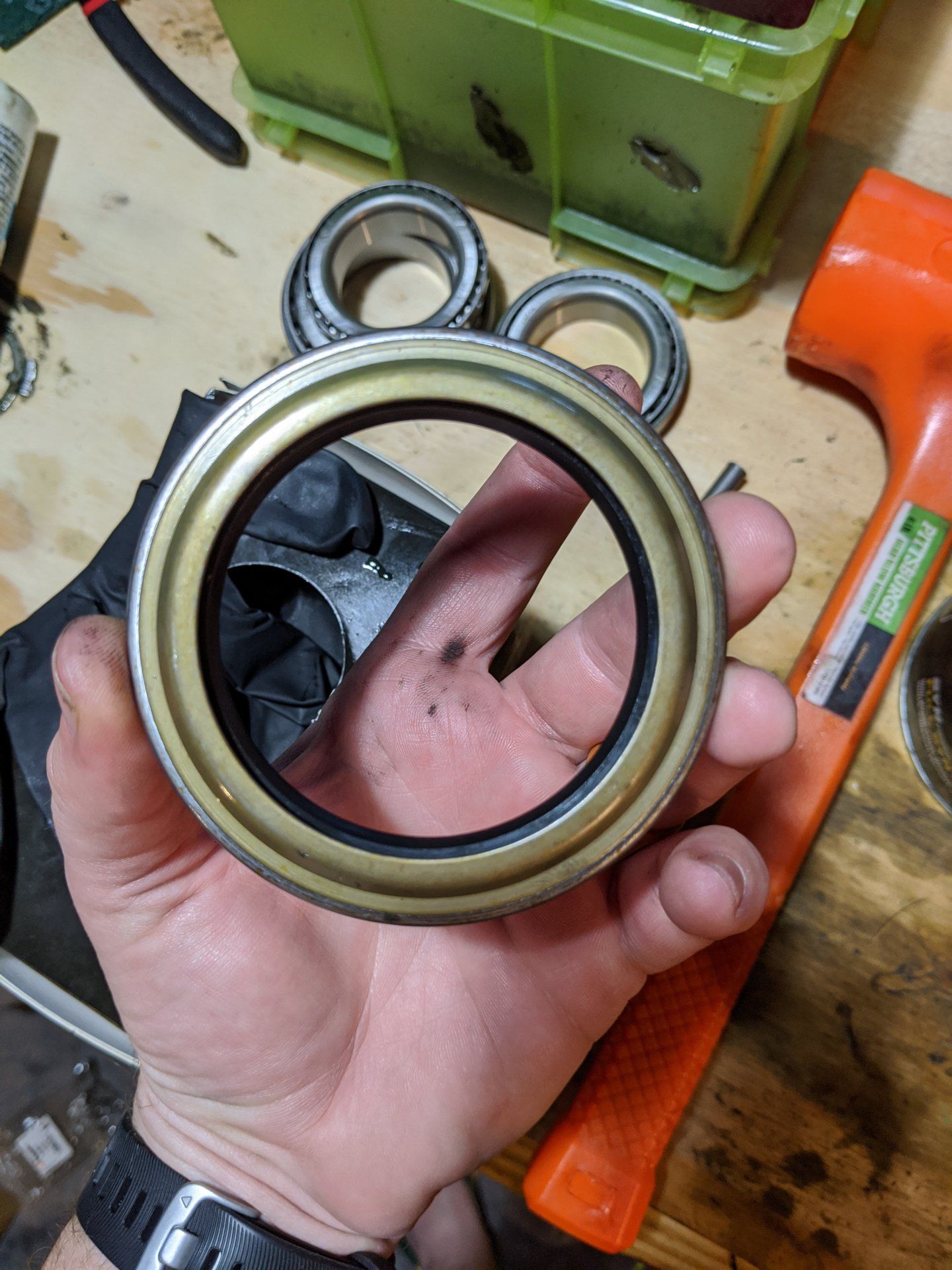

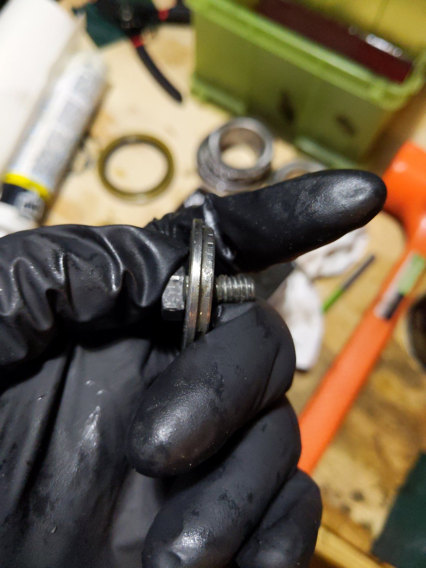

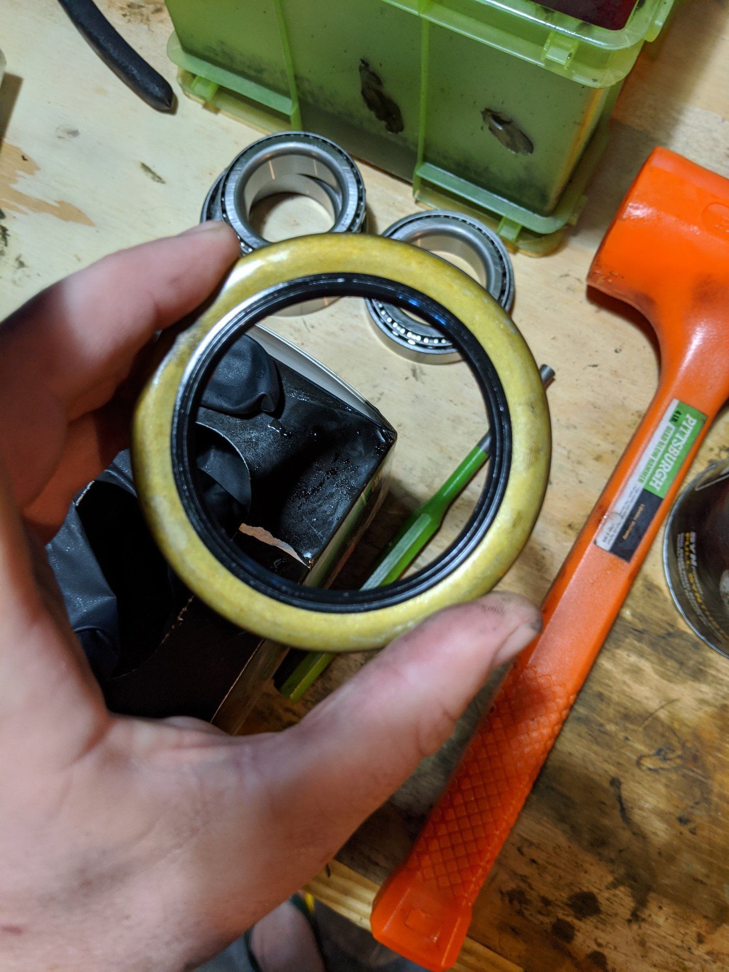

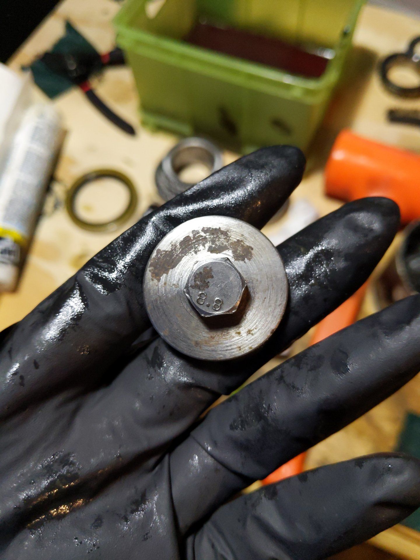

Two quick questions 1) can someone advise me which side of this wheel bearing oil seal faces the bearing? I've looked and can't seem to find the answer. 2) I was expecting a snap ring to be holding the hub on to the axle but it was a screw with a cap, see photo 3. Any idea what the torque should be on this? I don't know what it's called and the only fsm I found shows it being a snap ring.
Your first pic of the seal faces the bearing.
That bolt and two washers is not stock or at least nothing I’ve ever seen. My guess is someone used that instead of a snap ring to make whatever hubs and birfs ‘work’.
Warn selectable hubs use a bolt and washer arrangement to locate the birfield. Aisin selectable hubs do not, and of course neither do drive flanges.
