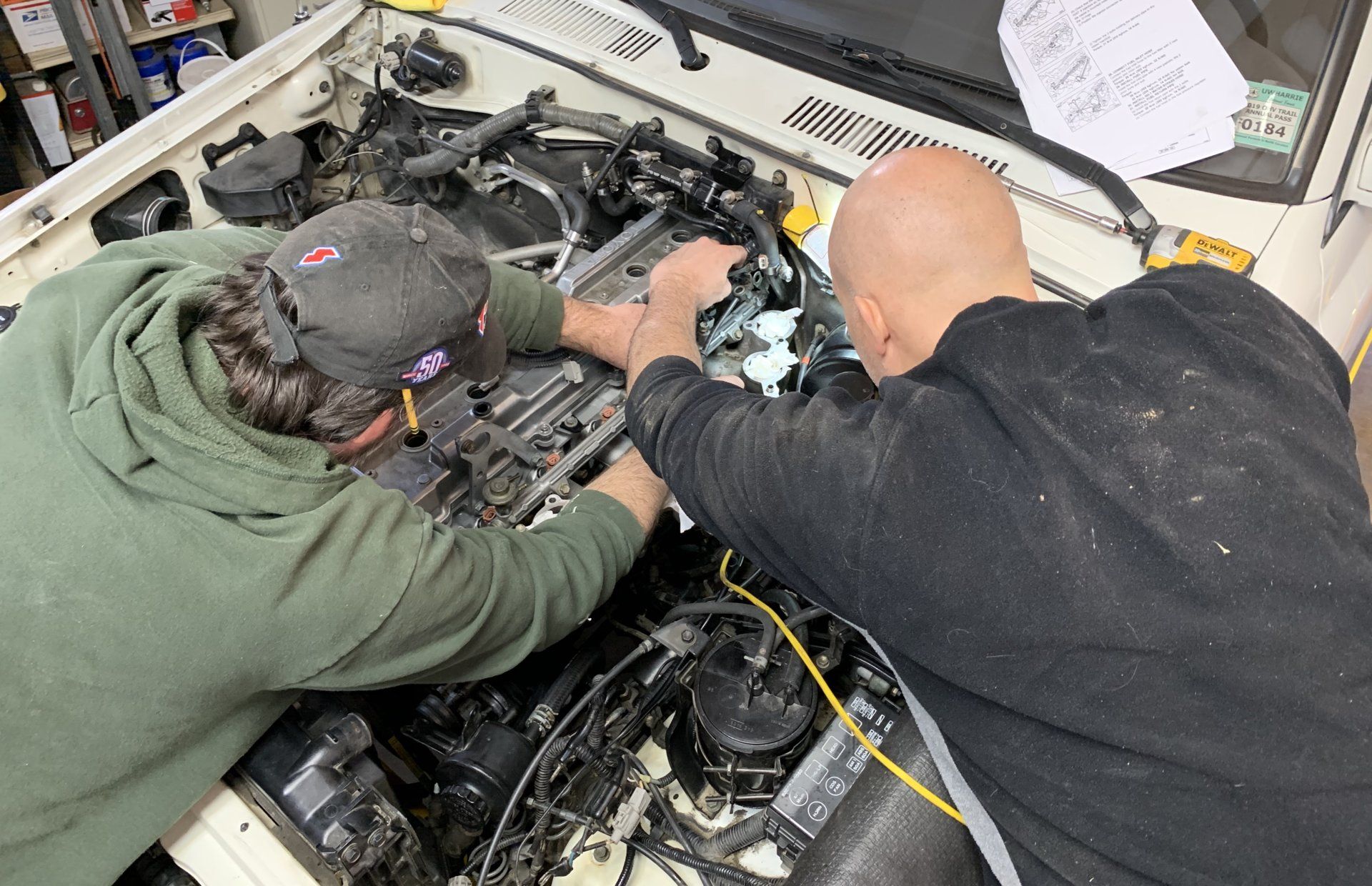

There’s lots of fun to be had at Dave’s today! Every once in awhile Rafael and Shaun even let Dave help.

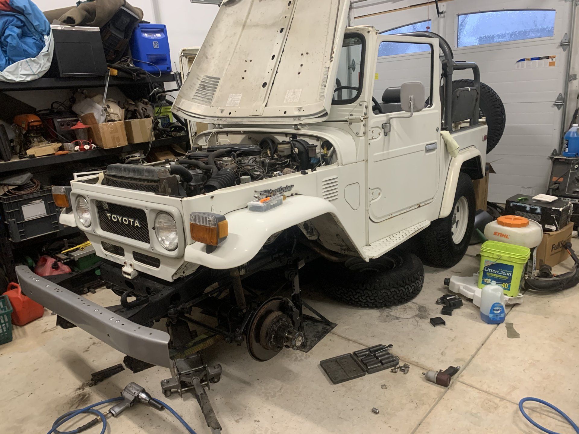

I started a lift install on my 1983 fj40. Dobinson 2.5 in lift thanks to @Payara Offroad for supplying the lift and arrange delivery.
Anytime!! let me know if you need something else.

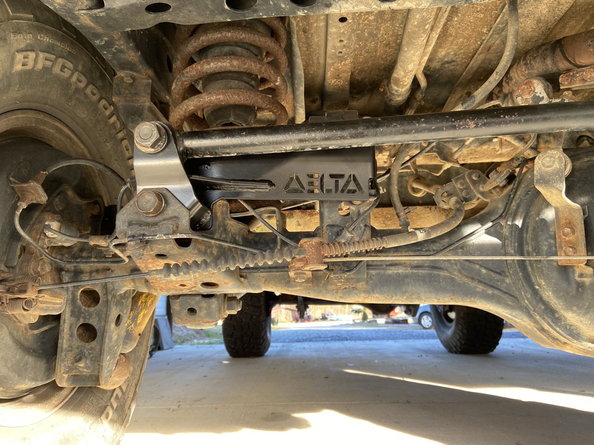

Installed @Delta VS panhard bracket this afternoon. Hadn’t had a chance for a drive yet but looking forward to the results.
Iirc it's designed to work with the factory panhard rod.
Yep. Designed for use with Factory pan hard. Bracket helps recenter axle and get panhard closer to parallel to ground like a stock setup would be.
I need to pull caster numbers again with plates but I had become less thrilled with the highway wandering and constant correction inputs needed. It became much more noticeable after taking a break from DDing the 80 and getting back behind the wheel for some long drives.
Let us know how much difference the bracket makes. Interested in maybe purchasing.
will do. I believe @fourtrax has had one installed for a good while now. Not sure how much he’s been allowed to drive his own truck :lol: but probably has some good feedback.
It is one of the top 10 mods. True that, Not much driving time but, it works well. Had been waiting for someone make one since I got the cruiser.
