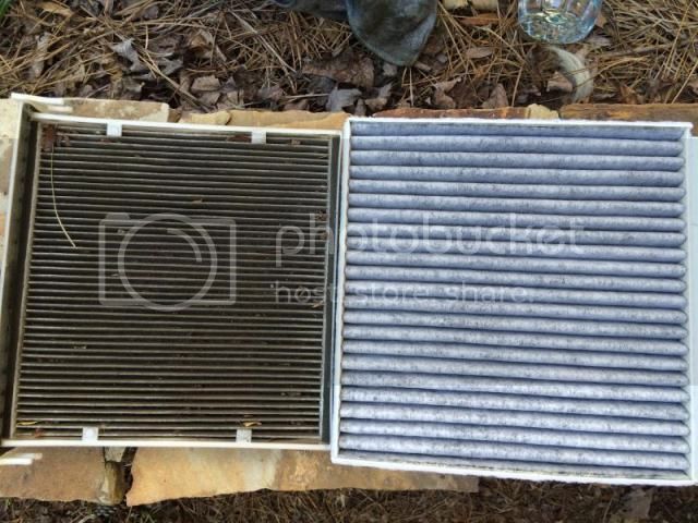

Service done this weekend:
Oil Change
Third Row seats Removed
Cabin Air Filter Replacement
Tire Rotation
