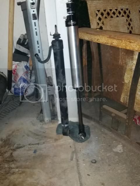

Finally I can get started on the lift. The parts look so nice they could go in a glass case. I will always run Radflo and looking forward to trying this setup out. 2.5" extended travel front and rear.

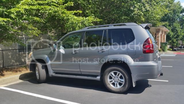

We were finally able to get the lift put on the Lexus after a few hangups and such. I've never had to fool with air bags when doing a lift before so it look a little longer than expected after sorting everything out. I am more than happy with the lift and the ride quality of the parts. The truck has about 3/4" rake on it with the 3.5" Lift FJ coils. The running boards have been removed and the passenger side damaged ABS wire was cut out with a new one spliced in.
Now I'm just waiting for the SCS container to come in with my SC8 wheels so I can buy tires. After I get the tires on and see where I am rubbing I may run a 1" Body lift but still in the air about it until I get it on the trail and see how it does when it's legs are stretched.
looking great man, what kind of hiccups did you run in with the rear? did you cut the air bag lines?
Nothing too troublesome, it was just mostly what we should/ needed to take out with the air bags. I noticed what I believed to be the height sensors have barackets on them that have to be bent or removed so they dont rub on anything once the lfit is in. You'll see a hose running to both bags that you simply just pull from the top of the bags so no cutting needed. There's just a lot of junk you wont need anymore thats a pain to work around. Everything had an additional step or two compared to the other 120's I've lifted. You only have to pull two fuses which was simple thanks to some interweb searching.
So did you remove much of the airbag related stuff? I have a prado grande (same as the lexus, but with the 1GR and I recently completed the coil conversion on mine. Just wondering if it's worth the effort to remove the compressor, the sensors and all that stuff.
We removed the sensors and anything that may get in the way of articulation with the new setup. At the very least take the sensors out. As time allows I'll look into the lines and compressor but they don't cause any issues being there.
