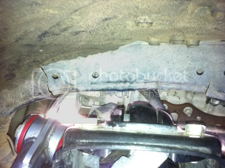

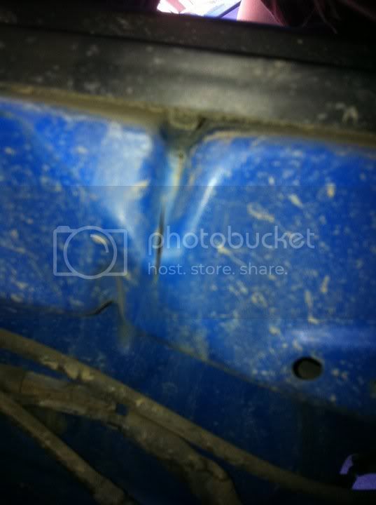

I think this is the first I've seen of this...how did you fracture the body by the UCA and engine also? Did it happen jumping it in the sand?
The overseas Prado guys were the first to report this kind of fender damage and the prado and FJs share the same inner fender. The 07-09 FJs had the weakest inner fenders and you could tell Toyota knew about it since the 2010 and up FJs came with a reinforcement brace on the inner fender making them stronger. The damage came from the wheels bottoming out and the top of the tire hitting the bottom of the inner fender causing stress cracks. I jumped my FJ once or twice but not a lot due to damage I've seen from other people, this is just from offroading/ bottoming out in dirt and sand.

Funny thing is my first fender bulge started even before I started going to Pismo sand dunes, it was just from trails here and there and desert whoops, here you can see where my tire rubbed on the fender at full stuff (I do have extended travel Icons):
