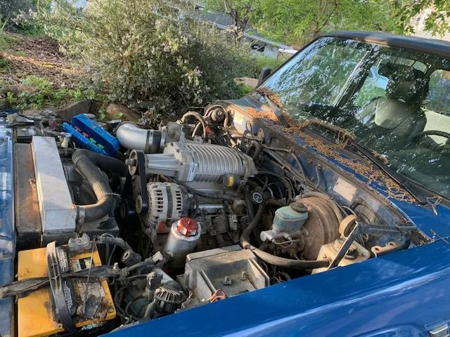

What I'm looking for, right now, is advice on what I need to keep from the 60 as I part it out. I've got a really nice T100 booster and master cylinder - keep or sell? Steering column - keep or sell? Radiator - keep or sell? Anything else I should be thinking about as I tear down the 60?

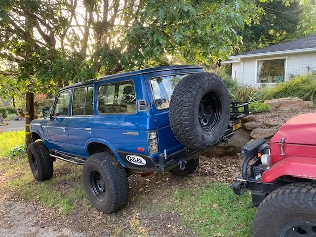

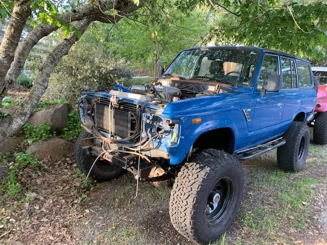

Okay, pics coming soon.
I think I know what the 60 body looks like...it's a CA rust free shell with minimal damage right?
Pictures
Oh its that one. I was hoping I would get the circumstances to swoop in and buy that one. A shame to tear it down I think. But anyway sounds like your mind is set. The steering column can be kept but I've always kind of thought a fj60 column looks kind of clunky in a 40. The booster and master should fit. Radiator would be a very tight fit but may work.​
