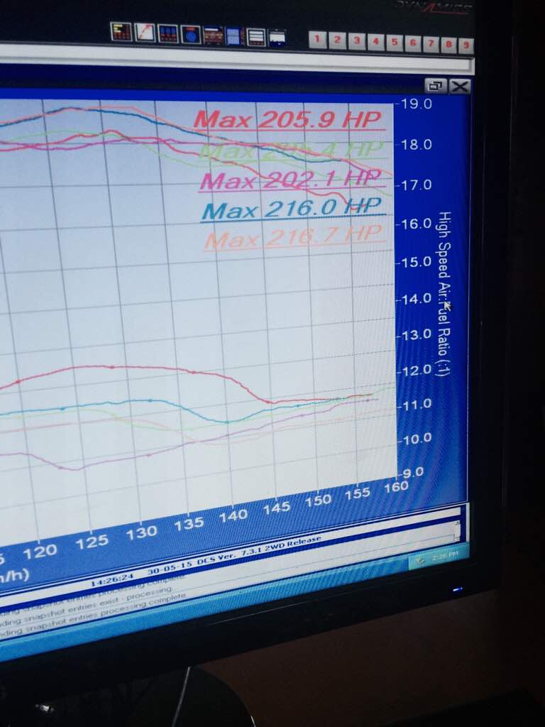

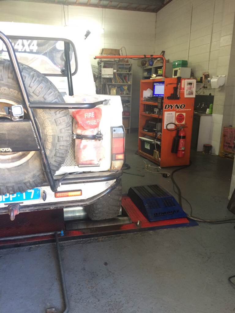

Put it on the dyno yesterday and am pretty happy with how it went. Had a issue halfway through tuning which was the factory fuel reg s***ting itself. Fixed it with a turbosmart reg and kept going
The new power comes on nice and hard which is impressive.
I have the new knock link G4 wired up so Il be able to catch any detonation when it happens

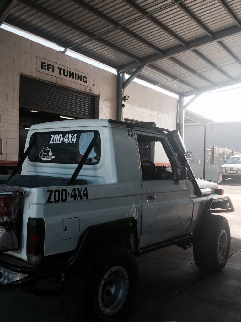

Retuned making 225hp at the wheels, comes on hard and cannot get enough of it. Few small issues I've had that I'm in the process of changing but with work and a few other things it's taken longer than it should. The standard exhaust gasket keeps blowing out from the heat so I've had a custom 3 layer steel gasket made and mounting it all up this weekend so should be back running properly shortly
I have a set of OEM exhaust manifolds...
So how many miles on the new turbo now? 225 is awesome. That's like 300 at the crank. What's the torque?
Hey mate, it's done about 15000kms, still going strong.
Torque came in a 520nms at peak power at 3200rpm.
