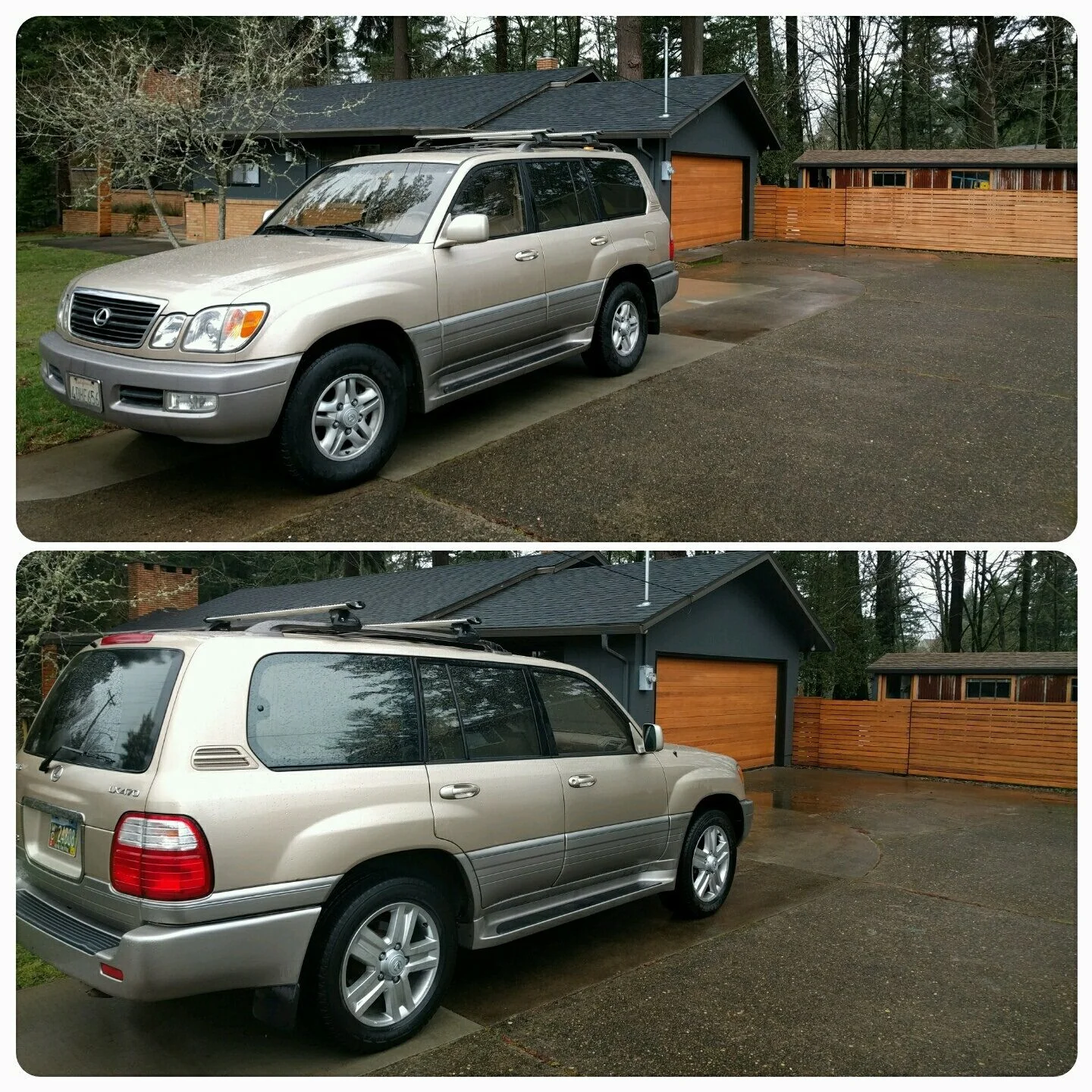

After reading tons of posts on here and other sites I decided to throw a set of 2010 Tundra 20's on my 99 LX. Tires are 255/75/20. Bolted right up and surprisingly my stock center caps snapped right in without the need for any altering. The car drives considerably better with less roll and IMO looks considerably better. Complete stereo upgrade coming in a couple of weeks.

Here the 07 18" Tundra wheels with 07 LC hub cap. Color off a bit and they fit a little loose. I thought these hub caps would work on 2017 wheel but they to large to snap in.
I could modify the inner ring that holds/snaps in the wheel. But then I'm giving up my 07LC wheel's matching cap. Something I rather not do.
These are on this 07LC because it came with snow tires on the stock wheel, and I had a Tundra set lying around. Help's me test handling and road sounds before I getting into base-lining front end.
How many miles do have with that set up? How's tread wear pattern on tires?
Almost 20k miles with this setup, zero issues. Tires are wearing evenly, ride is exactly as it was before I added the spacers.
