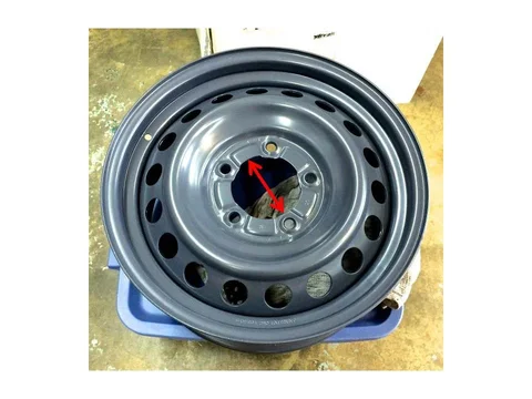

b3a5t... Which model Tundra wheel did you find didn't fit? That link is broken. Thanks!
@Manhattan
Heres a pic, I dont know the model but you can differentiate from others bc they are flat and have "dimples" furthermore the space for the hub is small (you can see the hub cap)
Whew. Thanks B3A5T. I've got this anxiety that, after all the effort to find a set of the 18" Tundra steel wheels - with the holes, not the 5-point start... having them media blasted, powder coated... I'd discover they don't fit for some reason. They're back in the box, tucked away in the attic - waiting for the current BFGs to wear out. I'm going to swap wheels when it's time for tires again.
Side note, the powder coat supplier was great - sent a bunch of sample color on thin aluminum plates. This lets you test the colors in various lighting conditions. The flexible sample plates let you look at them flat, curved, etc. I picked a color that matches one of the 4 grays in the trim and, like the paint on the body, the powder looks different in different light...
@Manhattan
Those look great! Those for sure will fit.
For future reference to those looking at doing this check out the size where the hub meets the rim, it should be as large as the ones Manhattan posted. Anything less in diameter will not fit the front.

Hi B3A5T,
Thank you for the very useful info you've shared. I'm sure a lot of members will benefit from your responses.
Just a question, were you referring to this when you were talking about "where the hub meets the rim"?
I know this is not the flat rim and has a different hub, but I just wanted to make sure before I make my purchase. RIM1.webp Rim2.webp Will this rim model fit? Thanks
The Tundra Alloy rim on the picture to the right (with tire)...will definitely fit. There's a picture somewhere around here with a black '99(?) LC with those on it and it looked pretty good. What he meant by 'where the hub meets the rim', is that the front wheel hub (on the end of the axle, dust cap, bearings cover, etc.) -- that 'hub' extends farther out than on the Tundra, and the diameter of the rim has to fit around that hub. So if the hole in the diameter of the rims is only 2 inches - it won't work. The center hole in the OEM 05 LC is about 4". (btw, rear axle is not a problem).

Hi B3A5T,
I know this is not the flat rim and has a different hub, but I just wanted to make sure before I make my purchase. View attachment 947696 View attachment 947698 Will this rim model fit? Thanks
Hi,
Well what I meant is the hub size (I think that's the name for it apologies of it's not). You see the size of the circumference inside the lug nuts in the steel wheel? You want the same diameter, anything smaller will not work. I'm not familiar with the model wheel you want to buy but if you take the hub cap off and the diameter is the same as in the steel wheel you are good. Come to think of it, those look like the ones I bought so it should work.
Hope I made sense.
Stay away from:
Here's the model I bought
You will need to cut the hub or use like this:
