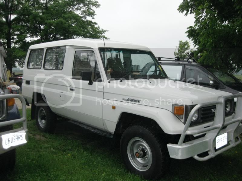

well that's the before at least, lol. hope you don't mind Wayne, found this pic from way back.
can't wait to see the after transformation shots!!
