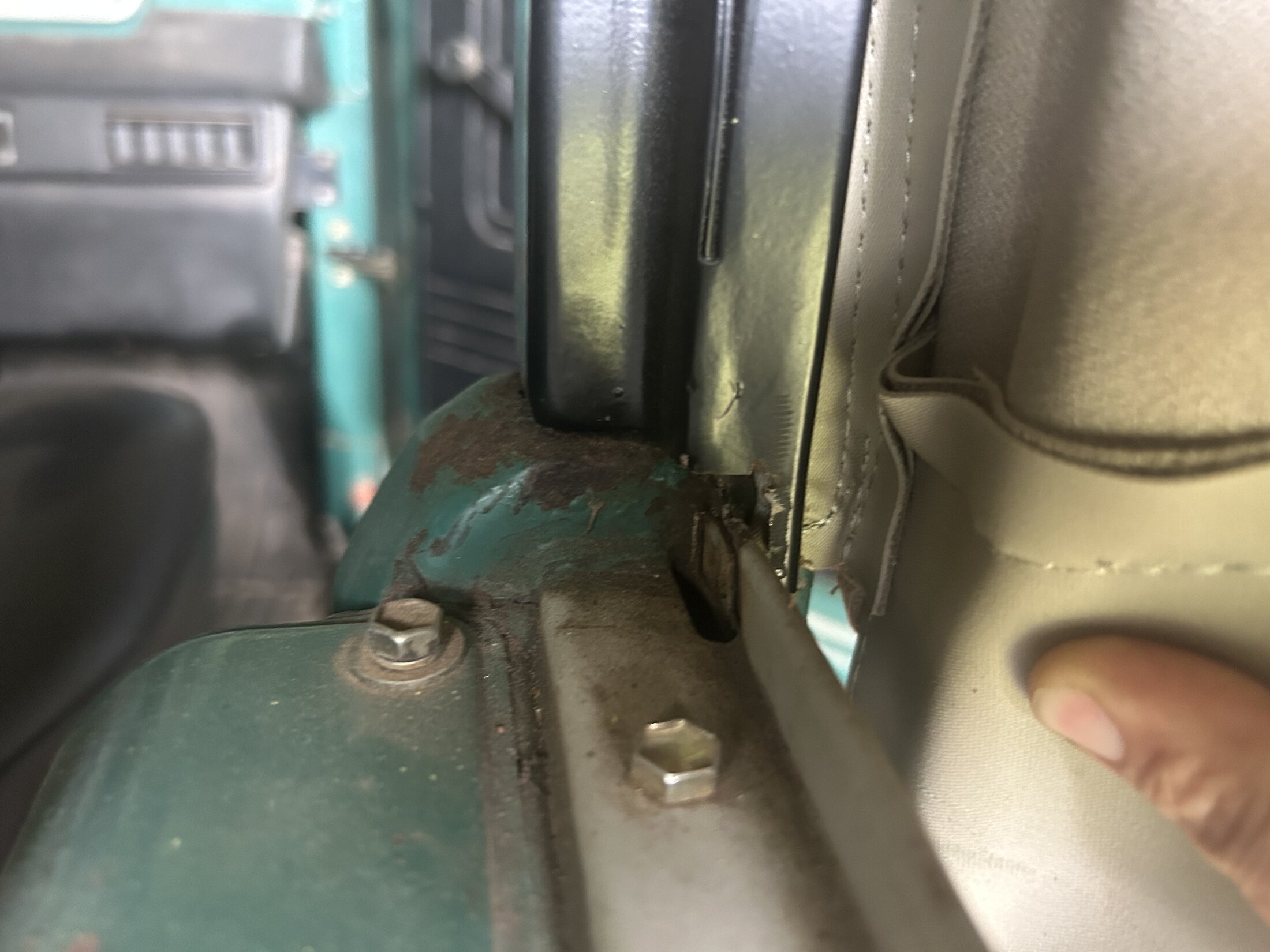

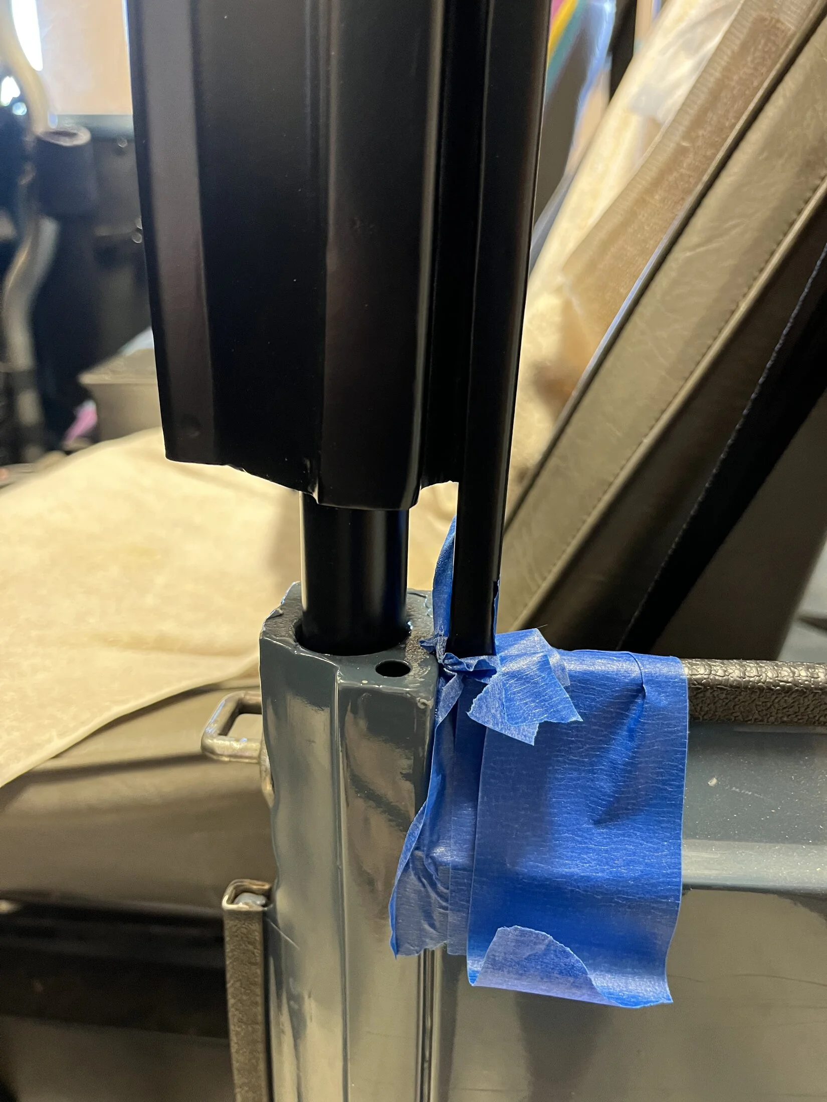

Hope this fits with this thread, but I recently purchased the TROA top and bows to put on a 78, hard top version.
Maybe my ignorance, but do I just cut the excess track off the bottom of the c pillar, or do something else with it?
B pillar.
Yes, notch it leaving the most track you can. It’ll take a few go’s.
B pillar.
Thanks RevISK,
Yes, b pillar.
OK, notch it to slip over the pinch seam on the top of the tub? Was thinking along those lines.
Thanks RevISK,
Yes, b pillar.
Like this, but you do it better.

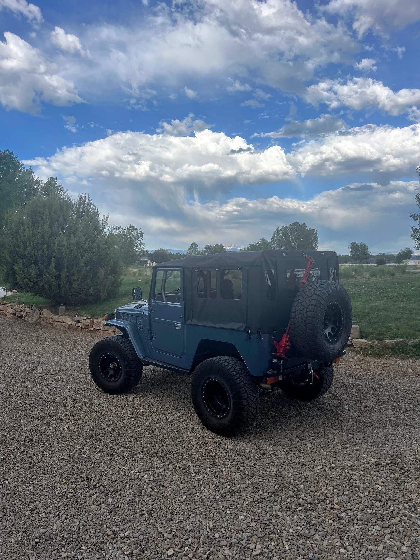

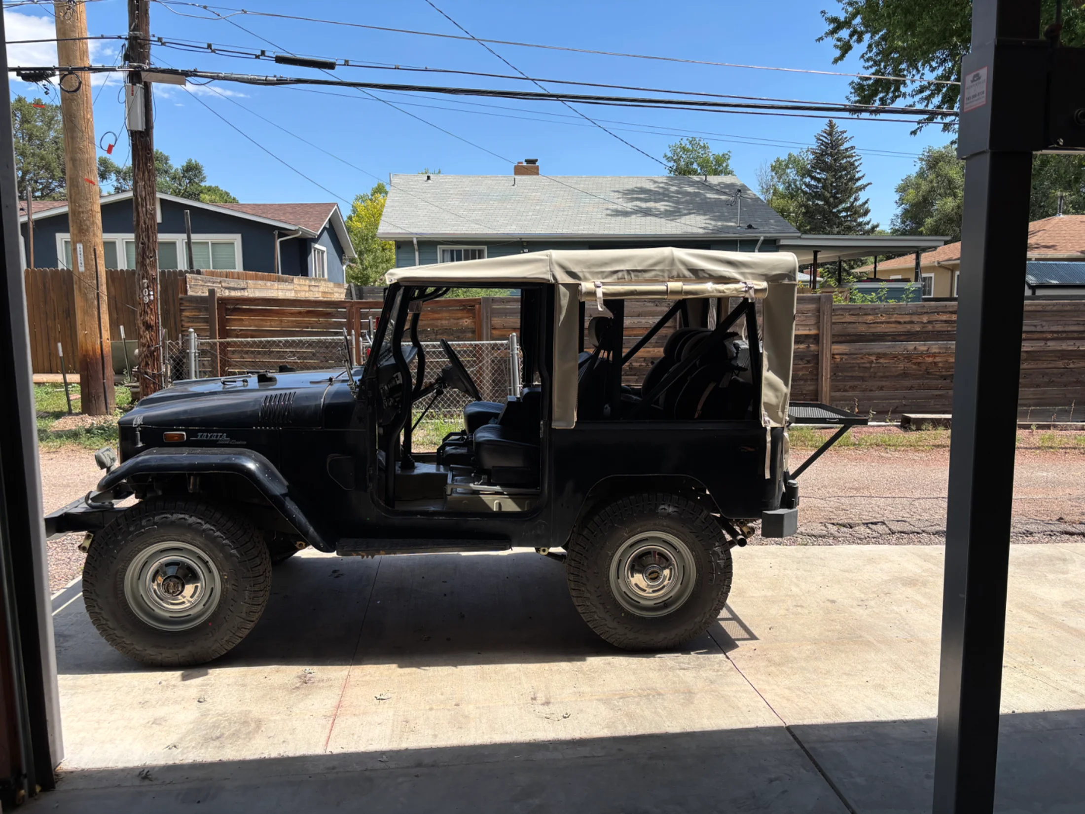

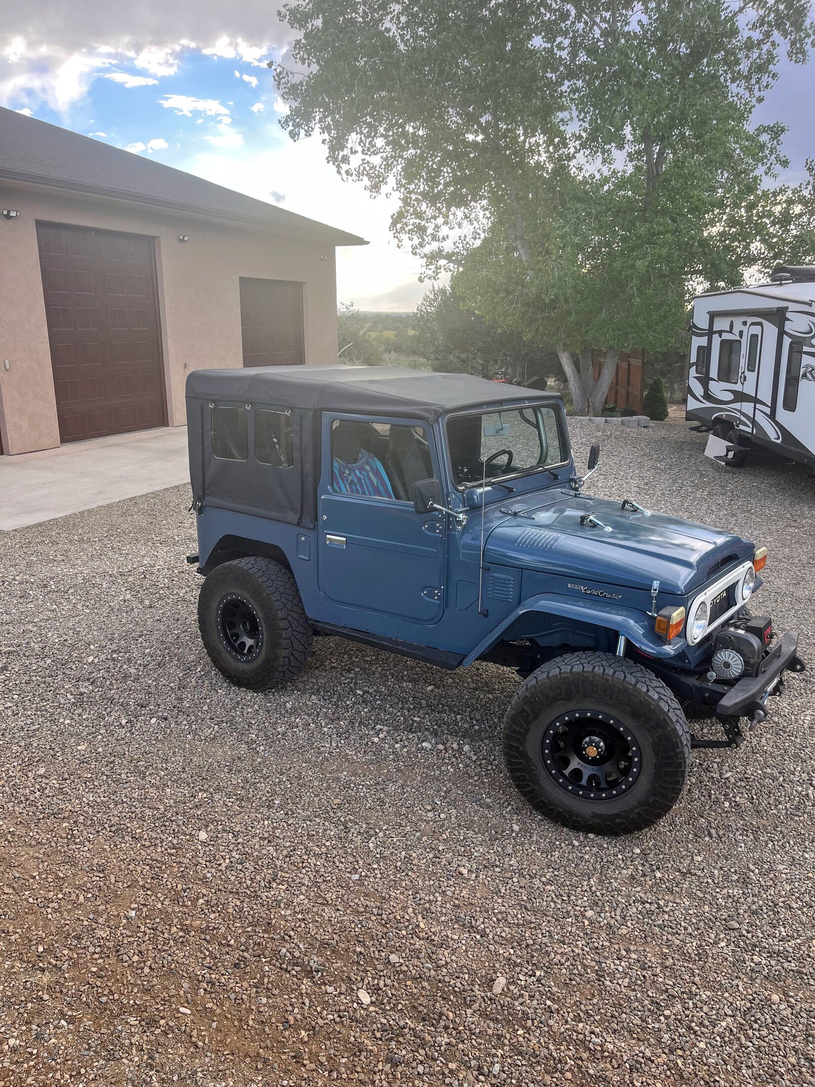

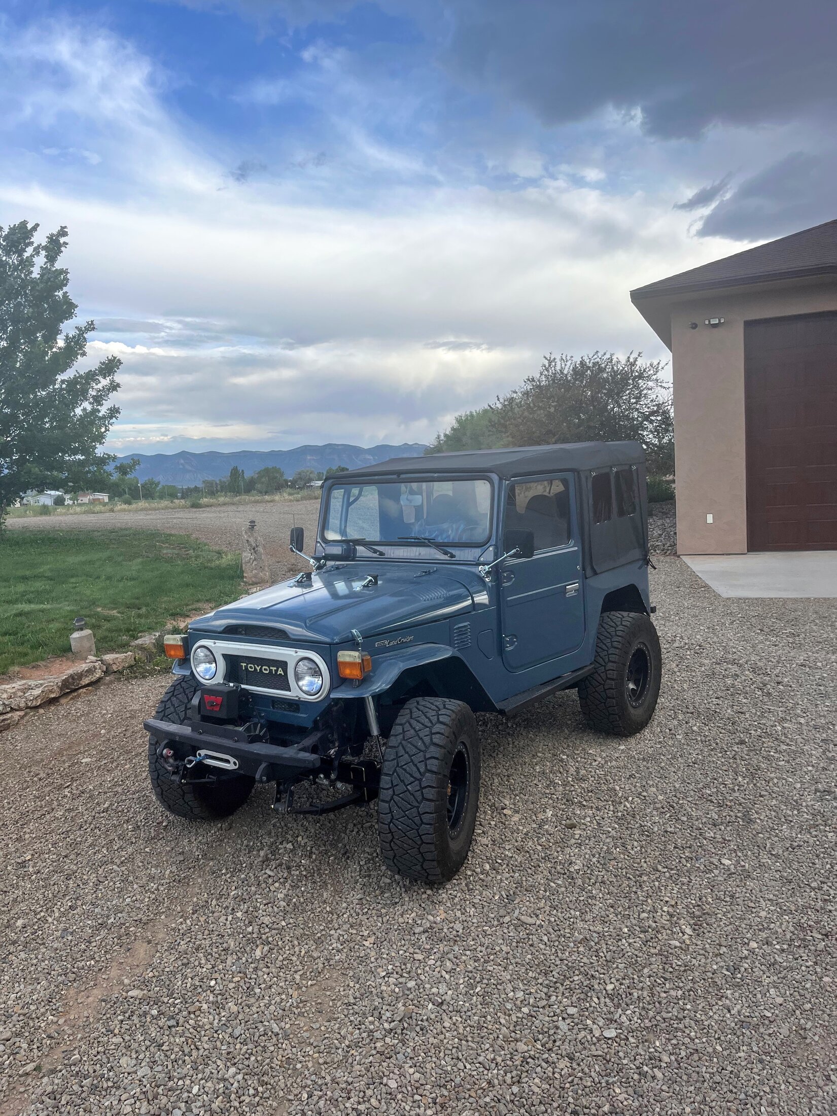

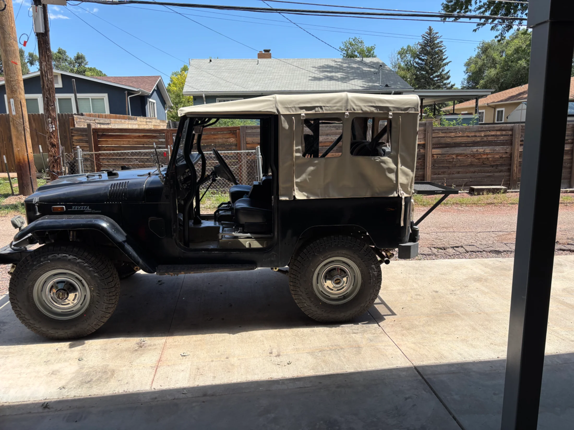

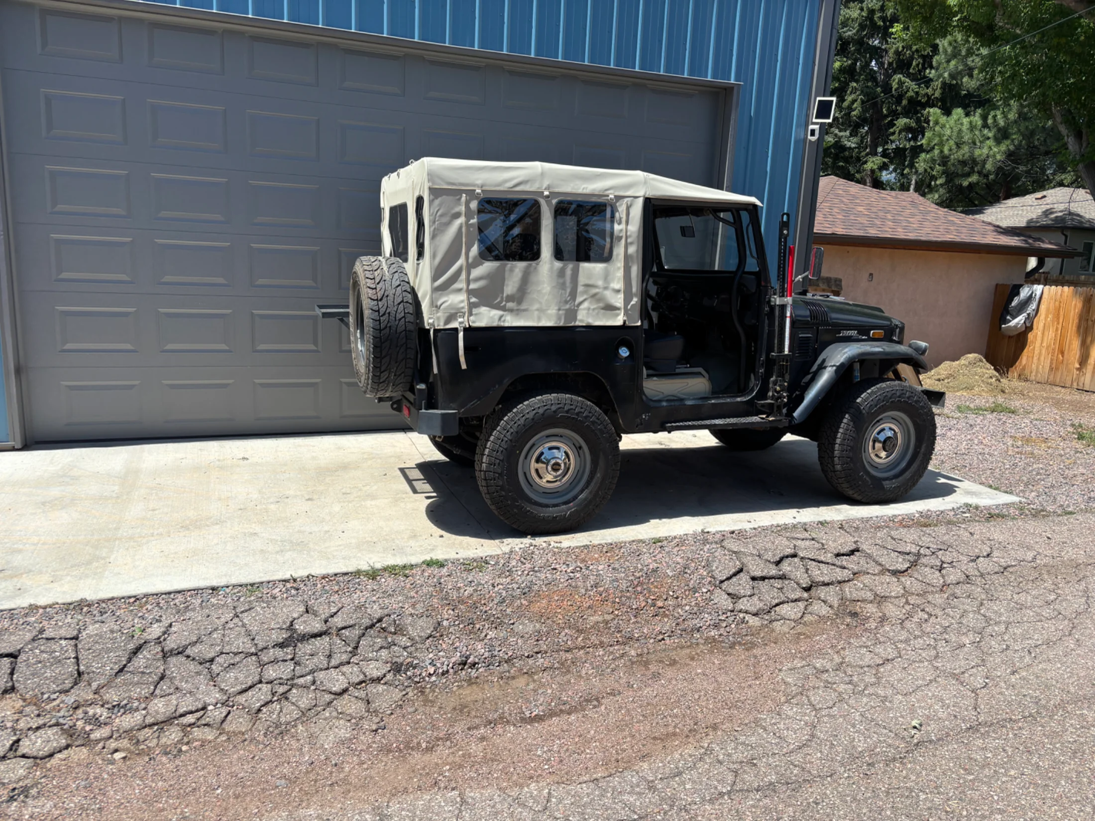

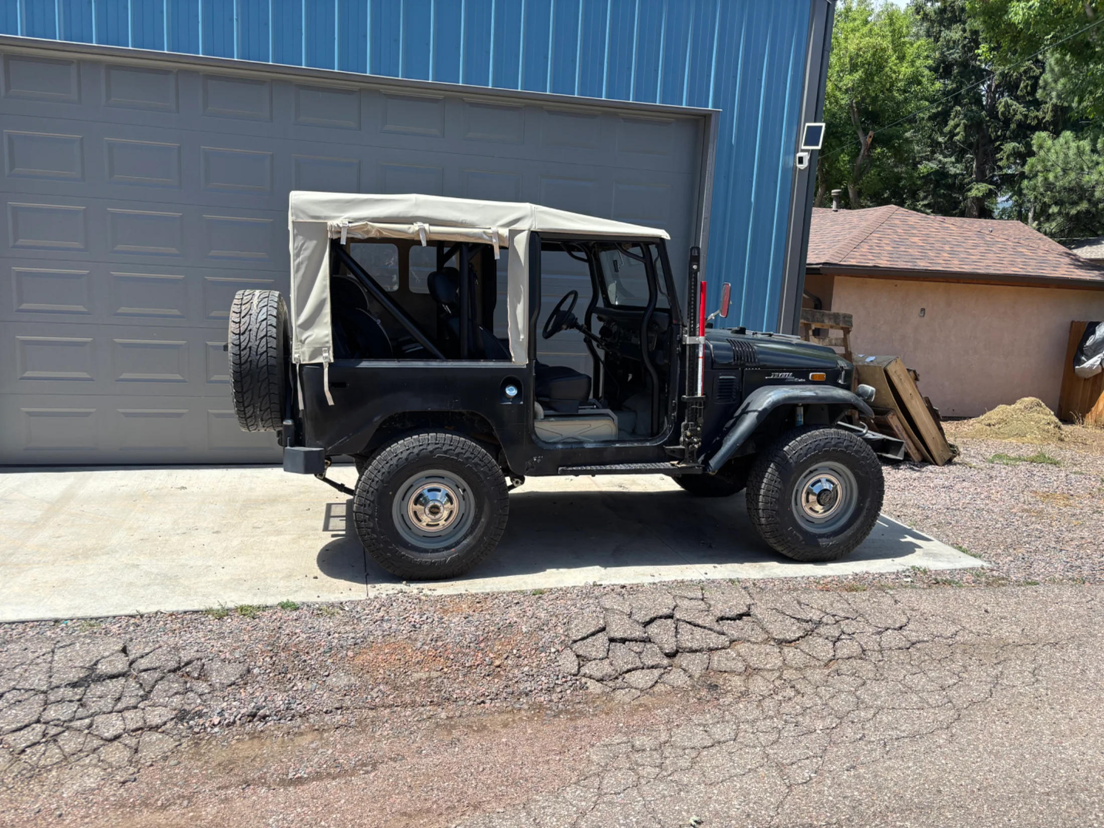

Another satisfied TROA bow and top owner here. I went through @RevISK and he's the man.
I haven't installed all of my rivets/twist locks yet, but the rest is in. The frame definitely need some massaging, but to be expected as I'm sure my 40 is anything but square in any dimension.
