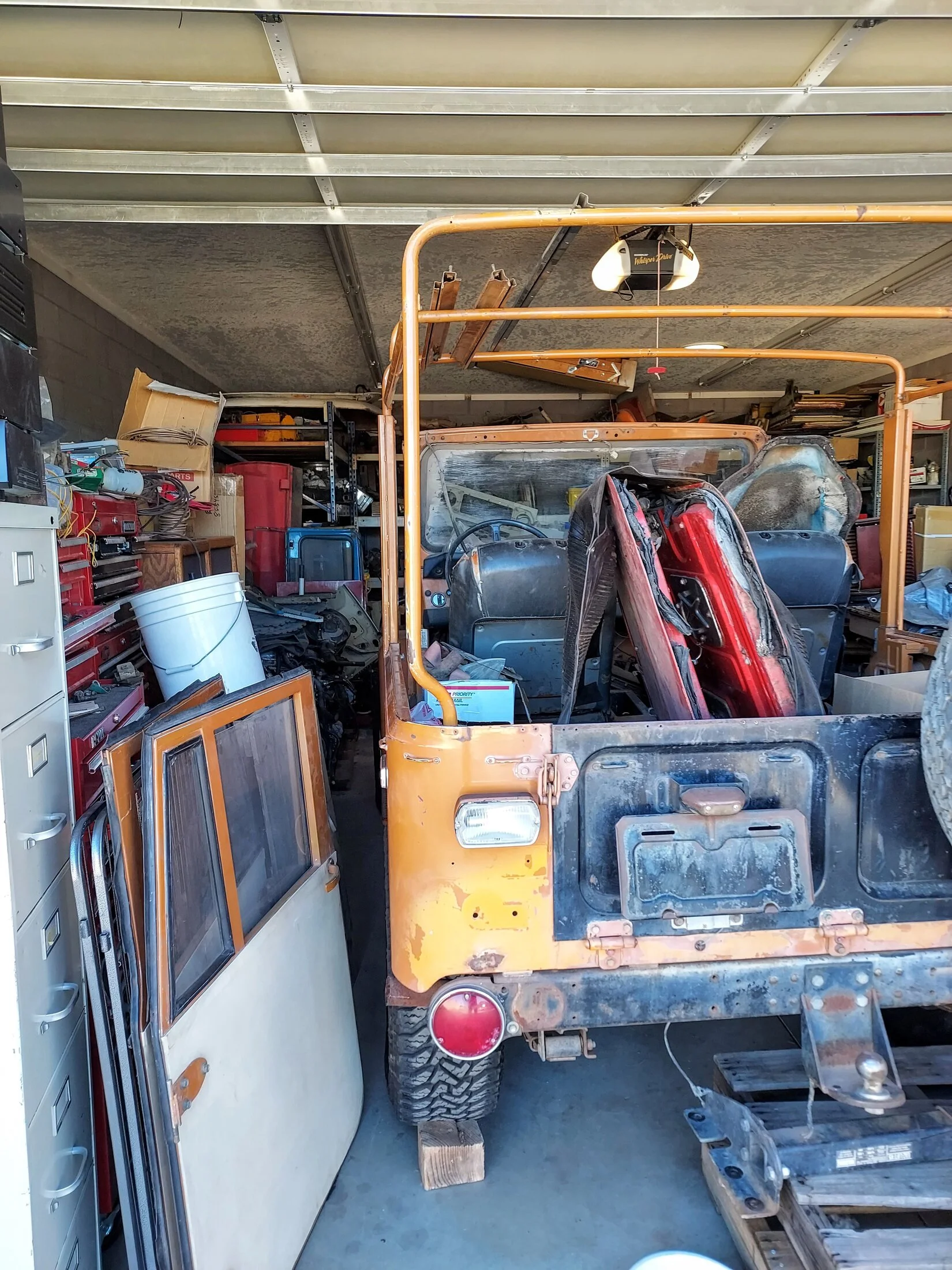

Mines a 9/72, sold as a 73. Pics bellow, I’ll have to attach some footman loops.

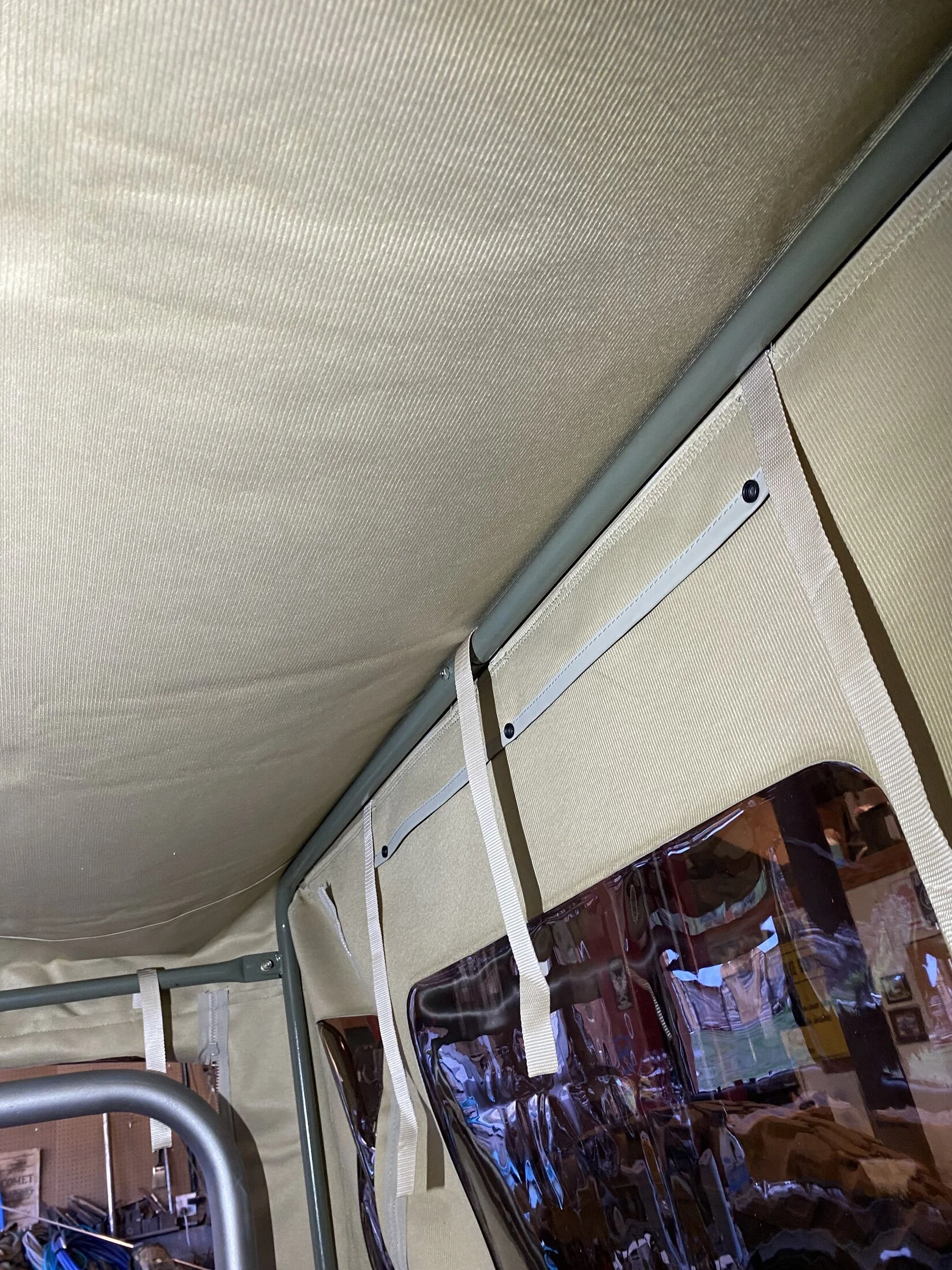

Main bow over driver. Snaps, no Velcro’s but seem to fit snug. Time will tell over time.
Center bow.
Rear

Interesting that your snaps in the center bow don’t line up with the bow itself. I have the same issue but on the bow over the drivers seat.

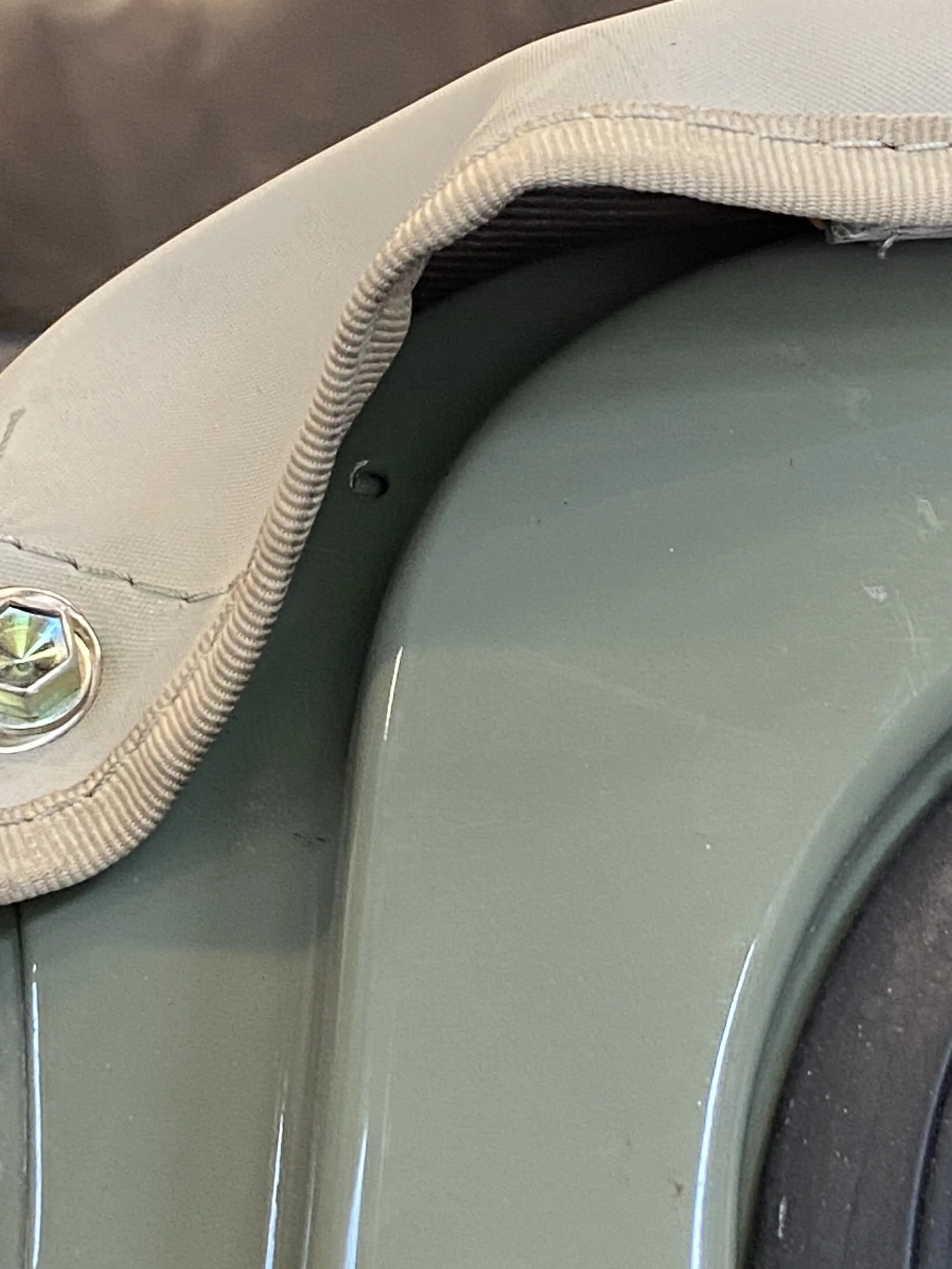

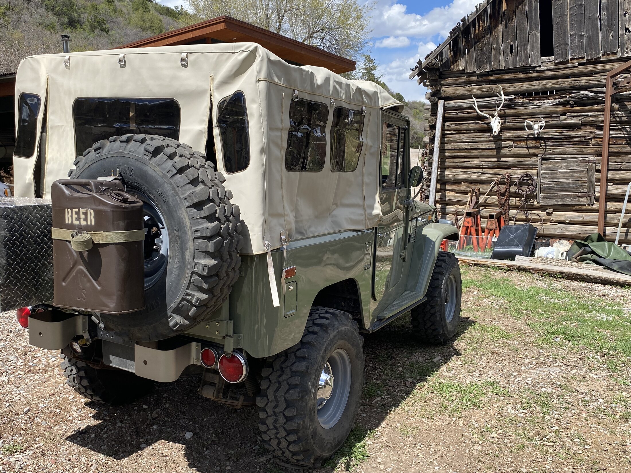

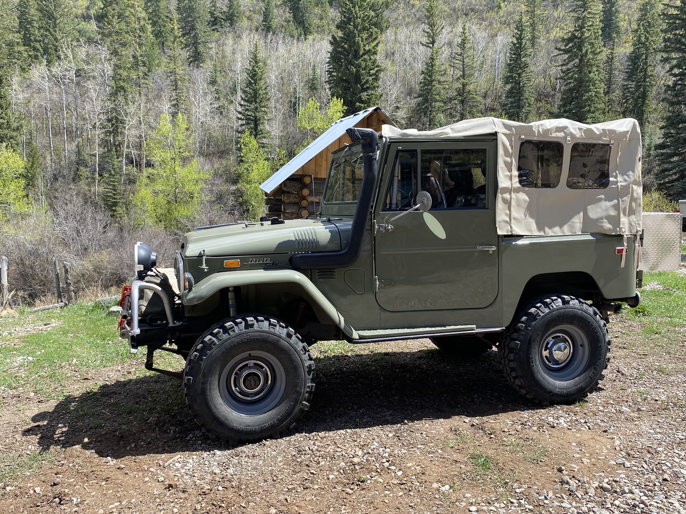

installed top today except for the extra footman loops. It fits pretty good for no custom measurements. I feel over the years a lot of these rigs metal has moved, windshields shift, I’ve replace body panels so that could be issues of mine not fitting perfect.
For the sides, I started with the passenger side and pulled down hard to line up hole over the door pillar, but maybe I pulled too much, driver side couldn’t pull down as far. I’ll have to figure out a seal.
For the windshield, I think I’ll add a snap, mine has a hole from the Best Top I had.
My biggest complaint that I just noticed today. The rear bow flap is missing the male side. There is nothing to snap into. Was that flap forgotten? Or am I missing something? Maybe someone with a TROA can check theirs.

Wish you were closer would be interested how it would fit on my 73 FST. Mine is basically still original with original bows and soft doors.
Everything fits like it should.
The distance B pillars is wider with soft doors. I need to measure further it angled from the bend on the hard top.
I would be disappointed with this fit.

I’m more disappointed in the rear bow snap/hold down. When the rear flap is rolled up, the only restraining point are the straps/footman loops on the corners.
I wonder if you adjusted the bows all the way out? They do have a tad of adjustment
I wouldn’t be bothered with adding snaps on the rear bow… it’s hardly needed
Unless the straps don’t get to tight?
The middle bows… yes they need it
When the rear window is down the straps hold it… when rear is rolled up it is being held by the straps
Even then it hardly moves
If your adjusted all the way out and it’s still not tight enough to your liking … you could use pipe insulation on the rear bow
Had to use that on my old kayline oem replacement top … those didn’t have any hold downs on the rear bows

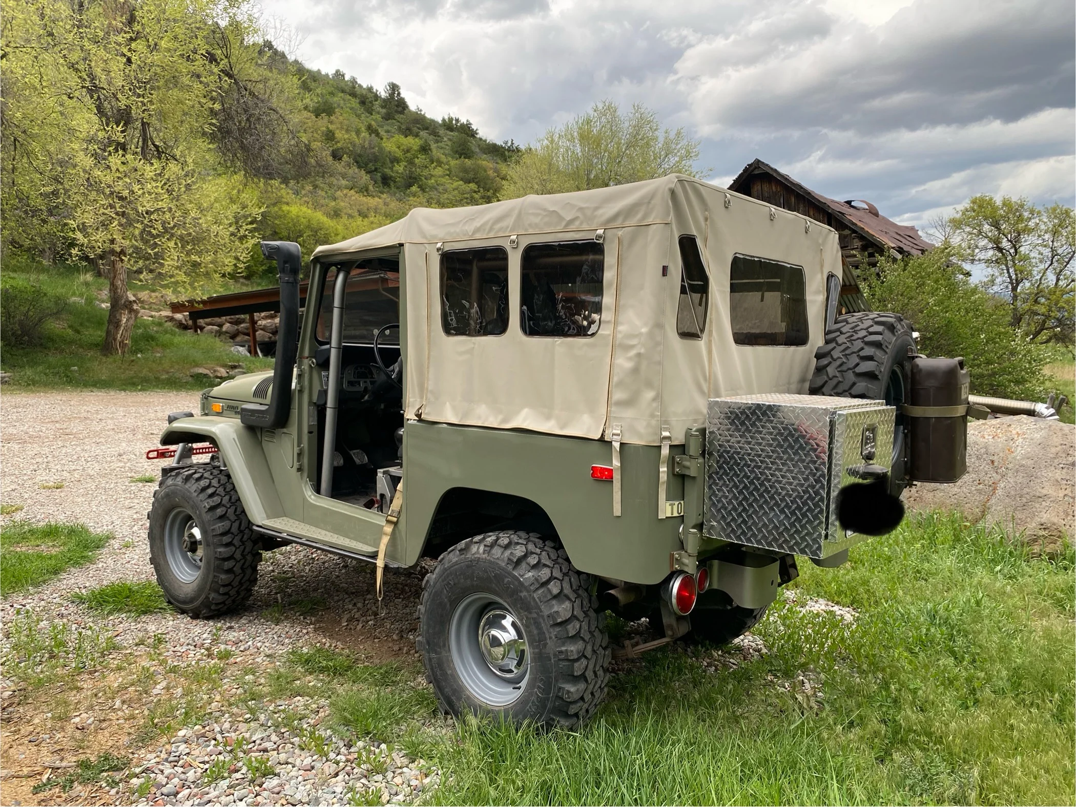

Best picture I have of the rear of the Kayline top. Have three of these tops and all use twists in the back corners. Bought this one off of a 69. Besides having tinted windows the back is shorter than the two. The height of the back now matches the height of the FJ25 and early FJ40 FSTs. The Kayline tops have a wider opening in the back.
