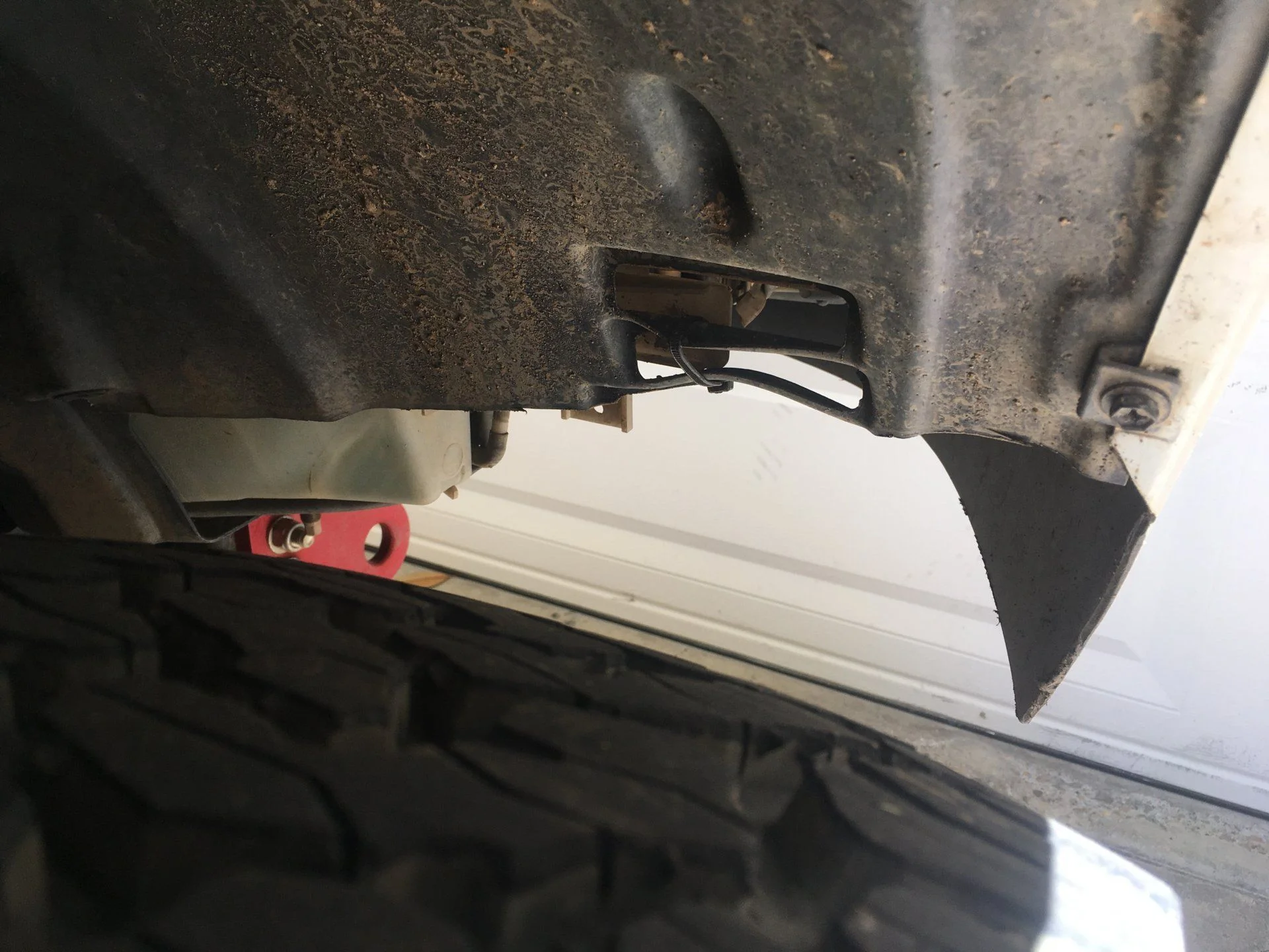

Here is my trim job.

Driver side inner fender
38e5b131-1366-4ea9-82d6-34616c9cb0e3-jpeg.1651961
Passenger inner fender (Careful for the washer bottle when cutting)
be73a901-8afd-4302-b0c7-d434f9188e53-jpeg.1651960
