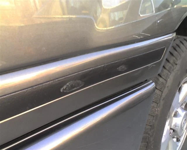

I sanded mine down just enough to remove the damaged paint, taped them off, and sprayed them on the truck. I used a dark bronze Rustoleum that matched PERFECT.
before (not very good pic but you can see the damage)
After (I used the same paint to do my emblems as well)
So, I fianlly got around to trying the Trunk Monkey approach. Great idea. Looks great. One banana job. Only hang up I had was when my wife walked by and reached out to feel the texture. I was not fast enough and this was the result. A little sanding and some xylene removed it and I redid the panel.

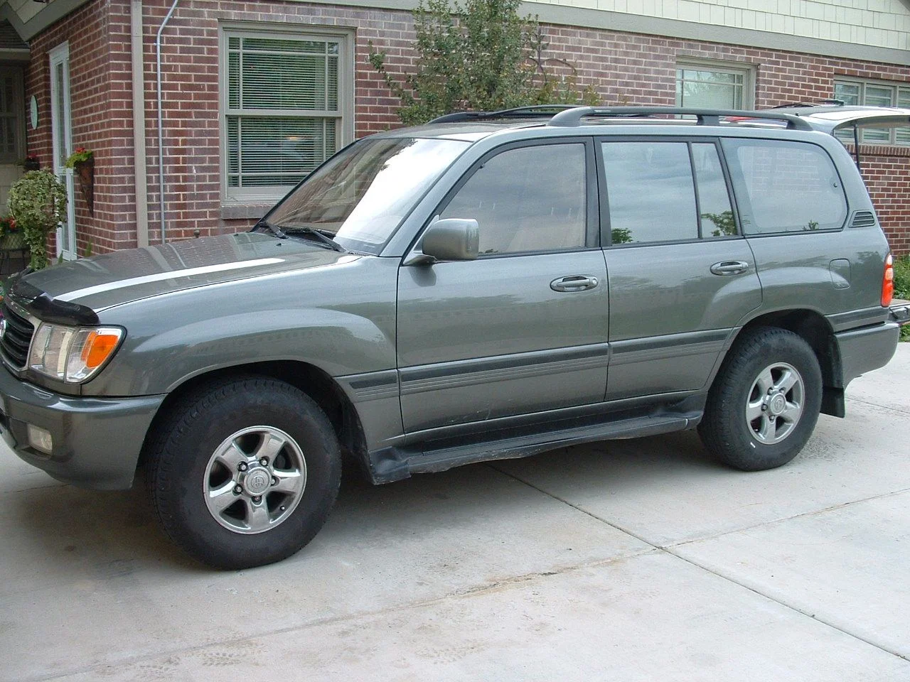

Dan,
We need a shot of the whole truck with the new trim paint! I have a Thundercloud 100 with fading trim as well. We need to see how yours turned out so we know how ours will look when we pull the trigger.
Thanks
I painted all my trim and rear bumper cover 2 1/2 months ago. Everything is holding up great!
Thanks for the pic Dan.
I think it looks great! Well done.
Thanks Lash, but we should thank the Monkey. His idea. I'm happy w/ the results.
Of course! Thank the Monkey.
Thanks Monkey!
I really love my gold emblems that are now DupliColor Phantom Gray Metallic. If I had to do it over again, I might go a shade or two lighter.
When the time is right, I'll address the side trim to match.
Thanks again.
