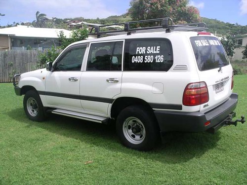

I always liked the look of the Aussie 100 series GXL:

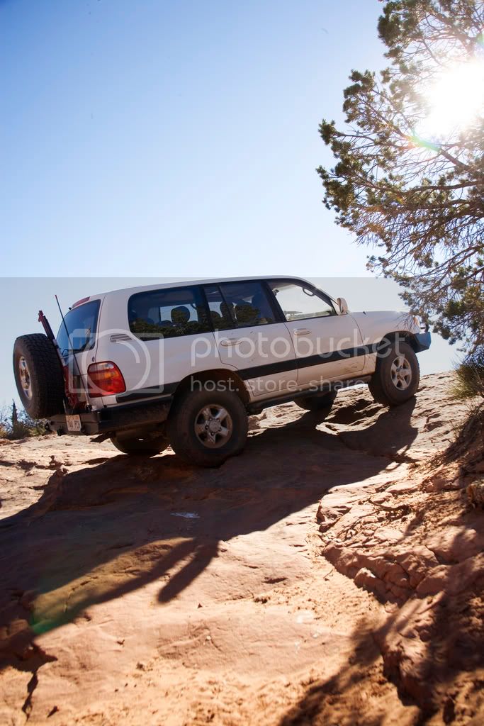

So I pulled off my trim using the following tool:
Then removed the adhesive using the following tools:
Next I sanded the plastic and cleaned it with a general purpose cleaner, then painted it with the following paint:
RustOleum.com
During the removal process most of the clips broke, so I ordered new ones from Toyota total cost about $40. To reapply the molding I cleaned the truck surface and used 3M trim tape with the new clips.
And the final product...
Now if I could just get some of those steel wheels...

I've been planning the same mod, but I've also been trying to source the non - USA side molding. Yours looks great, I think I'll go that route. Thanks for sharing... any difficulties I should know about before removing the molding?
Mas. It's Duplicolor spray on bed liner. It's not as thick as Rhino lining, but it's pretty durable. I used this on my 80 flares and it held up really well.

Sand it good to give it a tooth for the liner to stick to, mask really well up and down and you should be fine. Like I said, I did all 4 fender flares on my 80 and it held up well. Dunno if it'd survive a power washer but it was pretty durable. Branches on the trail wouldn't mar it.
