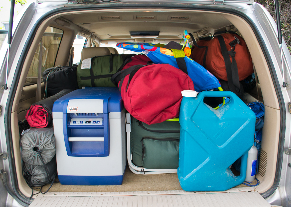

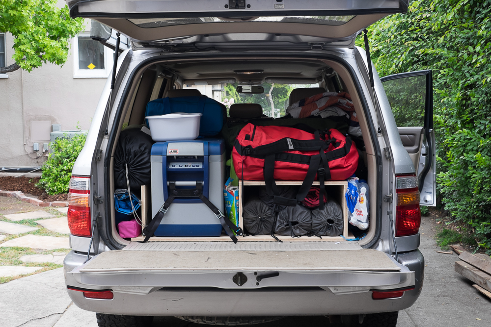

This is how I have packed my truck for years worth of camping....No Bueno!
Decision Making Process
Drawers have been an ongoing conversation between my wife and I since we bought our 2001 land cruiser. I have wanted a drawer system for my cruiser pretty much since the day I bought it and started looking at mods. Finances mostly kept us from jumping in with any one particular drawer system right away but I have also built my truck on the core principle of not buying anything until I have proven, through many field experiences without the particular item, that it will benefit my travel experience or safety. For four years my truck has only had a lift, tires, 9” LED light bar and communications gear.
After dozens of camping trips and having to pack, unpack, and repack all our gear in the truck just to get to some cooking gear my wife and I were fed up and ready for some kind of organization system in the truck. I started researching all the systems available, looking at every home built system, and eventually taking all those ideas and designing my own. I designed a beautiful system but it was still going to cost a fortune and take a lot of time that I didn’t have. A quote from my wife regarding this aspect:

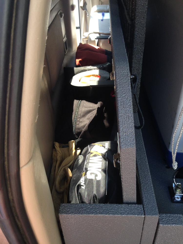

“I was not convinced that an actual drawer was the solution. I liked the open cubby as we could slide things like our camp pads, sleeping bags, and tent in it. At the time we owned the REI camp kitchen and had all our kitchen items stored in it. Even with the cubby, it did not solve the problem we ran into when trying to access our kitchen stuff with the car packed. This was especially annoying during lunch time when we were on the go and had to unpack half the car and then dig around in the camp kitchen to find what we needed. It turned lunch into a major production. My biggest reservation with the Trekboxx at first was it looked quite permanent. My other reservation was whether I could fit our stroller in it. I honestly didn’t put much thought into it beyond that. I had never seen a drawer system in the field, in person, so I didn’t even know it’s potential. ”

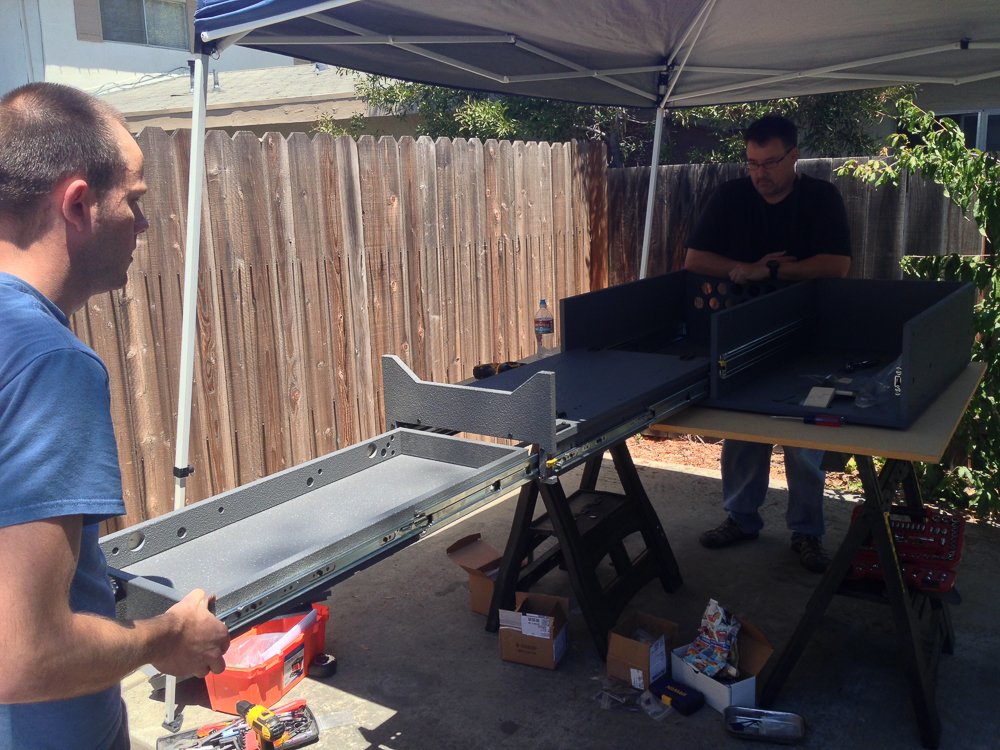

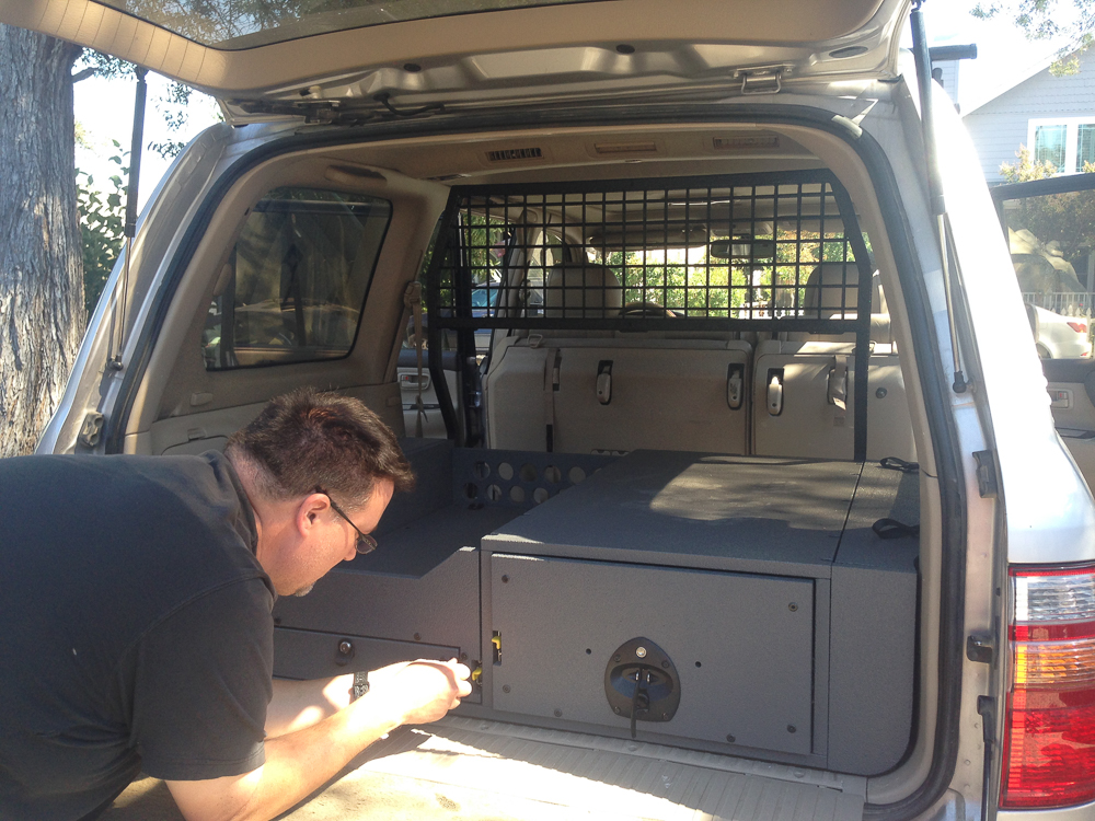

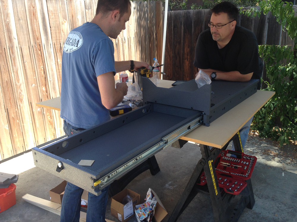

Five days before heading out on our trip, I drove up to San Jose, CA and met up with Dave at RobRed’s house where the three of us got to work prepping the truck and installing the drawers.
Assembly

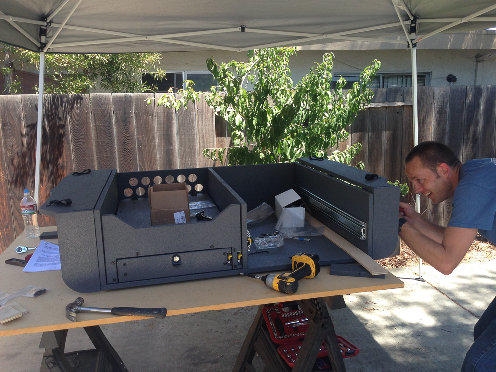

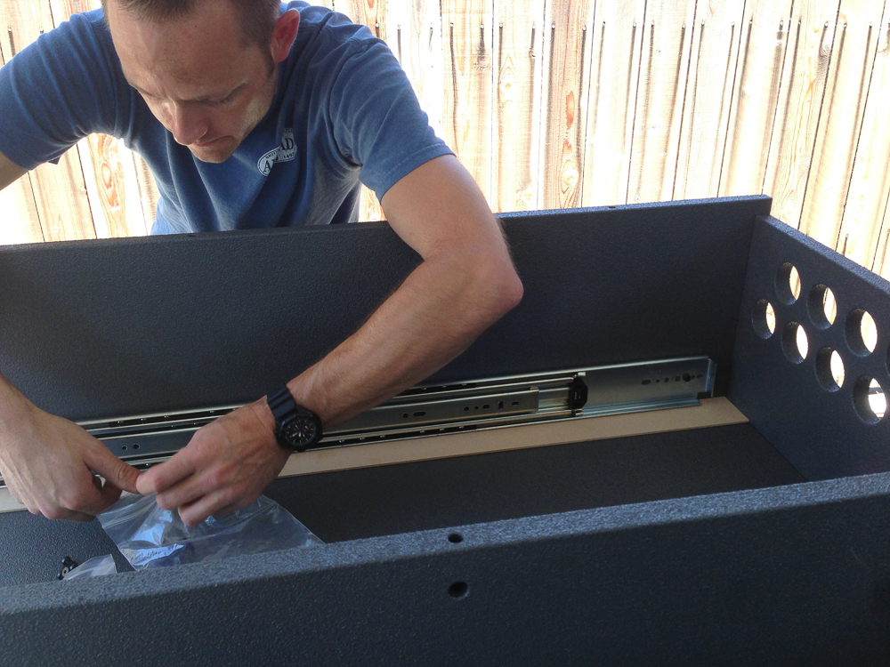

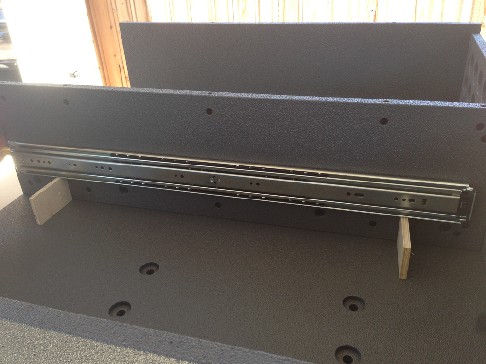

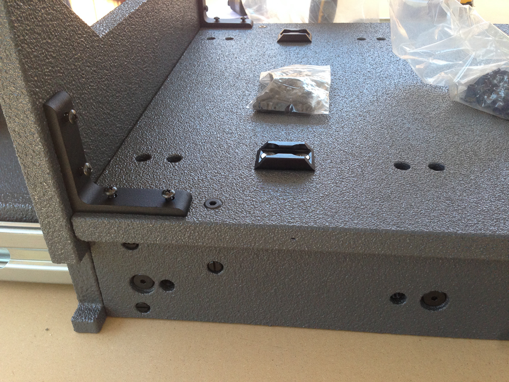

The assembly of the drawers is really straightforward; it goes together just like a piece of IKEA furniture minus the poor quality. Dave used top-notch hardware for every part of the system. It took about 2-3 hours to assemble the main structure, all the drawers and slides, and have it ready to go in the truck.
An example of the quality of the CNC work
Assembly like IKEA but better. This is the drawer the fridge sits on.
Fridge slide and small drawer
Dave provides all the shims needed to get the drawer slides set at the right height

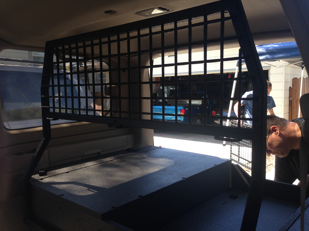

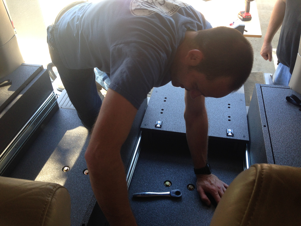

Wings on and in the truck. Two people could get it in and out of the truck but three is nice.
Anchor bolts in
Barriers
Barrier install

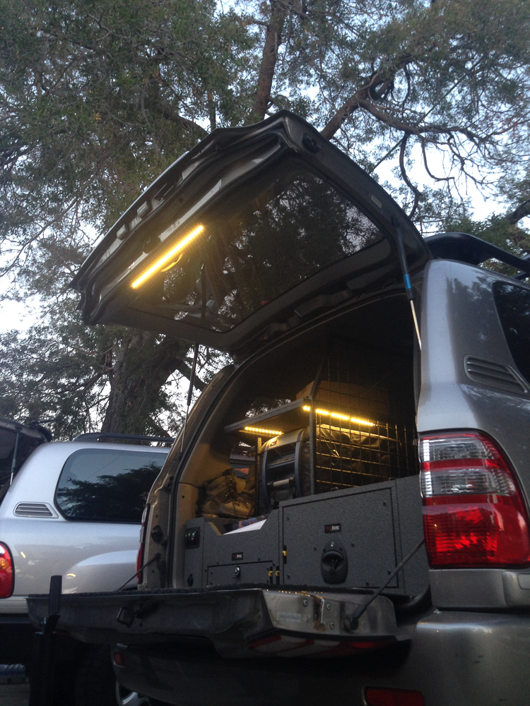

Dave had some cool extra features in his own truck that I will add later. The LED lights are exceptionally nice. The warm LED are the way to go.

This system was the first system that has been installed in a truck other than Dave’s. So for all the ease with which the system was assembled there were a few minor hiccups along the way. The first came up when we were putting the drawers in the truck and getting ready to bolt them down to the 3rd row seat anchor points. Dave had the holes machined “perfect”, meaning there was no accommodation made for tolerances in both the position that the CNC machine put the hole in the wood and the actual location of the anchors for the 3rd row seats. So several things happened because of this. First, the holes didn’t all line up well enough to get all eight bolts in. Second, there was no room to move the entire drawer system around to get it centered side-to-side and front to back in the truck even if the 8 bolts had gone in where the needed to. This issue was easily fixed by opening up the diameter of the hole with a drill and making it more of a front to back slot.
The second problem we ran across was one that turned a 3 hour install into a 9 hour install. We had assembled and tested the slide action of the fridge slide with the small drawer prior to putting it in the truck and everything seemed to be extremely smooth as expected. Once the whole system was in the truck we found that the small drawer under the fridge would stick halfway as it was pulled out. It took us 6 hours to figure out that the back panel of the small drawer was causing the drawer to not be square; it was pushing sides of the drawer out towards the back of the drawer. We found that the problem was in how that box was assembled prior to installation. Once we loosened up pretty much all the bolts we started to tighten them one at a time as we pushed the drawer in from a fully extended position. This let the drawer conform to the tolerances set by the larger drawer and box. The fix was simple and just required a few beers to figure out.
Through these two minor problems Dave had a notepad by his side and took very detailed notes so he could make changes to the hardware and also make changes to his already very detailed assembly instructions. I considered both issues minor and just part of dealing with the very first production run of anything. I knew there might be unseen issues going into the install. I don’t think either of the problems we encountered will be a problem for future installations.

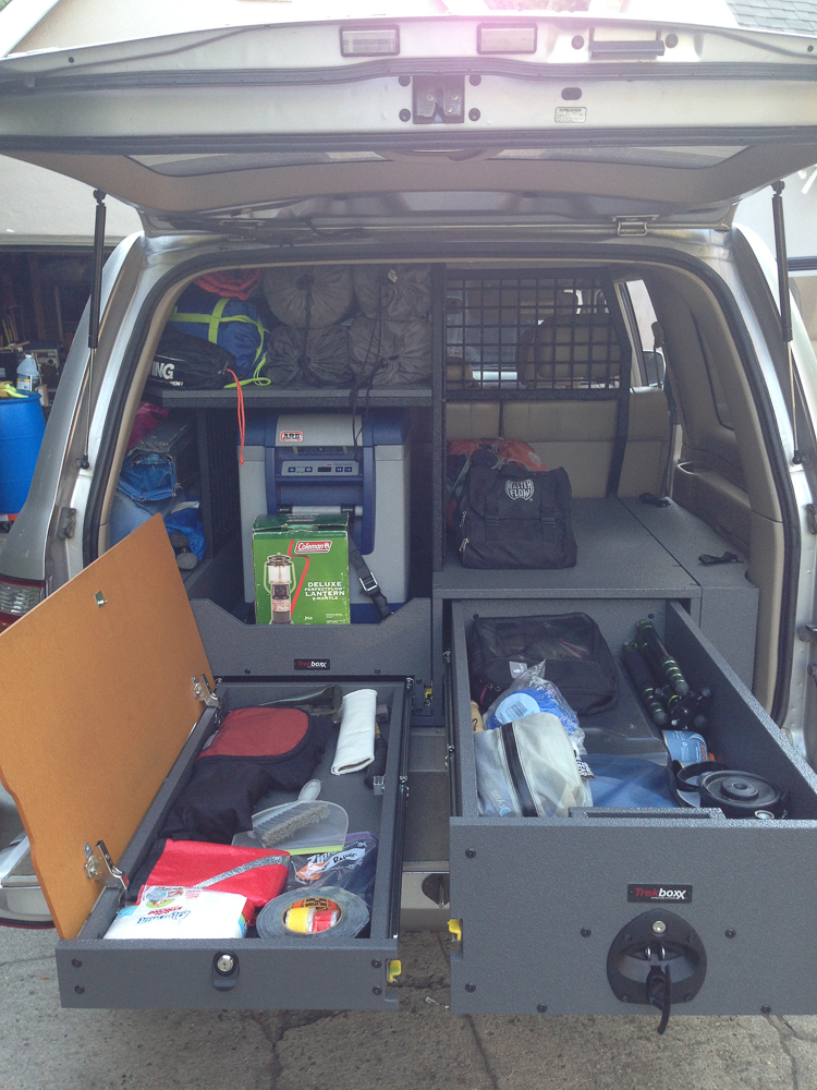

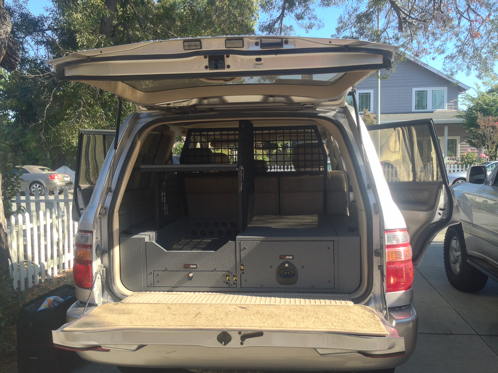

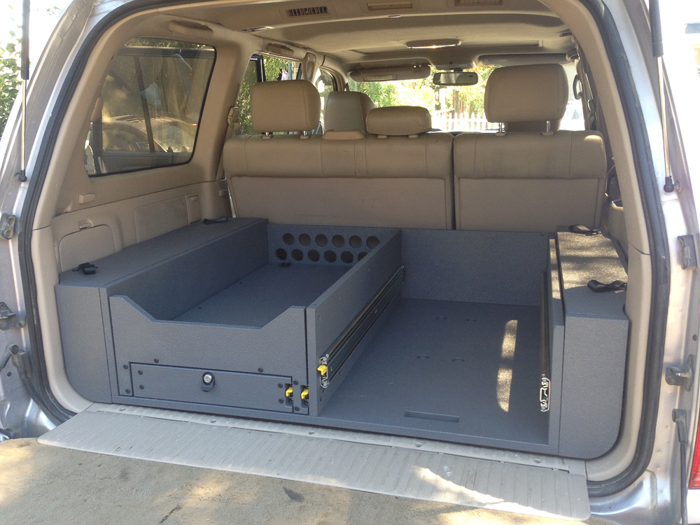

The fit and finish are second to none. I just stared at the system all day long as it is beautiful to look at. It was almost painful to have to pack it with stuff because it looked so nice empty. Immediately after getting home I started to throw gear in to see how it would pack. Right away I could tell it was going to be a game changer. I think this applies to any drawer system though.
First try at packing before my wife got her hands on things and showed me the right way to pack (i.e. actually thinking about where the kids stuff will go).

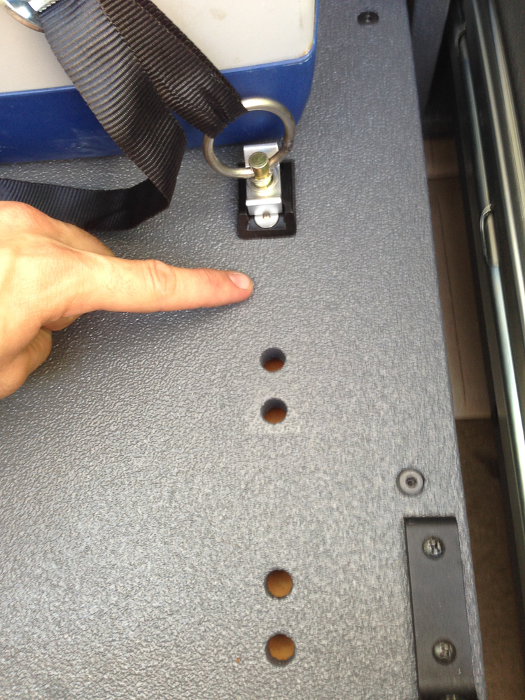

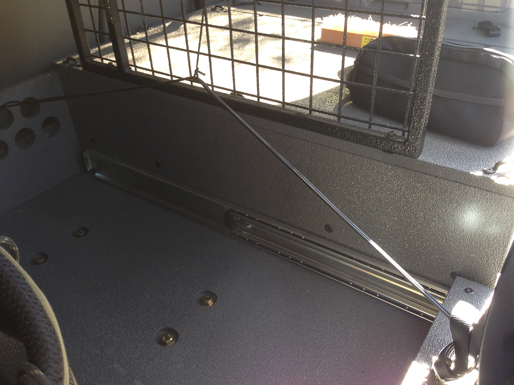

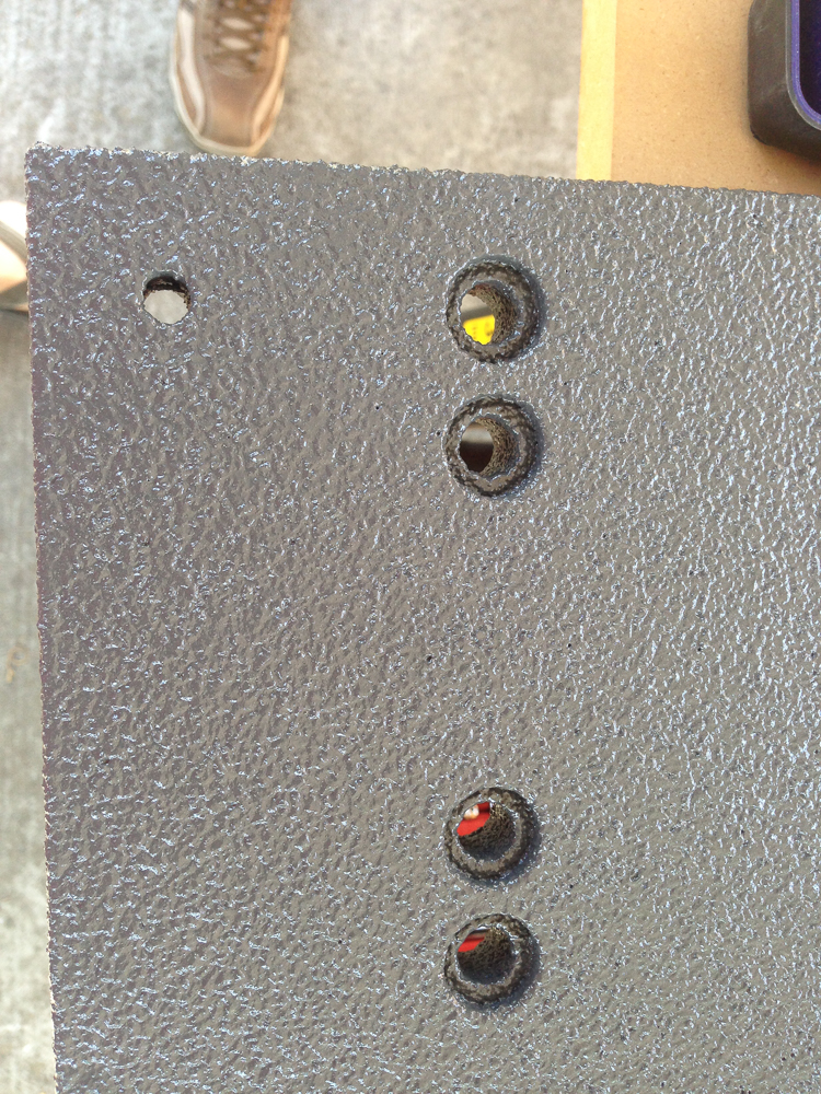

1) There are several sets of holes for the fridge anchors to be placed. I wish it was a continuous line of evenly spaced holes. This would allow me to slide the fridge as far back in the truck as possible and keep the tie downs close to the fridge. Having an extreme angle with the tie downs wastes a ton of space in front of the fridge. I could fit a standard size Rubbermaid container in front of the fridge if this change was made. As it stands the fridge is farther forward and our little box has to sit on its side.
More holes needed for more placement options.
This is with the fridge pushed back as far as it can go.
This is how the box sits up front with the fridge just slightly more forward with the tie down straps angled away from the fridge

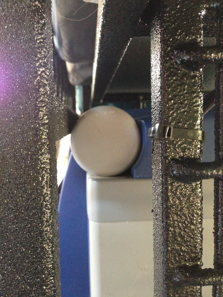

2) The fridge hits the main cargo barrier and prevents it front sliding another couple of inches back for even more room in front of the fridge. Having the barrier flush with the shelf would be ideal. Every inch counts when packing and fitting gear in. I have an ARB 47qt fridge.

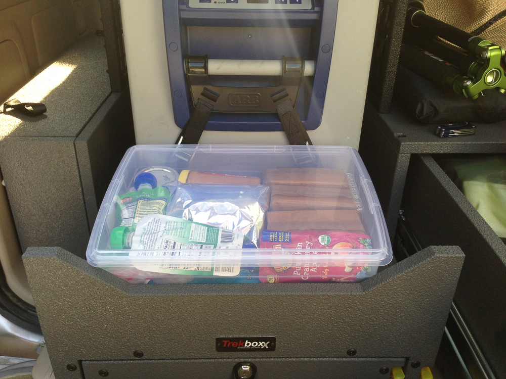

3) The little pull handle on the small drawer under the fridge is plastic and would feel better if it were metal. This pull tab is part of the lock so it may be hard to find an entire lock unit that has a metal pull tab.

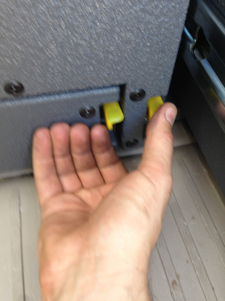

4) Inability to operate one handed. When holding a 1.5 year old it is impossible to open. An extra pull handle right by the drawer slide locks would be nice.

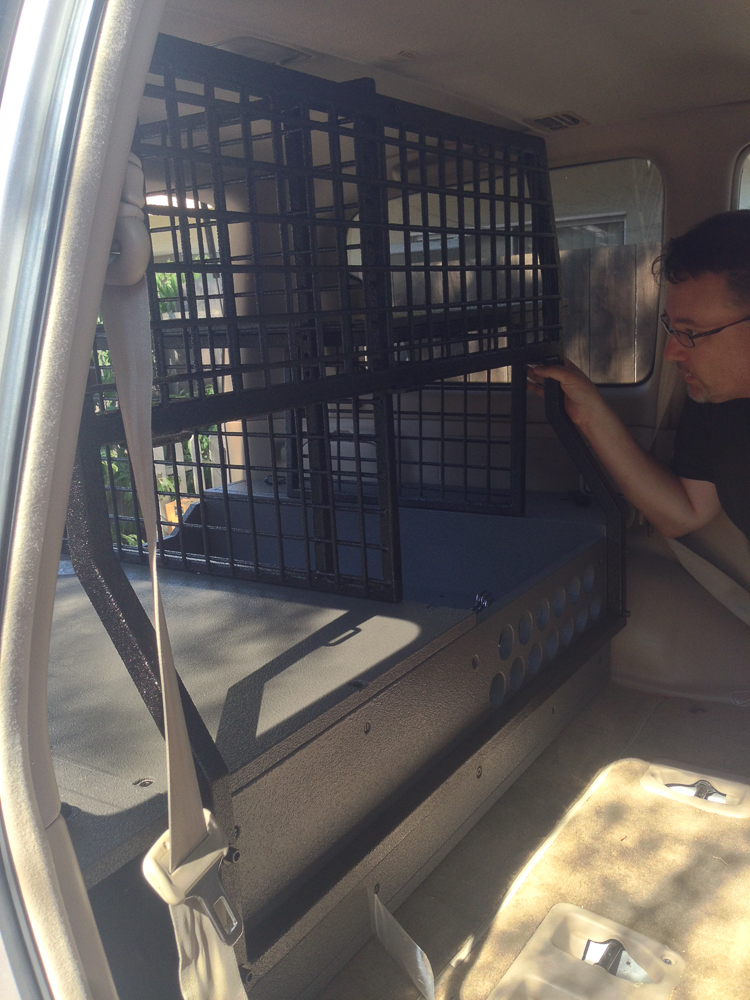

5) The cage system could benefit from captive nuts in the center wall of the system. Currently if you were to remove the cage you would risk loosing one of the nuts behind the main drawer. Total pain to fish out. Ask me how I know.

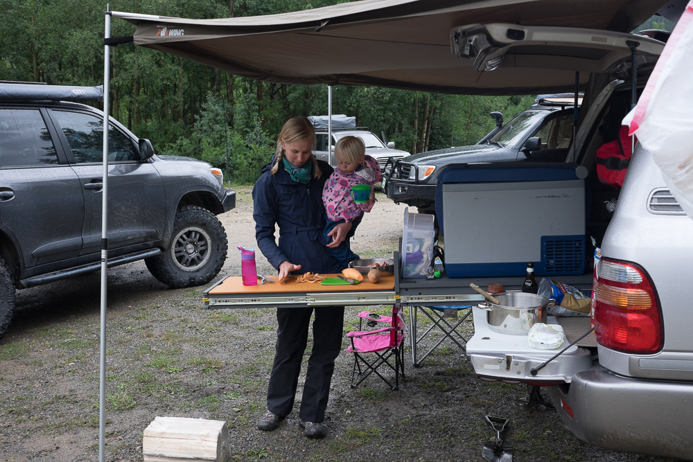

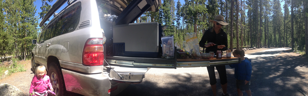

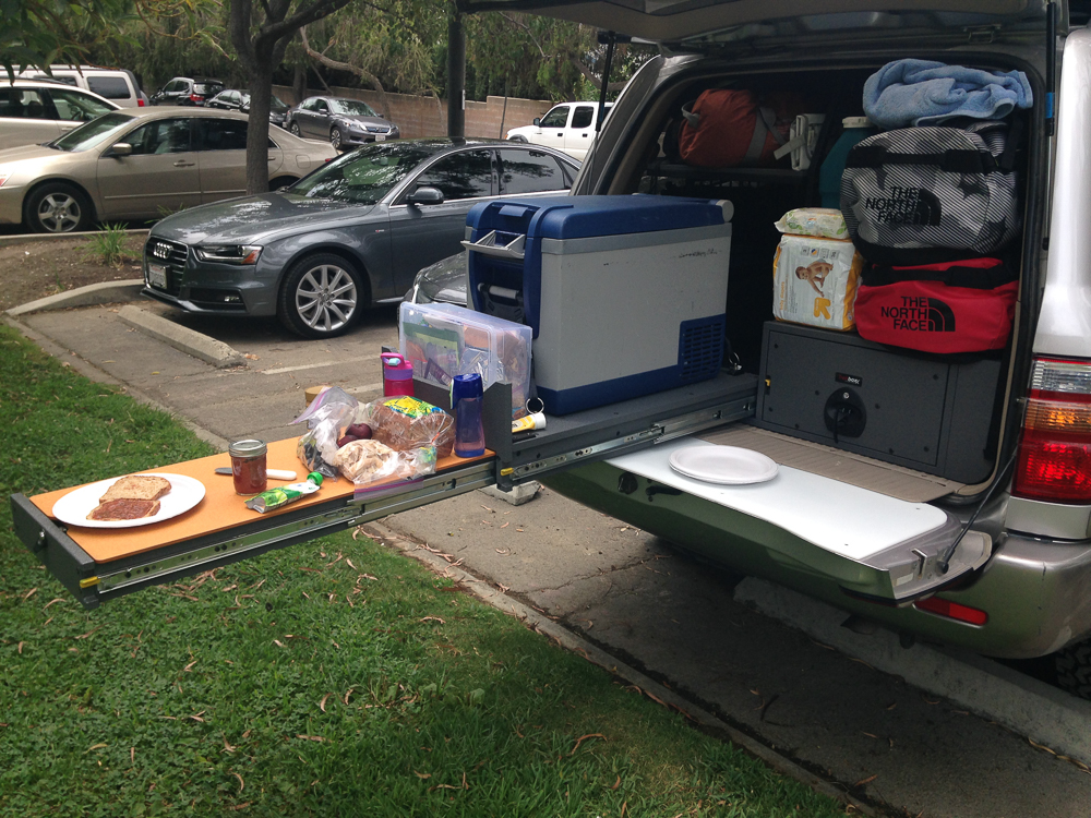

Over the 3,000+ miles we drove with Trekboxx in the back of the truck we stopped at parks, parking lots, schools, restaurants and stayed in hotels, cabins and tents. We used the drawers through all of it. They were an essential part of making every day on the road just a little bit easier. There is not much else to say other than the system has revolutionized car camping expedition travel for us. I kept saying to my wife "the best thing about this system is that it is invisible". Meaning I didn't think about it being there. It was never in the way, it never caused me to be frustrated, it just served its purpose with no hassles. I will let some real world photos do more of the talking. My wife loved it so much that she claimed it as her own. I am officially not allowed to pack the drawers except for the drivers side wing area where I am allowed to put my tools and recovery gear.

Lunch before leaving town.

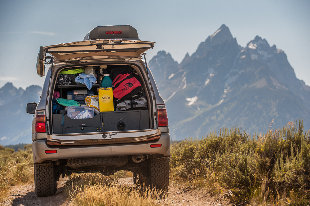

In full use

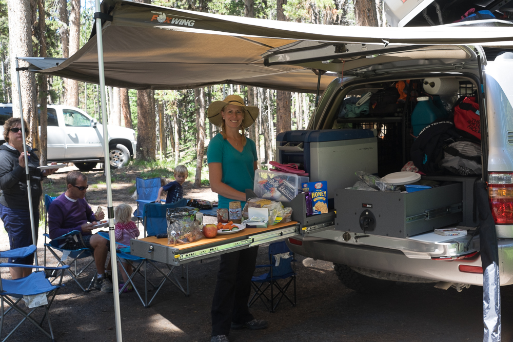

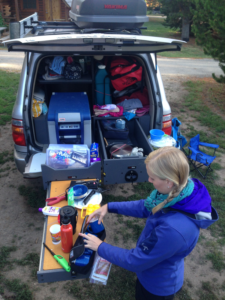

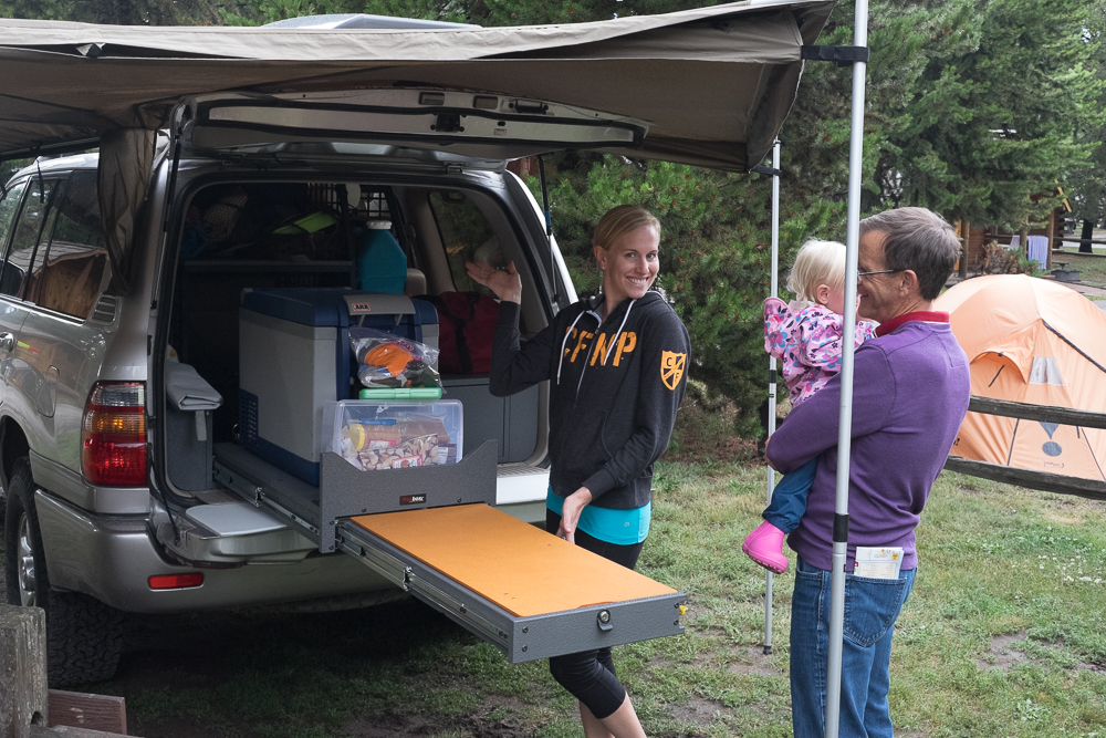

one of many quick lunch stops. We could pull in, deploy the awning, make lunch, feed the kids and be back on the road in 30 minutes if needed without unpacking any of our other gear.

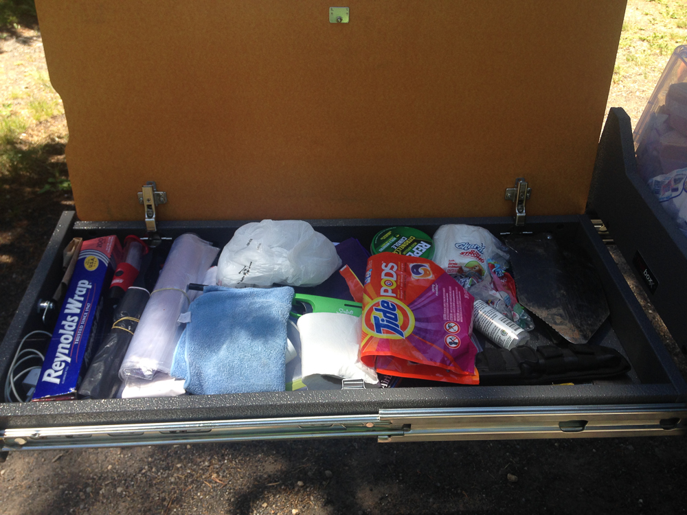

I think one of the best features is the "junk" drawer under the cutting board. All the stuff that never really has a great place to go but that you need all the time fits in here. You have to plan carefully though, so that when you are cooking you don't need to get in there.
One handed in the rain while holding a baby. She makes it look so easy.

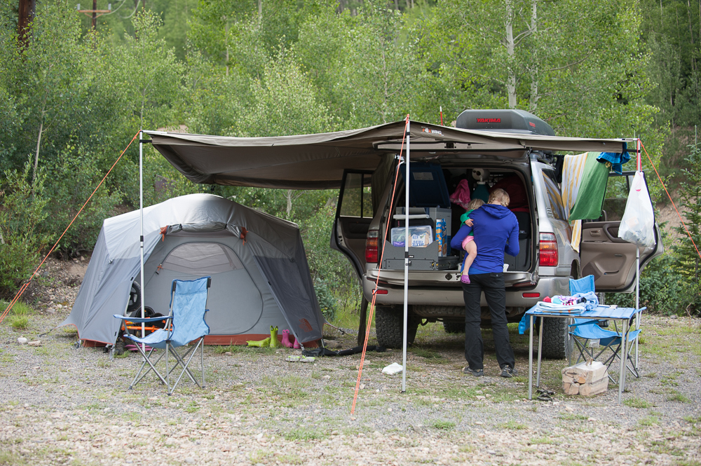

We had a lot of people hanging around our truck all weekend at 100's in the Hills.
Our full camp at HIH4.

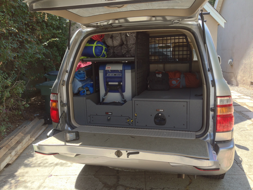

We were beyond fully loaded for this trip. Despite having the drawer system and roof top carrier there was stuff stuffed everywhere in the car. It was bursting at the seams. For a more normal 3 day weekend trip the drawers will make travel very clean. I will be testing it out again in the White Mountains this weekend.

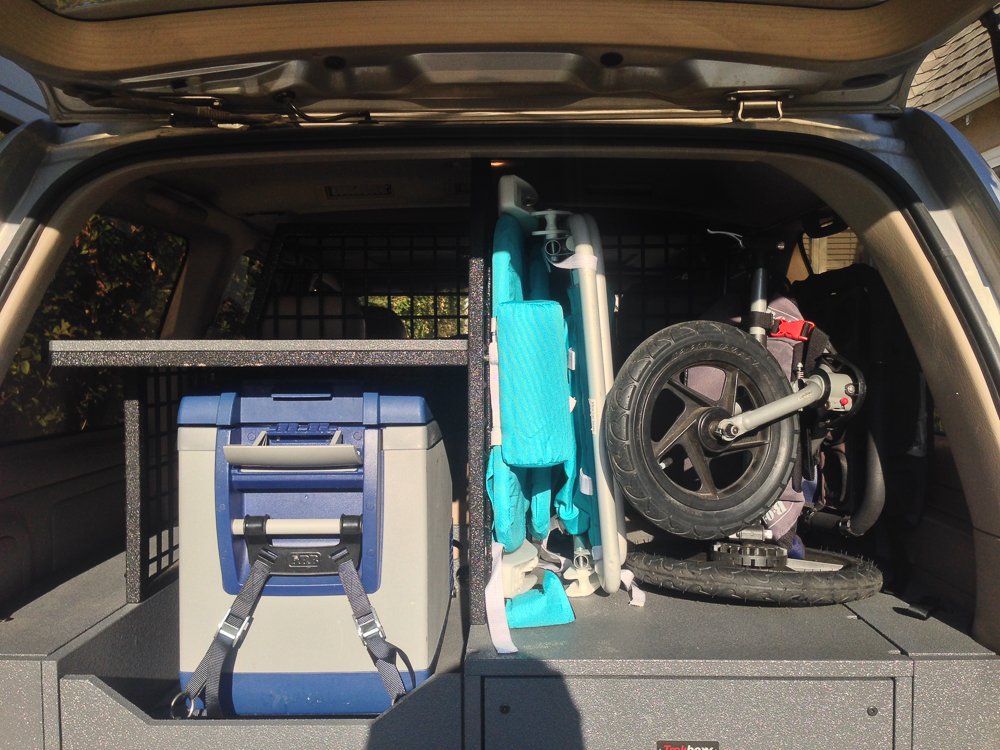

As I mentioned before, my wife's biggest concern was how the system would work with daily, non trail life. What she means is, can she fit the BOB stroller and the groceries in the back. The answer is yes. This is very important for those with kids. A single BOB stroller will fit in. I had to take one side wheel off but I think if I rearrange it I wouldn't even have to do that. My wife wants me to test if our double BOB stroller will fit as well. I will have to report back. There is also no lack of space for groceries since there is a nice cold fridge available and the empty main drawer. We keep everything in a big Rubbermaid box in the garage when we are not camping on expedition.
BOB stroller, beach chairs. Ready for solo trip with kids to the beach.

  1. The fridge slide mounting holes - great suggestion! I plan to incorporate this in the future.
  2. The fridge hitting the cargo barrier - well, remember that the shelf is mountable at 4 different heights, yours being the tallest setting because the ARB 47 is one of the taller fridges. With an ARB 63, for example, it would fit under as well as the shelf being in line with the barrier. It’s not really designed for the fridge to fit back that far, but I totally get the need to maximize your space up front. Hmm.
  3. The finger pull on the shallow drawer being plastic - Yep, believe me, I know. See #4.
  4. Pull handles for one-handed operation - I’ve actually been working on this since the beginning. I’ve bought and tested literally dozens of pull handles. Basically, they are either ugly, too big to allow the tailgate to close, or they are cheap c**p. I’ve finally found a few that I will be putting on my rig and I’ll report back. They’re not perfect, but pretty close. This addition will allow you to throw the finger pull from the shallow drawer into the garbage!
  5. Captive nuts in the cage system - I’ve pondered this a lot. I need an elegant solution, but have not found one due to the tolerance limitations. A not-so-elegant solution is to squirt a dab of silicone caulk into the cross dowel hole while the connector bolt is tightened. Let it dry and then you should be able to remove the bolt and leave the cross dowel in place. But it’s hokey, and I’ll be damned if I’m going to tell a customer to “go and get some silicone caulk…” I’m open to suggestions.
  6. Install issues - First, as Paul smartly suggested the mounting bolt holes have been changed to be a bit wider and much longer, more of a slot. All new systems will have this. The second issue we had, the doozie, was the shallow drawer sticking due to the back piece. I believe this was a result of minor thickness inconsistencies in the coating. This is an ongoing battle for me. Line-X is really great stuff, but it’s not an exact science. Right now my thickness variance is less than 1/64th, but in this case it made the install difficult. Paul was a great help in figuring out a solution. All new systems have a shallow drawer back that is 1/16th of an inch shorter on each end to allow for these variances.

Instead of a pull handle for the drawer show in Paul's pic why not just cut out part of the drawer face, make that the handle? That make sense?
...via IH8MUD app
Nice review - looks like a great product.
...via IH8MUD app
Makes sense. But then you'd have a holy drawer;)
But really, it would be pretty rough on the hands. Paul wasn't kidding. Also, due to the drawer side it would have to be placed farther from the latches.
