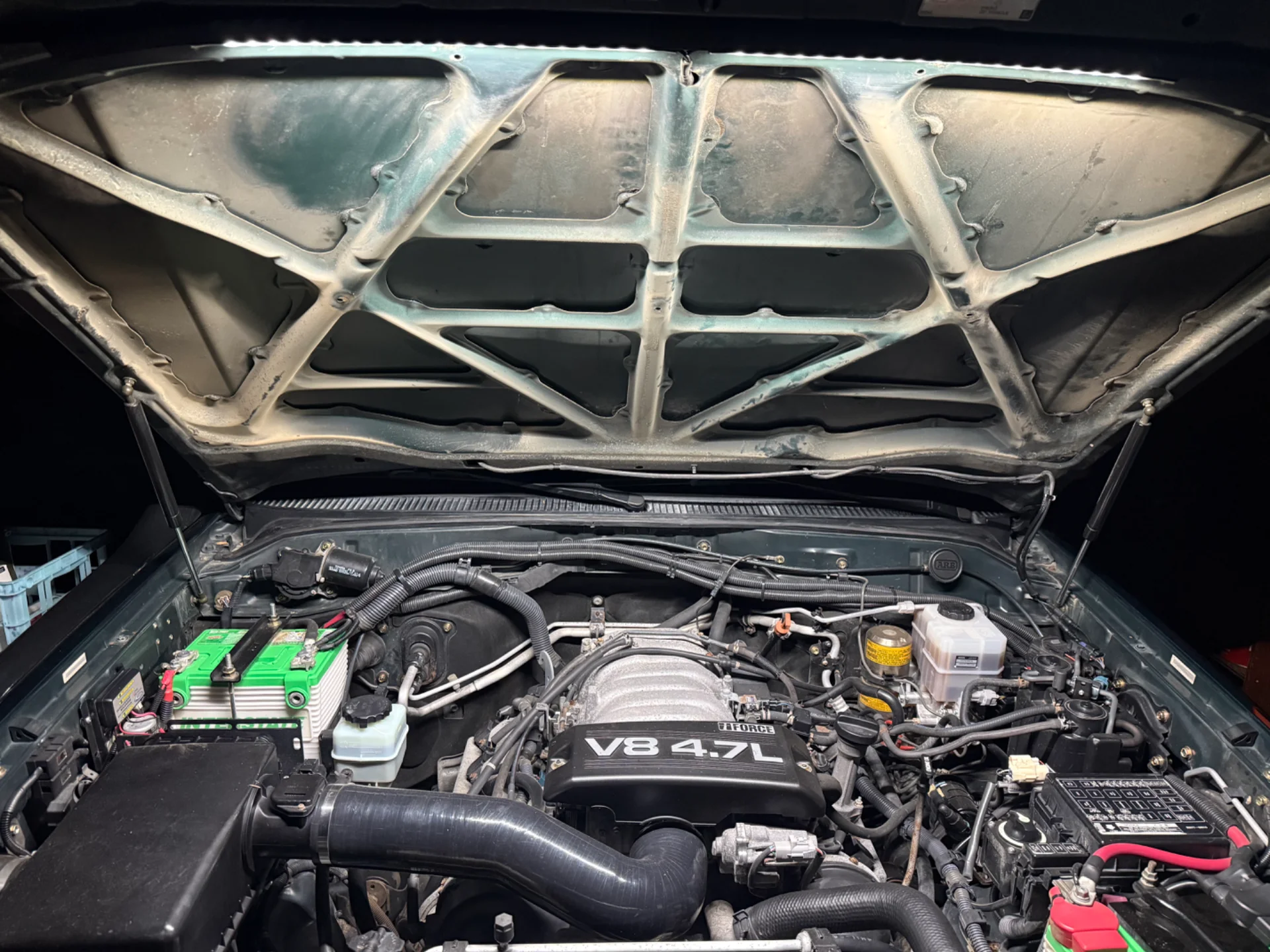

Fun little evening project, installed some under hood lighting, does a nice job of lighting up the engine bay. This is a check kit off Amazon so we will see how long it lasts. I did ditch the switch that came with the kit for a waterproof switch since I don't want it on every time I open the hood.

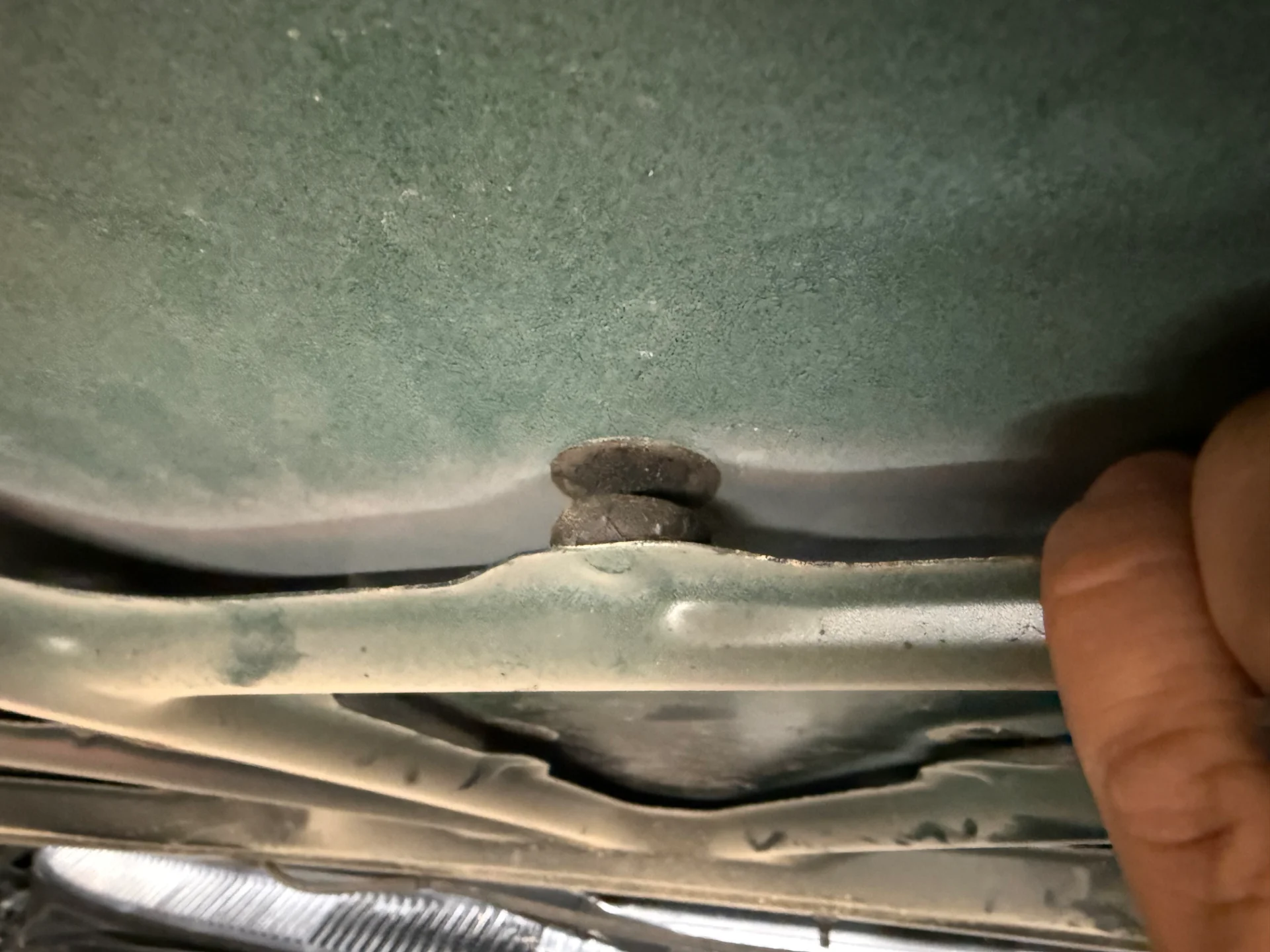

Almost all of the NVH foam securing the hood skin to the frame has pretty much rotted away so I'll be pulling the hood to redo all of it and clean it lol

@DC470 came over today to join in the fun, I told him about my plan to reseal the hood and I guess he decided that sounded like a good time lol.
We pulled the hoods and spent a little bit scraping and plucking as much of the old foam as we could, before we gave the hoods a good power washing and leaving them out to to dry.
We each used on full tube of 3M single part seam sealer, working the sealer behind the frame and filling the voids. Decided on this product due to it still having a bit of give even once fully set up.
I will tell you the difference is night and day! The hood feel and sound super solid! No more "tin canning" and the audible sound of the hood closing is just a solid click.

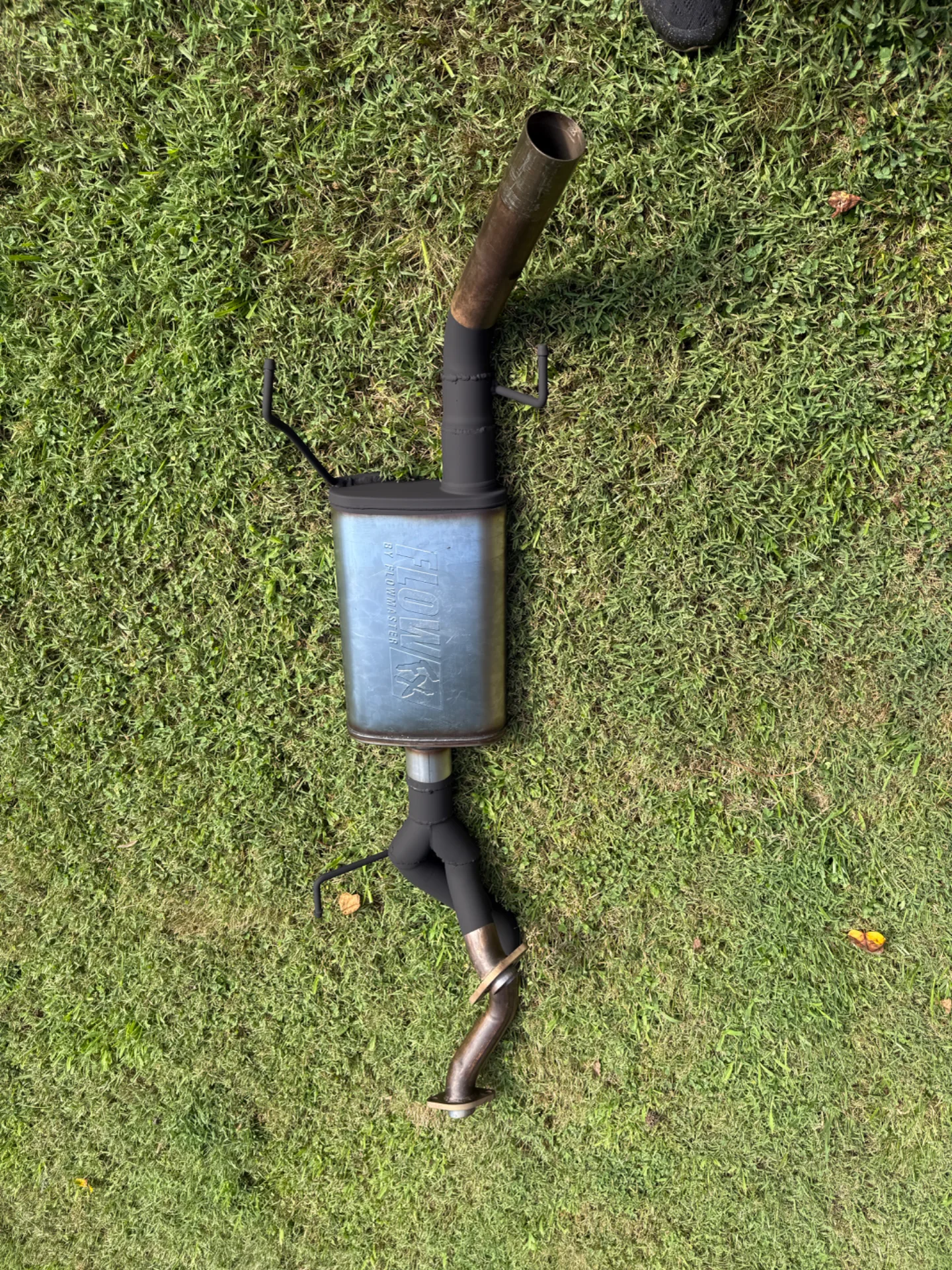

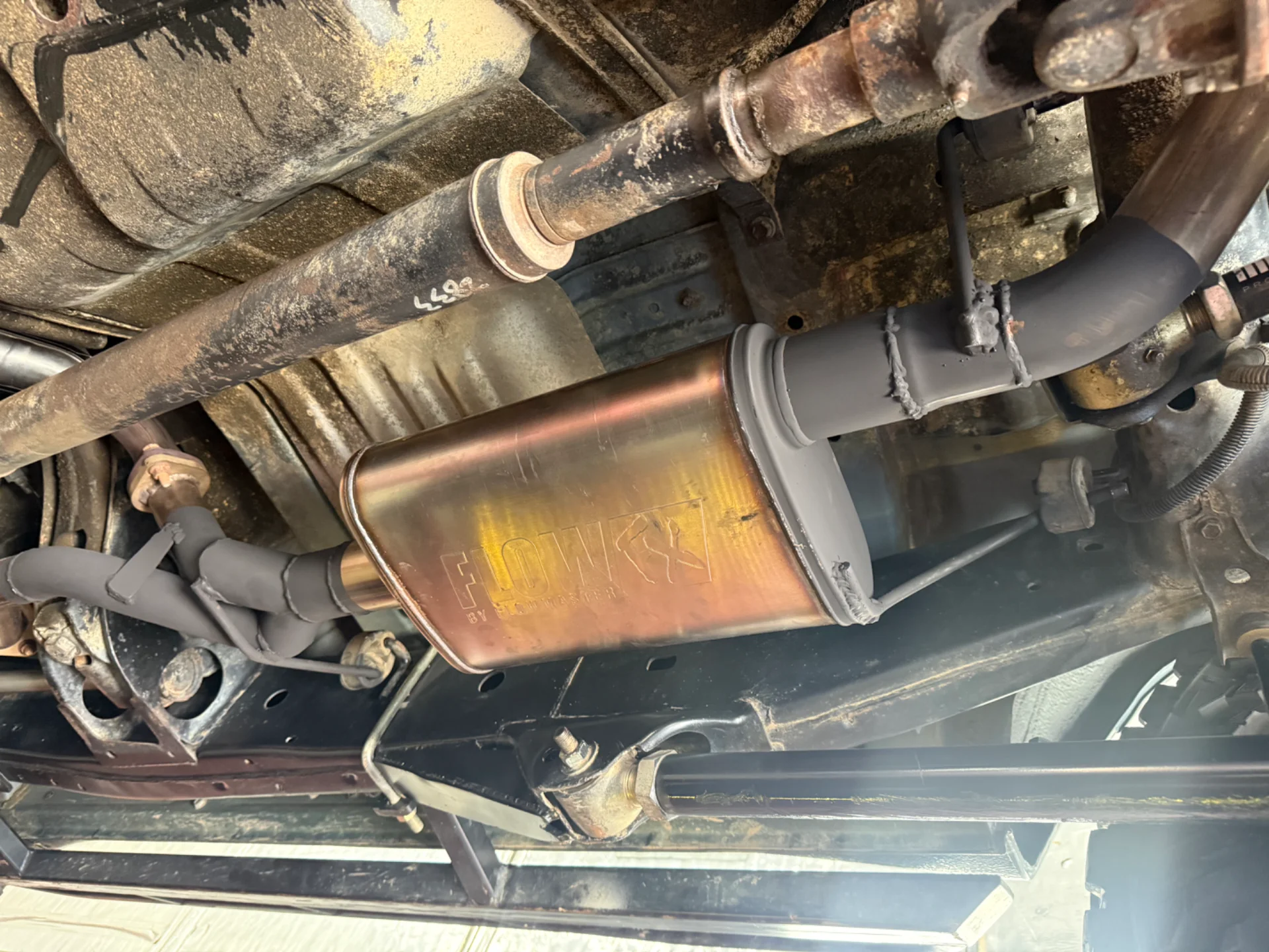

turning back to the rest of my exhaust, I thought the reason for that ANSA mid pipe not fitting properly as due to poor construction. Well when the OEM mid pipe pretty much fit the same way I knew the Borla had been tweaked beyond repair. I reached out to Borla and they did agree to split up a system and sell me just the muffler section at the tune of 900 dollars which was not in the cards at the moment. So i cut all the piping of he crushed Borla, bought a Flowmaster FX and got to work.
This was the end result, it sounds great, is tucked up higher out of the way, has a similar tone to the Borla, and the best part only costed about 80 dollars and some time.

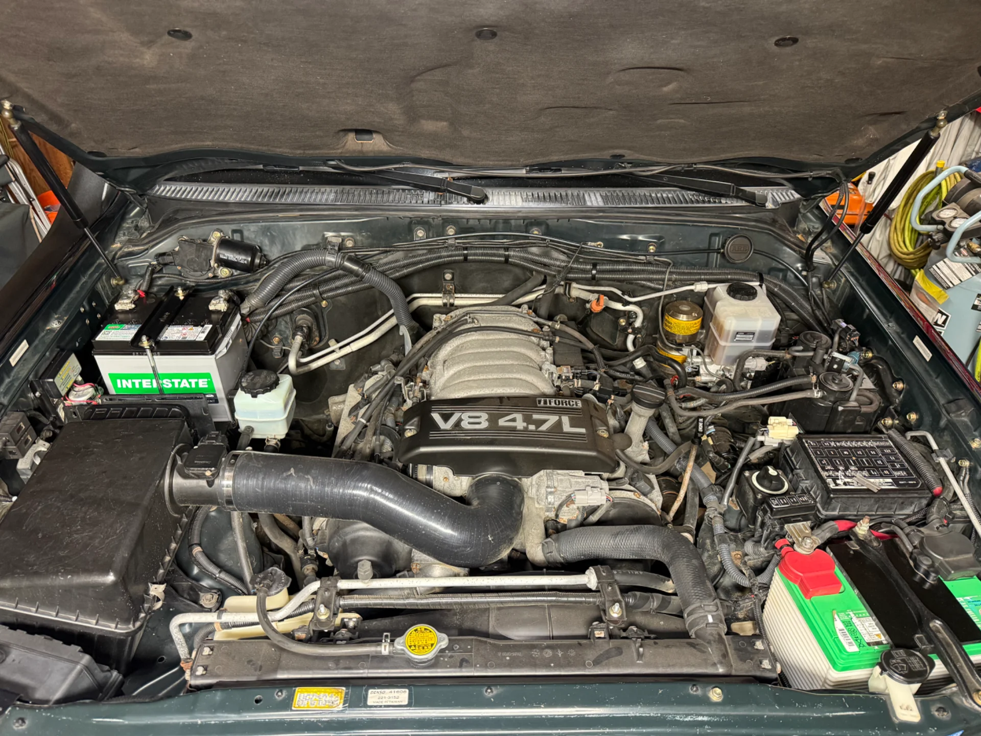

Well after 6 years of having my Dual battery set-up I finally have an issue out of the aux Interstate MTZ-75DT.
Regrettably truck has been sitting around a fair bit and not hooked up to the on board tender but I went out to it the other day and the alarm for the aux battery was going off indicating a low charge. I plug it in not thinking much of it and left it on charge for about 3 hours until I took it to run some errands. Drove it about 15 mins to the hardware store and when I came out the low voltage alarm was going off again, again I didn't think much of it since I didn't have it on charge that long and figured I'd plug it back in when I got home.
Got home plugged her back in for the rest of the evening until this morning. This morning is where I started to notice some issues.
Came out to unplug and drive it to work. As I walked up, I first checked the battery monitor in the truck which was reading full charge on both batteries (no surprise there as it was still plugged in) I had left the hood up for whatever reason over night and as I was unplugging the on board NOCO I just was giving everything a glance over. I reached up just to confirm the battery terminals where tight on the aux battery and they were very warm, boarder line hot, the whole battery was! I checked the voltage with a meter and it was reading 12.2. Now I know that AGM's will get warm while charging but this felt more than warm honestly took me by surprise. Drove it to work, no signs of an over charging, everything was normal. About 3 hours into work I walked out just to check the monitor in the truck again and it showed almost down into the red (indicating low charge)
Pulled the aux battery and dropped it off at Batteries Plus, where they will run some tests on it and report back tomorrow but they think its probably bad based off of a quick load test they did with me there. According to that quick test they showed the battery to be at about 40 percent and only producing 300 cold cranking amps vs the 715 is should be.
I'm complaining but not at the same time, the battery is 6 years old and has done its job powering my fridge on trips and other accessories but, I was hoping for a bit more life out of a 430 dollar AGM battery, we will see what the verdict is tomorrow.

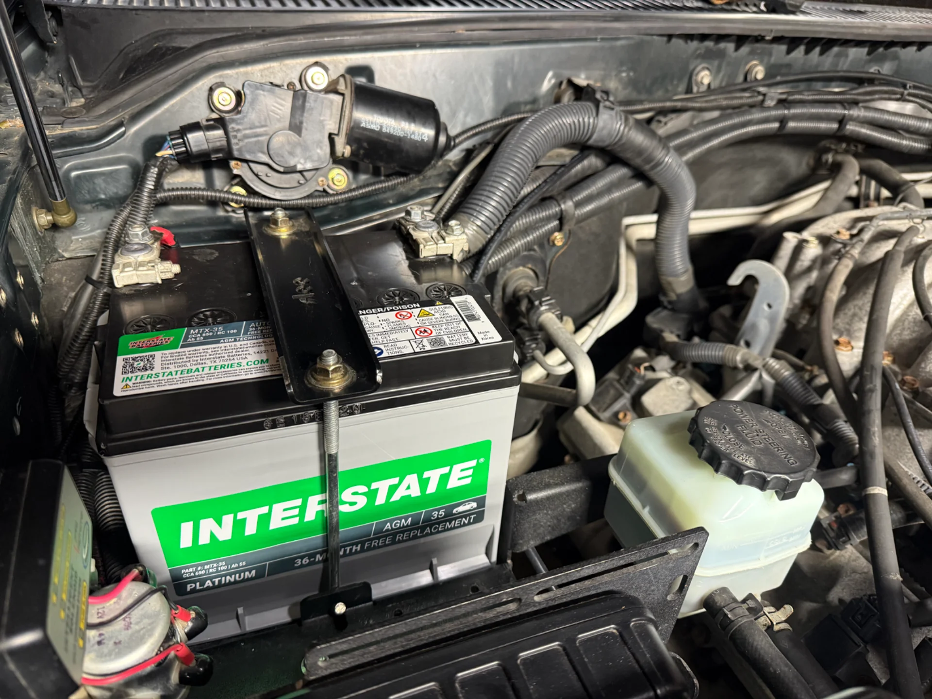

Small update on the aux battery. It did test out bad, I order another one from a interstate vendor just to be called back a day or two later and was told they couldn't get it. I found that interesting so I called and actual Interstate batteries store. Again I was told they didn't have it but could order it. Perfect ... go ahead and order it, was told they would call in a few days once it arrived. Kinda forgot about it but it has been about a week so I reached out....
I was told that interstate is discontinuing that model and they were unable to get it
So now I'm switching gears to modifying the Slee tray to accept a bigger battery. I don't run anything in the air compressor spot so this shouldn't be to difficult.
Just figured I'd pass along the information about the MTZ-75DT interstate. I know there are other battery that fit in the slot (odyssey, optima yellow tops, some duracell agms ) but if I have to replace it I might as well try and get a bigger more common size in there
Ended up settling on the MTX-35 Interstate AGM, no modifications to the tray were necessary. The battery has roughly the same foot print but is about an inch taller, Hood clearances are fine. The MTX is Interstate's mid grade AGM line up, they do offer the group 35 in the higher end MTZ line but I couldn't justify the additional cost and the spec are very close. The biggest difference is about 5ah less which is never going to be a problem for me. Whenever my MTZ start battery dies ill swap it to match
Did redo quite a bit of the dual battery wiring just to clean up and better secure some of the cables

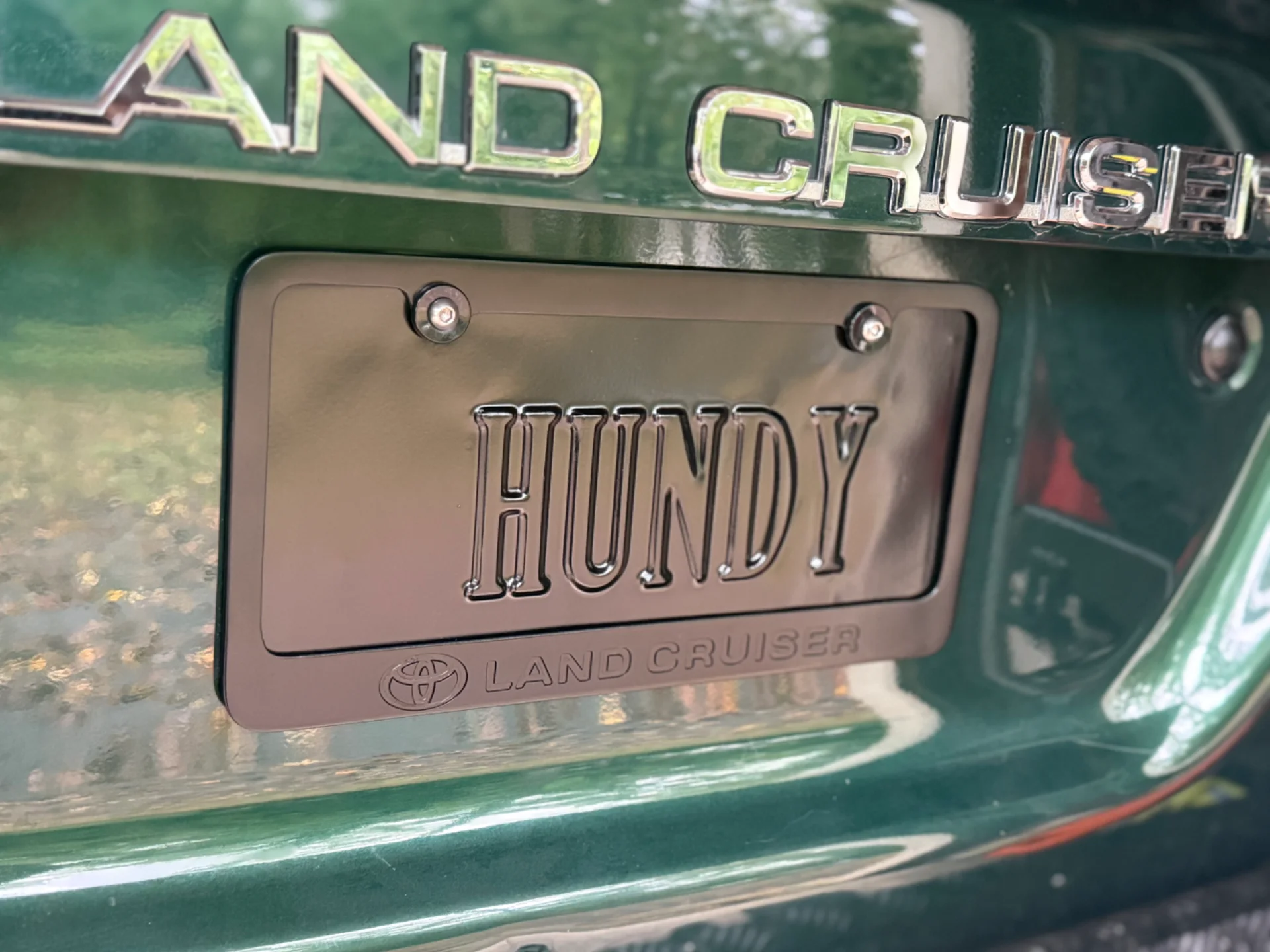

@D21FJ60 was nice enough to send me one of his "HUNDY" tags from his gone but not forgotten 100. Scuffed it an spray bombed it black to add a bit of flare. I've never had a vanity plate, I guess I kinda do now lol
I succumbed a couple years ago when Colorado started offering black plates...
All the 100 related and TEQ related references I could think of were taken so I went with my username.
I've always wanted too, but having a lot of vehicles its an extra expense that I haven't been able to justify. Maryland gets enough of my money lol
