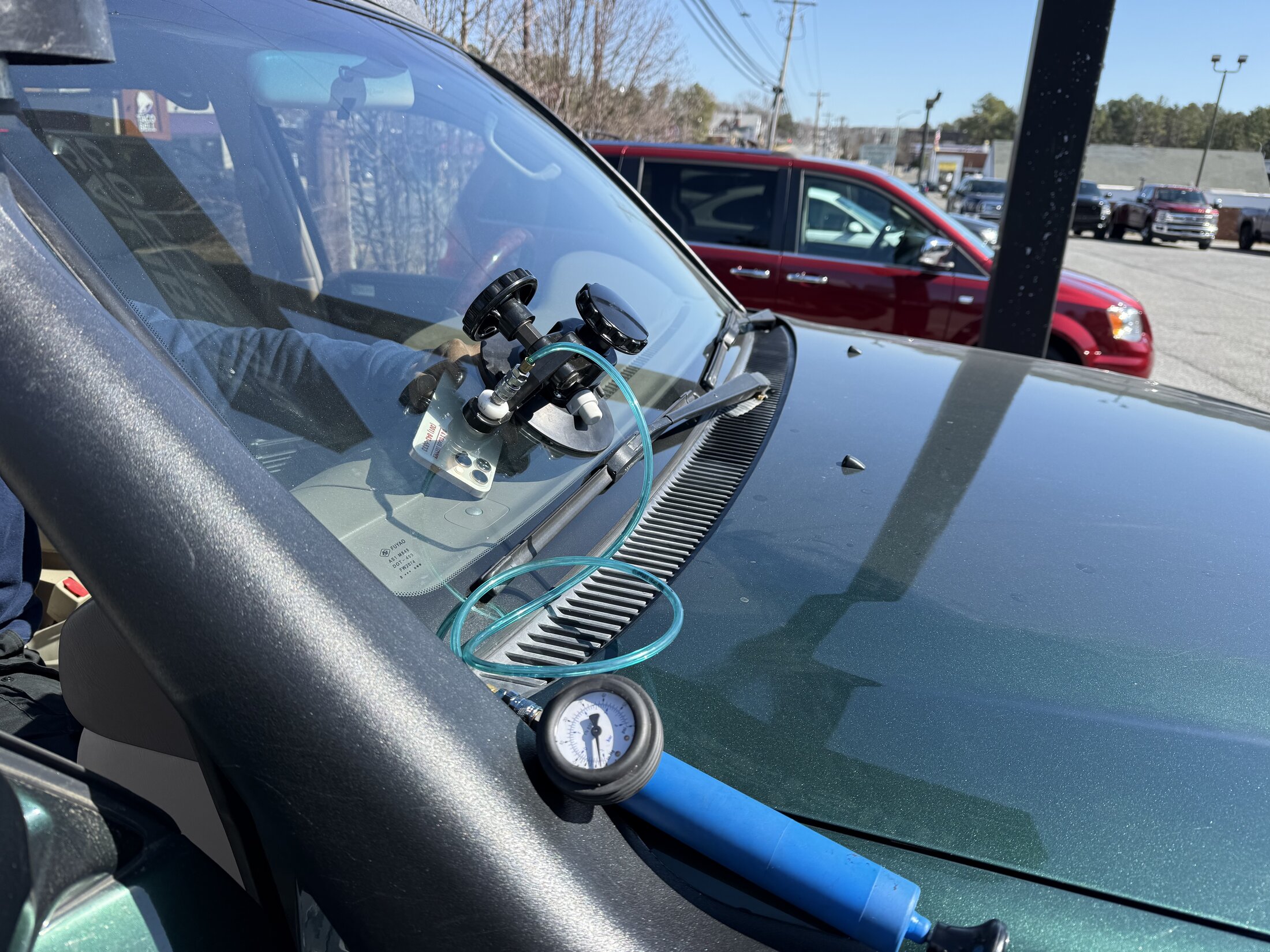

Had my buddy that works for a glass company fill a small chip in my windshield, been there for about two years just didn't want it getting any worse. sorry nothing exciting to report
Did that recently as well...proper windshield replacement for these is becoming a lost art with many claiming they can do it, but few that actual avoid common shortcuts. And it's so expensive either way. Gotta get to those chips early.
ya well if you read back to the beginning of this thread you'll know why I got him out to do it lmao
OMG, what a s*** show. That's inexcusable to give this difficult of an installation to "the new guy". That's basically malpractice. Just imagine if you hadn't walked down there...what they would have tried to get away with. Not that they'd be able to cover all that up...
OMG, what a s*** show. That's inexcusable to give this difficult of an installation to "the new guy". That's basically malpractice. Just imagine if you'd hadn't walked down there...what they would have tried to get away with. Not that they'd be able to cover all that up...
ya it was pretty bad but its fixed right, and it jump started the build. So at this point its just another chapter in this trucks story. That was definitely in the top 3 of the most pissed off ive ever been

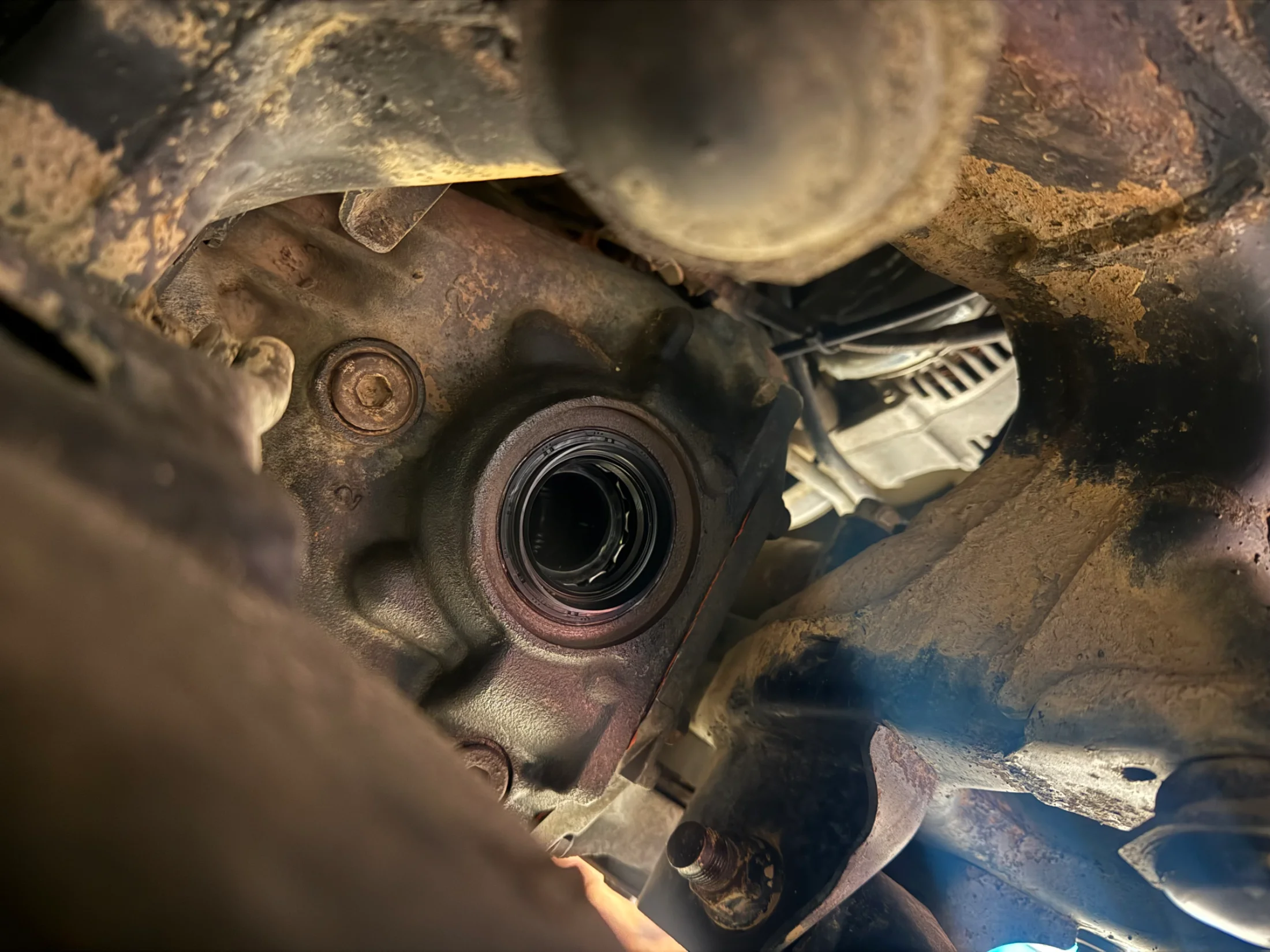

Did happen to notice the passenger side front axle seal has sprung a small leak so I'll deal with that shortly

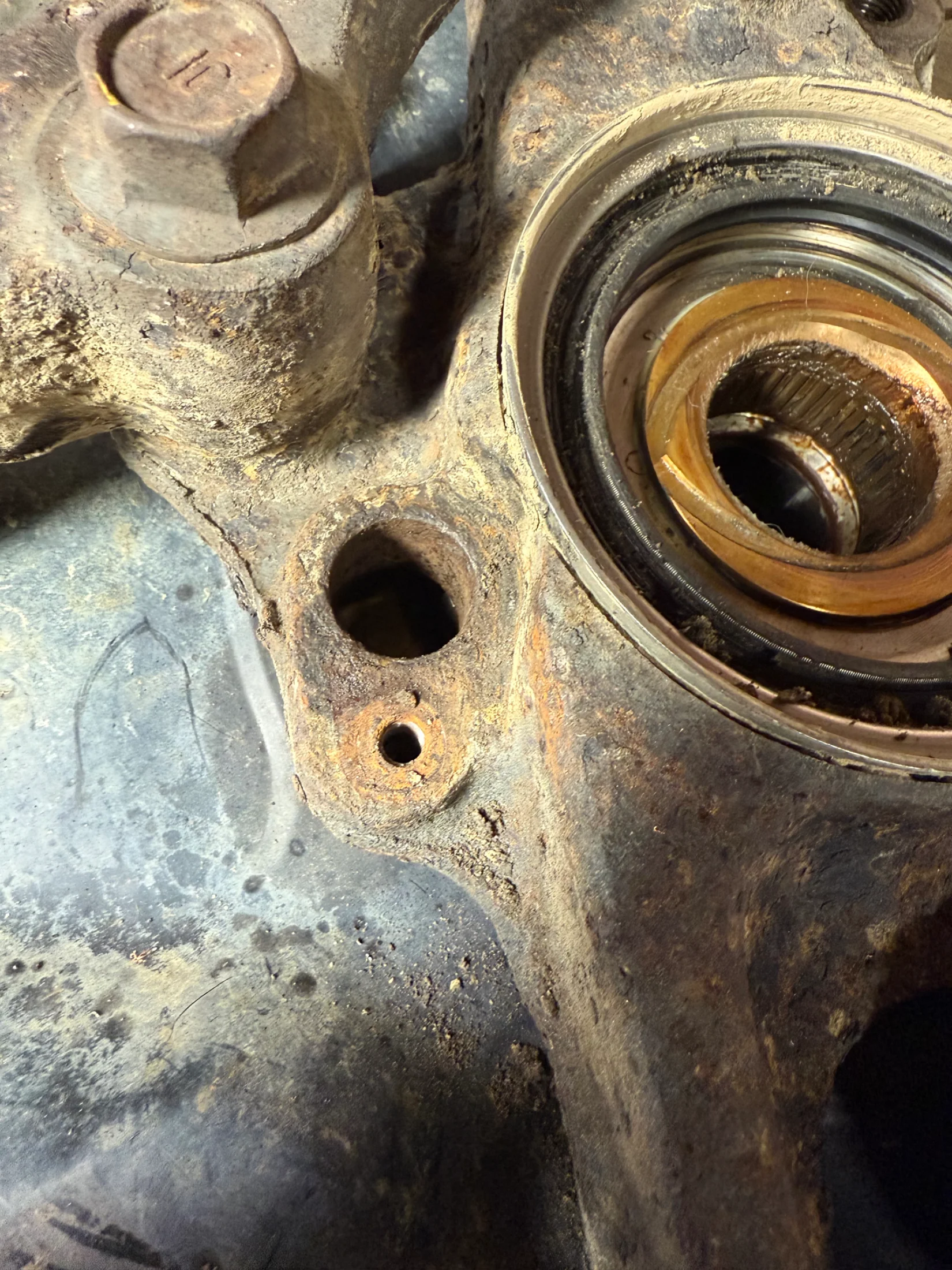

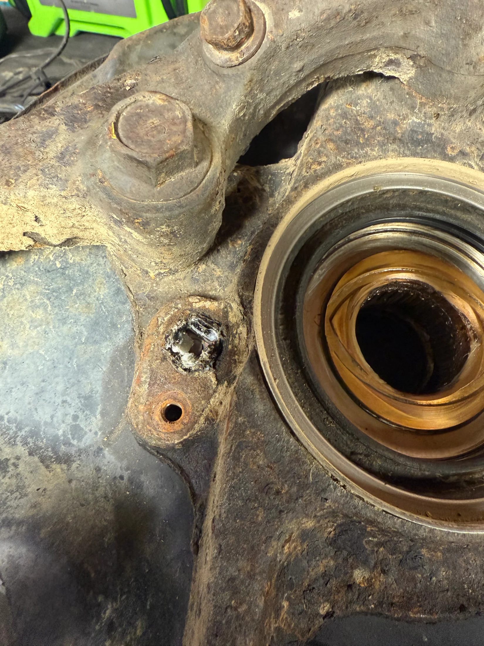

Tackling the passenger side diff seal over the weekend. Everything was going great until it wasn't lol. Decide to pull the entire knuckle assembly just to make better access and to no surprise the abs sensor was stuck. Had to extract that, order a Holstein one from parts geek since a few have had good luck with them and I'm not paying what Toyota wants for it lol

Just waiting on that and the crush washers for the diff to finish it up
I never try to take out the ABS sensor from the knuckle. It is way easier (and safer) to unplug from the other side (under the hood) and then just get the whole cable come out from wheel well.
now he tells me :rofl: .... hindsight is 20/20
The Holstein sensor works great, seems to be a quality replacement part. No lights and even better yet no leaks from the diff
