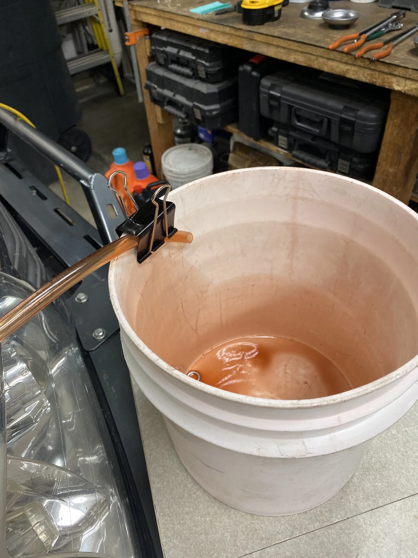

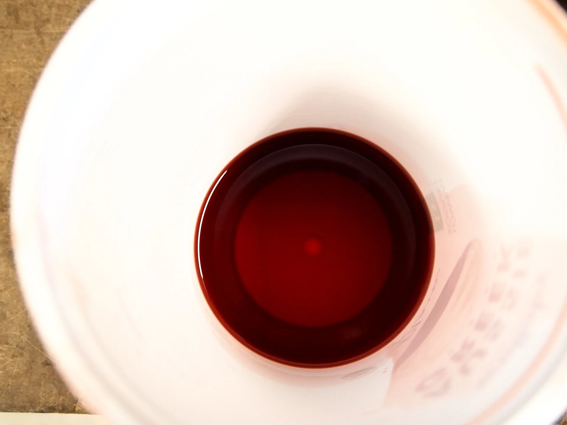

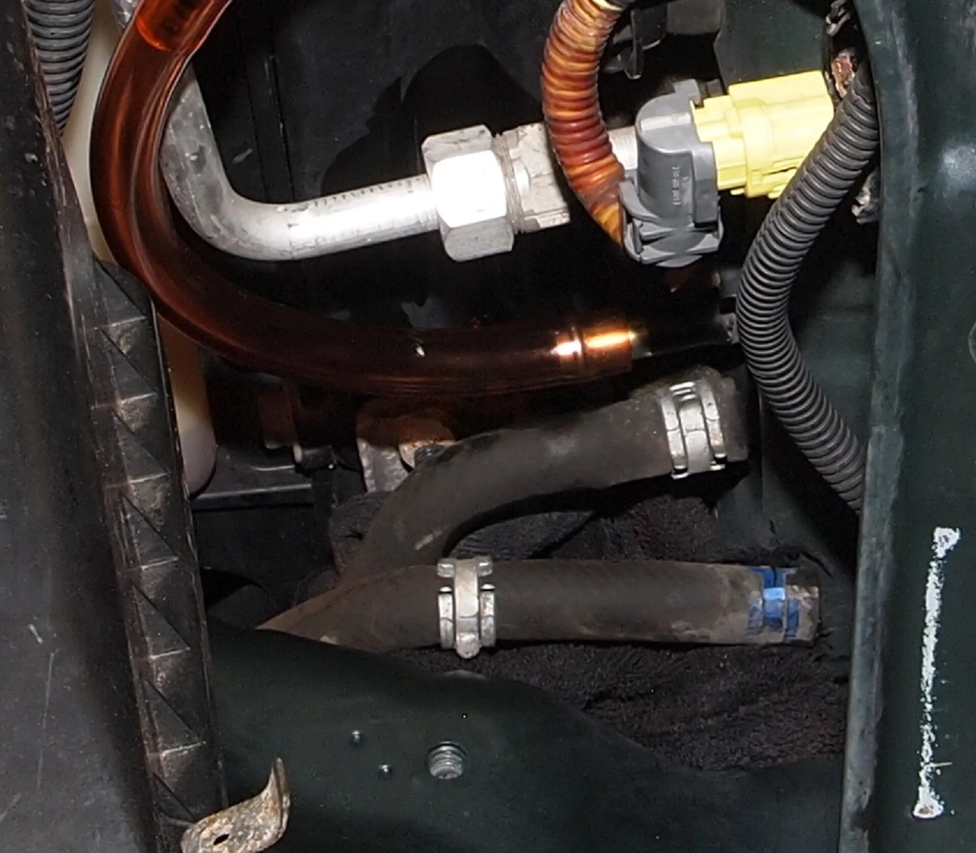

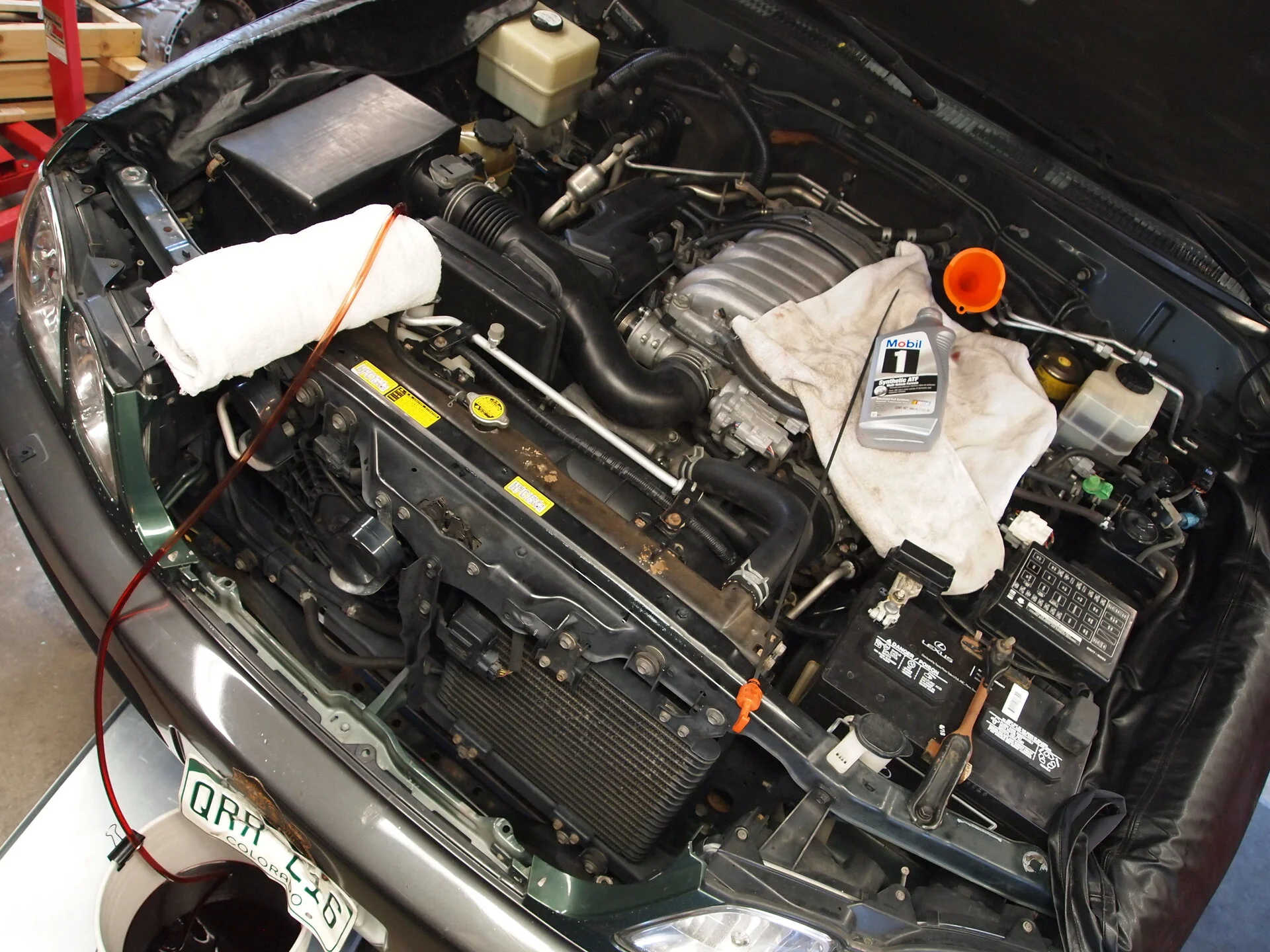

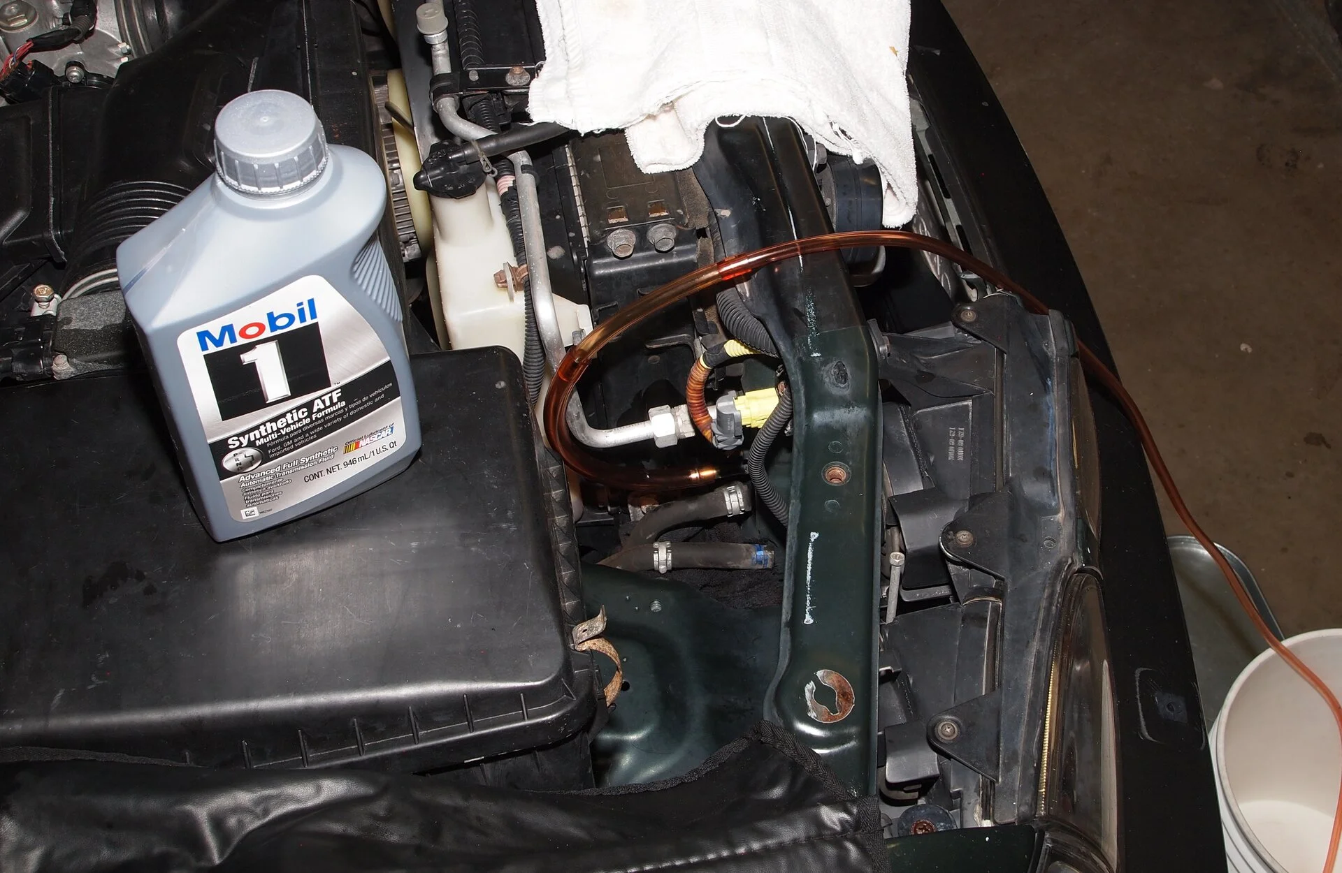

I attach a clear (clear hose so I can see ATF as it passes through) hose to return pipe, at side of radiator. Run to my catch can. This way I get both pre cooler and main cooler flushed. It's the top one nipple. But warning: Once someone switched lines, and I dump a qt or two on the shop floor before I noticed. So it's not a bad idea to run a catch hose off the return hose also. But you can just let return hose lay off to the side.
I always start by draining the pan, installing new drain plug gasket and retorque to 15ft-lbf. I record exactly what came out pan. Add that much plus 1/2+ qt. back to transmission. Then start engine to pump out aft, as I fill through dip stick. I watch very close how much comes out. I usually need to shut down engine after ~90 seconds. As I can't fill as fast as it comes out. I measure ever drop I remove, and replace same amount less 1/2 qt. Then come back and top once return hose connected to nipple and at ATF at 157F.
