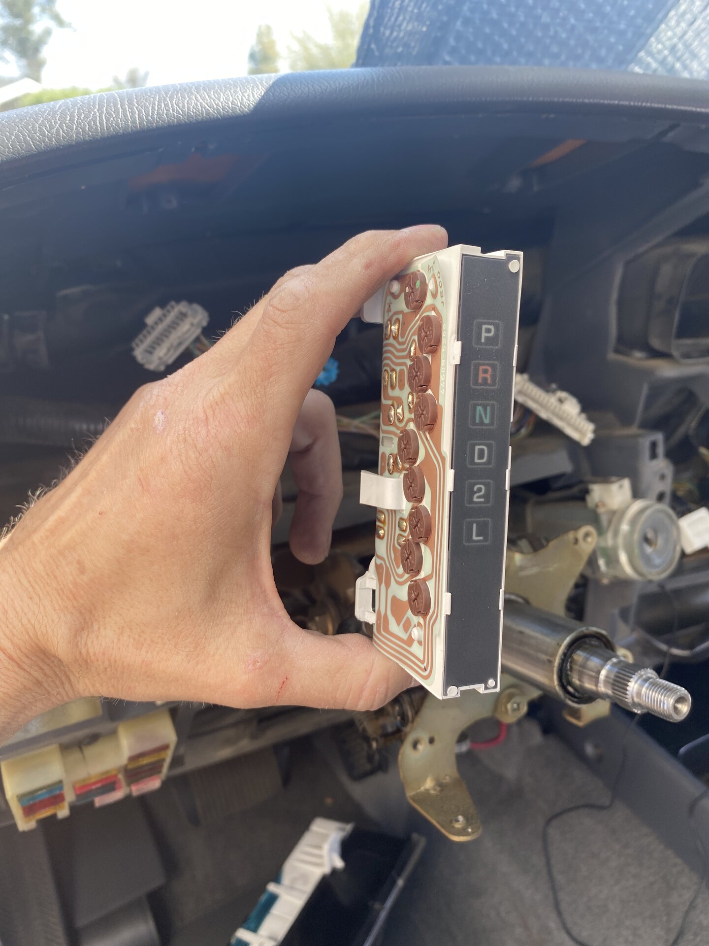

Well, I’m more than 10 minutes in so far, but I’ve just about got the dash cluster out and ready to put in the replacement bulbs.
Well, it took a few hours, and I took the opportunity to clean up some wiring. Ran into a couple things. The transmission is still acting like it was.
On a cold start when I put it D, it is in some sort of a limp mode. Doesn’t really move and limiter is at 2000 RPM. If I switch to L then back to D it shifts as normal.
The O/D light is working properly now and I’m not getting any codes.
Also, I replaced all of the lights and tested them in place on the bench. I don’t remember if they were working before or not, but P and N are not lighting up now that it’s back together. I do have a shiny bright D though!

Anyone have ideas about where I should look for the P and N light issue? I tested and replaced those bulbs yesterday, so it has to be somewhere else. I found a photo I took a week or so ago and the P light definitely wasn't working then so it's not a new problem.

Maybe the nss?
First instinct is to check the large barrel connector above the starter. Have seen the phh leak and drip coolant into that plug and rot it out on SEVERAL occasions.
