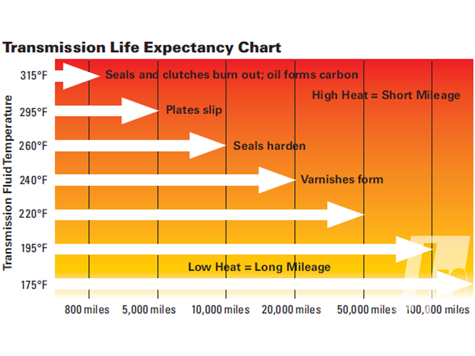

It's a little dated, and hasn't been updated in a LONG time, but here's some actual data.
WOW! To say that I’m impressed by your research and data is an understatement!
Based on your findings I’m feelin’ pretty darn good…thank you for pointing me to your thread…good stuff!

This is an incredibly outdated chart.
Provide a chart then.....that you consider more appropriate.
Bear in mind we are talking about transmissions that are 20 yrs. old in some cases.
And fluid types the same.
Fluids have been improved over the years (and many are backwards compatible).
The transmissions in our 100 series (and going back to the 80 series) are robust and were manufactured using good quality components ( a huge plus).
But it remains, heat (and lack of regular fluid changes) will result in decreased transmission life (the point being made in the chart), whether you agree with the mileage estimates or not.
