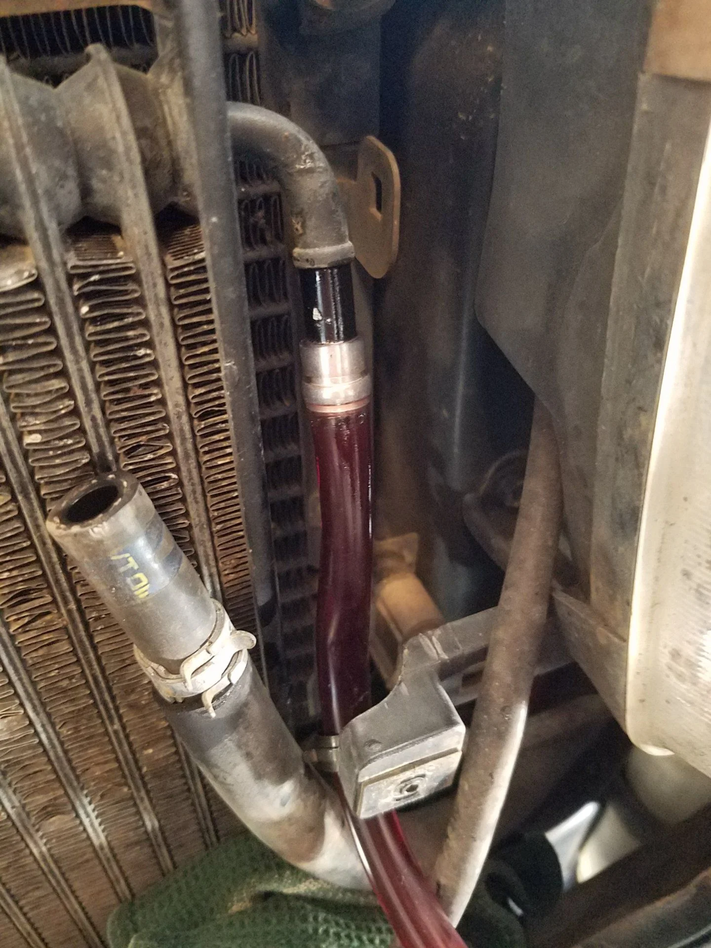

For anyone who missed this:
THE FLUID COMES OUT OF THE TOP PORT OF THE TRANSMISSION COOLER
Just disconnect the top hose, then attach your tubing to the same pipe. Nothing will flow out the top hose, just keep it pointed up to avoid drips. No need to undo the bottom (would be a PITA with my Slee bumper with a ton of wiring down there).

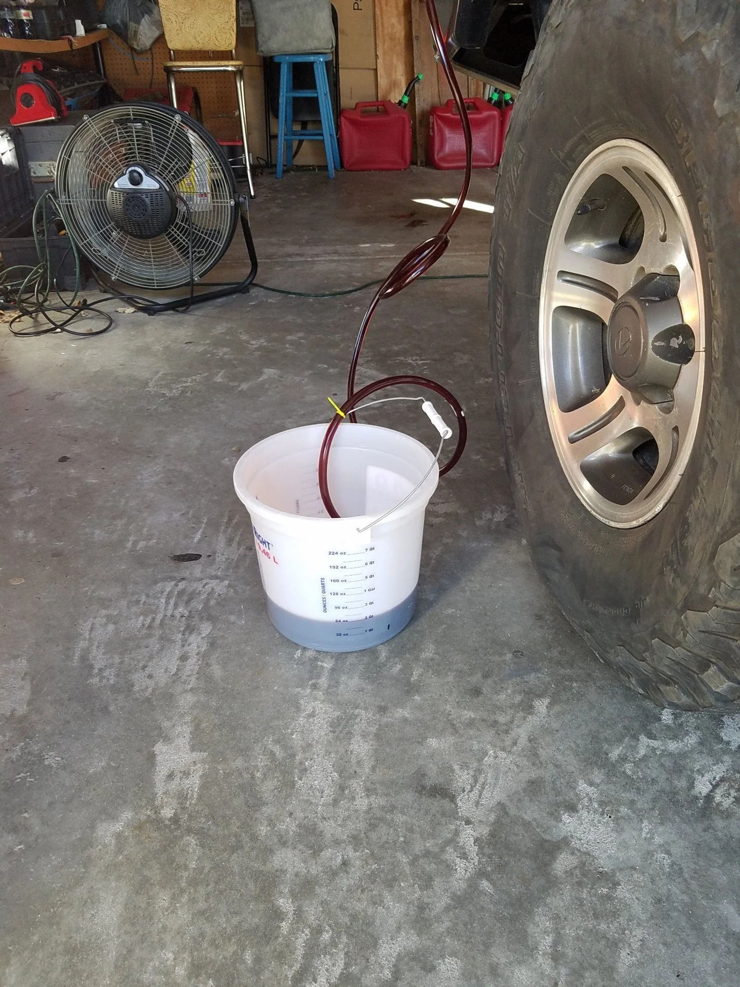

Rodney flush is awesome. I put about 16 quarts through and it was coming through the clear tube nice and clean by the end. Filling through the dip stick tube is definitely the bottle neck of the process, watch how quickly you pour or you will end up over flowing the fill tube and making a mess. Found a cool 2 gallon "paint" bucket ($4) at Lowes with graduated quart marks on the side, it was translucent as well! This allowed me to pull the bucket out to the side of the truck so I could see it filling while i was in the truck running the engine. Did 2 quarts at a time. On the final fill cycle I only added about 1.5 quarts just to make sure I didn't overfill the tranny, then fine tuned it until the level was perfect on the cold marks on the stick. Some complained about the house clamp on the out flow tube from the cooler being backwards and hard to get to, try a set of 45 degree angle jaw needle nose pliers, piece o cake! Trust me, you won't use another set of pliers for any of your house clamps after you use those. Overall a super straight forward PM, been meaning to get to this for like four years now, hoorah!
Something about seeing that fresh clean fluid flowing through the clear hose is so satisfying. Great idea on the clear bucket and long hose that you can see from the drivers seat.

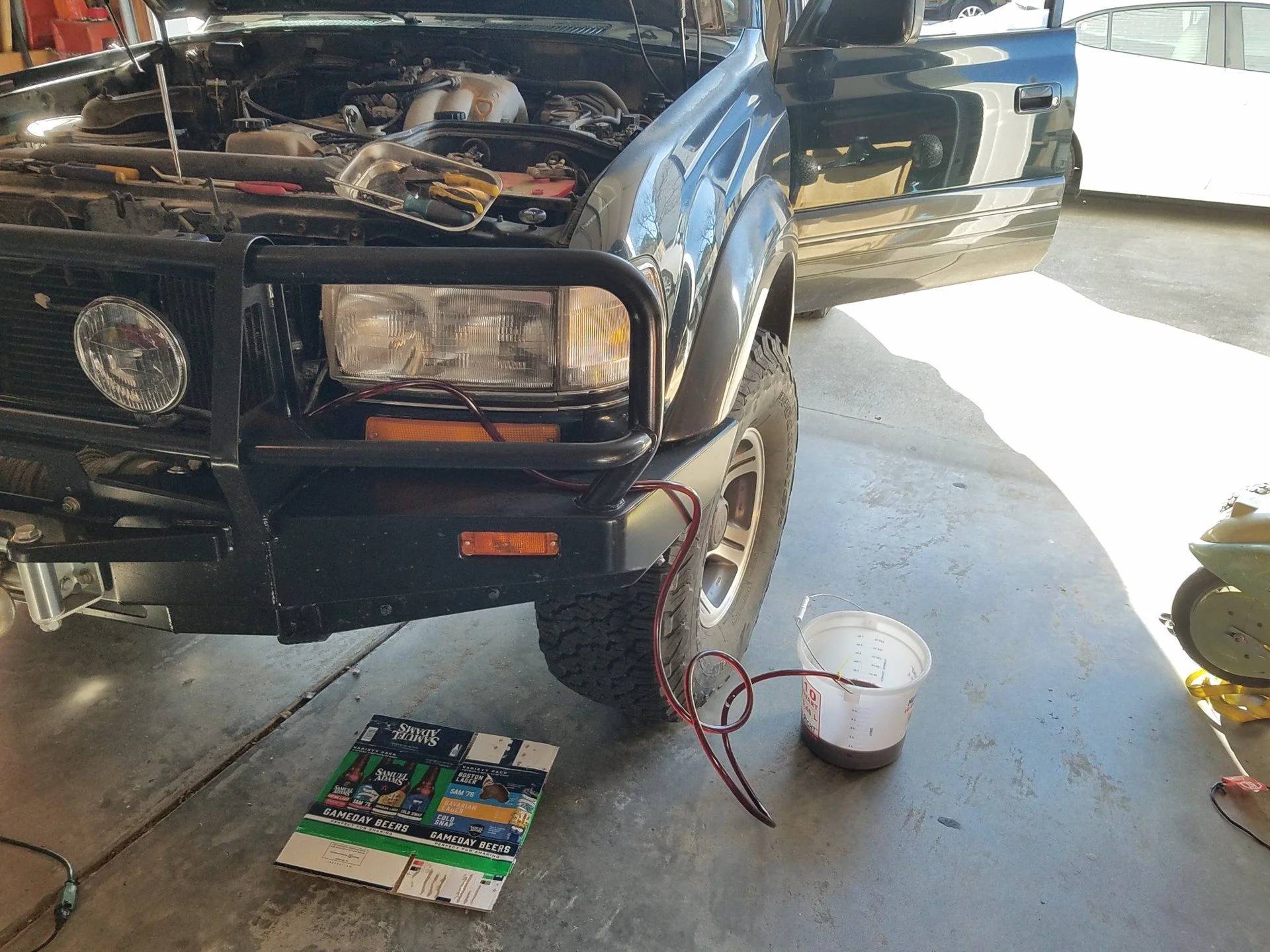

I was wringing my hands quite a while until I just did it. And like many have said, other than the small stuff of removing the grill to access the lines, this is easier to do than an oil change (no oil filter to remove). I drained and filled the pan and used old 5 qt motor oil containers to put all the old tranny oil in. I made sure to add back exactly what came out over the course of the job (I ran about 20qts of Castrol synthetic transmax through it (for Asian vehicles, not the high mileage variety--no real reason, just wanted a clean transfer).
I had a good long snout tranny funnel and frankly, it's so bloody easy that I don't know why one would complicate the process with external pumps. Just use ~10 feet of clear line from the tranny cooler as described above and put the catch container (I used a clear gallon former mineral water container) in a place where I can see it fill. I started the car, ran as long as I felt comfortable there was fluid in the pan (maybe half a gallon). I slightly overfilled for these intervals. After the first or second interval, you'll feel comfortable to step on the brakes and move the tranny through the gears slowly, after first filling the pan with new fluid.
REALLY easy job. Sorry I waited so long. I guess the reason I used Castrol Transmax for Asian vehicles is that I had 350K miles and I wanted as close to OEM as I could find. Walmart (I can't believe I'm now a regular for motor oil, tranny fluid and Jelly Beans) was by far the best source for Castrol of all varieties, delivered, and inexpensive.
The tranny shifts so smoothly now, and seems to keep the engine in a tighter band between shifts. Slight shifts up and down when I hit slight inclines like it's flexing its muscle. Keeps the engine revs more steady.
