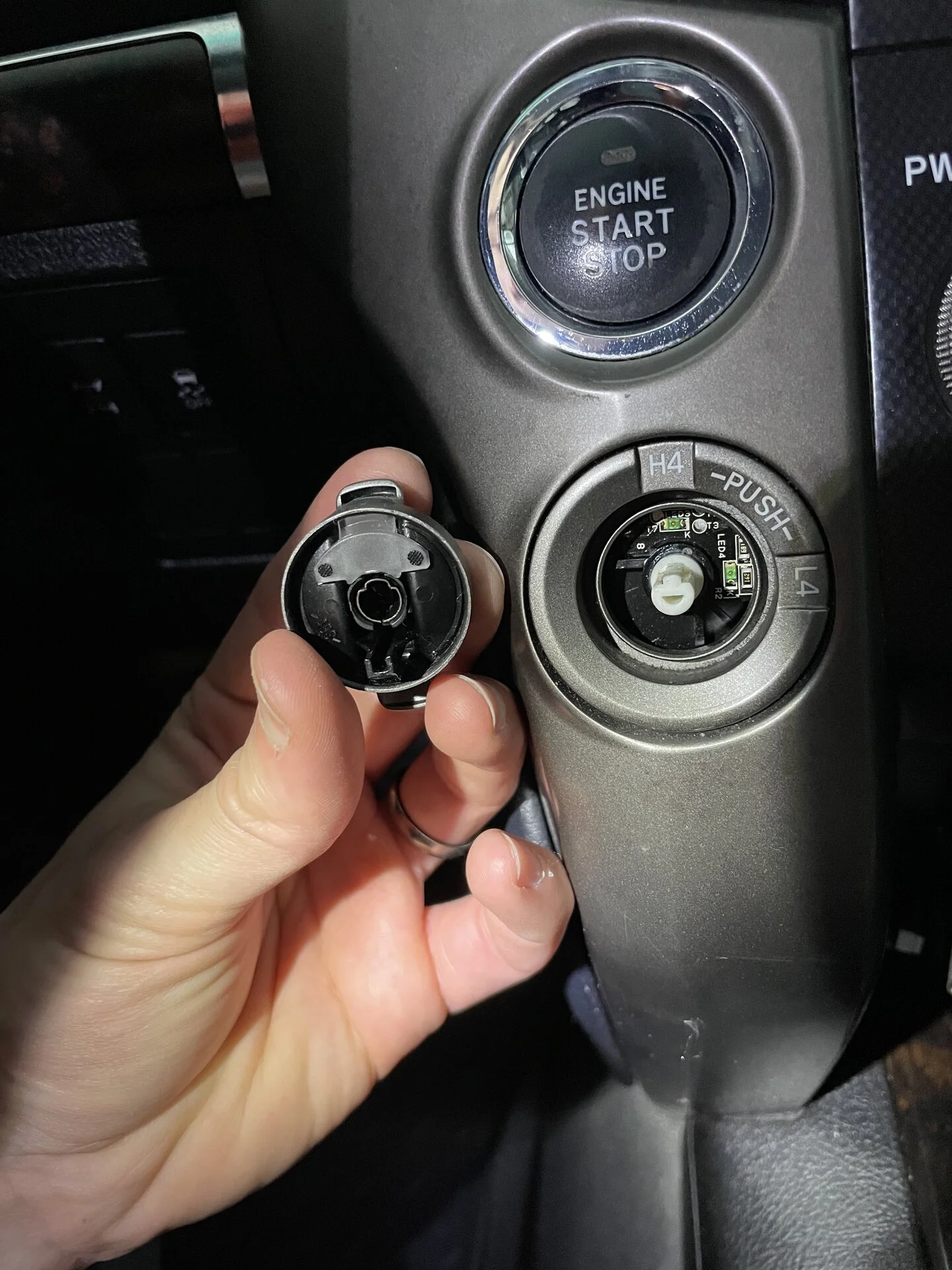

Slight anecdote for my specific scenario incase anyone encounters the same thing. I had been having the typical flashing lights that everybody reports and slow engagement. I started engaging the diff lock and 4lo daily to hopefully get everything smoothed out and working better.
All worked as it should for a few weeks and suddenly the 4lo stopped engaging. No issue with center diff. No lights or sounds of struggle with 4lo just no response. Very frustrating.
Followed every ounce of advice in this thread and tore into the actuators multiple times (many thanks everyone!) and couldn’t make any progress.
Finally realized the 4hi/4lo selector knob on the dash had cracked and wasn’t actually turning the switch. Turned the switch with a pair of pliers and *bam* engaged.

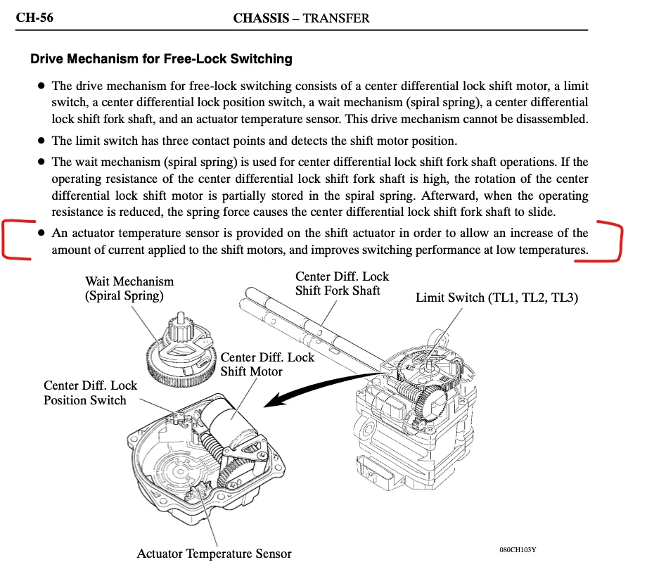

Re-reading the thread as I've been having issues with my CDL flashing pretty much every morning recently. Thinking I'm going to have to finally bite the bullet and disassemble the motors and clean them. I'm hoping they aren't so corroded that they're unrecoverable

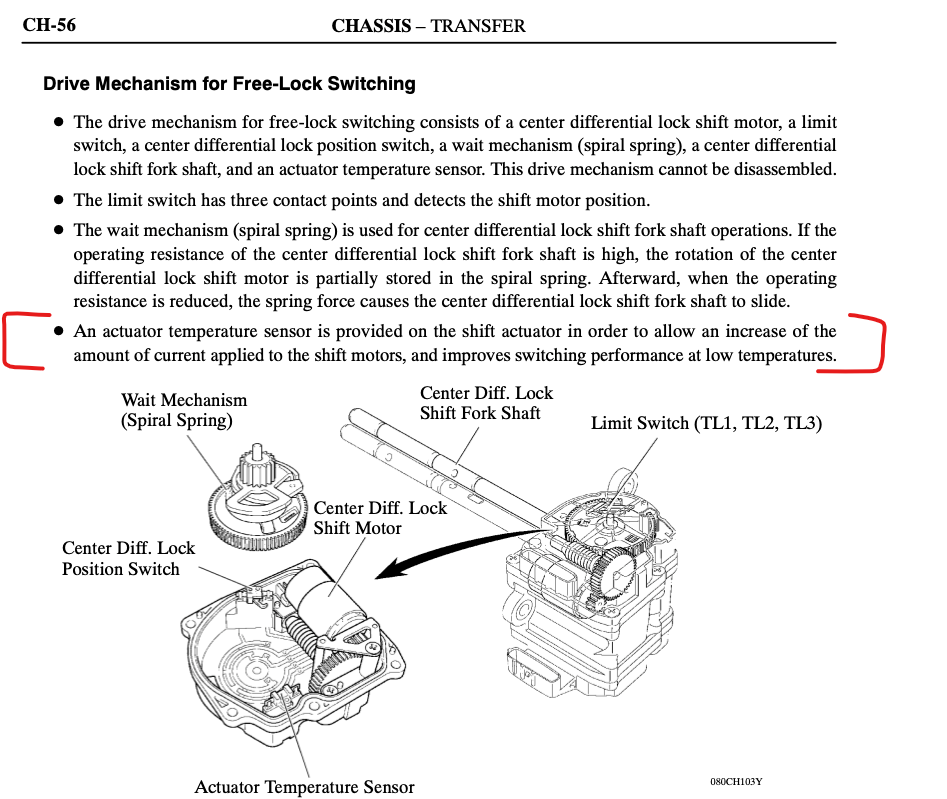

Interestingly when re-reading the thread I noticed the info below. I'm trying to find out at what temperature the sensor operates. The FSM says pins 5-to-27 on the 4WD ECU should show between 0 and 5V. I'm assuming that when the temp sensor closes it reads 5V and when it opens it reads 0V. Beyond that I'm not sure what's happening when it closes as the FSM shows all voltages measured are typically 11-14V, so it's not like the system is kicking up to 24V or something. It does make me suspicious that this sensor is why many of us only see issues when it gets cold though
I don't believe it's related to this compensating logic. At some point regardless of compensation, it cannot deliver enough current because of contact corrosion. The fault is temperature sensitive, and battery voltage sensitive, because the switches in the system are electromechanical. Wear and corrosion creates resistance making them more sensitive to these factors. Then the faults can occur even before actuation which is why I'm suggesting this.
From what I've seen, it's the wiper switches switch leading to further wear of the motor brush commutators. There's also a microswitch that corrodes then reporting false actuator position.
Certainly could be, it's just very strange that it never ever happens for me above ~55-60F. TBH I'm just hoping for an easy fix... i.e. "just apply 5V across these 2 leads and it always steps up the motor voltage as if it's cold out and so the issues that happen when it's cool out but not cold enough to normally warrant the extra kick when the sensor closes no longer apply".

When I had the actuator apart, I jumpered the motor directly to a 12V source. The response was sluggish. I don't imagine any compensation logic to provide much boost beyond a direct battery connection.
That's what drove me to clean the motor brushes via electronics cleaners. It woke up the motor dramatically.
