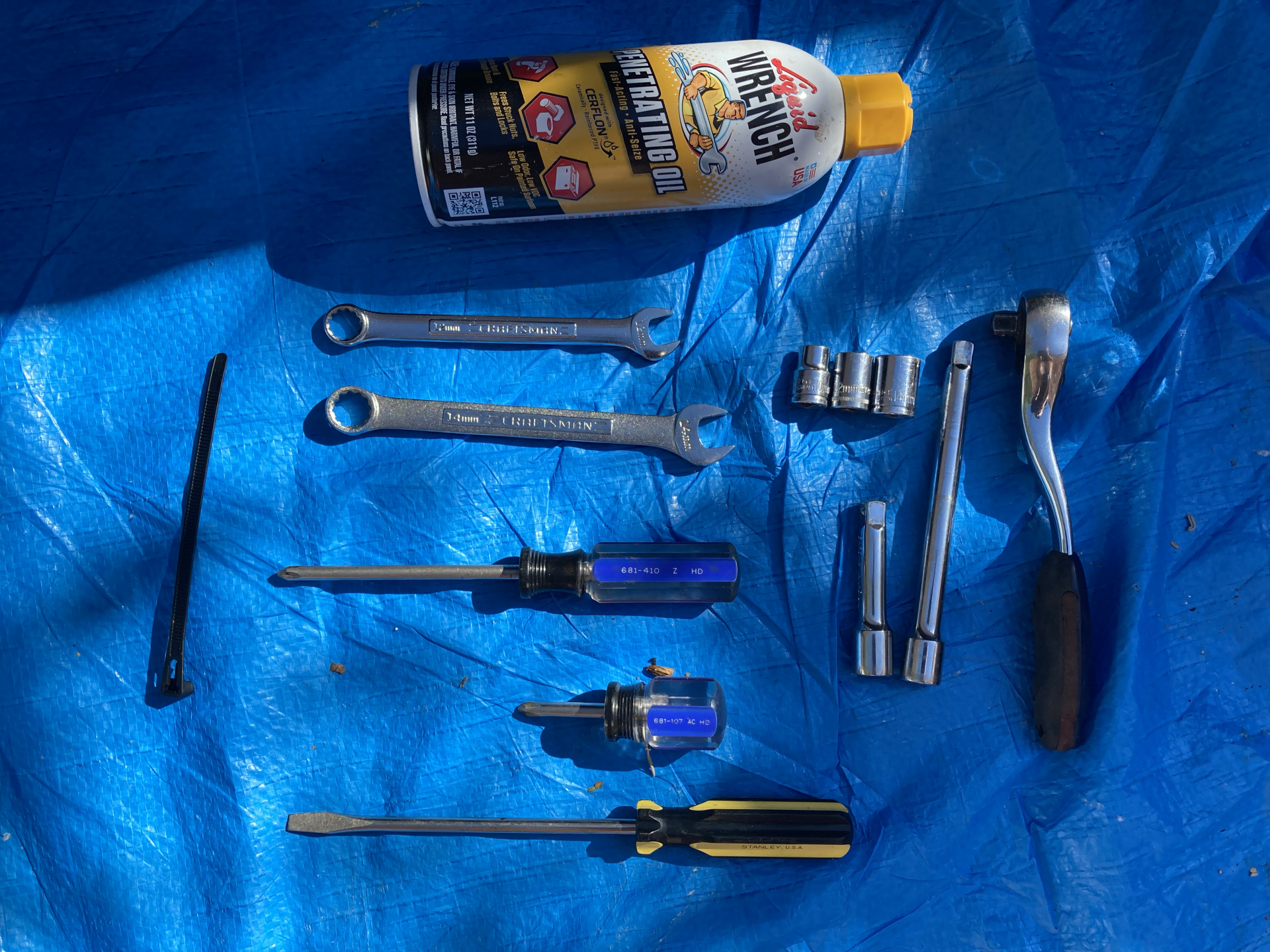

Tools needed:
- 10mm socket
- 12mm socket
- 12mm wrench
- 14mm socket
- Flathead screwdriver (to release electrical harness clips)
- Stubby short #2 Phillips screwdriver (You must have a short screwdriver to get the screws at the top of the actuator)
- Scissors or a knife (To trim the breather tube if it's shot)
- Zip tie to reattach the breather tube if needed
Optional:
- 14mm wrench
- Penetrating oil (to spray the transfer case rods)

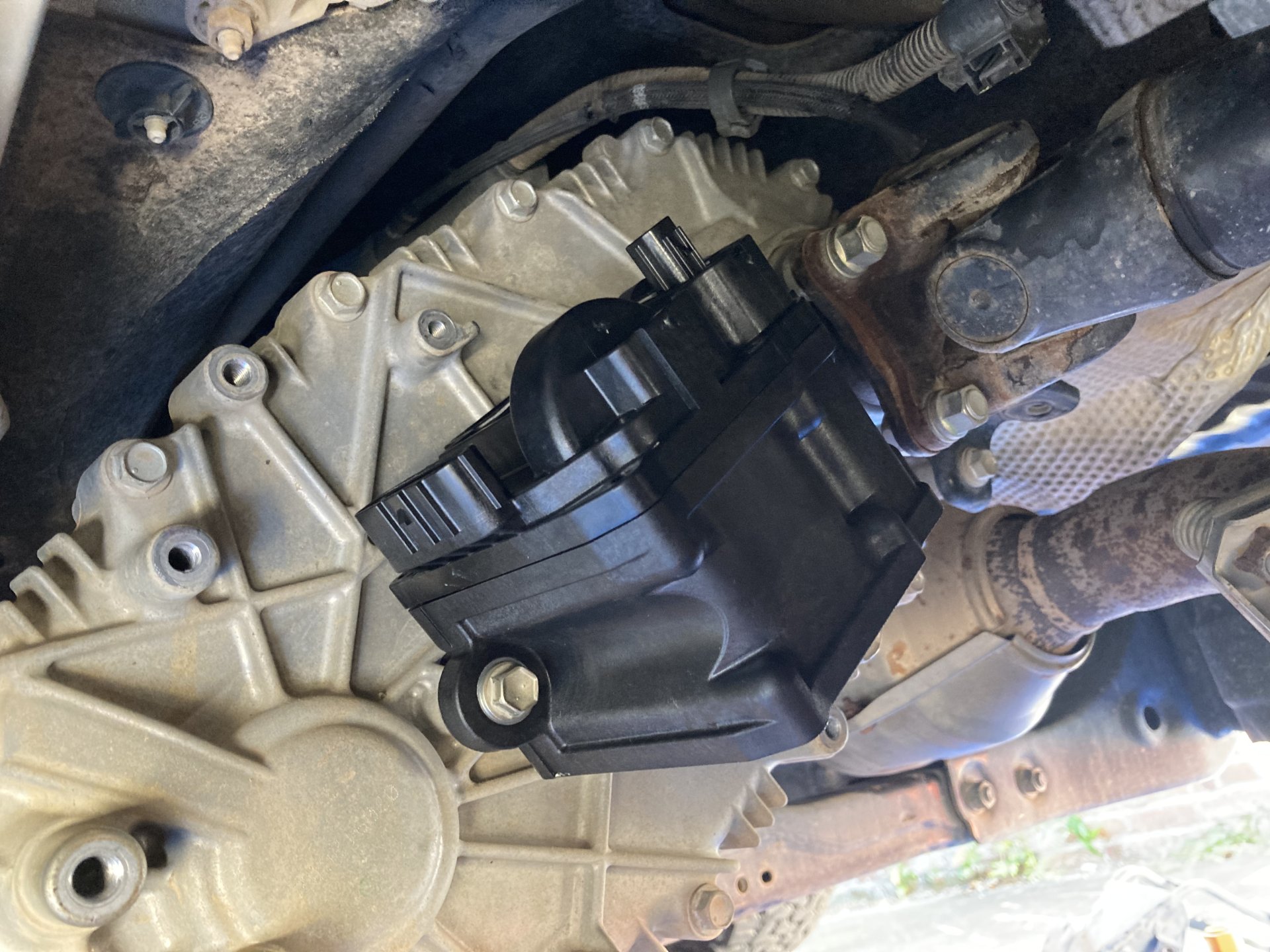

Here's what the actuator assembly arrangement looks like on the transfer case. This pic will be useful when you're trying to put it all back together. The guards are a bit of a puzzle, at least they were to me when reassembling. *Note the funny black weight attached to the transfer case in the center of this picture- I assume it's to dampen any vibrations- engineers are smart like that- the 100 series has similar looking weights attached to the frame:

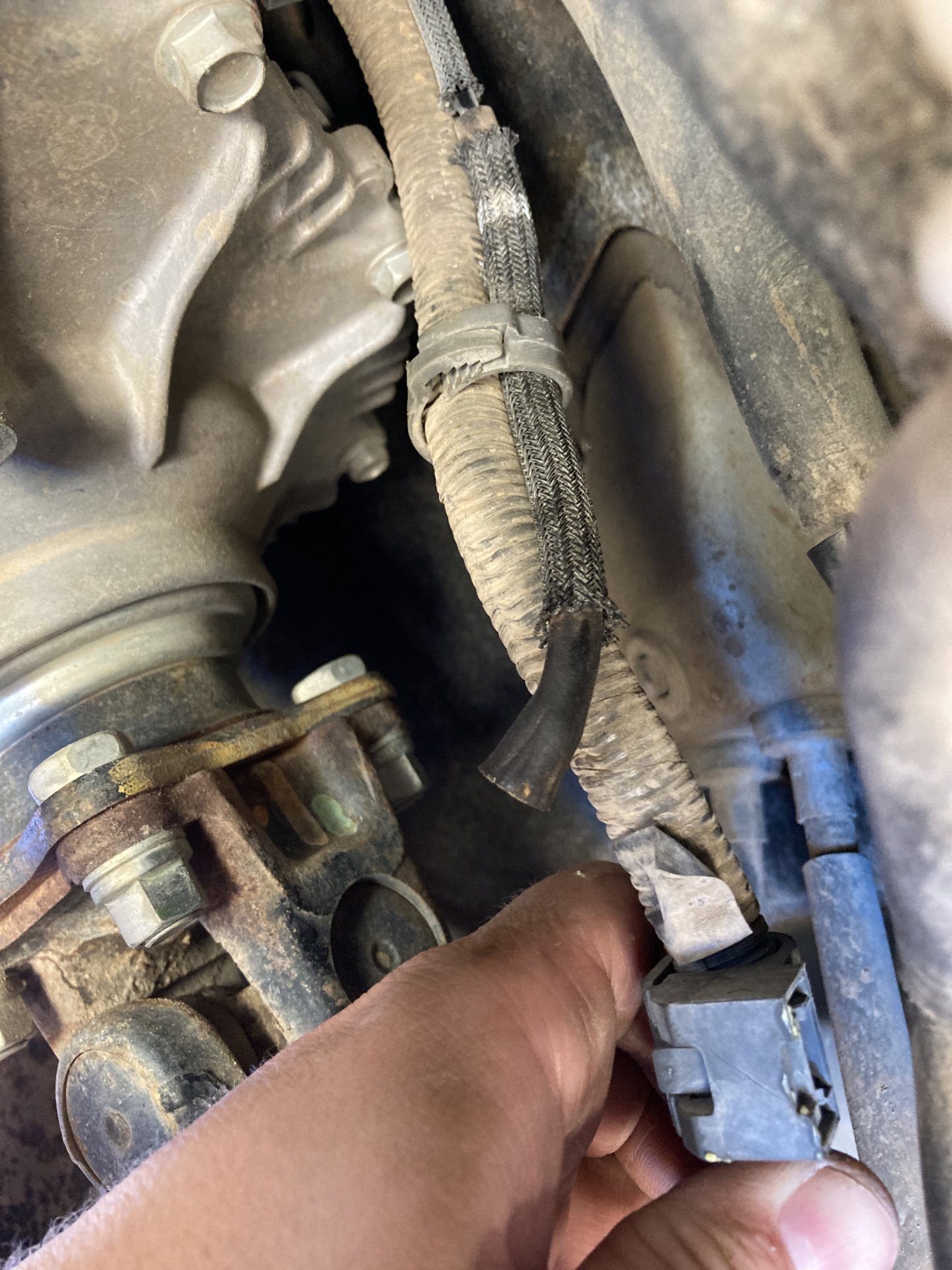

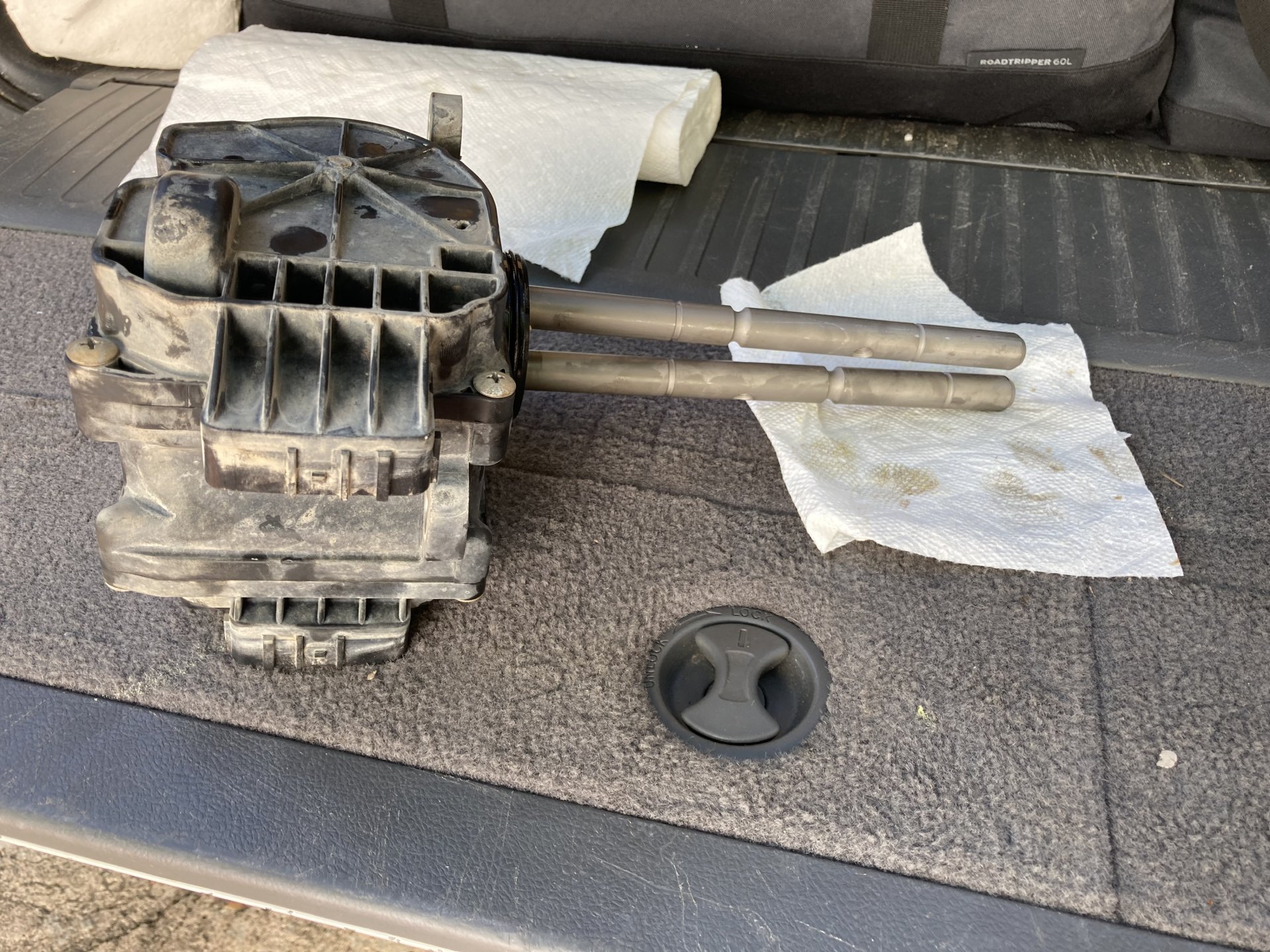

Here is the old actuator. Note how corroded and rusted the components of the top CDL actuator are. The diff breather hose was completely disconnected and frayed thus leading to corrosion from intrusion of moisture:
Part III of V

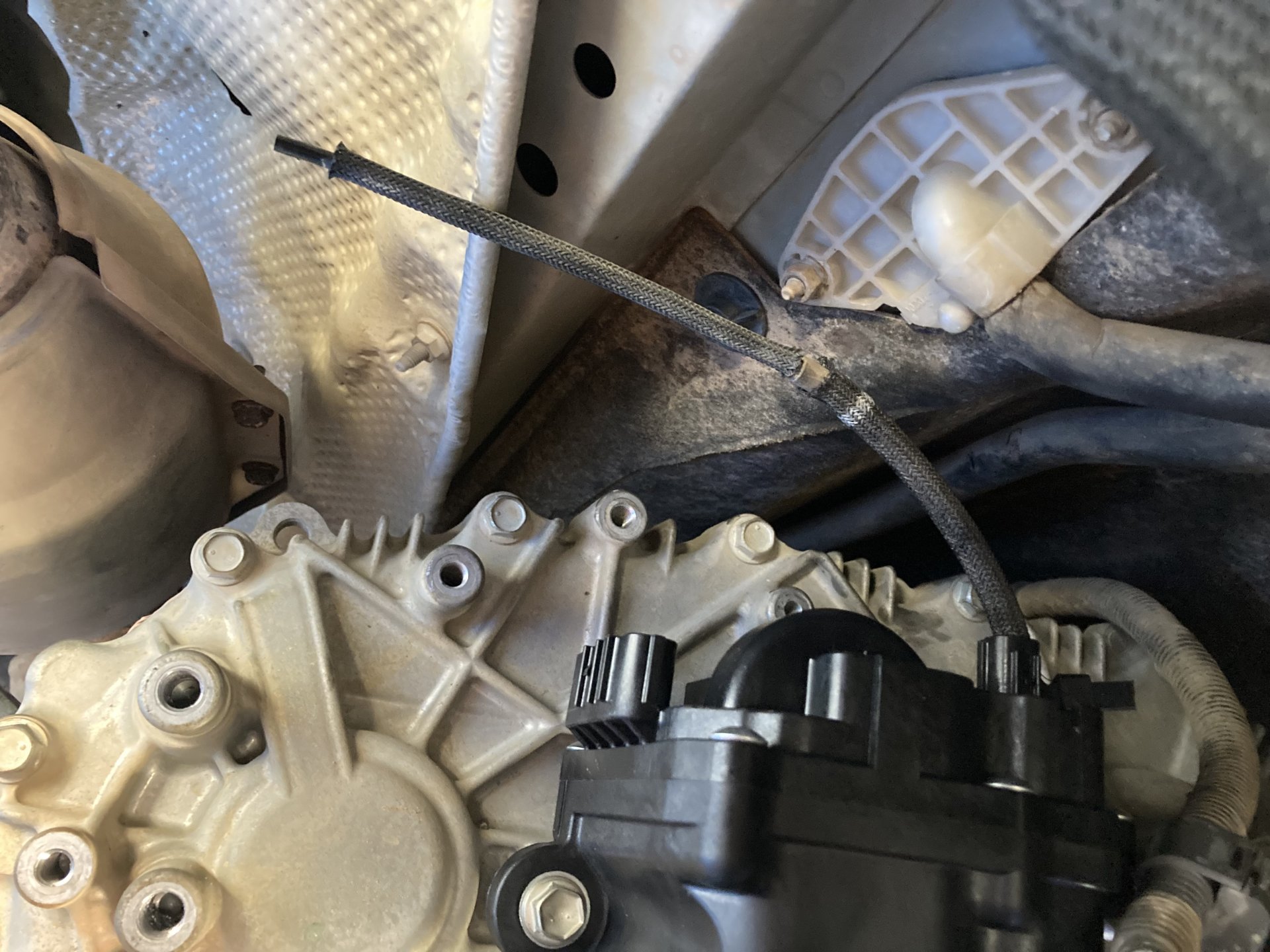

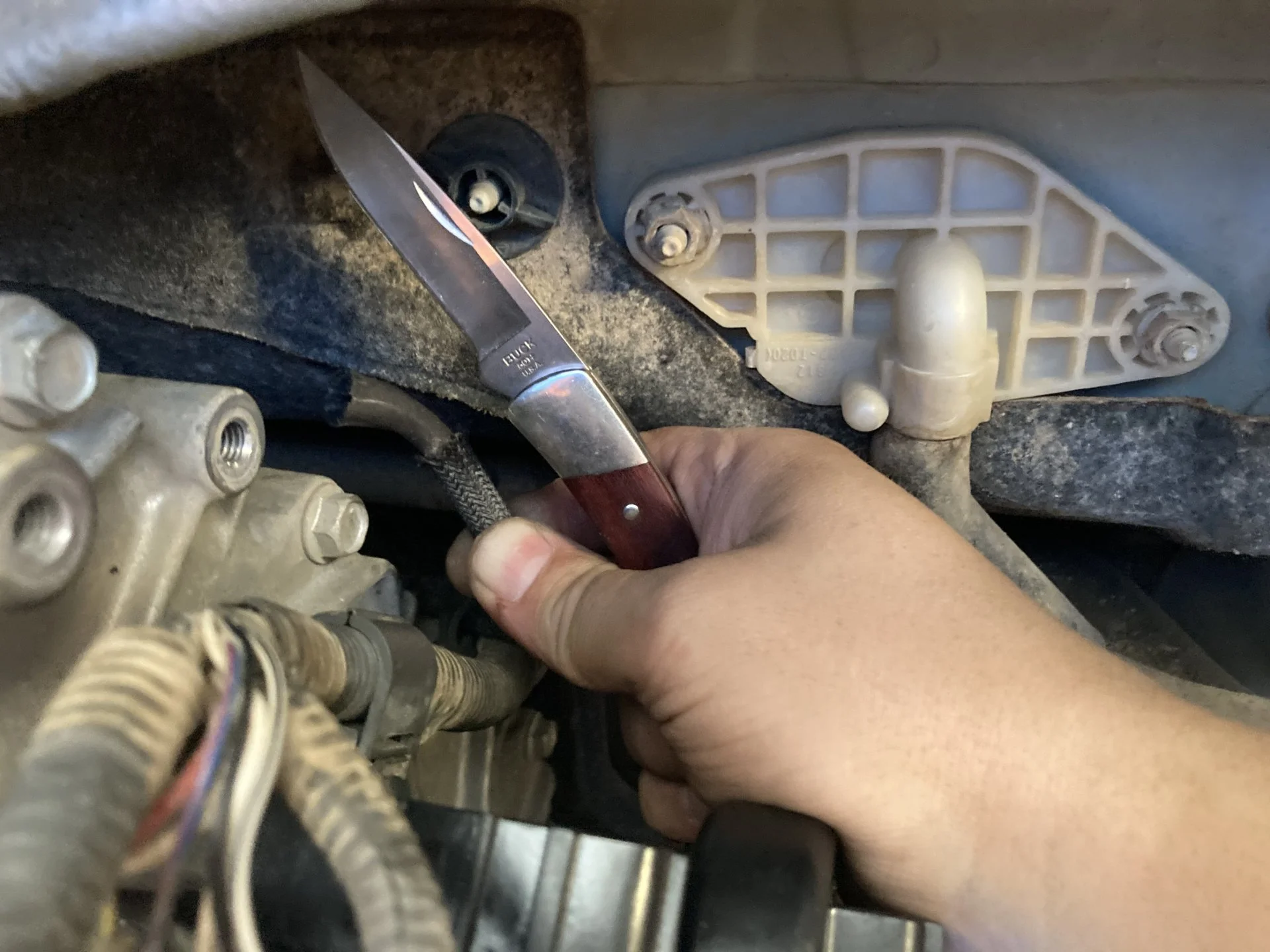

The transfer case actuator breather tube was split and disconnected from the CDL actuator housing:
I trimmed the breather tube to get a new end and ziptied it tightly to the new actuator:
You can see the breather tube is in sections of varying thickness. I accidentally pulled the tube apart and had to reach up above the transfer case and reattach it one handed. Not an easy task. DO NOT pull on the breather tube very hard:

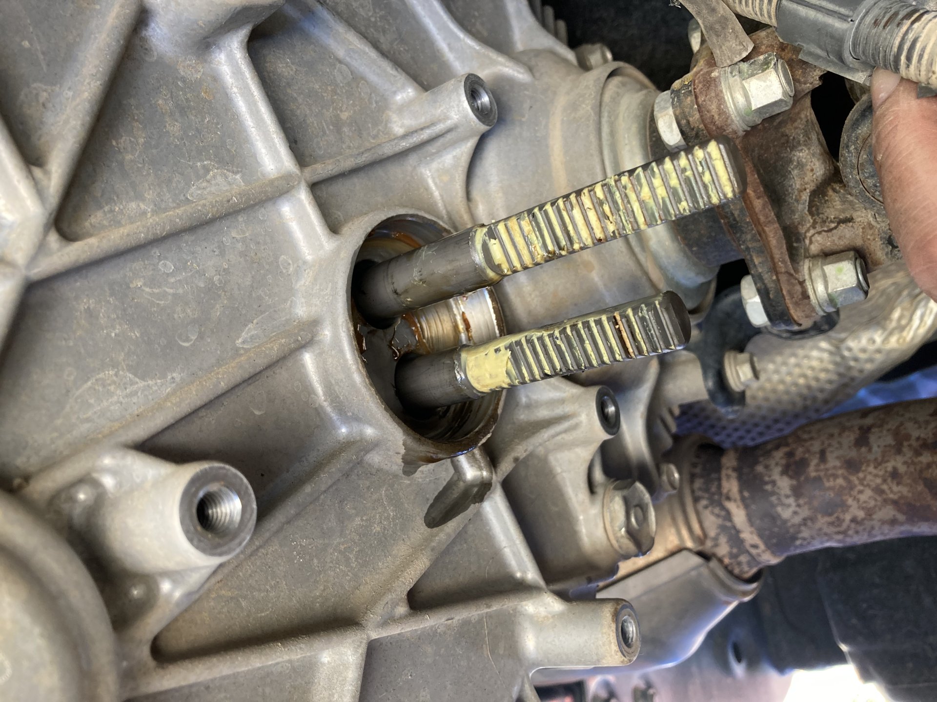

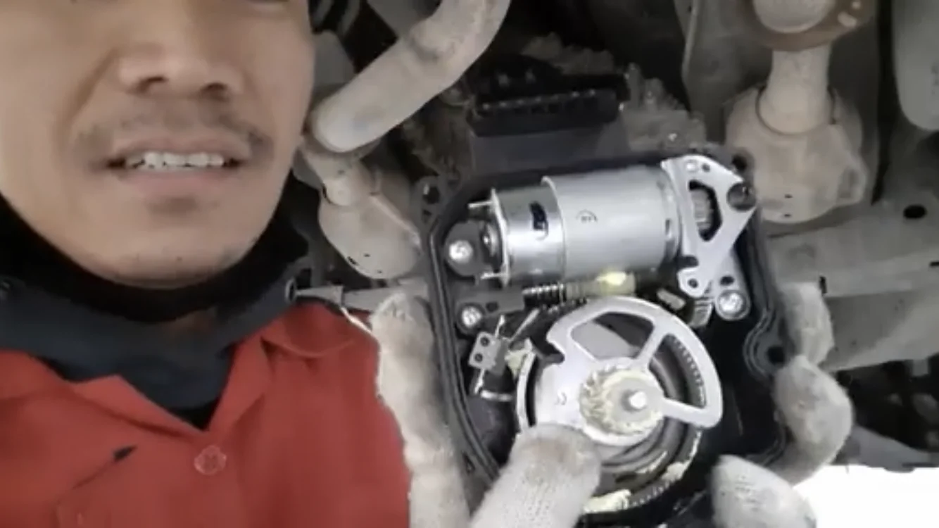

Clocking the motors correctly was done by watching the video posted earlier in the thread. Below are the screen shots from that video for correctly clocked upper (CDL) and lower (4Lo), respectively:
For the rods, the lower (4Lo) rod should be pushed into the transfer case all the way. The upper rod should be sitting so that the actuator motor gear contacts the rod at the 9th tooth- edit: essentially push the rod all the way in. You have to count by feel as you lay the actuator up top. I sprayed penetrating oil into the rods and got them moving pretty freely with my hands ahead of putting the new actuator on. A bit of oil came out of the transfer case. I assume that’s normal.
For the rods, the lower (4Lo) rod should be pushed into the transfer case all the way. The upper rod should be sitting so that the actuator motor gear contacts the rod at the 9th tooth. You have to count by feel as you lay the actuator up top. I sprayed penetrating oil into the rods and got them moving pretty freely with my hands ahead of putting the new actuator on. A bit of oil came out of the transfer case. I assume that’s normal.

Part IV of V

I made an edit to my post to make perfectly clear, you essentially just push both rods in all the way. With the top rod, that happens to be the 9th tooth of the rod engaging with the motor gear. Honestly, it was not difficult. I watched that filipino guy's video and did as he did. The hardest part is keeping the pieces all together in the CDL actuator when you lay it up top, but I used a stiff ziptie drapped across it to hold everything in place. Again, I copied what the guy in the video did.
Here's my updated info on what I did with the rods:
"For the rods, the lower (4Lo) rod should be pushed into the transfer case all the way. The upper rod should be sitting so that the actuator motor gear contacts the rod at the 9th tooth- edit: essentially push the rod all the way in. I sprayed penetrating oil into the rods and got them moving pretty freely with my hands ahead of putting the new actuator on."
And just to highlight once more, as a few videos have been posted, here is the specific video I referenced:

It was not difficult to get the gears clocked correctly. Watch the video I used and just make sure to push the rods in all the way when you put the actuators back on. Once you visually study and understand the way the gears go it becomes pretty obvious and should mentally click. I had an ah-ha moment when I took mine apart and then wasn't worried at all about putting it back together correctly.

Yeah, I didn't mean to scare anyone away from doing the fix. It's ultimately not that bad. It's CYA and to be aware that there is clocking that I put the warning out there. To your point, it's straightforward to maintain the clocking once there is awareness of it.
I used a small flat blade like a paint spatula when lifting the top actuator out to keep the gear and clocking in the assembly.
