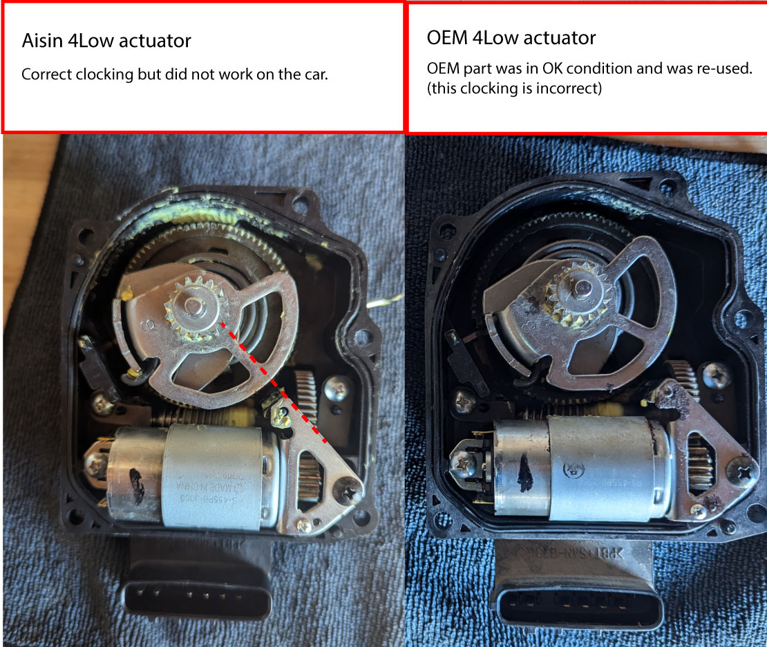

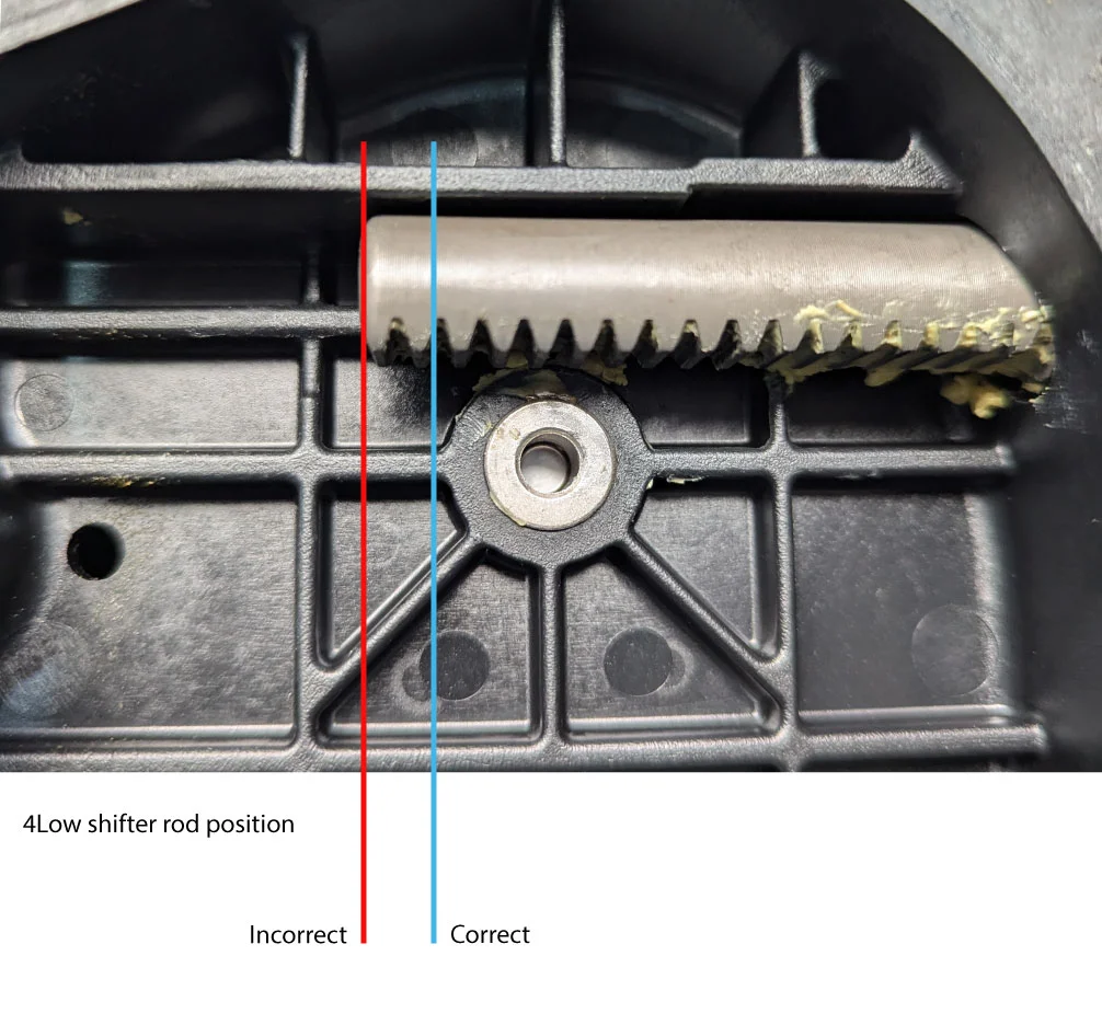

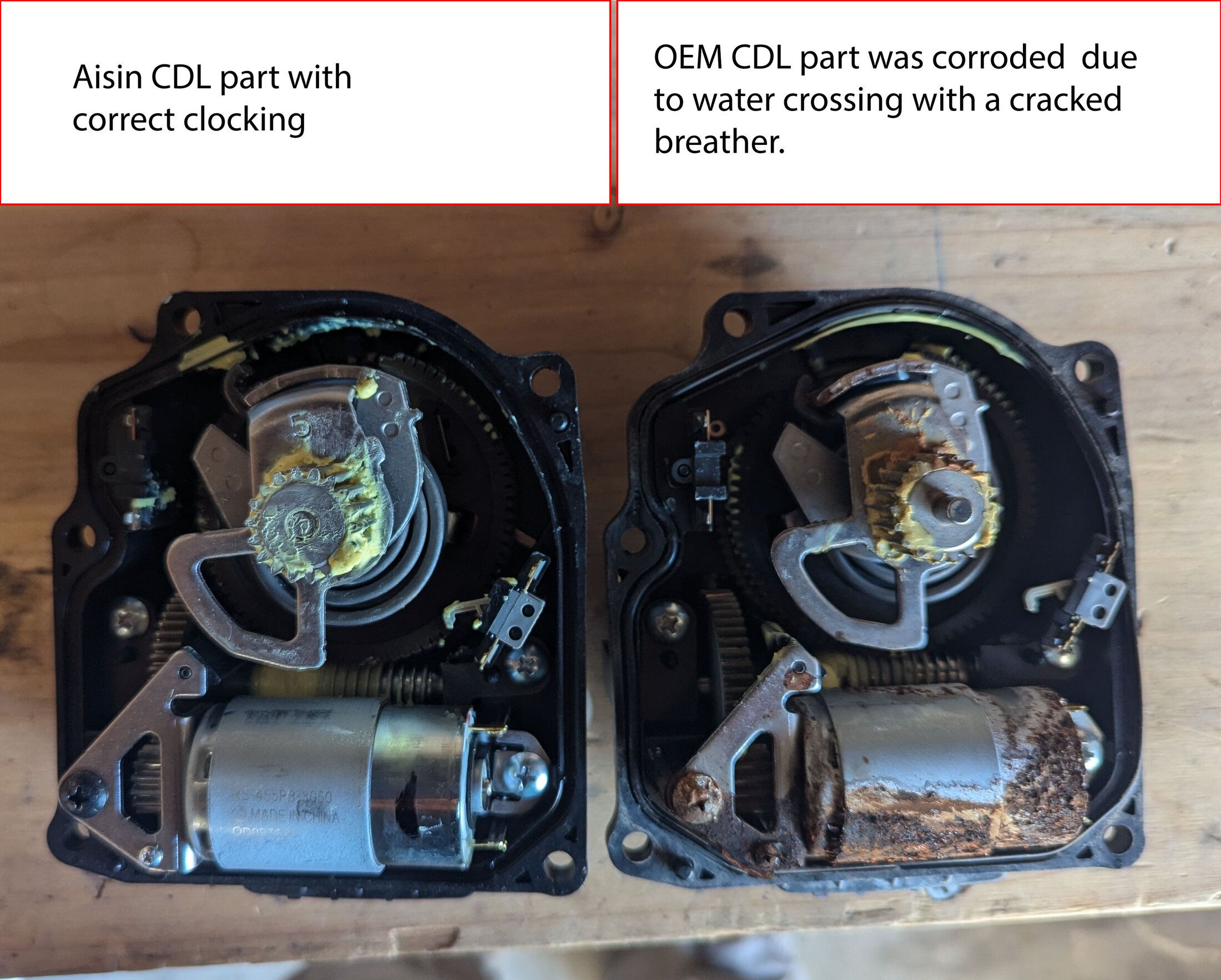

So today I did several more tries on the 4H-4L actuator part and finally resorted to putting on the old part.
AND.... It worked like a charm!!! :cheers:
I still have no idea what is the difference between the Aisin SAT-015 part and my OEM, as they look identical but somehow I could not get the Aisin part to work. The car was fully drivable in 4Hi when I corrected the rod position but I could not put in low gear. The 4Lo kept blinking and not engaging. I compared the traces that the limit switch was leaving on the contacts and it seems like the Aisin part was indeed completing it's movement and the rod position was also the same but yet the 4low never fully engaged. Could this be an electronic communication problem? If the the actuator is making the full correct movement, the rod should be in the right position so what can possibly cause it to not go into 4Low? For now I am just going to use the old OEM 4low part and the new Aisin CDL part. And of course fix the breather as that was the cause of the issues. Mine was actually attached, but cracked, and water had gotten in and sat there in the housing.
The top part (CDL) which was my actual problem in the beginning has been fully compatible.
The Aisin part has been working there like it should.

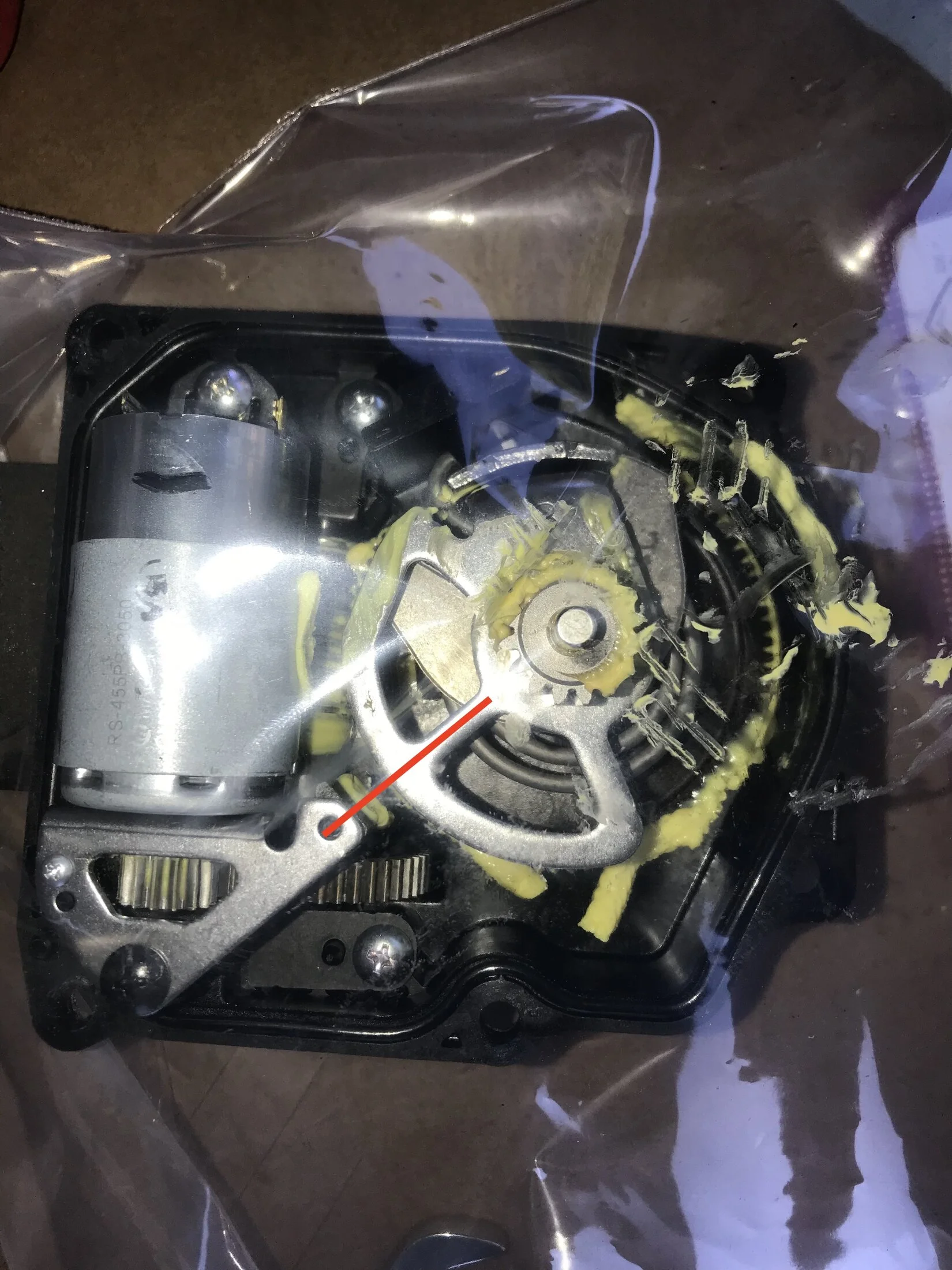

A note about the bottom rod position... When you play with that rod :eek: sometimes it likes to stop at a different location and if the housing is completely off there is nothing to compare it against and so it is hard to tell if it is fully inserted.. sorry this sounds really dirty but it's the best description I can give you :hillbilly:
This was the cause of the problem I was having yesterday. The rod was at the red line and so it never reached the full seated position for 4Hi and thus I couldn't put into reverse.

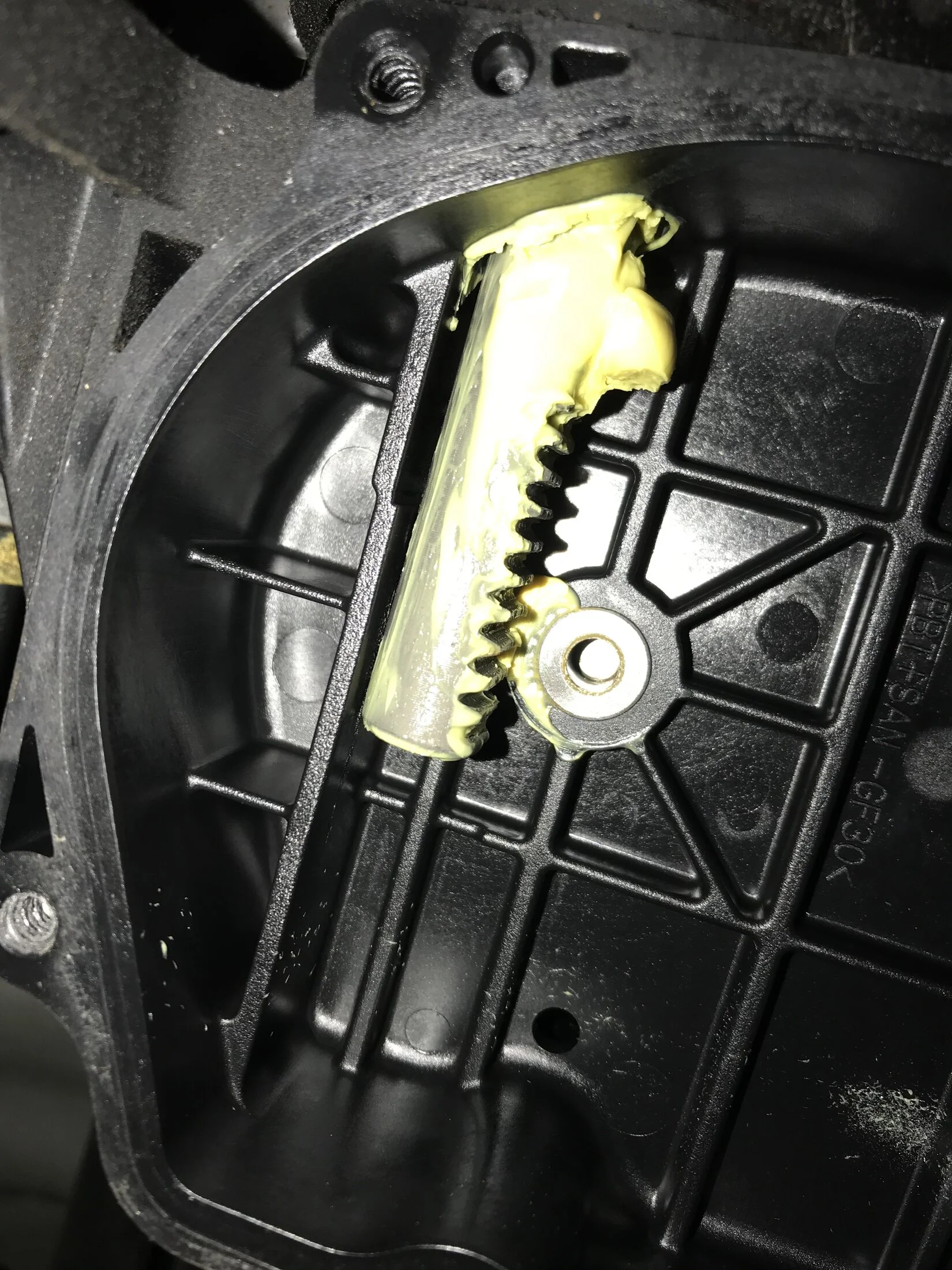

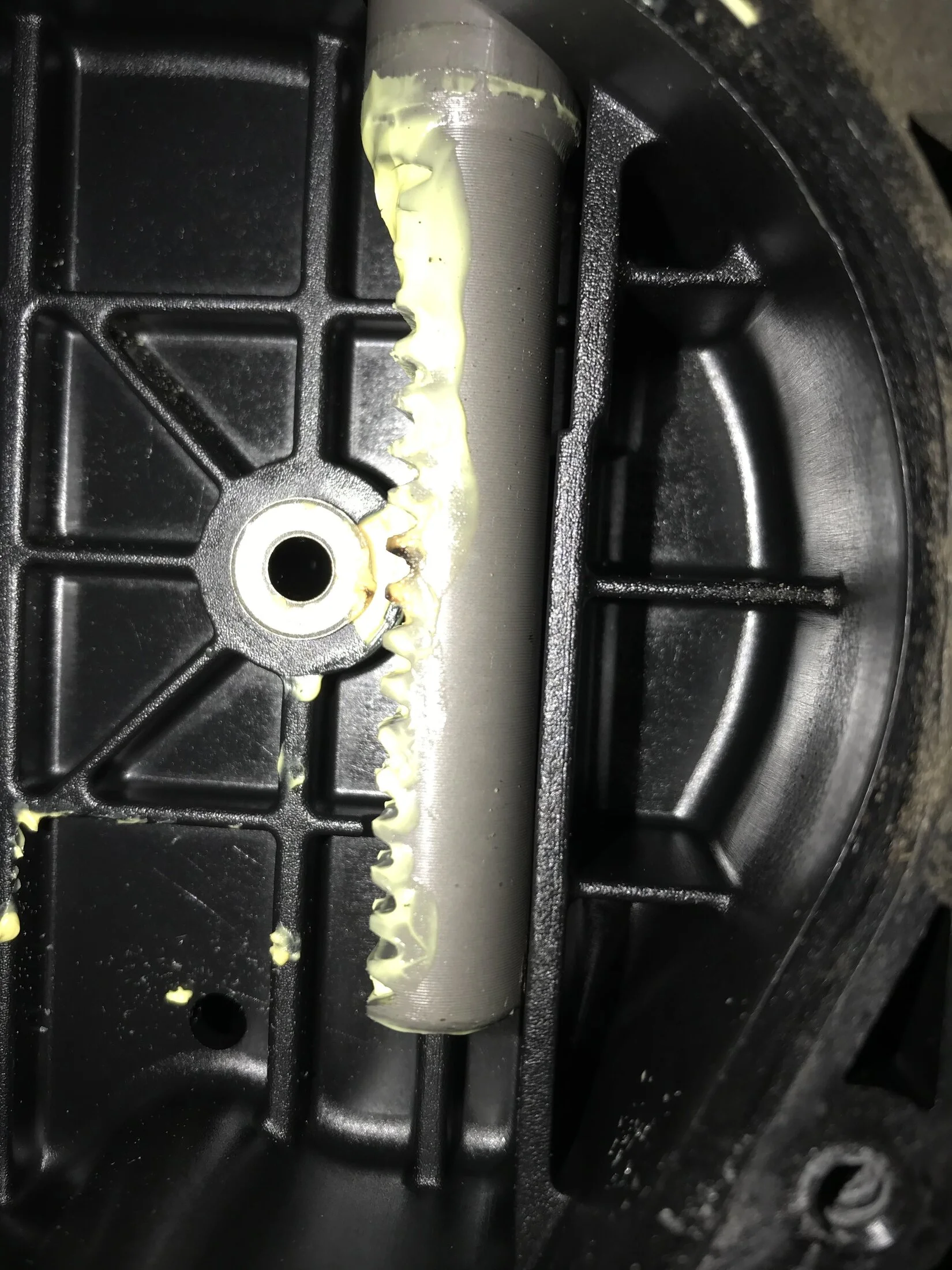

Did this job to replace shift rod seals, and the actuator oring, which was leaking.
Here are my pictures of the rods as soon as the motors were removed.
Bottom rod:
Top rod:

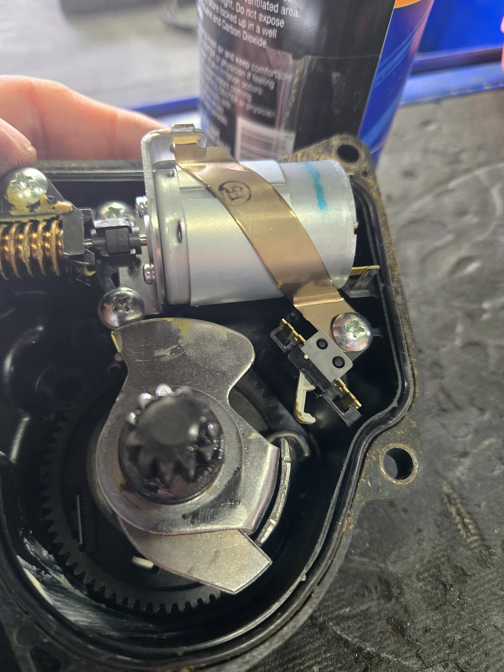

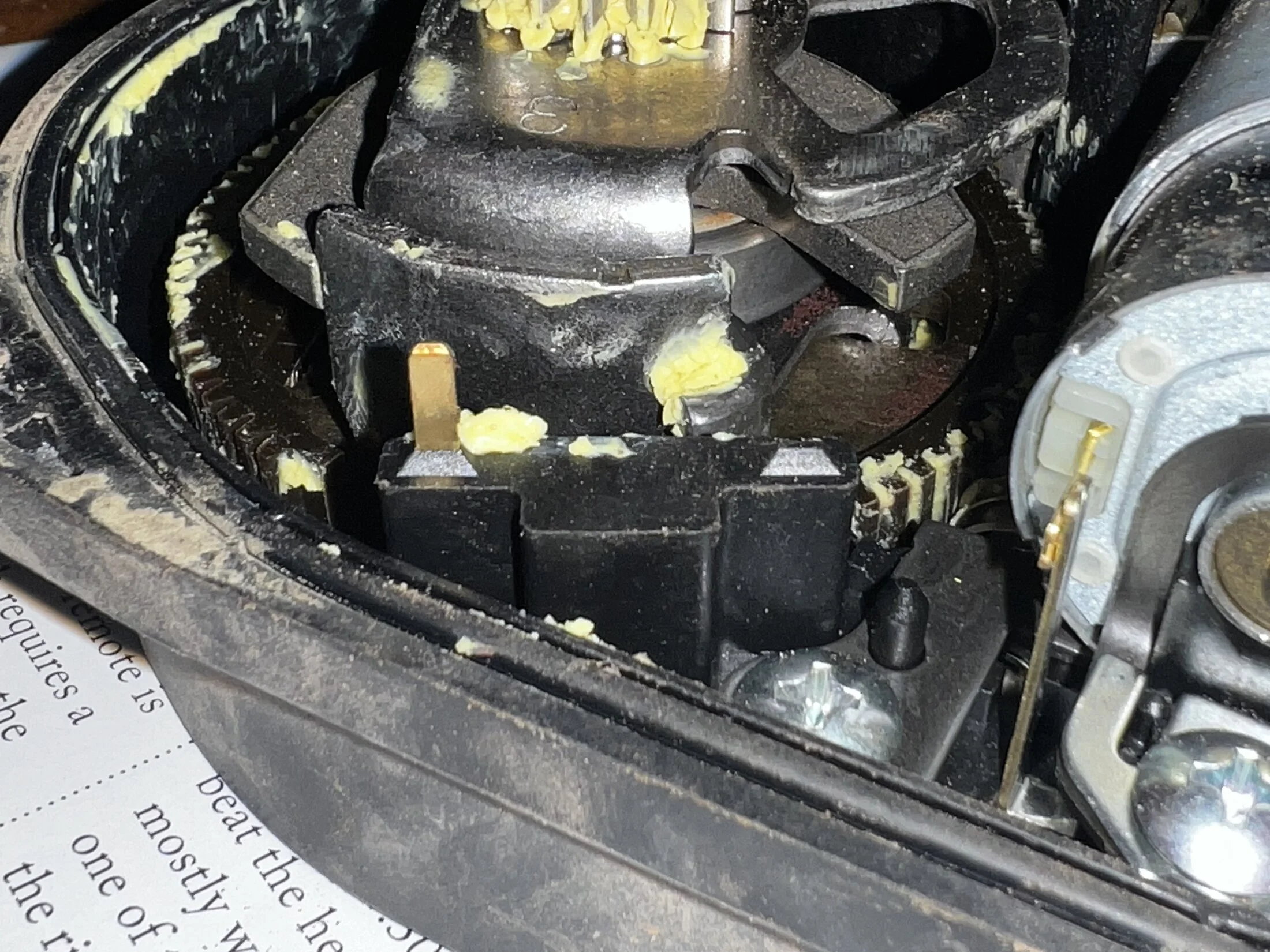

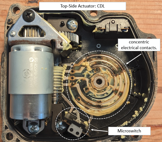

Understanding that in these repairs I stand on the shoulders of giants (@TeCKis300 and others)...
I suspect that my biggest issues were the actuator's poor/inconsistent contact at the microswitch View attachment 3046437(might be submicroswitch), and possibly the corrosion at the concentric electrical contacts. Disclaimer: I'm not a mechanic or doctor, and the Holiday Inn Express here is occupied by violent squatters; don't do this stuff unless you are ready to buy a new transfer case actuator assembly. For inspiration and to steel my nerves, I watched KenKej savagely restores these parts.
  • concentric electrical contacts
  • motor
    • tested fine on 12v bench test; saw no need to remove/break factory solder points
    • removed the big silver screw (south-end in picture) to remove the bracket
    • removing the bracket uncovered the small hole in the motor

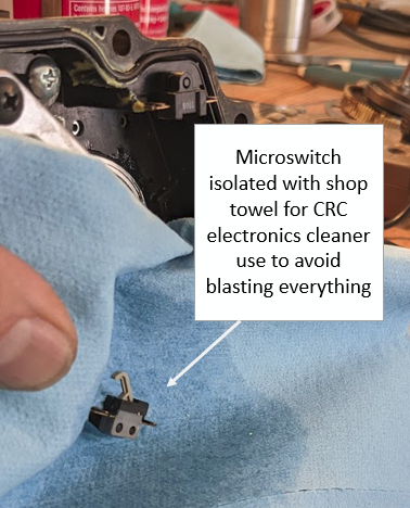

    • covered and isolated motor with shop towel in same way as the switch (see pic below) and sprayed CRC Lectra-Motive Elecric Parts Cleaner inside, holding the motor-in-housing hole-side-down.
  • microswitch

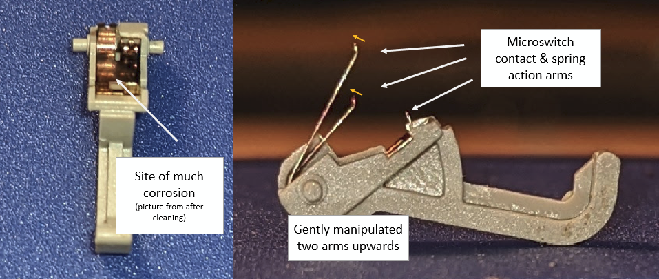

    • required several removal/install cycles for me to figure out and to fixView attachment 3046441
    • escalated to switch dissasembly; plenty of corrosion found in spite of having a relatively clean actuator housing
    • turns out the issue was twofold: corrosion at contacts and too-loose hinge mechanism
    • the tiny plastic hinge allowed z-axis travel (orthogonal to intended plane of travel) of the platstic arm, making good contact at full-up or full-down positions but wildly inconsistent Ohm readings at its resting plane/position.
    • did not have the talent/bravery to mess with plastic housing of microswitch to reduce the up-down looseness
    • did have sufficient recklessness to gently adjust the two copper arms 'upwards' (on workbench), downwards when in-situ, to improve firmess of copper-on-copper contact when switch is activated by rotation of actuator wheel.
    • how gently did I manipulate those copper arms? If you are reading this and are thinking about doing this, you are already using too much force.
Over the course of this repair attempt I un- and reinstalled the two actuator housings many times. I want to share some things that would have helped along the way, had I known them earlier. Credit to sixweeds over at tundras.com for great work on this issue with the Tundra cousin truck (among other info).
Next time I will remove the entire actuator housing (yes, can be done without dropping/cracking, etc.) to
  • more easily service both CDL and 4LO actuator housings
  • allow spray of penetrating oil into the push-rod housing/channel. I think they become less compliant over time, which causes the electronics in the actuator housing to work harder and degrade faster

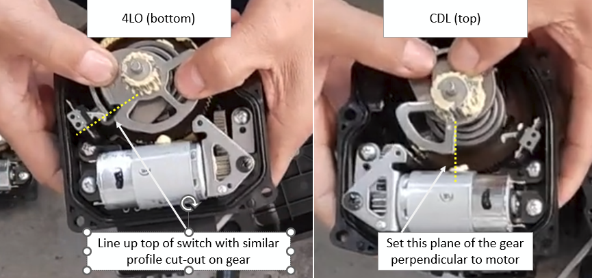

The poaster over on tundras linked to a few good videos from a Tagalog-speaking mechanic in Saudi Arabia. The videos are all shot with the front-facing camera, so I grabbed the stream, inverted, and will drop the reinstallation gear-clocking information here. (original video)
Bottom line on installation: push the actuator rods all the way in. (NB: my truck was in 4HI w/ CDL not locked)
Clock gears as follows. And use a screw driver (or other long, flat thing) to hold gears in place while installing top-side housing. You may have to adjust the clocking slighly to line up with shaft teeth. Do so by pulling the housing, turning the larger gear below the motor, and going in for second approach.

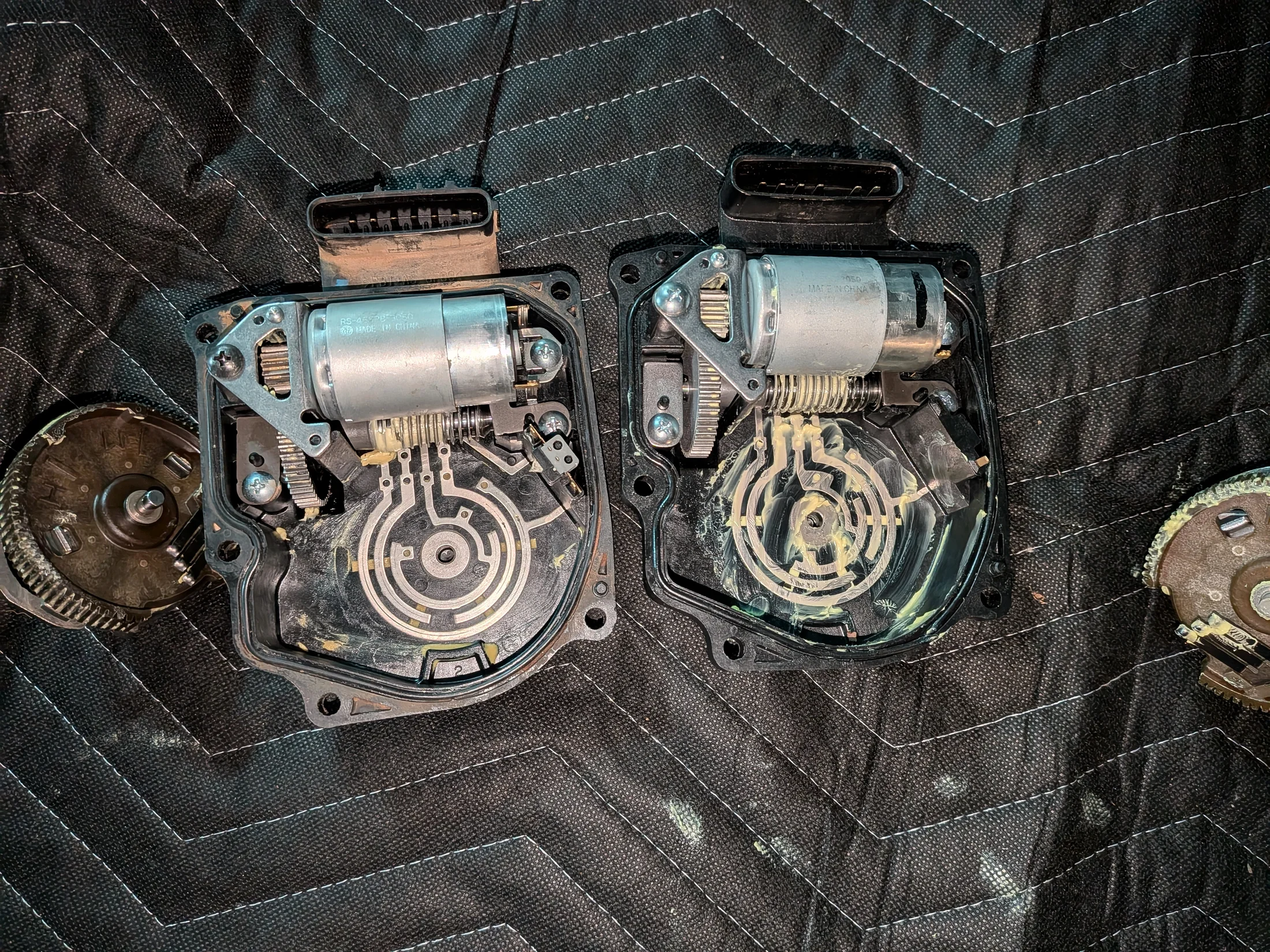

This is how I timed the lower actuator with no microswitch. It came out of the housing at this position. The top motor had a microswitch but I never got a picture of it, and pulling the motor out while retaining its clocking is near impossible due to gravity. So, I used the Tagalog video to time that motor. Bottom motor with no microswitch is the same as the Tagalog Land Cruiser video, and the video briefly showed timing for both motors. Refer to my previous post for the video and the transfer shift rod positions. Hope it helps!
I had previously removed my center diff lock and low range actuators and didn’t get the timing quite right this past fall. As I was comparing mine to the post on page 6, I noticed that the lower actuator doesn’t have the microswitch on my 2013. I don’t know what year they changed
Ditto here, there was no microswitch on the lower actuator, only the top one. The top is the CDL, the bottom is the 4Lo mechanism. I haven’t pulled apart an earlier model but AFAIK no 4Lo actuators used the microswitch - only the CDL does

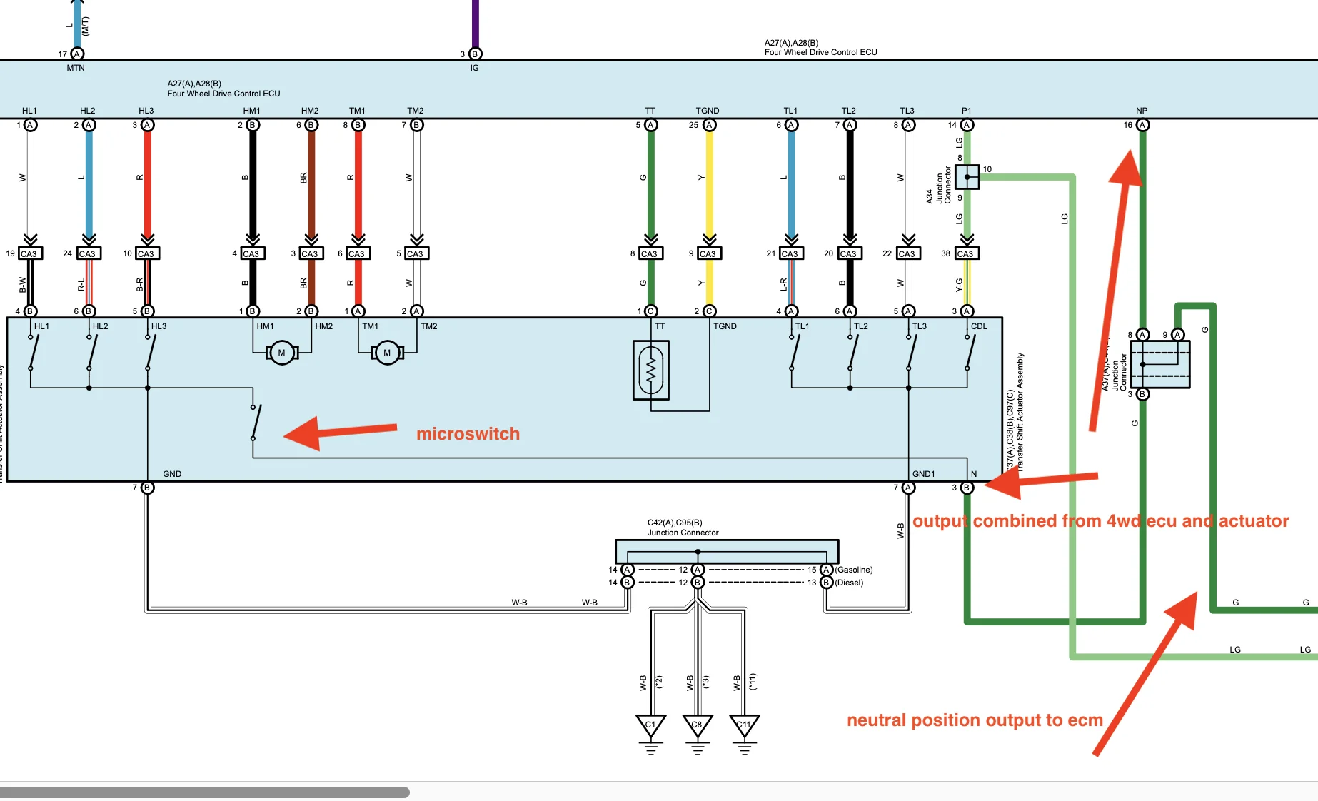

Just finished fixing a weird 4LO/4HI actuator issue and wanted to share some of my findings.
Regarding the microswitch - at least in our LC200 2008, it's not needed, even though the original did have it. Looking at the wiring diagram for this, I believe it might be used to signal an A/T/P (aka the car isn't in "park" and will roll away) alarm to the ECM. The ECM already has the information from the 4WD ECU however this might be a backup in case the 4WD ECU fails or maybe Toyota thought they might change how this works in the future. Either way it doesn't appear to be needed.
Regarding getting the clocking right - there's a simple way (though probably requires two people. This is how I did it:
Hold the assembly in your hand, connect it to the car, but don't connect it mechanically. Hold it in a way that your hands are clear from the gears (it moves faster than I thought it would), but applying a bit of force to the shaft to keep the contacts down - then have someone turn the car to on (don't need to crank) and let the motor spin and it should stop at the correct position. For us, setting the 4WD to 4HI is easiest as the then rack just needs to be pushed ALL the way in. Without adjusting the position of the actuator gear, now insert it into the rack and screw it down. It should be in the correct position.
Now regarding part numbers and replacements. There's several part numbers for the actuator assembly. If you are having trouble using a replacement part it's likely that the contact pattern on the actuator is different to your original. If you remove the gear and the grease it's pretty easy to see.
This will cause the rods to be in the wrong position as we found out the hard way.

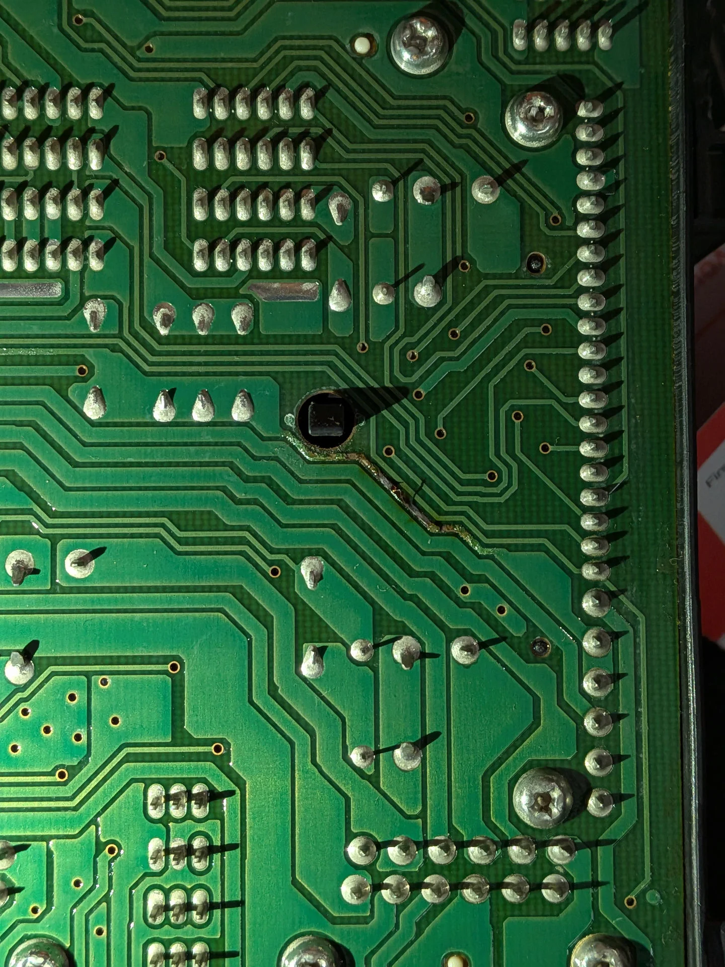

Finally - in our case - the actuator and 4WD ECU were fine. It turns out the Main Body ECU had a PCB trace fail (caused by me). This caused high neutral resistance, and likely causing the 4WD ECU to restart everytime the power drew current. This caused a click click click click, and the actuator very slowly ticked across, taking 6 or more minutes to change into 4LO.
If you are troubleshooting something that sounds like this, measure the neutral pin on the 4WD ECU to the car body. Resistance shouldn't be more than like 1 ohm. (We were seeing 5). We soldered a bodge wire across this point and it resolved the issue (it also resolved a bunch of electrical issues we were having like slow door locks and electrical systems rebooting).

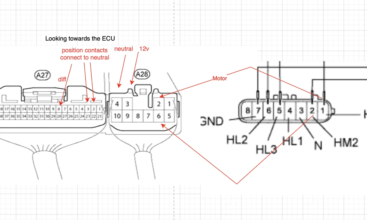

During this troubleshooting process I discovered how to test the 4WD ECU:
On A27 (the small pins): 1,2,3 are the position contacts for 4HI/4LO. Pin 8 needs to be connected to neutral so that the diff is in the correct state. 2,3 connected to neutral should trigger the 4LO motor to spin. The motor connects to A28 (the large pins), 2 and 6. Neutral on 4 and 12v on 3. Double check my working as your parts might be different or I might have made a mistake.

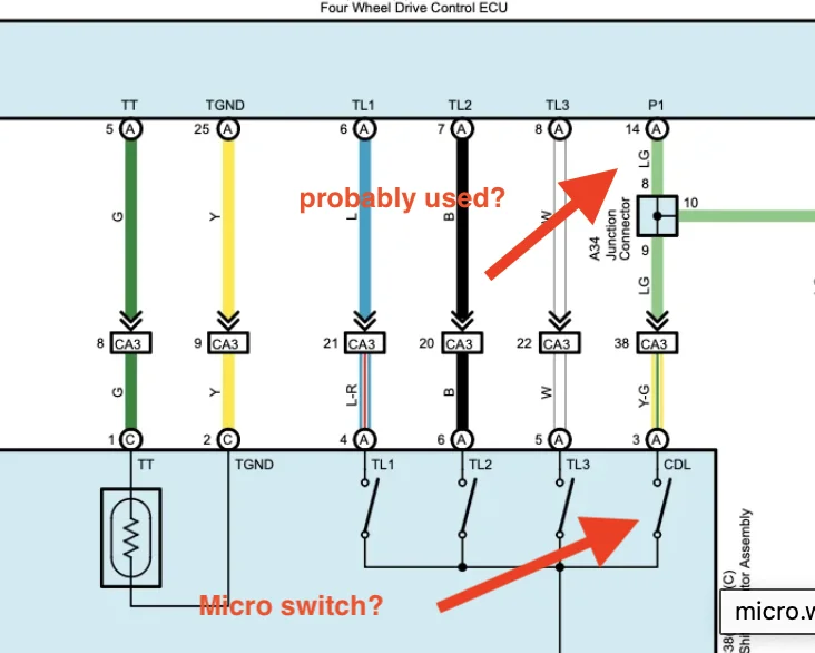

Nice write up.
My gut says even though the microswitch might be simply duplicating the function, the ECU is unhappy when the switch is in the “wrong” position… hence the flashing CDL we often see
I want to give you huge thanks for documenting all of this troubleshooting and resolution. It may be a big help to me as I’ve struggled to clock the damned thing properly when reinstalling it and have been relegated to trails where I know I won’t need 4lo.
Nice write up.
I wonder if this is eliminated if there is no micro switch, as then there is no dissenting opinion regarding the transmission state?
My gut says the opposite since my actuator was a hot mess after I bent the pins in that little microswitch but WTF do I know?
Likewise, I'm pretty sure it is used because I had to take mine a part a couple times specifically to tinker with this switch.
Often for safety critical functions, there are cross checks for subsystem states.
I guess vainly hoping we could ignore that micro switch is out.
Well you might be able to solder across the contacts to bypass it… though I don’t know if that will cause another issue with it thinking the CDL is “always” being unlocked. But removing it (or rendering it nonfunctional in my case) seems at least in my experience like it wouldn’t work…
If the switch is removed entirely (at least with our 2008 landcruiser) there are no faults. I tested running the newer (though wrong position) assembly that doesn't have the switch and there were no faults. (though important to note that this is only for 4LO/4HI operation, CDL is likely a different story). If the switch has gotten gunk in it and is stuck creating a contact then yeah this will probably be a problem. You can meter pin 3 to pin 7 from memory to test the micro switch. I'd be more inclined to think there's seperate fault - but maybe our 4WD ECU or ECM is using different code/config.
