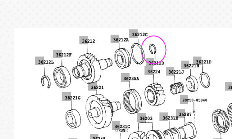

I got the snap ring out (the large one)

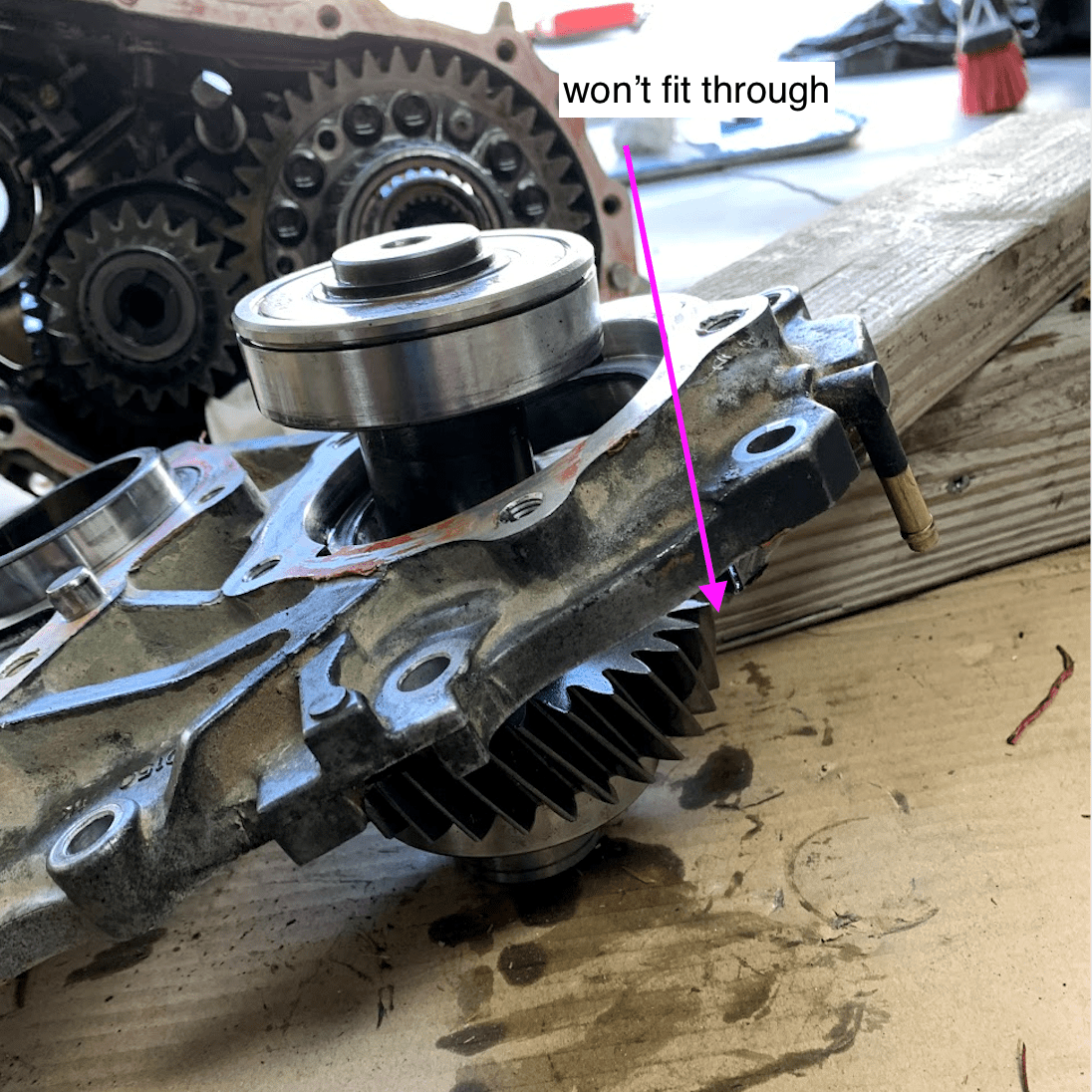

But I can't get this race to fit back through the opening like it does in the OTRAMM video. I tried tapping it in lightly w/ a brass hammer but it really doesn't seem to want to fit through. Any ideas?
thanks!
It should fit through there easily. I would recommend cleaning the race and the machined surface of the rear housing with some brake cleaner and trying again. I assume it is getting stuck on the trail edge of the bearing snap ring lip? If cleaning both surfaces doesn't work I would check for some burrs on the lip or the machined seat on the housing.
Hmm, tried that and I do see a few burrs on the machined surface but it is honestly so tight it feels like a race you would press in. ??
I threw my micrometer on it and got the race at 85.02mm and the machined surface at 84.8--don't think they are the most accurate of measurements but the two certainly don't seem to want to slip past each other.
Let me know if you have any other ideas? Otherwise thinking about going ahead and pressing the gear off "through" the housing as at that point I can slip it off, but not sure if I'm missing a larger problem that will bite me later.
You could pull the bearing off the input shaft with a bearing splitter (flat side) and either press it (may be too tight for a press) or use a puller. Be sure to pull off that snap ring first. I used a large bearing splitter from HF to do my transfer rebuild. I have a different input shaft from what you have but the bearings are the same.
Got it! I pulled the inner snap ring and for some reason that gave it the play it needed to come out. ??
