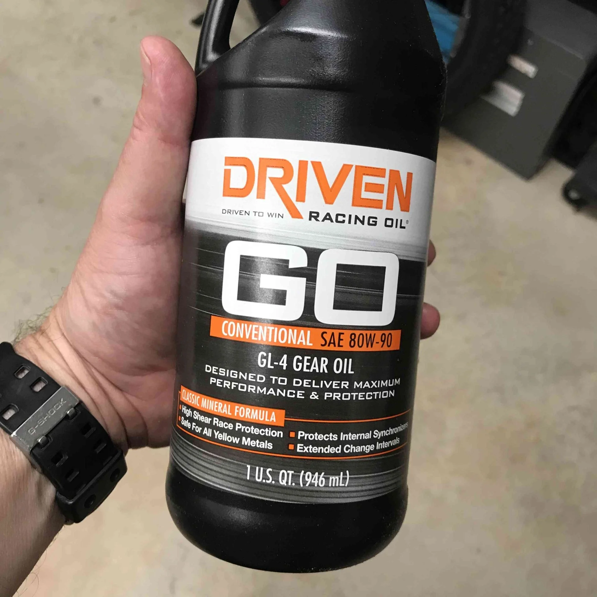

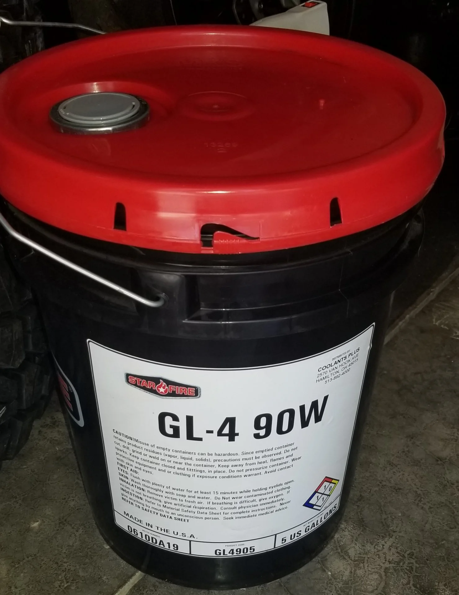

When I search which oil to use for the transfer case most of the threads are 7-10 years old. I have searched in my area and the only gear oil I can find is blends i.e. 80w90 GL-5 etc. The FSM says SAE90 GL-4. In some of the old threads, there are comments that only GL-4 should be used in older transmission and transfer cases. I have a stock 1973 3 Speed with pto. Any guidance would be appreciated.
Do you have a Carquest nearby? I’ve been using their house brand 90 wt GL-4. I think now it’s labeled as Fram.
the GL-4 part is important....GL-5 will eat gold metal parts under the right conditions.
The issue that I'm having is most oils that any oils that have GL-4 listed also list GL-5. There is one example, Spirax S4 AX High Performance Axel & Differential Oil, 80W90, 20-L API GL-4, GL-5, API MT-1, SAE J2360. Would this work or should I keep looking for GL-4 only?

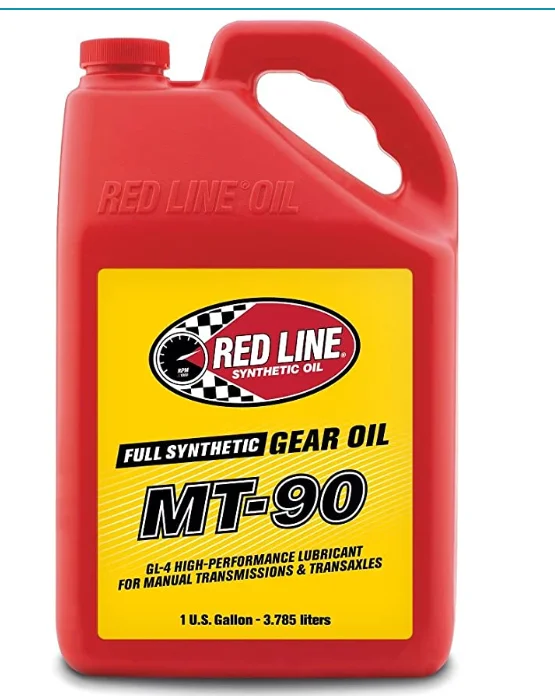

You will have a difficult time finding a GL-4 only lubricant at your local parts houses and suppliers. I recently had luck purchasing 90W GL-4 from StarFire Lubricants, I'm not sure if they have any left but I bought two 5 gallon buckets for about $50 each. If you don't care to pay $$$ you can always buy Redline MT-90 from Summit Racing or similar.

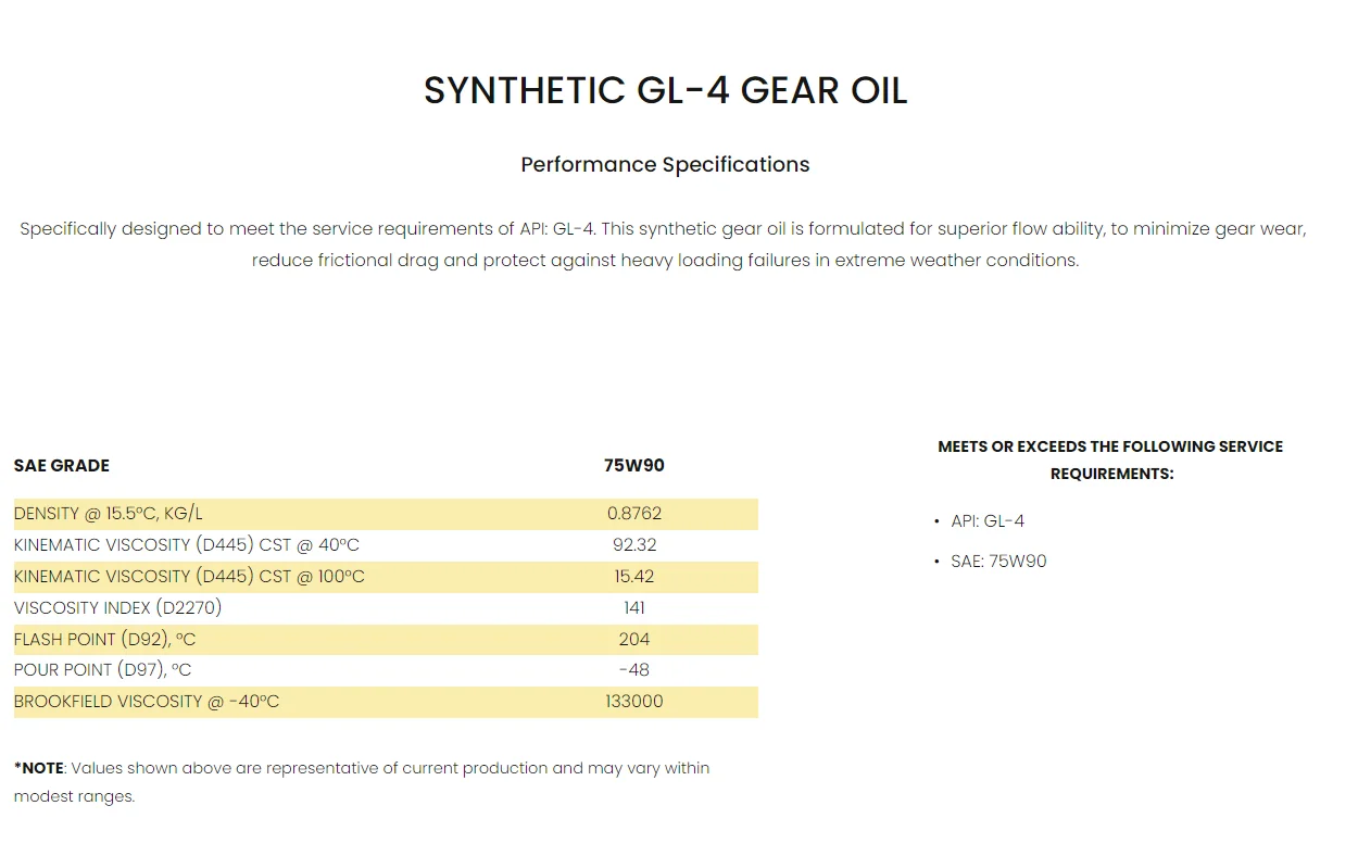

I don't know if Canada has it but some of us on this board are using this oil: PennGrade 1® Classic GL-4 Gear Oil SAE 80W-90 - Gear Lubricants - https://penngrade1.com/products/gear-lubricants/penngrade-1-classic-gl-4-gear-oil-sae-80w-90/

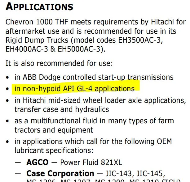

Doing some service work on my Kubota and was comparing hydraulic fluids. I stumbled across this...
Note: The Service Designation "GL-4" implies that it is yellow metal safe, saying both GL-4 and YM Safe is redundant. Since our trucks don't have hypoid gears in the T-case or Trans, Chevron 1000-THF should be a suitable transmission and transfer case lubricant.
