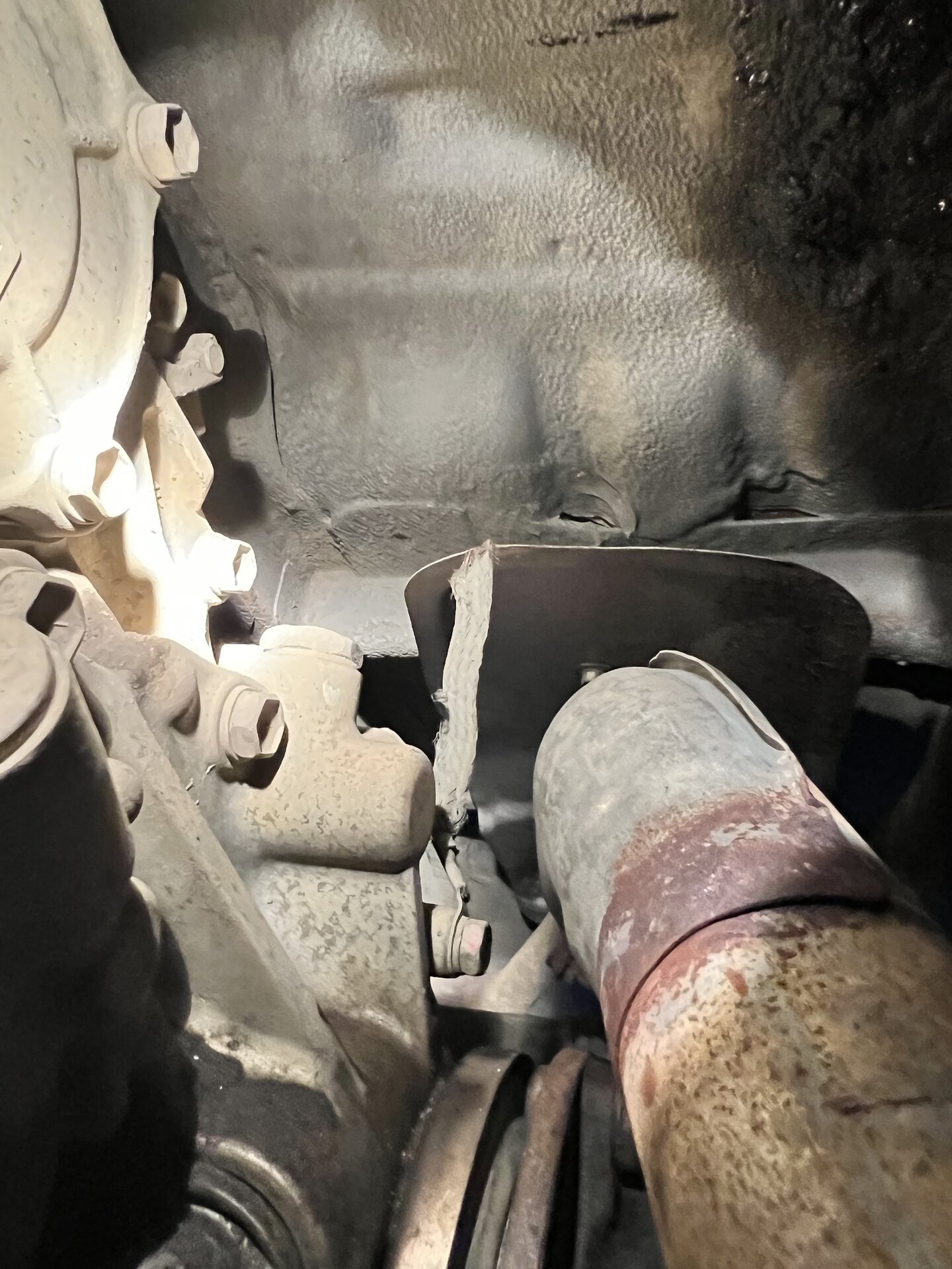

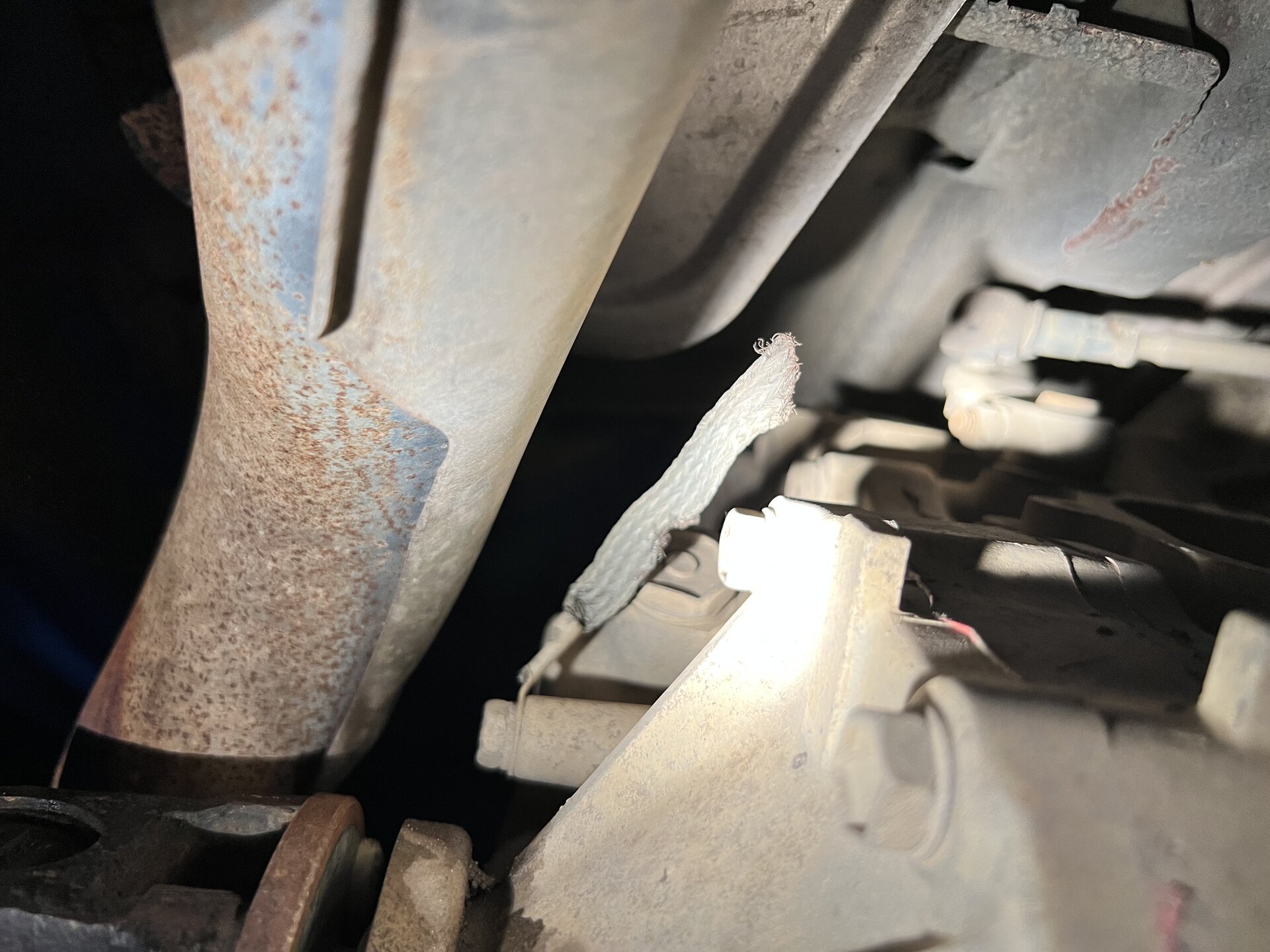

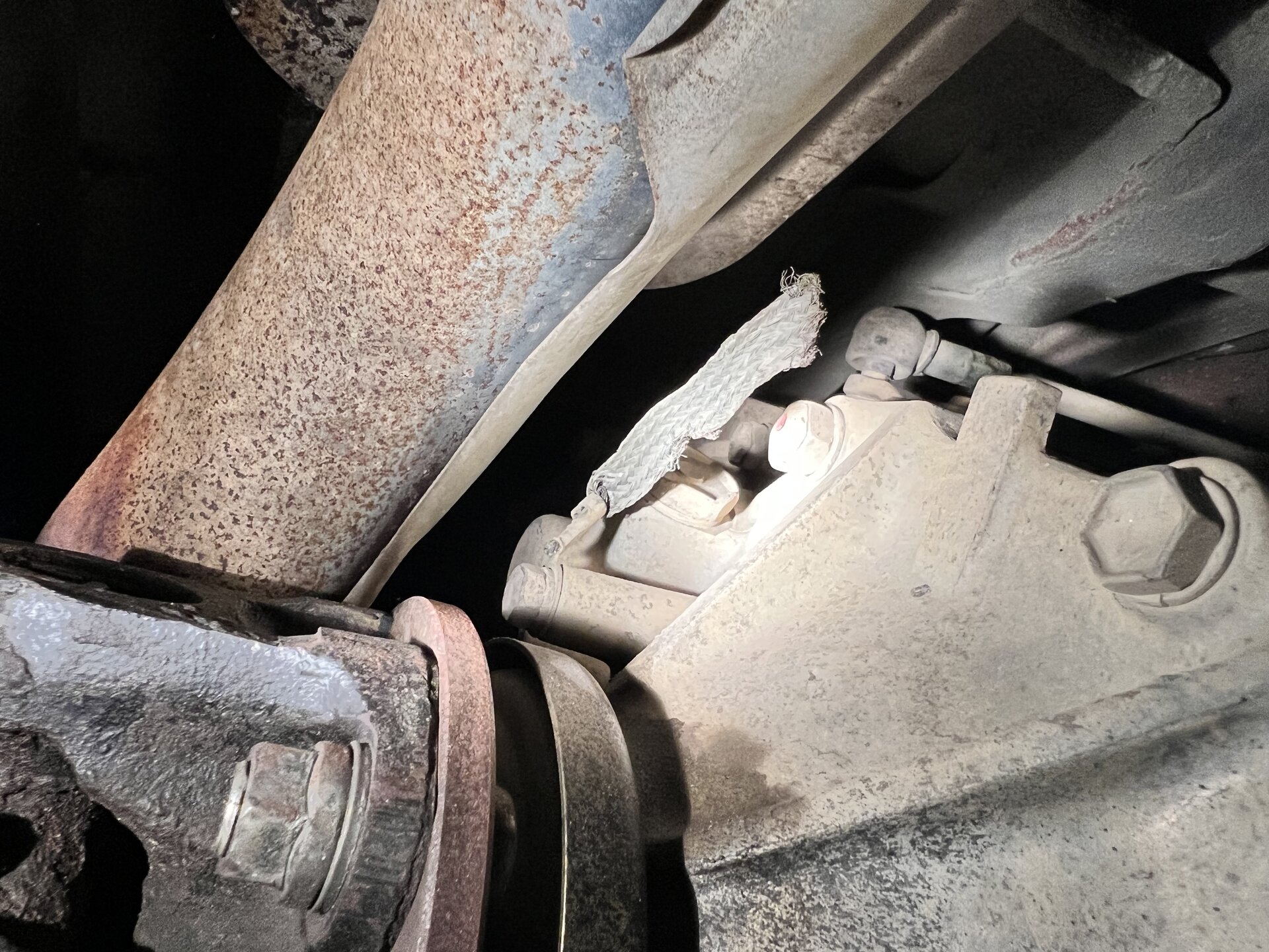

Doing a little TLC tonight and noticed the ground strap…..well ain’t doing it’s job !!! 🫤 I looked but couldn‘t see where the heck this thing was supposed to be grounded to. Can someone point out the other end attachment location and I would assume a thick piece of insulated wire ( like a battery cable size) with 2 fittings could be bolted in its place or is the strap type better ?
thanks for any help or suggestions
Hello,
There is a captive nut in the body close to where the transfer lever is.
You can bolt the strap there.
Juan
