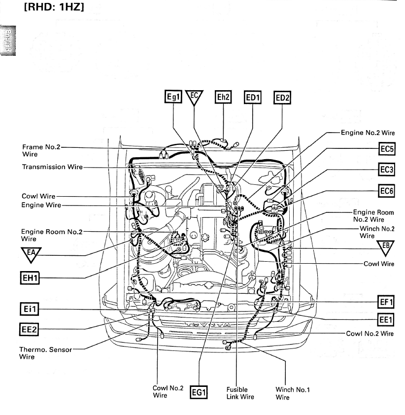

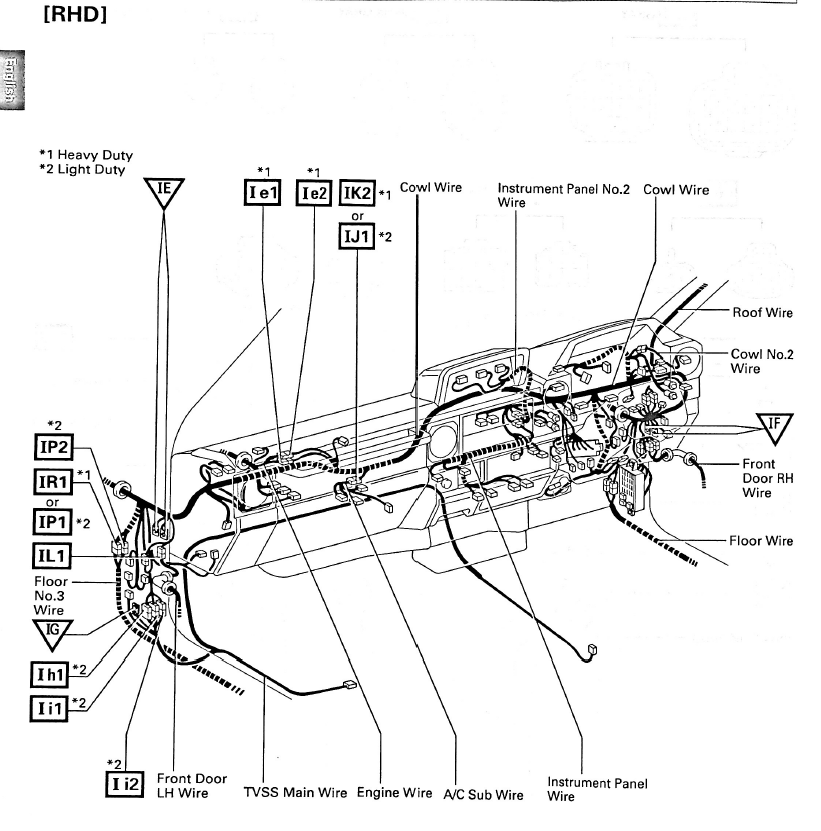

Other model EWDs I've looked at have a ground point diagram
You are completely right. I'm not sure how I skipped this in the EWD. Digging into it all now.
Thank you @mudgudgeon @JuanJ and @AirheadNut

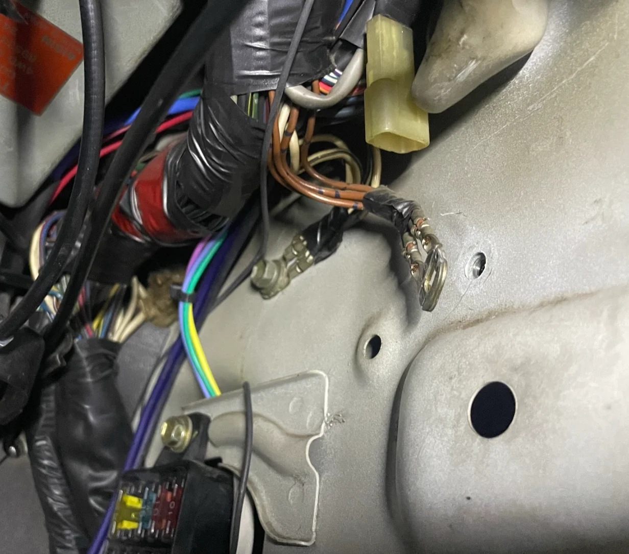

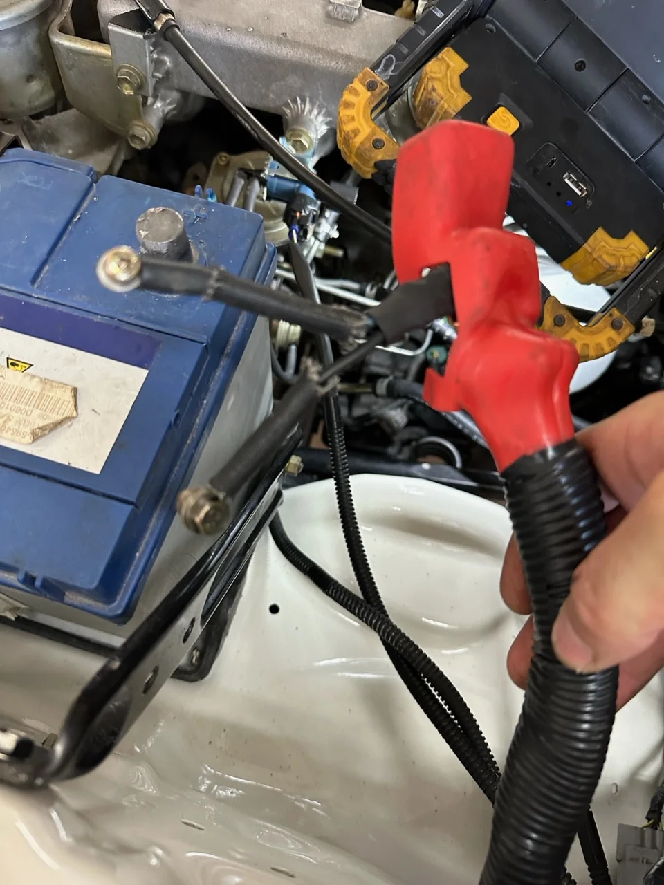

Confirmed there is a second hidden ground on the front left footwell near all the modules. It requires HVAC box removal. Lots of work. But worth it.
All the grounds in the front look like this. Completely relying on the bolt threads for ground. I removed the paint, re-tapped the threads, cleaned up the ringlet, and replaced the rusty bolts.
Now that the interior is complete, I'm moving on to the engine. That's where it gets tricky. @mudgudgeon it's strange ... the EWD shows the little grounds, but the big, uber, mega wire grounds are nowhere to be found.

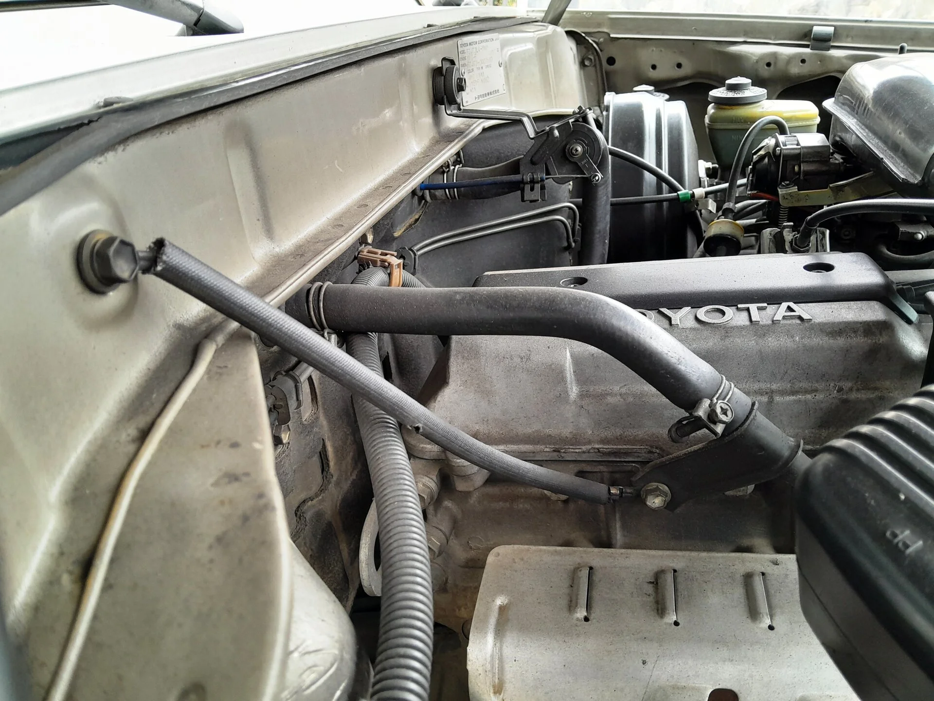

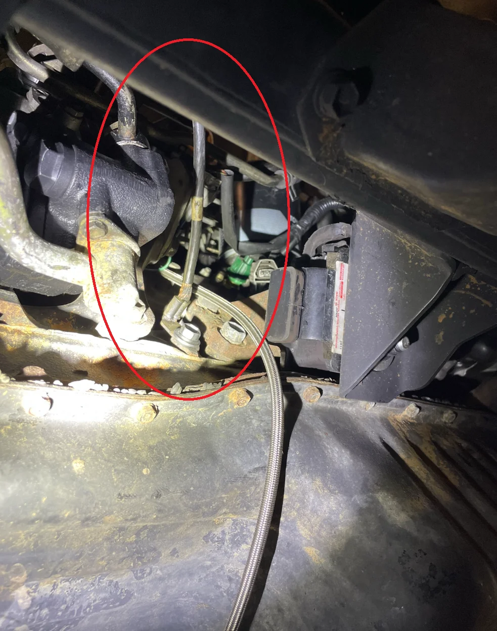

Hello,

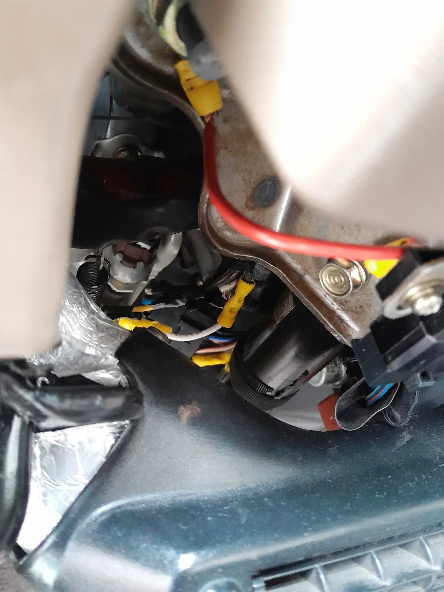

Some pictures to complement the manual.
This is an engine grounding point.
This is the left fender/cowl grounding point, in the engine bay. This is the left fender of an LHD truck. There is another point, just like this one, on the right fender.
And this is the steering column grounding point. It is the red cable. I mentioned two nuts. Actually, it is one bolt in the column (bottom of the picture) and one nut in the panel (on top in the picture.) The camera had a hard time trying to focus on this one.
@JuanJ - Thank you for these pictures. My truck has exactly zero of these grounds. Looks like I'll be adding a few this week.
it won't hurt to also do the Big 3 upgrade
@veiloctane - agreed. I kicked off an order for those cables yesterday. The truck currently has the trash parts store clamps. I'm fabricating all new cables next week.

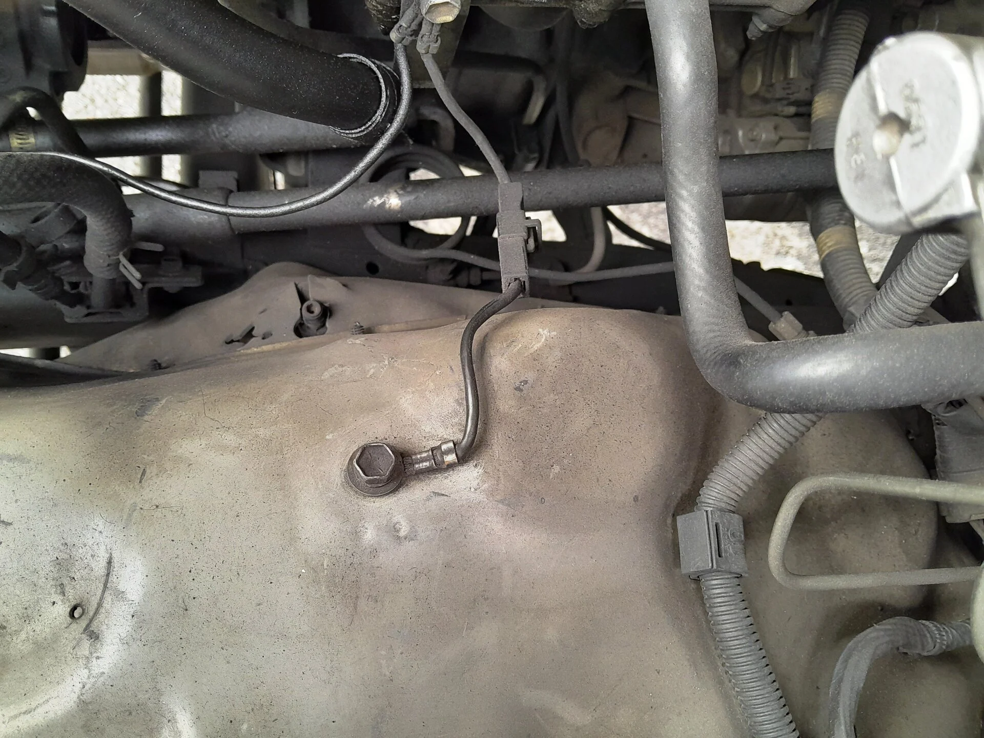

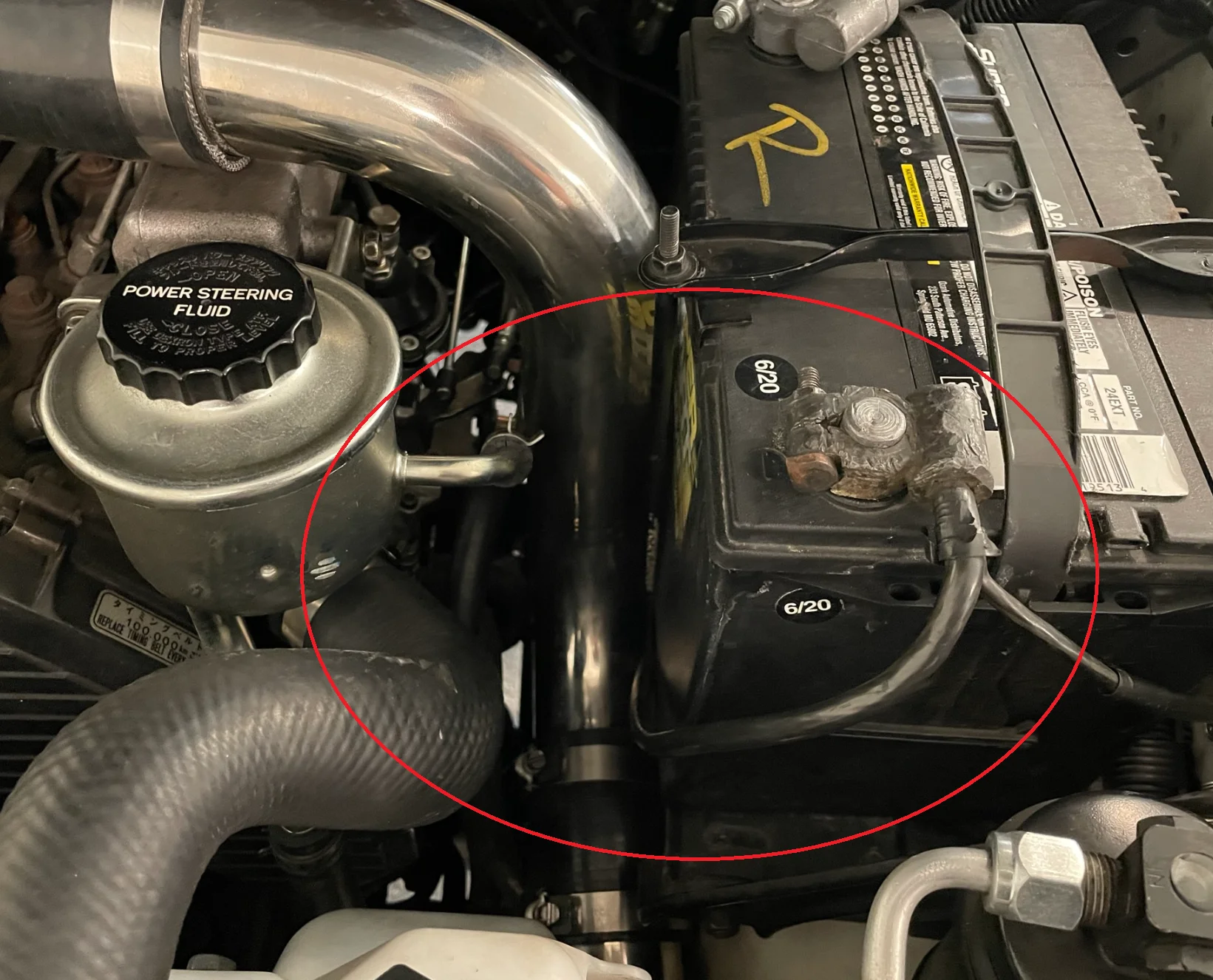

Would anyone have a photo of the Engine ground position to the battery?
Yes, here you go:
Battery top side connection. Yours will not have the intercooler pipe there.
The wire goes straight down and connects to the 1HZ engine block between the LH side motor mount and the P/S pump.
(please ignore my horribly routed turbo oil feed line)
