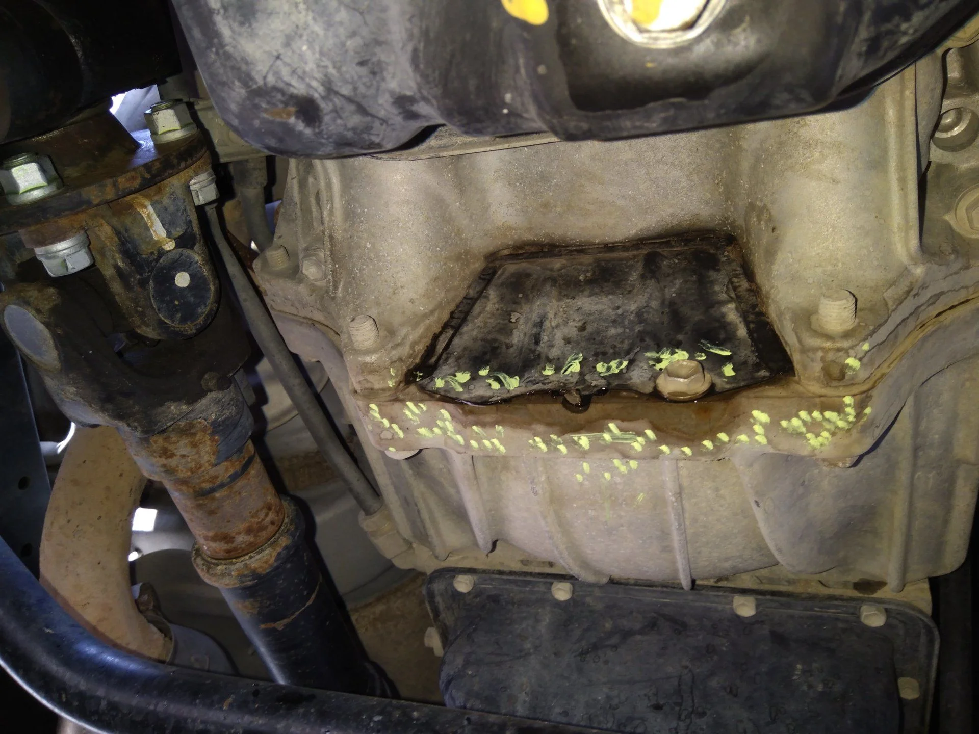

99 100 series. Have minor leak. Can see in pic marked by yellow chalk. I have looked everywhere to see if coming from other areas. The thing is it tastes like antifreeze not Tran fluid.
Bolts are snug. It looks like its behind that plate not necessarily the seam.
Mechanic told me if taking this apart is a major $$$ job.
The leak is only in the middle. I put alot of chalk for picture.

That is the transmission. And the leak is not coming from the transmission but the Rear Main Seal from the engine.
Your mechanic is correct, it is expensive and major labor. It involves taking the transmission out and everything else attached. You can try some AT 205 sealer and hope it works.
If it’s not leaking to the point of staining your driveway then you can leave it until it becomes worse. Just keep an eye on oil levels. I have have had same problem for a year now and it’s wet and looks like your but has not started dripping on floor YET.
I could see this costing close to $1k. It’s at least a 1 1/2 day worth of work. The part is probably $25.
If it is antifreeze, my guess is the heater core is cracked where it goes through the firewall, and it's dripping down to that lowest point. What is your coolant level doing? Could be the line that comes down from the heater tee that goes to the rear heater core, too, or the heater tees themselves.
I would actually guess its the rear heater bypass. Did your heater T's get done recently??

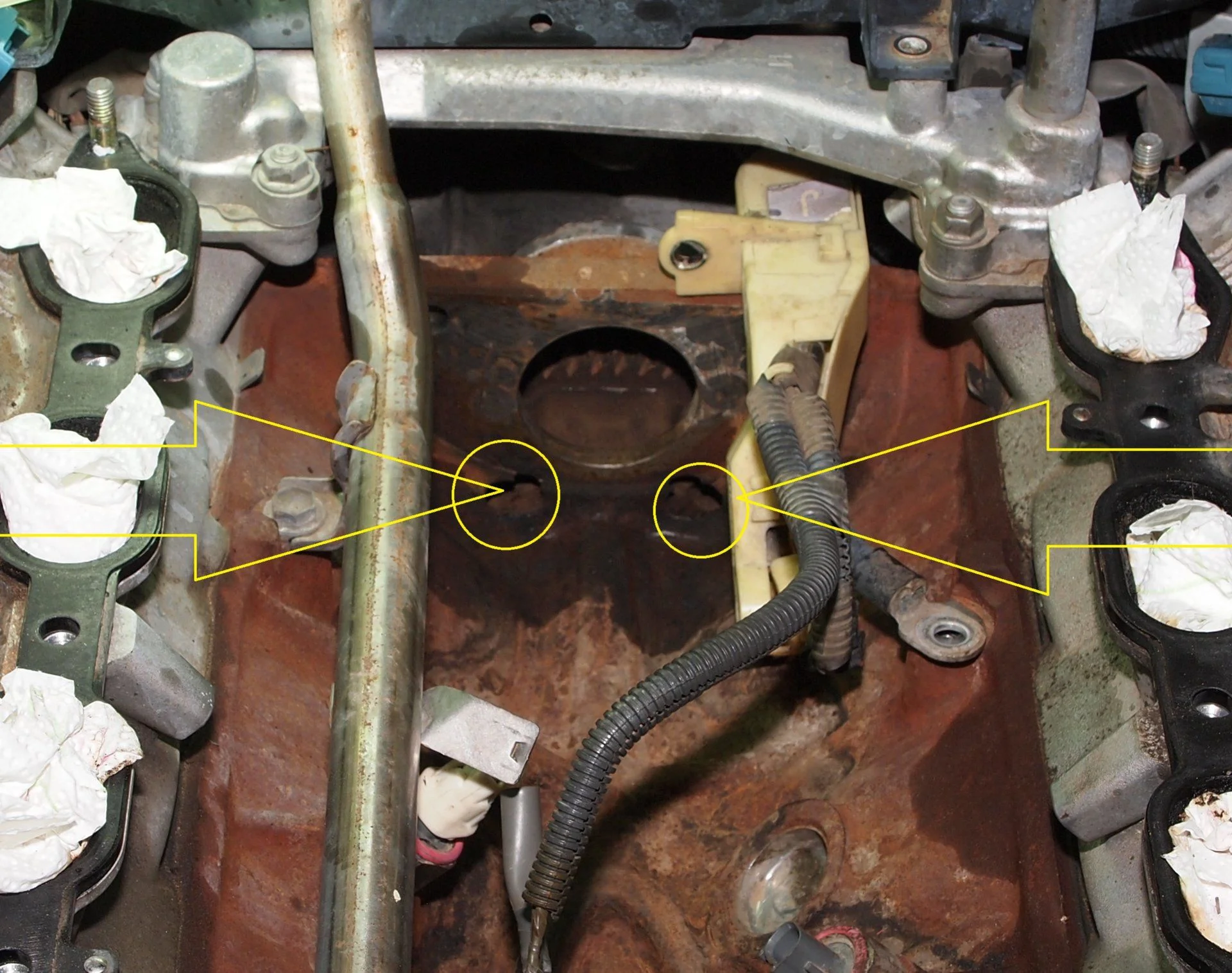

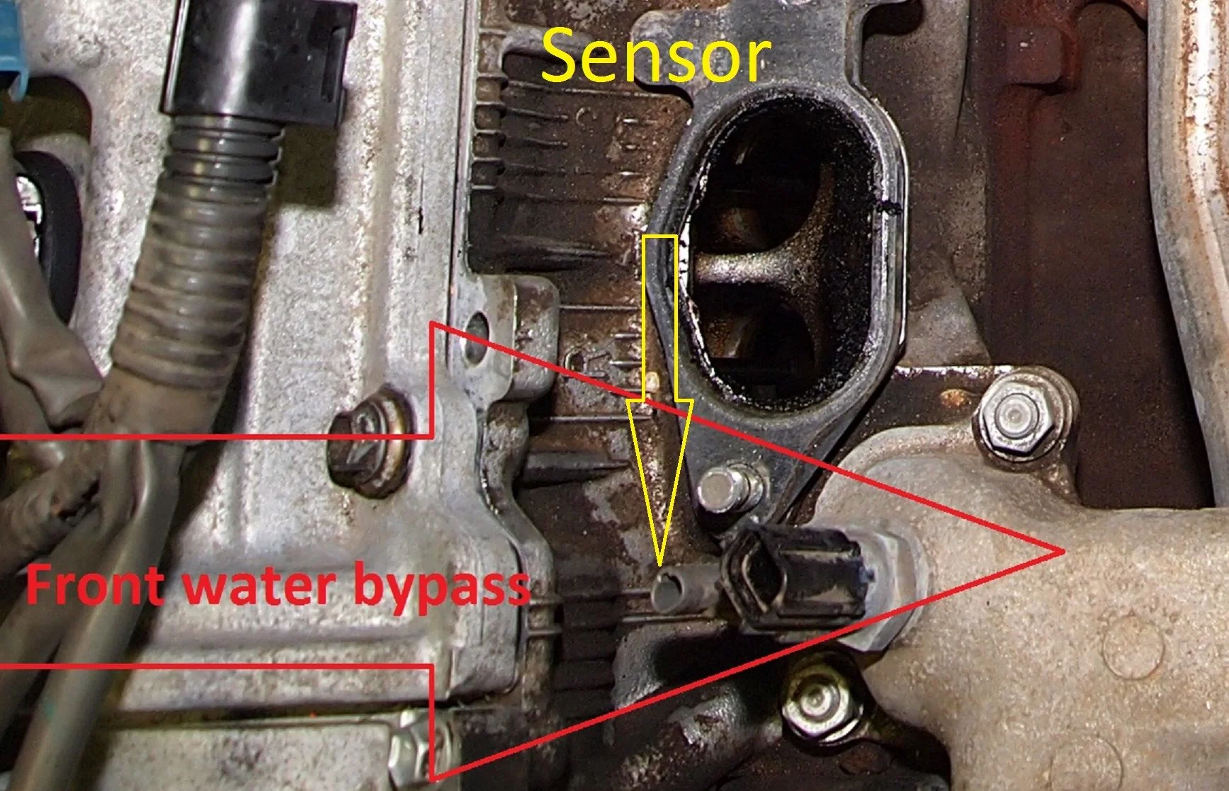

First off you do not have a VVT engine. That is a broken water/coolant sensor. I don't know why but the 98-02 had two water sensors. If you see coolant coming from it, then it is filling the valley and following out the drain holes in back of block. It the come out the rear weep hole on bottom front of bell housing in your first picture. Call any Toyota parts counter; tell them you need the water sensor, that's on the front water by-pass. Tell them it's the small one just below the larger one. They'll figure it out.
Drain holes in engine block valley (starter removed)

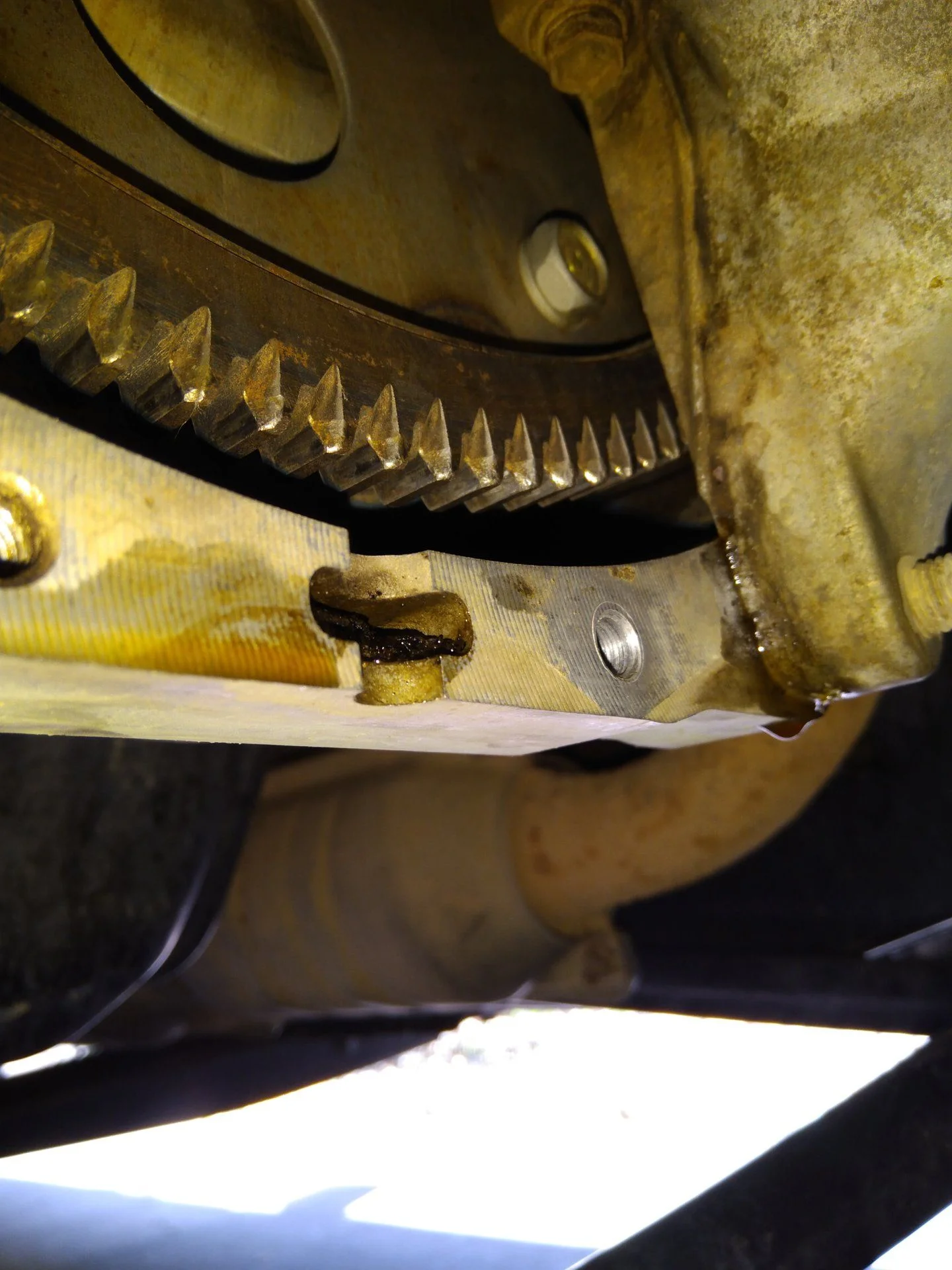

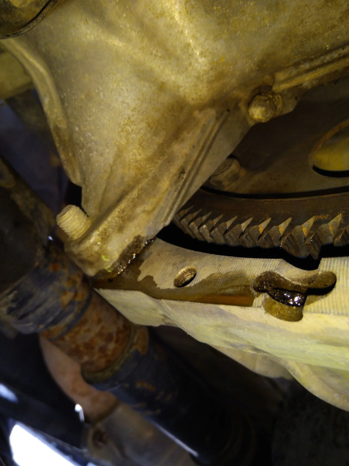

OK here is where I am at on the rear seal. (I'll forward your replies above to my mechanic on the water sensor etc.)
We checked all the hoses and Ts, all great shape. Put a pressure test on the system over 5 minutes at PSI. Never dropped, no air or liquid from any where.
I took off flywheel plate cover and 1+ ounces dripped out. Over than a tiny amount of dirt gunk on inside of plate there is nothing Perfectly clean inside
. I wiped the bottom under the wheel itself. Clean as a whistle. Ran engine and looked in by flywheel, couldn't see anything inside. It is seeping thru seems to outside bolts AND I FEEL NO liquid inside. There is no other sign of moisture except seep thru outside bolts.
