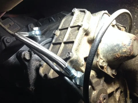

What would be the advantages of this hose? I have a oem PTO in my split tcase is it ok to put one of this? Pictures will be appreciated tks
To make sure you get the right length you need to
Measure from the fill plug of the transmission yo the fill plug of the transfer case. The standard length is 12.75 for an H42 4 speed transmission to a one piece transfer case. Thats all I own so I
dont have any way of knowing what exactly you have. The way to test if you need it is to remove the fill plug on the transmission. If oil comes out of it its because it sucked oil out of the transfer case. The hose would prevent the over flow condition. The oil is sucked out of the transfer case because the seal between the transfer case and transmission failed. Some guys are still installing the hose as insurance for when the seal does fail. For what the hose would look like after installed there are several pictures on this thread.
@shipmag tks for the info. Could not look for a picture in this thread that has thus hose with a Toyota oem PTO attached to the tcase. It would be nice yo see one and how it was attached from tranny to tcase
Take a rubber hose and measure how long of a hose you need without putting any kinks in the hose. The longest one I have had made was like 27 inches to snake around all the obstacles the hose works better than a tape measure. Your the first one I have had asking about the pto. Just be sure to try and keep the hose from
Coming in contact with your exhaust. These hoses have a teflon sleeve to protect from heat but if it lays on the exhaust pipe all the time eventually i think the hose would fail from the heat. Good luck.
don't know which side the PTO and fill hole are located????
PTO and Hose
PTO comes out driver's side of the t-case.
My bad Pablo your right saw the pic on Vaes thread. In looking at that pic, it will take a longer hose to go above the PTO. I am not sure but it might be too high then to work properly as the oil would have to get to that level where it comes over the PTO. Not sure but that may end up keeping too much oil in the transmission allowing it to flow out the front seal of the transmission when it goes putting oil all over the clutch and possibly ruining the clutch plate.
Why couldn't you just use a long hose and run under the PTO box? The gear oil would still return to the transmission fill hole the same way, just a bit long route. John
