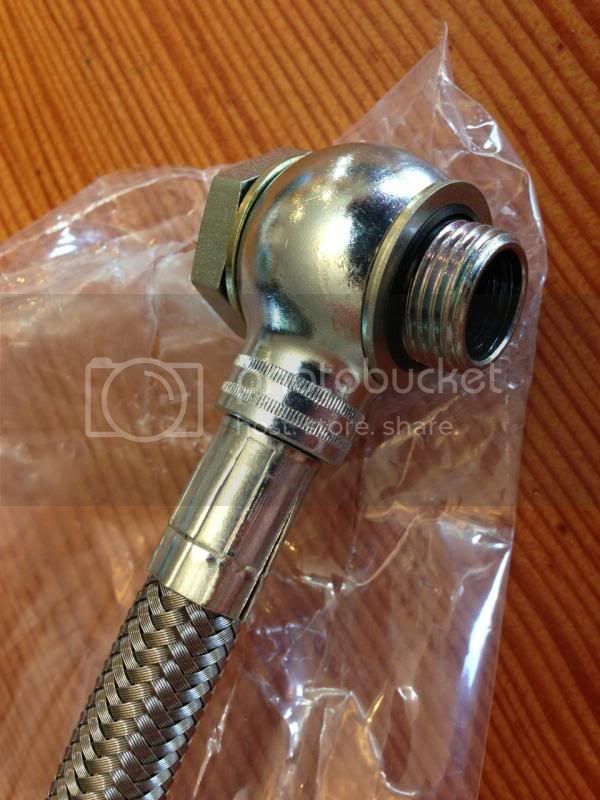

How deep do these thread into the t-case/trans fill holes? I have Shipmag's hose and the worn out threads on my t-case need something that threads a little deeper. My t-case is more of a basketcase.
http://s132.photobucket.com/user/duffontap/media/Shipmags_zps8e49b471.jpg.html
I was just told today that the first five shipped to me today should have them Friday they will go out within a couple days after that with the holiday things are busy at my store. The first five will go to
